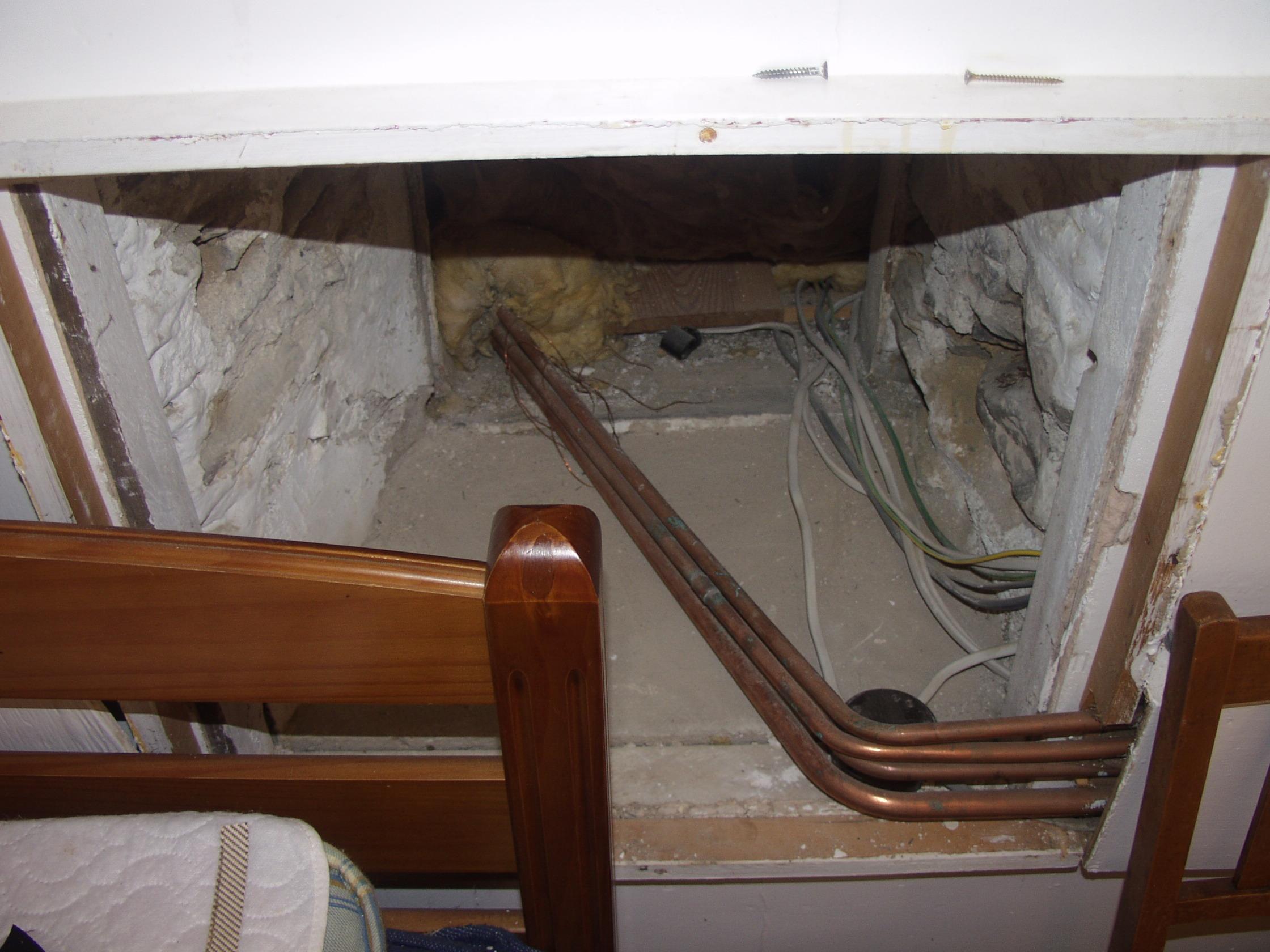

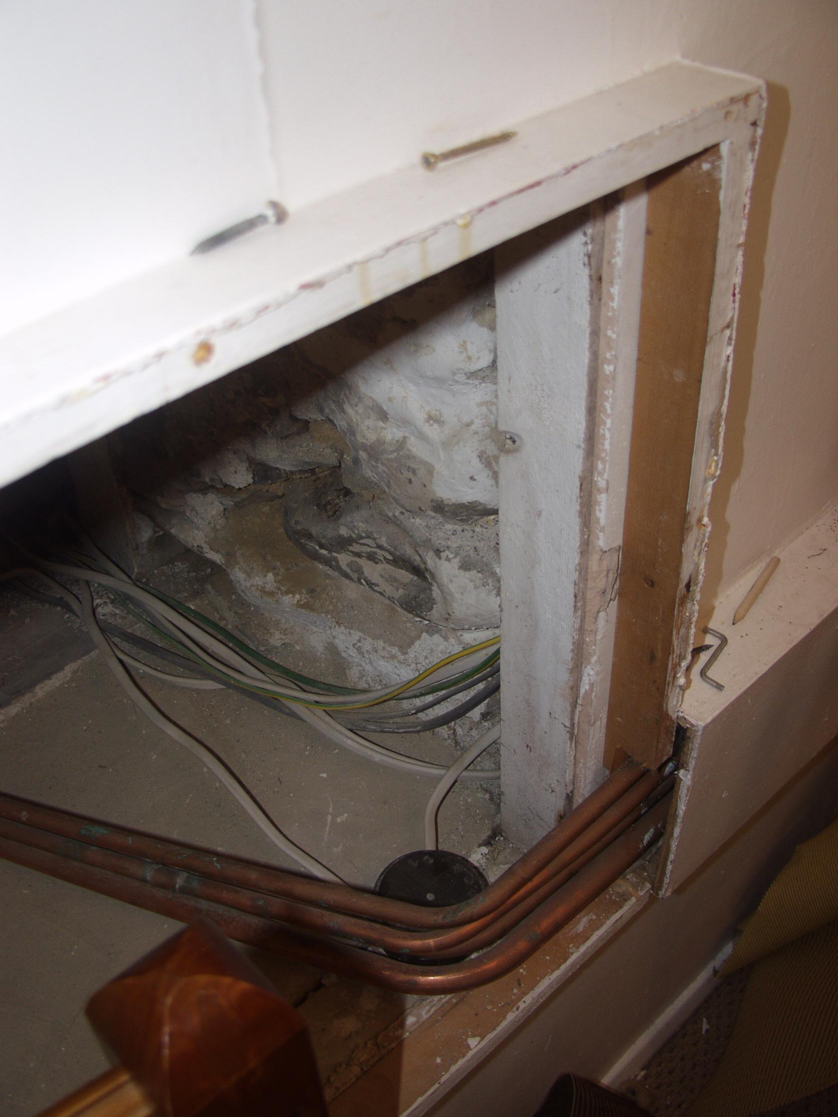

zoothorn Posted November 29, 2018 Author Share Posted November 29, 2018 Understood Peter.. but surely @ the pir edges, filled with soudal say here, need a stable wall face to stick to: if a bit crumbles whilst or after the foam set onto it, I might have an air gap I cant really see to repair kind of ruining the job. Link to comment Share on other sites More sharing options...
PeterW Posted November 29, 2018 Share Posted November 29, 2018 If you've got either 3x2 or 4x2 on side against the wall and foamed front to back, it will not move !! There is no impetus to make it move so you won't have an issue. Make 2 frames - one front, one back - and foam the edges of the PIR sandwich and you will have no issues at all. Link to comment Share on other sites More sharing options...
zoothorn Posted November 29, 2018 Author Share Posted November 29, 2018 Ok I'm now confused of the frame. Thought I had it but.. So is the frame a vertical 'picture frame', Im pushing into the hole, parrallel with me 'ole front door? I'm not understanding the 1st part of your sentence above/ I can't visualise (esp '3x2 on side against the wall'). This is where we need an onoff-banksy eg! Link to comment Share on other sites More sharing options...
PeterW Posted November 29, 2018 Share Posted November 29, 2018 1 hour ago, zoothorn said: Ok I'm now confused of the frame. Thought I had it but.. So is the frame a vertical 'picture frame', Im pushing into the hole, parrallel with me 'ole front door? I'm not understanding the 1st part of your sentence above/ I can't visualise (esp '3x2 on side against the wall'). This is where we need an onoff-banksy eg! Yes correct - picture frame one goes in, wedged and foamed about 10-12” back. Leave the foam to go off, cut the excess off and then cut a piece of PIR or two to the thickness you want to a rough shape. Push these in and foam round the edges to hold them in. Finally, another “picture frame” foamed in to be level-ish with the wall. Clearer..?? Link to comment Share on other sites More sharing options...
zoothorn Posted November 29, 2018 Author Share Posted November 29, 2018 Yes thanks- I did have this plan in mind, just your previous reply stumped me for a bit/ such is the way with written replies etc. Why the last frame tho.. to hold all the pir's in place pushing them all against each other? shouldn't the pir's be joined together as I go with foam.. I guess there's no definitive way to do this just shove it all in so long as its secure enough. Link to comment Share on other sites More sharing options...
PeterW Posted November 29, 2018 Share Posted November 29, 2018 Both to hold the PIR in place and to give you a surface to fix the plasterboard to. Link to comment Share on other sites More sharing options...
zoothorn Posted November 29, 2018 Author Share Posted November 29, 2018 Ah ok.. I hadn't thought any pB was in the plan tho, as if I'm going to undo the main pB's & shove rockwool in then I can't re-use the pB's (can I?) but do new ones. I'm not on board, sorry. Do you mean create the front frame to stick way out, as would be needed so the new square of pB is flush with the wall's existing pB's?? With the 2" gap needed.. I'd need to somehow make a frame protruding 5" out from me 'ole castle wall faces. I think I'm stumped- I just can't visualise what you mean re this front frame & pB. Link to comment Share on other sites More sharing options...
PeterW Posted November 29, 2018 Share Posted November 29, 2018 No just make the second one flush with the walls and put your 3x2 studwork in front of it. Didn’t know you were doing studs in front of this as pics don’t show it. Link to comment Share on other sites More sharing options...
zoothorn Posted November 29, 2018 Author Share Posted November 29, 2018 Ok think I'm there then. Not quite sure on the finishing of the pB.. but I'll cross that bridge when I get to it. I tried to show exactly these studs, relative to me 'ole, in the most recent pic above tho.. maybe not seen? Thanks Peter. Link to comment Share on other sites More sharing options...
Onoff Posted November 29, 2018 Share Posted November 29, 2018 Not to pi$$ on anyone's parade here but if that hole you're blocking up is the ONLY access to the void above the kitchen ceiling then what are you going to do the day you get a burst pipe in there...or a chewed wire? I'd be making an insulated door / removable panel. Link to comment Share on other sites More sharing options...
zoothorn Posted November 29, 2018 Author Share Posted November 29, 2018 No no.. good point (& thx for thinking ahead) I do have a ~1/2 sized loft hatch in kitchen ceiling I can just about haul me arse up thru. About same overall size as me 'ole/ window. If I were to pir the loft joists, I'd have to get the pir's up in small thin bits, up thru me' atch: a sod of a job surely. Link to comment Share on other sites More sharing options...

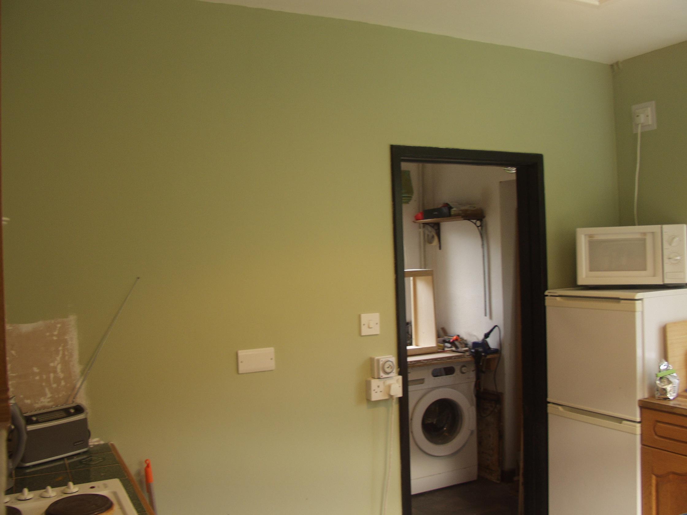

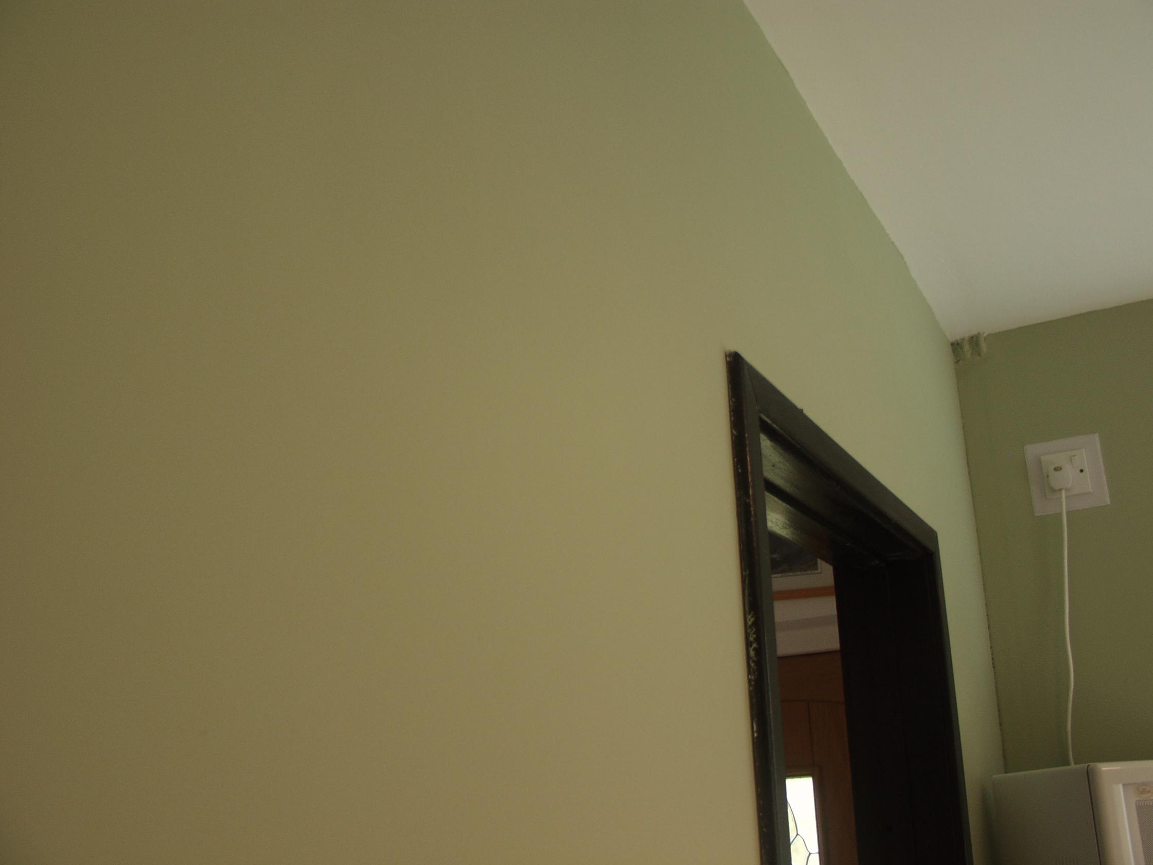

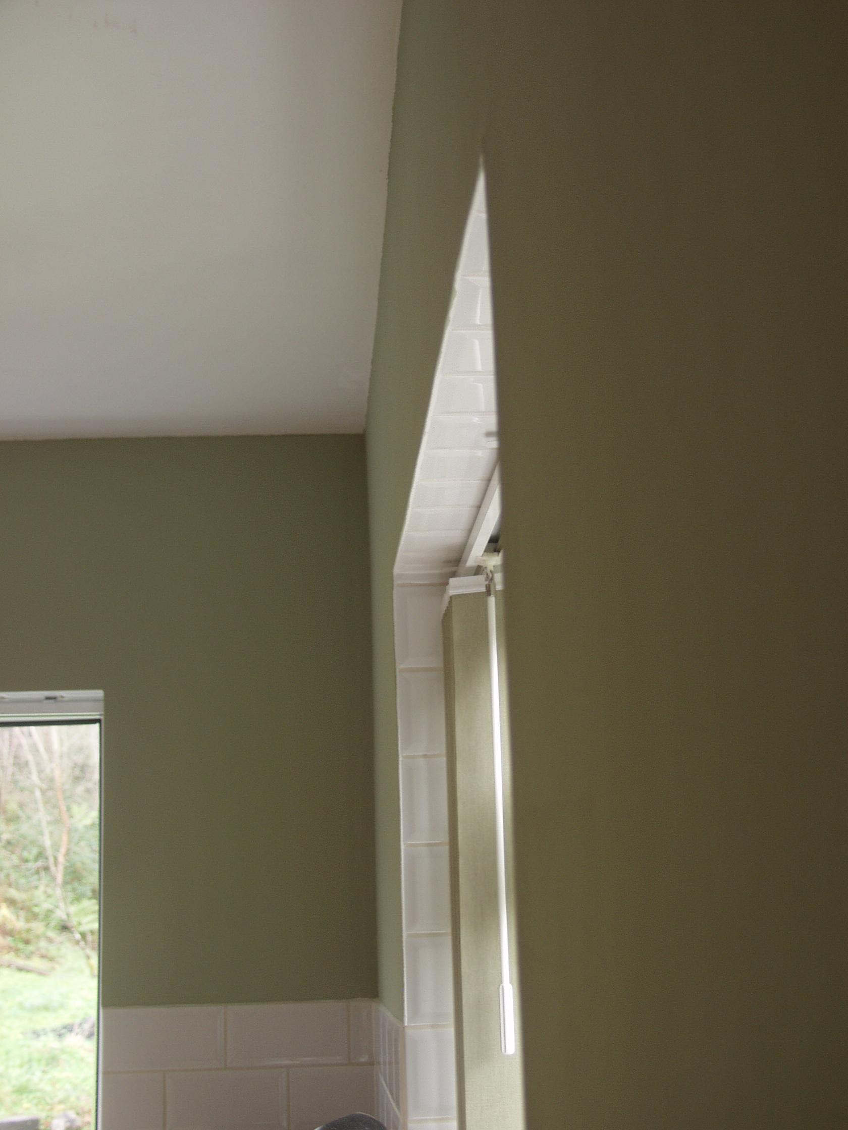

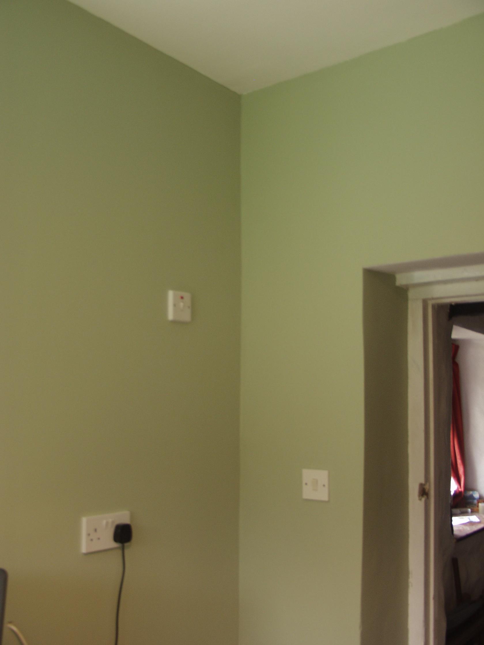

zoothorn Posted November 30, 2018 Author Share Posted November 30, 2018 Big wall 3, & 4 done (inc large area of blown plaster repaired above fridge). Great results after so much graft/ you can't see old paint residue at all in fact, wasn't expecting this. Link to comment Share on other sites More sharing options...
zoothorn Posted November 30, 2018 Author Share Posted November 30, 2018 Details/ sitting alot, admiring my handiwork etc.. 1 Link to comment Share on other sites More sharing options...
Onoff Posted November 30, 2018 Share Posted November 30, 2018 Show off! Link to comment Share on other sites More sharing options...
zoothorn Posted November 30, 2018 Author Share Posted November 30, 2018 Hehe. Damn right I am! (as much showing results of your efforts guiding me along). Its not perfect only just up to 'good' std at best.. but good thing is cos my cams so cr*p yous lot can't tell. Link to comment Share on other sites More sharing options...

zoothorn Posted November 30, 2018 Author Share Posted November 30, 2018 Just back to me' ole. Im just off to get some 3x2.. & cleaned area up: so you can see better/ I got this lot to manoeuvre around.. a big pain. Can you advise re. the bunch of wires & pipes? Link to comment Share on other sites More sharing options...
