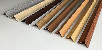

Onoff Posted October 13, 2018 Posted October 13, 2018 Well it was torturous at times but you got there in the end and then some. Looks great. Glad that idiot's idea ref getting the tiles on in one hit worked out! If you find yourself hating the external corners of the tiling you could trim in upvc angle; white, woodgrain etc.
