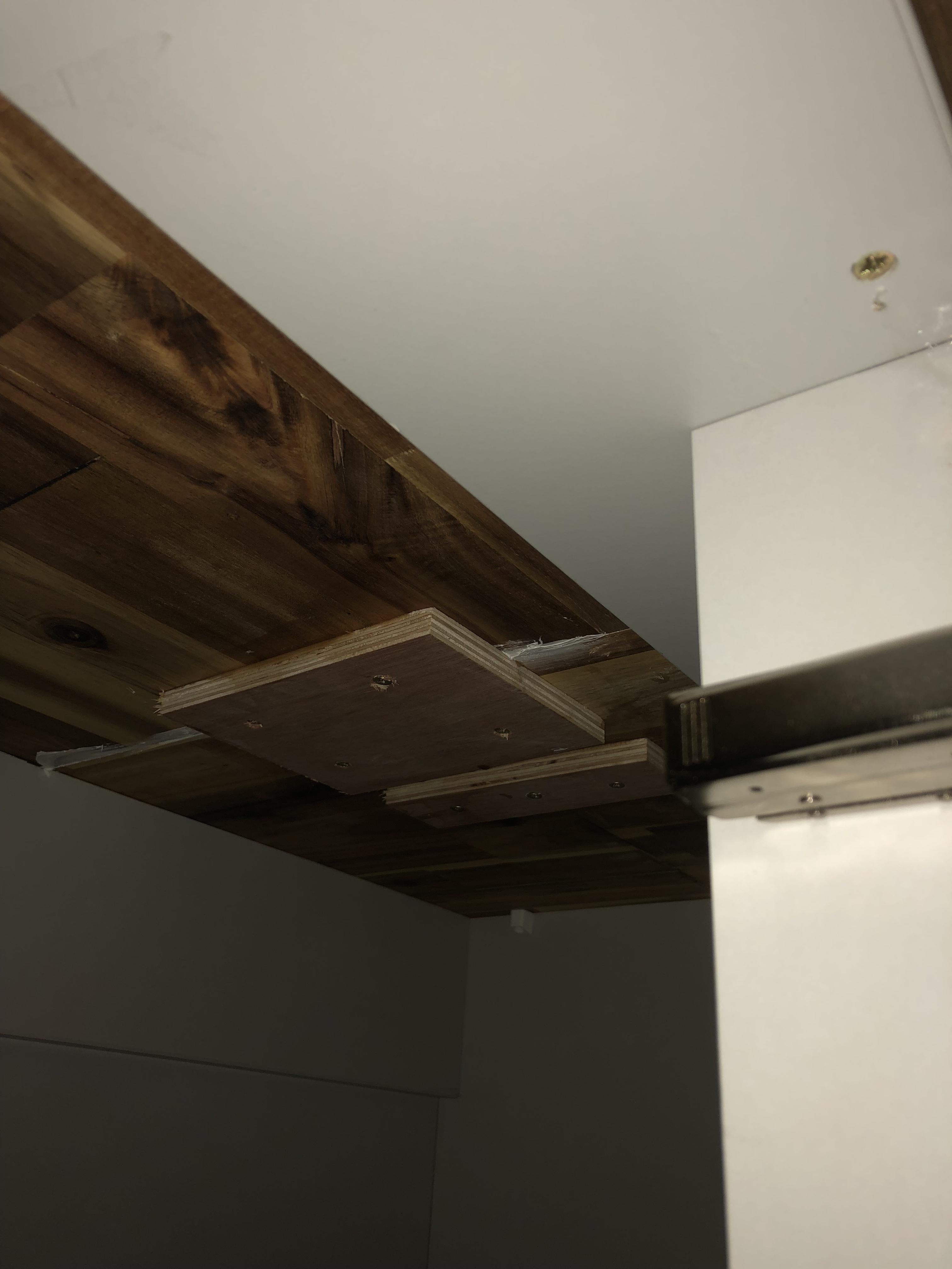

PeterW Posted September 11, 2018 Share Posted September 11, 2018 Clear sanitary sealant is fine as it just means it has a biocide in it. And yes -just screws and nothing else ..!! You can see the joint on this one from below and above - screws into the frame in top right of the picture. These are 4x30mm so even if you sink them into the frame it won’t pierce the top. Same with the 12mm ply as joint blocks. Link to comment Share on other sites More sharing options...
zoothorn Posted September 12, 2018 Author Share Posted September 12, 2018 Peter, sorry I'm still confused as to your 'not using anything under units, but screws & nothing else'. Its just the way with the www & not being able to speak in person (what did you mean by "not using anything under units"?? I can see one ply block which seems to span a join with the white stuff. But can you tell me what the other block is for, the smaller one? At the moment I'm having huge difficulties with these tops to join. Ive just spent the day getting the 3rd & 4th units in, & as best I can possibly do regarding level, & xyz relative to the sink tops. A hell of a job. Then got the sink into the top- very tricky this with sti=upid barckets that dont fot properly pulling down onto the cabinet walls. A nightmare day tbh. This top is yet to be fixed into the cabinet frame &/or the wall as I'm very concerned with the joining: Ive biscuit rebated 3x in each face. But the shorter top, even putting a huge weight on the thing to flatten in order to get cutter at its face.. was still pulling up 1-2mm. So I had no choice but cut like so. Now, getting them to join I think will be nigh on impossible: the shorter one I had to cut 2/3rds (1/3rd removed), is still bowing up badly meaning offering them together is a dogs dinner.. big disappointmernt after so much massively careful prep work. Link to comment Share on other sites More sharing options...
zoothorn Posted September 12, 2018 Author Share Posted September 12, 2018 Ive gone back over the info re. joining, & clamping is mentioned.. &/ or the screw plates understood once the joint is made, but how do I try & pull the bowed top into line for the biscuits to meet? i don't think its possible, is it? I just can't think of anything to help: I can't screw from under ^ up to pull it down, as then I can't move the two tops together. The two top together are 5mm difference one end. I think the only way is to buy a new top tbh.. but no Homebase anywhere near me/ a 120m drive to p/u. Or 2nd idea is to somehow join 5mm proud & sand the fk out of it.. but the work involved to do so I can barely think of, plus the join will have a 'step' right at the main junction/ seen. Anyone know if there's any way to force this hardwood bow out?? Link to comment Share on other sites More sharing options...

PeterW Posted September 12, 2018 Share Posted September 12, 2018 5mm bow sounds a lot - is it really that much..?? you could temporarily pull it down using screws from the cabinet below and then unscrew it and fit the biscuits. Would work to an extent I expect. Second block in on the picture at the back is because this is a 3 way join - had to extend the first piece to 2.5m before creating the join. No biscuits in the L join, just in the end. Acacia behaves as both a softwood and a hardwood - it will sand back with a DA using 60 grit pretty quickly if you need to level it off. Don’t be afraid to force it into shape for a day or two before fixing it into its final position Link to comment Share on other sites More sharing options...

PeterW Posted September 13, 2018 Share Posted September 13, 2018 Lean on the front edge and get it level then put 4 or 5 screws along the edge into the frame. Then put some weight across the back edge which will now have kicked up by probably 6-8mm and just leave it alone and go find something else to do for a day. It will start to settle back down I expect. Link to comment Share on other sites More sharing options...

PeterW Posted September 13, 2018 Share Posted September 13, 2018 Biscuits aren’t the only option - yes they will make it stronger but a ply plate works just as well. Link to comment Share on other sites More sharing options...
