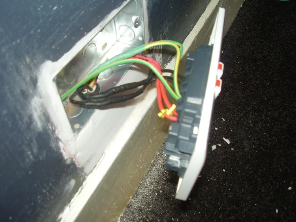

zoothorn Posted August 13, 2018 Author Posted August 13, 2018 I did unscrew them, but can't determine if the wires are long enough.. it looks like there's some 'slack' available, maybe. What I need to know is if I can leave this for now, & crack on with the 2 bits of pb3 (above & below window), with pb2 just 'pinned' in its final place. Then take off pb2 later & do the socket biz. If I don't have enough wire I'll have to re-place the socket(s) higher I guess. That's quite a job for me. Maybe I need an electrician.. but just for an hr's work/ unlikely any will be available being busiest time of year you see.
newhome Posted August 13, 2018 Posted August 13, 2018 2 minutes ago, zoothorn said: Maybe I need an electrician.. but just for an hr's work/ unlikely any will be available being busiest time of year you see. @Onoff will need to advise on this one ?
Onoff Posted August 13, 2018 Posted August 13, 2018 With the power OFF! Will the face plates unscrew and then still connected pull forward the depth of the new batten + the pb? Sometimes you might find you are prevented from doing this by the fly lead, that is the green/yellow earth lead that goes from the brass terminal in the corner of the back box to the earth terminal on the face plate. Doesn't look like there is one on yours. If there isn't enough slack you will have to extend the cables.

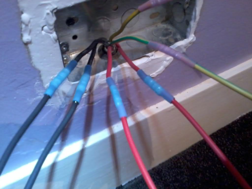

Onoff Posted August 13, 2018 Posted August 13, 2018 We could talk you through extending wires if necessary like this with crimps as shown or even Wago blocks at a push. Just not sure if doing so will send me over the edge! Let's hope you don't have to. A big difference is all the above was done with the proper crimps etc by somebody competent & tested after with the proper kit.

Tennentslager Posted August 13, 2018 Posted August 13, 2018 (edited) 1 hour ago, zoothorn said: I did unscrew them, but can't determine if the wires are long enough.. it looks like there's some 'slack' available, maybe. What I need to know is if I can leave this for now, & crack on with the 2 bits of pb3 (above & below window), with pb2 just 'pinned' in its final place. Then take off pb2 later & do the socket biz. If I don't have enough wire I'll have to re-place the socket(s) higher I guess. That's quite a job for me. Maybe I need an electrician.. but just for an hr's work/ unlikely any will be available being busiest time of year you see. Can't you (with power OFF) have a tug at the wires going into the wall and see how far you can gently pull out any slack. Often there will be plenty ... Edited August 13, 2018 by Tennentslager

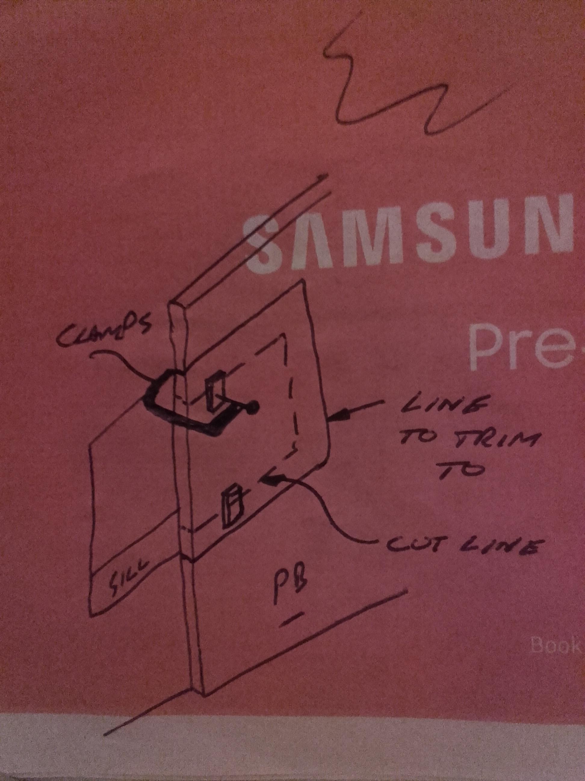

Onoff Posted August 13, 2018 Posted August 13, 2018 3 minutes ago, zoothorn said: That's an idea (cut later) but how? I could barely get behind to mark cos it was so big a "C".. I had to squash my head between the pB & window to reach to mark/ actually I had to do 1/2 of it outside thru the top window! Cheap as chips that last one's a good site. Ok wilol guage the wire length 1st thing tmrw & order if enough wire. I'm still up a gum tree re. this extreme "C" pb2. Has the idea of splitting it into 3 (in obvious places) got legs? Just screw the board on. Do the vertical cut first but allow an inch or two over. Cut the bottom, again an inch over again. Stick a clamp at the start of the cut. Cut the top again put a clamp at the start of the cut. Trim up neatly once the big awkward lump is out.
zoothorn Posted August 13, 2018 Author Posted August 13, 2018 Gotcha/ capeesh all the way up to.. 'put a clamp on start of cut' onoff... b b but where/ clamp/ eh?
Onoff Posted August 13, 2018 Posted August 13, 2018 13 minutes ago, zoothorn said: Gotcha/ capeesh all the way up to.. 'put a clamp on start of cut' onoff... b b but where/ clamp/ eh? I ain't moving to get paper!
zoothorn Posted August 13, 2018 Author Posted August 13, 2018 Ok understand where clamp go. b but dunnae know what clamp for. ugh.
Onoff Posted August 13, 2018 Posted August 13, 2018 7 minutes ago, zoothorn said: Ok understand where clamp go. b but dunnae know what clamp for. ugh. Just an aid if you're on your own so it doesn't all wobble or suddenly break when there's only a piddly bit left to cut.
zoothorn Posted August 13, 2018 Author Posted August 13, 2018 Aha! I was thinking put a massive clamp out through the window, clamping the pB to the outside wall.. for some reason.. it must be that I thought!
Onoff Posted August 13, 2018 Posted August 13, 2018 7 minutes ago, zoothorn said: Aha! I was thinking put a massive clamp out through the window, clamping the pB to the outside wall.. for some reason.. it must be that I thought! These are handy: https://www.screwfix.com/p/spring-clamp-set-6pcs/3036V?
zoothorn Posted August 14, 2018 Author Posted August 14, 2018 Hang on Im still not on board. do you mean use a straight edge, clamped on..? Im trying to figure out what your clamps are for exactly. Im sure its a good idea.. anyway I'm about to put up the whole sheet- Ive cut the vertical line, hoping it won't break here. damn heavy these twisting round/ up.
Onoff Posted August 14, 2018 Posted August 14, 2018 5 minutes ago, zoothorn said: Hang on Im still not on board. do you mean use a straight edge, clamped on..? Im trying to figure out what your clamps are for exactly. Im sure its a good idea.. anyway I'm about to put up the whole sheet- Ive cut the vertical line, hoping it won't break here. damn heavy these twisting round/ up. Couple of short off cuts of timber, one either side of the cut, clamped on...
zoothorn Posted August 14, 2018 Author Posted August 14, 2018 As a straignht edge along which to make the cut?
zoothorn Posted August 14, 2018 Author Posted August 14, 2018 Is a saw the best thing to make the rough cuts ~2" away from my 2x cuts across? got the sod up tho.. thank gawd..
Onoff Posted August 14, 2018 Posted August 14, 2018 18 minutes ago, zoothorn said: Is a saw the best thing to make the rough cuts ~2" away from my 2x cuts across? got the sod up tho.. thank gawd.. Stanley knife, new blade. Take your time and you'll eventually cut through the paper the other side. Do the bottom first. Then do the top. As your doing the top you'll realise why I said to clamp the bottom cut!
Onoff Posted August 14, 2018 Posted August 14, 2018 55 minutes ago, zoothorn said: As a straignht edge along which to make the cut? No, see the fag packet sketch above. Little bits of timber under the clamp faces.
