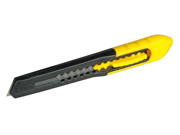

zoothorn Posted August 12, 2018 Author Share Posted August 12, 2018 A stanley being a fat heavier handled type w'more chutzpa I guess, craft the lighter thinner kind.. is that the difference? Cutting the RHS edge seems a much easier proposition than the slight curve on the LHS, if doing upright.. which is what I''ll go for.. dust is my biggest gripe- I loathe it. Link to comment Share on other sites More sharing options...

Onoff Posted August 12, 2018 Share Posted August 12, 2018 (edited) 57 minutes ago, zoothorn said: A stanley being a fat heavier handled type w'more chutzpa I guess, craft the lighter thinner kind.. is that the difference? Cutting the RHS edge seems a much easier proposition than the slight curve on the LHS, if doing upright.. which is what I''ll go for.. dust is my biggest gripe- I loathe They're all known colloquially as "utility knives" I think. A "Stanley" pretty much means a heavy, metal bodied utility knife of any make as Stanley was I think the original. Generally takes this type of blade that can either be fixed or retractable. Some even allow you to select a new blade from within via a clever little mechanism. Most of the retractable ones let you set the blade only a certain distance out which can be to make cutting safer or to only cut so far in: Craft knives are generally plastic and come in two different blade widths. The blades can be extended to a few inches. They're generally scored along their length so as you blunt a blade you just snap off to a fresh edge: Tbh you can get better quality metal bodied craft knives that take the snap off blades or cheaper plastic ones that take the little blades. Cutting pb then a decent metal bodied Stanley. Cutting 25mm Celotex a craft knife. The permutations of craft knives are endless! Edited August 12, 2018 by Onoff Link to comment Share on other sites More sharing options...

zoothorn Posted August 12, 2018 Author Share Posted August 12, 2018 Ah ok then I have the fatter old stanley type then- good, actually just got thru the 25mm C'tex with it. Good. What I've just thought of.. is instead of a curve, is go eg1 with one straight cut at midpoint > to top LH cnr. I just can't face this curve cut, esp on the LH edge! eg1 looks clearly better on the photo in fact. So we agree on the 1st pic. So, a slight gap in the corner of 0.5cm at worst to fill. Good thats a plan I think. I'm less nervous about starting the PB job tmrw now. Cheers zoot. Link to comment Share on other sites More sharing options...
