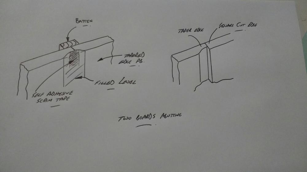

Onoff Posted August 6, 2018 Share Posted August 6, 2018 19 minutes ago, zoothorn said: good one onoff- I think I get the idea(..)/ recall Peter I think said somthing similar, morelike your block/ pencil idea. I like your diagrams! I may be tempting fate by asking so soon.. but can I get away with -not- plaster/ skimming these PB's? I will be tiling + units hiding 3/4 of the PB area.. but still leaves some mostly near door/ immediately noticeable. (Is that basically the principle of these 2 fillers you link to-?) If you've bought tapered edge boards you can tape and fill the joints. You'll have to get creative around the reveal as said earlier. Near the door.....let's see what gaps you end up with. Better fit = less filler. Link to comment Share on other sites More sharing options...

Onoff Posted August 6, 2018 Share Posted August 6, 2018 1 hour ago, zoothorn said: I only just saw what actually you meant by tapered edge boards today.. its so subtle as to any difference (for the uninitiated) to have been missed by me twice Ive read that post. Bugger. I ordered/ bought std 12.5mm ones today, but being delivered thurs (TP) so maybe I should try & redo?? Do all std PB's need full-skimming? that's a pro job I hadn't bargained for at all. Didn't I sketch what a tapered edge board looks like? And write "tapered"...with an arrow...28 July? If I pm you my address can you send me some of whatever you're on? Link to comment Share on other sites More sharing options...

zoothorn Posted August 7, 2018 Author Share Posted August 7, 2018 13 hours ago, Onoff said: If you've bought tapered edge boards you can tape and fill the joints. You'll have to get creative around the reveal as said earlier. Near the door.....let's see what gaps you end up with. Better fit = less filler. Hi onoff- just spoke to TP - they said they don't stock tapered edge/ need to get in/ 2 weeks min.. so what do you recommend: stay with order as is, or wait on these? it is possible to fill & sand the joins of square-edge enough for the finish to be acceptable? I am covering most of the PB's by: units/ tops, tiles above/ up to a corner cupboard (above 'L' worktop join corner). Could I fill > sand > paper over square edged joins at all? Where the wall is most/ ceiling to floor only in one spot albeit next to door, this will be ~somewhat covered too by a couple of shelves (higher) & bins (lower). Link to comment Share on other sites More sharing options...
Onoff Posted August 7, 2018 Share Posted August 7, 2018 9 minutes ago, zoothorn said: Hi onoff- just spoke to TP - they said they don't stock tapered edge/ need to get in/ 2 weeks min.. so what do you recommend: stay with order as is, or wait on these? it is possible to fill & sand the joins of square-edge enough for the finish to be acceptable? I am covering most of the PB's by: units/ tops, tiles above/ up to a corner cupboard (above 'L' worktop join corner). Could I fill > sand > paper over square edged joins at all? Where the wall is most/ ceiling to floor only in one spot albeit next to door, this will be ~somewhat covered too by a couple of shelves (higher) & bins (lower). Because you don't have a depression where the boards meet, if you taped then filled you end up with a shallow "hump". The skill is then feathering this out so it's less noticeable. Sorry, I really don't know what it would end up looking like! Or as Peter says fill and use lining paper but that's more faff/time etc. Try it I guess if only a small area. I wonder if you should be running a bead of No Nails type stuff where the boards meet...? Someone else will dive in shortly... I hope! Link to comment Share on other sites More sharing options...
CC45 Posted August 7, 2018 Share Posted August 7, 2018 square edge boards & skim = looks great. Skimming isn't DIY for most - so £ required. taper edge & fill = can look naff if not done well. Filling can be DIY - along with lots of sanding..... Time vs cost skimming - £10/m2? + materials (not much). prob small % of overall costs?! Link to comment Share on other sites More sharing options...

zoothorn Posted August 7, 2018 Author Share Posted August 7, 2018 Ok good got the tapered edge PB coming thurs, instead of the std PB. Cheaper at Jewsons in fact/ stocked. Easier than I thought that! Cheers zoot 1 Link to comment Share on other sites More sharing options...
newhome Posted August 7, 2018 Share Posted August 7, 2018 (edited) So I've never done plasterboarding before but if I was going to try it I would have a go at taper edge, fill and sand from reading what's involved here. I've done a bit of filling and it doesn't look too bad if you get the sanding smooth. Worst case you have to cover with lining paper and emulsion but try for a decent finish with the sanding first so you can complete on your own. I know what you mean about not being able to get trades out to do small jobs which is why I have to try to do some of the things myself that take me out of my comfort zone. It's all a learning experience though and will help with the jobs you need to do in the rest of the house. Edited August 7, 2018 by newhome Link to comment Share on other sites More sharing options...
zoothorn Posted August 7, 2018 Author Share Posted August 7, 2018 Good points newhome. I'm sort of used to filling/ sanding albeit on the woodwork front.. so I've some knowledge about how 'perfect' a finish is likely needed prior to painting. Saves £alot & prob not a major headache. Good practice too for the upstairs BIG job I'll have to tackle after the winter. Its all about doing w'out pro's so far.. so ideal if I can do all the job. 1 Link to comment Share on other sites More sharing options...
Onoff Posted August 7, 2018 Share Posted August 7, 2018 You'll want: - self adhesive tape (T'station 61291 £3.65) - a wide filling knife (T'station 25000 £5.39) Next day free delivery at TS over £10 btw. - joint filler (Gyproc Easi-Fill for example). Shop around. Can get ready mixed or powder. I splashed out on the Mirka sanding kit at Toolstation. It's excellent. Attached to a Hoover and is virtually dust free. Lidl occasionally do a cheapo version. Link to comment Share on other sites More sharing options...

PeterW Posted August 7, 2018 Share Posted August 7, 2018 Either use Easy-Fill or Toupret filler depending on what you can get locally. Easy-Fill is good for large gaps and sets pretty quickly and sands well Link to comment Share on other sites More sharing options...

zoothorn Posted August 7, 2018 Author Share Posted August 7, 2018 Omg so much more things to get/ consider. Ok thanks for links. I'm just going to get the screws/ the PB job done before I can think of all these extras. One Q, is re these tapered edges: on all 4 edges? I was thinking of putting them in [] this config.. the walls either side of the window are ideal. Is that correct thinking, or have I messed that up-? Link to comment Share on other sites More sharing options...

Onoff Posted August 7, 2018 Share Posted August 7, 2018 2 hours ago, zoothorn said: Do you know what I mean by [] this way/ orientation ("portrait" I call it as Im a dericate frower.. I bet builders don't call it that) for my PB's? I do NOW! Before I thought you'd made a typo! I'd be fitting them portrait. If you can find what Jewson code, on your invoice maybe, it is then you might find the manufacturer's part number. If it's: 01129/0 then its "4TE" as in 4 tapered edges. Link to comment Share on other sites More sharing options...
