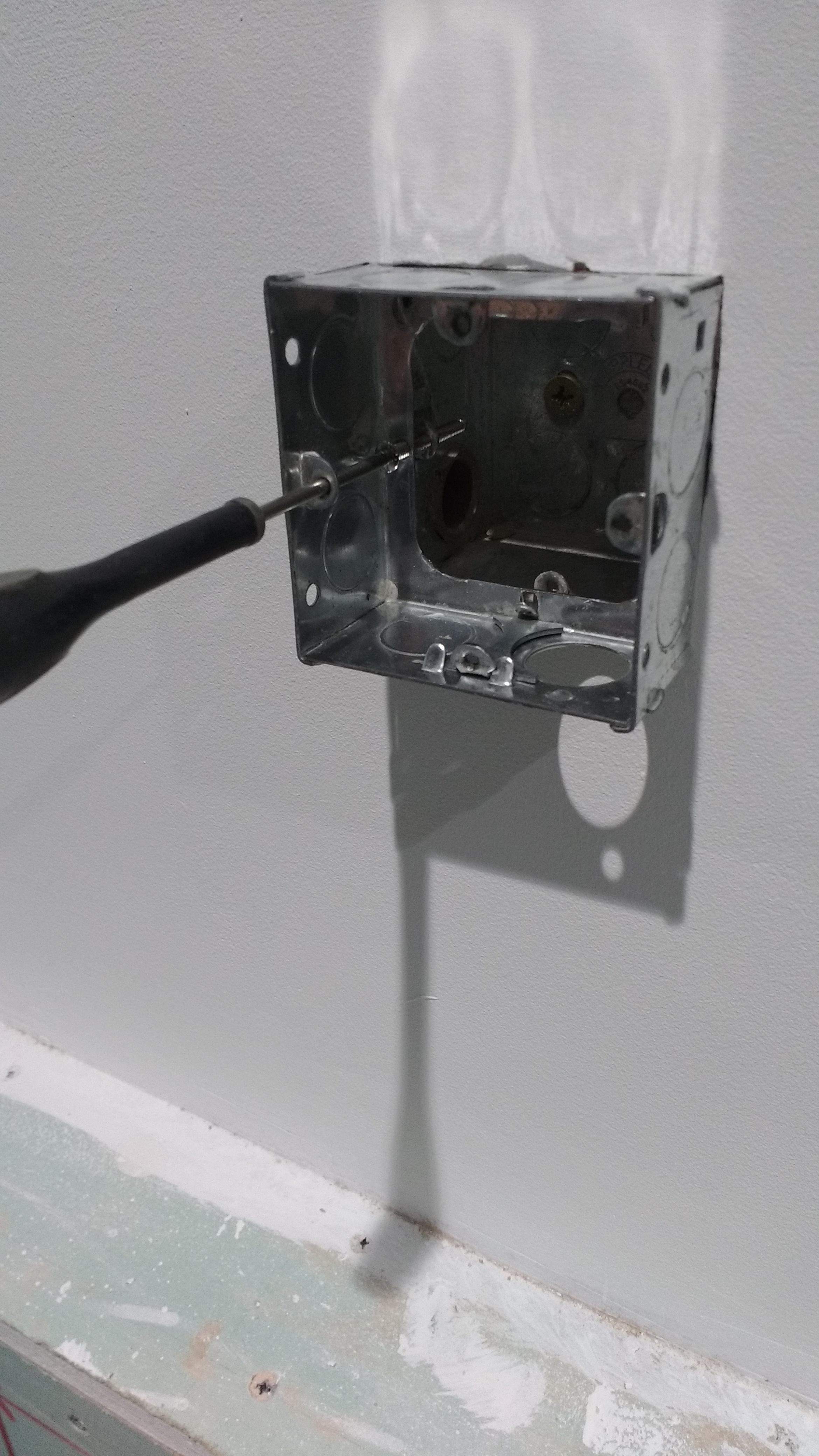

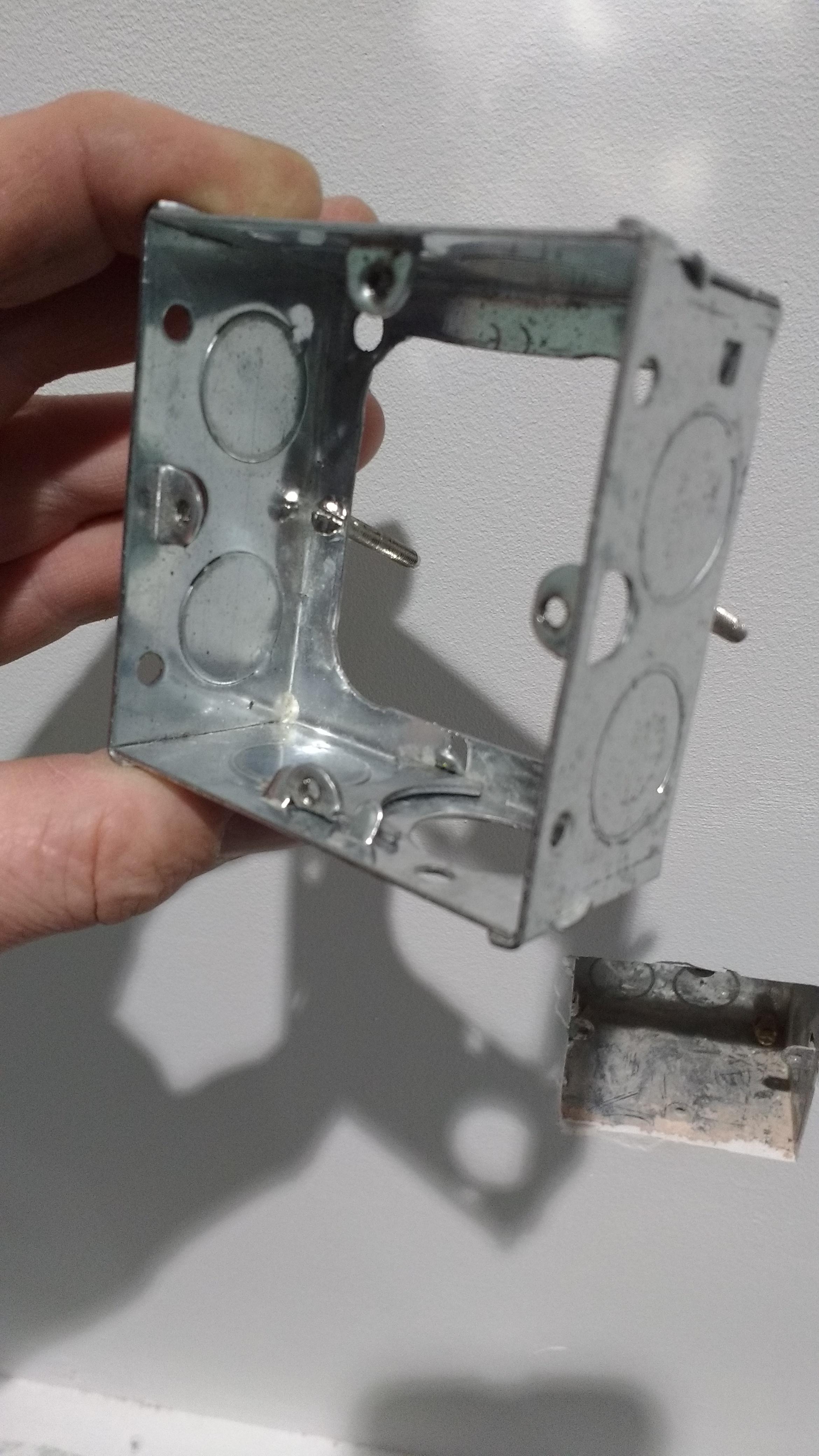

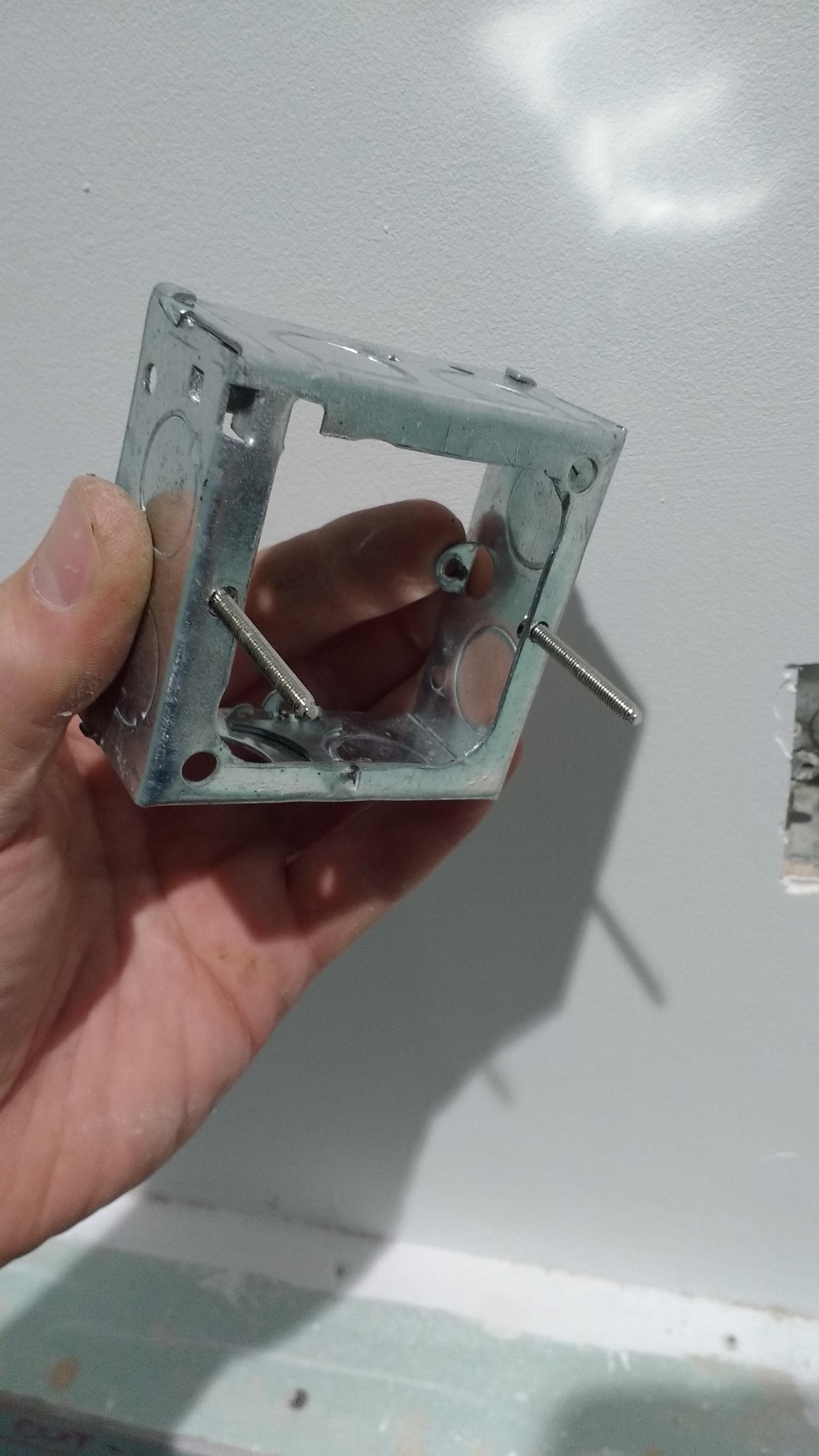

Onoff Posted August 1, 2018 Posted August 1, 2018 Nothing wrong with box extensions. They're the right thing for the job. Better than screw extenders. The screws that fit face plates to back boxes are "M3.5". Same ones that fit extension boxes onto back boxes. Available in different lengths if buying separate. When you buy a new face plate you generally get two new screws with it clipped in the back. Sometimes they have a fancy finish to match the face plate. You need to make sure when putting the screws in, if a bit long, you don't nick or squash the wires behind. You can cut the screws down if necessary. There exists the cheapest of cheap tools that claim to be wire strippers/bolt cutters and crimps all in one. Basically this: http://cpc.farnell.com/duratool/d03190/wire-crimper-stripper/dp/TL19441? As a stripper they're OK 'ish. As a crimper they're utter shite, verging on dangerous imo. However...as a cutter for shortening M3.5 screws they do the job. Simply wind the screw in to the desired length and cut. If you want a basic crimper then this: http://cpc.farnell.com/duratool/d03009/ratchet-crimping-tool/dp/TL08620?st=Crimping tool The CPC site btw is good and cheap. If you f**k up an M3.5 screw hole you can generally rethread with one of these: http://cpc.farnell.com/kamasa-tools/55821/re-threader-3-5mm-x-0-6mm/dp/TL16988?st=M3.5 Look how cheap this stuff is! If you REALLY f**k up the thread you might need to reach tap a size up, M4 with one of these: http://cpc.farnell.com/draper-tools/37924/rethreading-tool-m4-0-x-0-7/dp/TL04580?st=M4 tool Both sizes no doubt available also on eBay etc. You'll of course need an M4 screw to suit. Available in little packs if desperate from B&Q etc.
Onoff Posted August 1, 2018 Posted August 1, 2018 @zoothorn, did you check your Notification Settings within your account?
Ferdinand Posted August 1, 2018 Posted August 1, 2018 There also longer screws available if you need them. You can get them from Screwfix and they will probably be called ‘machine screws’. You can take one of yours along, or look at a socket in the shop to check. Other places have better value etc, but if you are there then they have the stuff. Ferdinand
Onoff Posted August 1, 2018 Posted August 1, 2018 @zoothorn, if like some on here you lack social skills, struggle with interpersonal relationships, have a mild drinking problem and tbh generally prefer contact with tools rather than people then you might like to have a go at making an extension box out of a standard back box: I really can't recommend the use of a 4 1/2" grinder 6" from your nose though. I'd take a bid longer too deburring the cut edges than this bloke did and even consider a grommet strip! Don't either try it either, in the dark with a failing head torch and after 2 pints of Shipyard Pale Ale or you too could be sporting an L shaped burn on your leg from a dropped, hot back box... 3
