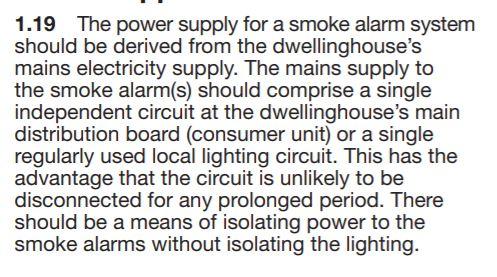

ProDave Posted June 18, 2018 Share Posted June 18, 2018 A number of issues. The rules are different in Scotland and require hard wired mains powered smoke alarms. That requirement may come to England in the future. The electrical regs are all about voltage not power. A 240V smoke alarm comes under the same regs as a 10KW heater. England and Wales has Part P which imposes restrictions on who may do certain wiring e.g new circuits, or circuits in bathrooms. Scotland and NI does not have this. Link to comment Share on other sites More sharing options...

Ian Posted June 18, 2018 Share Posted June 18, 2018 32 minutes ago, ProDave said: The rules are different in Scotland and require hard wired mains powered smoke alarms. That requirement may come to England in the future. The English Regs Part B Vol 1 also say that smoke alarms must be mains powered. Link to comment Share on other sites More sharing options...
