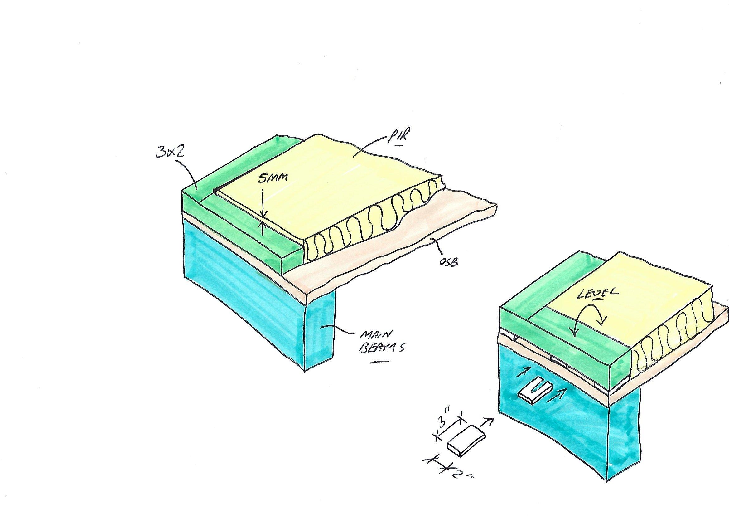

zoothorn Posted May 26, 2020 Author Share Posted May 26, 2020 @PeterW & @Onoff done the sub floor! ok will attempt a pic tmrw. All fine except my PIR is 5mm proud of the surrounding 3x2 frame (45 bloody mm). Many PIR offcuts used so all seams foil taped. What can I do re. the 5mm discrepency-? racked my noggin but as usual very little of worth emerges. Great start tho. Link to comment Share on other sites More sharing options...
PeterW Posted May 26, 2020 Share Posted May 26, 2020 Is there a 3x2 down the middle ..?? I think if you put the OSB over it and screw down from the middle toward the edges it may pull it a bit flatter, otherwise a hammer onto a piece of wood will squash the worst bits. Link to comment Share on other sites More sharing options...
Onoff Posted May 26, 2020 Share Posted May 26, 2020 (edited) On 26/05/2020 at 18:39, zoothorn said: @PeterW & @Onoff done the sub floor! ok will attempt a pic tmrw. All fine except my PIR is 5mm proud of the surrounding 3x2 frame (45 bloody mm). Many PIR offcuts used so all seams foil taped. What can I do re. the 5mm discrepency-? racked my noggin but as usual very little of worth emerges. Great start Expand 1) I've used a lump of steel bar about 2" x 1/2" and a club hammer to beat the pir down in 1/2" strips. or 2) Cut 3" wide strips of 6mm ply. Pin to top of 3x2. 1mm won't make a difference. or 3) You could.....just lop off 5mm slivers of 3x2 on the chop saw and use them. (A bit flimsier instead of ripping with the grain on a table saw). Unscrew, the low, 3×2 timber. Insert the packs perpendicular to and under the 3x2. Once in place fine. or 4) Buy 5mm plastic packs. Unscrew, the low, 3×2 timber. Insert the packs perpendicular to and under the 3x2. https://www.screwfix.com/p/broadfix-plastic-shims-large-101-x-5-x-43mm-200-pack/95031 If you can stretch to it you won't look back from buying an assorted shim kit like this. Invaluable for "shed" building etc. Would be enough in this assortment and then some. https://www.toolstation.com/broadfix-u-shims-kit/p52385 With 3) & 4) place the packs about every 200mm making sure corners are well supported. Fill any gaps later with silicone or whatever's going. Edited May 27, 2020 by Onoff Hoping a picture will save 50 of the 100 questions! Link to comment Share on other sites More sharing options...

zoothorn Posted May 27, 2020 Author Share Posted May 27, 2020 @Onoff cheers for ideas/ sketches prior post (just seen your replies chaps after I put my pics up- cam temp fixed). Best idea is your 5mm insert-risers.. but for sourcing such things/ hard placcy must be (&introduces a gap for moisture/ needs careful thought). As you can see floor in 3 slotted sections, crossbeam timbers just about ok: I wonder whether the interlocking ones on the PIR area might squish it down 5mm over time. The walls actually sit upon the crossbeam 1" protruding ends now I recall, getting it all out after 6 months. Or I just take off crossbeams, use the floor t&g sections/ lay on the PIR.. so negating the 5mm issue. Walls instead sit on my 3x2. But I don't know how the front door area is config'd.. if it needs the crossbeam front. Link to comment Share on other sites More sharing options...

PeterW Posted May 27, 2020 Share Posted May 27, 2020 On 27/05/2020 at 10:59, zoothorn said: Or I just take off crossbeams, use the floor t&g sections/ lay on the PIR.. so negating the 5mm issue. Walls instead sit on my 3x2. But I don't know how the front door area is config'd.. if it needs the crossbeam front. Expand I would fit the frame to the 3x2 and then cut and fit the floor boards to the internal dimensions when it’s done. Just mark the joists and screw them down. If the front needs anything you can just pack it with a spare board. Link to comment Share on other sites More sharing options...
Onoff Posted May 27, 2020 Share Posted May 27, 2020 (edited) On 27/05/2020 at 10:59, zoothorn said: Best idea is your 5mm insert-risers.. but for sourcing such things/ hard placcy must be (&introduces a gap for moisture/ needs careful thought). Expand Just lop off 5mm slivers with your chopsaw from 3x2 offcuts. No need to buy anything. Back the screws out of the perimeter 3x2, lift and pack. Fill the gaps between packs with silicon. Moisture won't get in there. Edited May 27, 2020 by Onoff Link to comment Share on other sites More sharing options...

zoothorn Posted May 27, 2020 Author Share Posted May 27, 2020 On 27/05/2020 at 11:49, Onoff said: Just lop off 5mm slivers with your chopsaw from 3x2 offcuts. No need to buy anything. Back the screws out of the perimeter 3x2, lift and pack. Fill the gaps between packs with silicon. Moisture won't get in there. Expand Done this with dpm folded bits 3mm or so. Onoff one thing's clear now: my floor t&g as you can see sits upon the 2x1 battens. So now floor fixed.. of course I have a gaps of 1.5" or so H under the t&g floor, above the PIR. If you look at my 2nd 'shed' pic.. imagine the tarmac is my PIR. Have I totally negated the function of the PIR? I mean I can close the 4 side gaps, with long PIR bits forming a frame around perimeter.. but only on the sides. There will still be these air voids, between the 2x1 floor battens. Link to comment Share on other sites More sharing options...
zoothorn Posted May 27, 2020 Author Share Posted May 27, 2020 On 27/05/2020 at 11:20, PeterW said: I would fit the frame to the 3x2 and then cut and fit the floor boards to the internal dimensions when it’s done. Just mark the joists and screw them down. If the front needs anything you can just pack it with a spare board. Expand Ideally I understand the suggestion: but I'm really loathed to not construct it exactly as it was dismantled, IE (like the 2nd shed pic above) the walls resting on the floor's extended edge bits.. I'm gonna have a n'mare re-constructing it as it is you see. Link to comment Share on other sites More sharing options...
