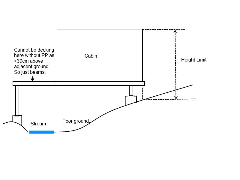

joe90 Posted July 10, 2019 Share Posted July 10, 2019 @zoothorn just post up what your planner replies with, also can you do a rough section sketch with rough dimensions of the stream, bank, Slope and where you want your Cabin, we can go from there. 1 Link to comment Share on other sites More sharing options...
Temp Posted July 10, 2019 Share Posted July 10, 2019 I think we need a diagram of what you would like to build. Here is my interpretation of the situation. If it's way off have a go at producing one yourself.. Link to comment Share on other sites More sharing options...
Temp Posted July 10, 2019 Share Posted July 10, 2019 6 minutes ago, zoothorn said: It seems I missed a post of yours a few back (how can I get notification of replies via email?). I think I understand the nature of your last few posts now, you're responding to when I referred to a decking surrounding the log cabin. Not just decking. If the platform (4x4) is bigger than the cabin (3x3) the extra bit will look like decking to the planners. So that area must just be open beams no decking on top. Link to comment Share on other sites More sharing options...
zoothorn Posted July 10, 2019 Author Share Posted July 10, 2019 @Temp many thanks for this, very useful diagram- what a fab tool to have (or a trained robotoid I don't know). It ain't far off at all! but for.. 1) Shift LHS pillar over the stream, & plonk it where your word "POOR" is (that L side of stream not my property, but unreg'd land). 2) Shift the platform & cabin down ~2 ft, so platform touches the ground RHS. 3) Steepen the slope gradient to a bit less than 45 degrees (yup that steep). Link to comment Share on other sites More sharing options...
zoothorn Posted July 10, 2019 Author Share Posted July 10, 2019 16 minutes ago, joe90 said: @zoothorn just post up what your planner replies with, also can you do a rough section sketch with rough dimensions of the stream, bank, Slope and where you want your Cabin, we can go from there. Just in from my Ceredigion planning officer: sorry its a bit long (its incomprehensible to me reading it 1x so far).. Permitted development E. The provision within the curtilage of the dwellinghouse of— (a) any building or enclosure, raised platform, swimming or other pool required for a purpose incidental to the enjoyment of the dwellinghouse as such, or the maintenance, improvement or other alteration of such a building, enclosure, platform or pool; or (b) a container used for domestic heating purposes for the storage of oil or liquid petroleum gas. Development not permitted E.1 Development is not permitted by Class E if— (a) the total area of ground covered by buildings, enclosures, raised platforms, pools and containers within the curtilage (other than the original dwellinghouse) would exceed 50% of the total area of the curtilage (excluding the ground area of the original dwellinghouse); (b) any part of the building, enclosure, raised platform, pool or container would extend beyond a wall comprised in the principal elevation of the original dwellinghouse; (c) any part of the building, enclosure, raised platform, pool or container would extend beyond a wall comprised in a side elevation of the existing dwellinghouse, and would be nearer to the highway than— (i) the wall comprised in that side elevation which is nearest to the highway; or (ii) any point 5 metres from the highway; whichever is the nearer to the highway; (d) the building would have more than one storey; (e) the height of any part of the building, enclosure or container, measured from the surface of the ground immediately adjacent to that part, would exceed— (i) 4 metres in the case of a building having a roof with more than one pitch; (ii) 3 metres in any other case; (f) any part of the building, enclosure or container would be— (i) within 2 metres of the boundary of the curtilage of the dwellinghouse; and (ii) exceed 2.5 metres in height above the surface of the ground immediately adjacent to it; (g) the height of the eaves of the building, measured at any point along their length, would exceed 2.5 metres; (h) any part of the building, enclosure, pool or container would — (i) be situated within 2 metres of the dwellinghouse; and (ii) exceed 1.5 metres in height above the surface of the ground immediately adjacent to it; (i) the building, enclosure, pool or container would be situated within the curtilage of a listed building; Link to comment Share on other sites More sharing options...
zoothorn Posted July 10, 2019 Author Share Posted July 10, 2019 @joe90 @Temp here's an approx sketch. This is looking back at the house, behind the cabin. LHS of stream is unregistered land. Stream is prolly a bit away from my side than this tbh. Link to comment Share on other sites More sharing options...

Temp Posted July 10, 2019 Share Posted July 10, 2019 1 hour ago, zoothorn said: (e) the height of any part of the building, enclosure or container, measured from the surface of the ground immediately adjacent to that part... That sounds more restrictive than in England. Normally the height is measured from the highest point of the ground. This says from the ground adjacent. In effect the height restriction slopes with the ground. Link to comment Share on other sites More sharing options...
zoothorn Posted July 10, 2019 Author Share Posted July 10, 2019 56 minutes ago, Onoff said: Another thing...if that land is unregistered can you not lay claim against it? I wouldn't know the reason for doing so, let alone whether I could.. Link to comment Share on other sites More sharing options...
zoothorn Posted July 10, 2019 Author Share Posted July 10, 2019 3 minutes ago, Temp said: That sounds more restrictive than in England. Normally the height is measured from the highest point of the ground. This says from the ground adjacent. In effect the height restriction slopes with the ground. But equally it could be interpreted as from the ground nearest the RHS point of the platform (in our sketches).. & what I think joe90 interpreted the H rule as measured from, right back beginning of conversation. This is what I mean, its nigh on impossible to comprehend this jargon. I call the PP chap himself to get clarity on it.. but instead gives me this info. If I cant understand it.. its catch22. Link to comment Share on other sites More sharing options...
Temp Posted July 10, 2019 Share Posted July 10, 2019 (edited) 25 minutes ago, zoothorn said: But equally it could be interpreted as from the ground nearest the RHS point of the platform (in our sketches).. & what I think joe90 interpreted the H rule as measured from, right back beginning of conversation. It's says "any part of the building" (the left hand corner is a part) .."measured from the surface of the ground immediately adjacent to that part"(eg adjacent to the left hand corner). I'm sure the wording in England is different and in England it would be measured from the right hand side. Edited July 10, 2019 by Temp Link to comment Share on other sites More sharing options...
zoothorn Posted July 10, 2019 Author Share Posted July 10, 2019 4 minutes ago, Temp said: It's says "any part of the building" (the left hand corner is a part) .."measured from the surface of the ground immediately adjacent to that part"(eg adjacent to the left hand corner). Partially understood, but the word adjacent here though could be interpreted thus(?): the ground "immediately adjacent" to the LH corner in my sketch, is not directly below it, but on a 45* diagonal line in to the bank disecting at a point directly below the centre of the structure instead. This call it 2 ft discrepency could span below & above the 4M figure. Is my brain actually working? it feels kind of hurty & strange. Link to comment Share on other sites More sharing options...
