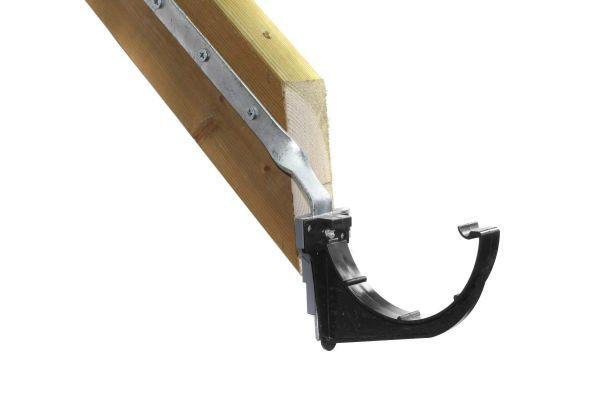

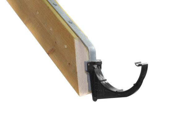

zoothorn Posted May 10, 2021 Author Posted May 10, 2021 4 hours ago, PeterW said: You need these to support it https://www.plasticdrainage.co.uk/rafter-top-gutter-bracket-2-9365.html Hi Peter- useful suggestion: so these fit to the underside of the overhanging roof? presumably not fixed to the topside thru felt etc, tho it would be 'surer' this way of course.. thanks for that- zH
zoothorn Posted May 10, 2021 Author Posted May 10, 2021 4 minutes ago, PeterW said: Yep usually under a rafter block or rafter tail. Which suggests they're usually fitted after the rafter.. but before the perpendicular roof surface, wood in my case, sandwiched in between-? Am I anywhere close?!

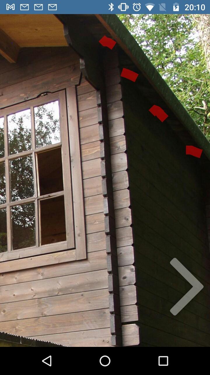

Onoff Posted May 10, 2021 Posted May 10, 2021 Crap attempt at marking up the pic but if you look underneath the side overhangs can you see the ends of the angled roof timbers? What the fascia board butts up to...
zoothorn Posted May 10, 2021 Author Posted May 10, 2021 @Onoff thx yup I guessed they went under here, well they cant go anywhere else (apart from onto the topside).. but they seem longer than my overhang here, so they'd either need cutting down, or, inserting somehow into the side structure of the top of the wall. But Im likely a country mile off!
Onoff Posted May 10, 2021 Posted May 10, 2021 (edited) 9 minutes ago, zoothorn said: @Onoff thx yup I guessed they went under here, well they cant go anywhere else (apart from onto the topside).. but they seem longer than my overhang here, so they'd either need cutting down, or, inserting somehow into the side structure of the top of the wall. But Im likely a country mile off! Difficult to see under there tbh...it's a dark photo. Cut down, re-drill and paint the cut end and drilled hole an option. Multi-tool the top of the wall and let them in without cutting the bracket maybe? Could you not just cut some timber blocks from say 4*2 and screw on from the inside. Cut them at an angle so they butt up to the roof timbers. Then affix the gutter brackets to those? Edited May 10, 2021 by Onoff

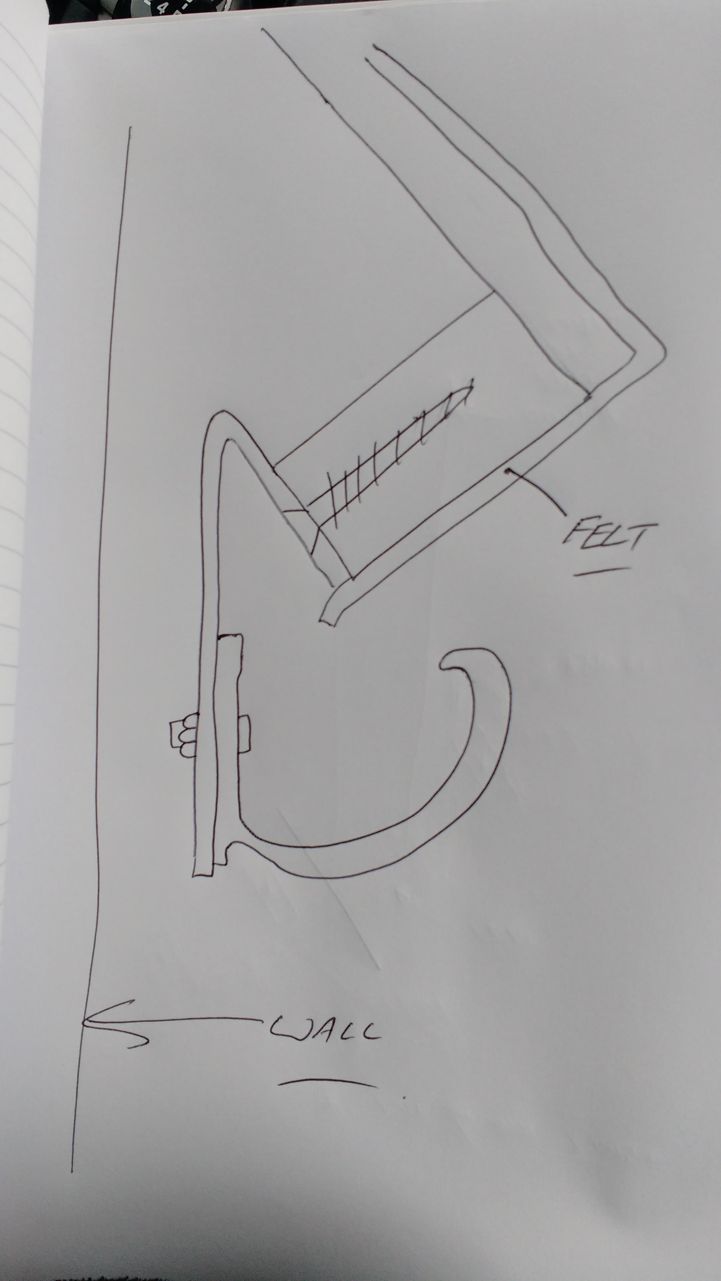

zoothorn Posted May 18, 2021 Author Posted May 18, 2021 Im still totally lost as to where these galv brackets attatch to. I know this might seem incomprehensible & simple to all. I am even starting to wonder if I have early dementia, because I seem to be getting stupider & stupider, job to job. Seriously (!?). I even watch a video (someone emailed or linked to- but I cannot find it) but even that makes no mention or shows where on the cabin they fix to. Im getting all sorts of conflicting info you see emailed from the supplier, twisted types suggested (but nowhere to fix them to: 'rafter they say'.. b b but I have no rafters along under here!). Or the flat types 'fix under roof tiles' they say (so under the felt, but on the roof top maybe-?!). Or with these 'fix perp to rafter' they say .. (what fkn rafters are you talking about supplier-?!). Ok. The only place I can think these [flat types- the twisty ones are an utter mystery] attatch to, in my cabin, in any normal log cabin.. is simply 'under the roof'. To the t&g roof, under the 10" overhang. Parralel to & onto one of these 24 (if there are say 24 all allong next to each other) t&g boards. So where Onoffs arrows are (but why any mention of 'rafters'?? why not just 'under roof'??). Could someone please help? I'm going insane & I think I need mental help. thx zH
zoothorn Posted May 18, 2021 Author Posted May 18, 2021 @Onoff no it doesn't unfortunately. I understand clearly this is how these two types of bracket would fit/ are specifically designed to fit, as your photo shows. I knew this days ago by watching a video clip, chap says flat one fixes from above to top of rafter, t'other one to the side of rafter. But I cannot understand how in the 1st top pic, anyone is supposed to gain access to the topside of a rafter, if guttering is an after-addition to the construction of a roof. Remove the whole roof 1st-?! well yes you could do this I guess. If A) I had such a rafter to contend with, I could simply just plump for the 2nd twisty type (& just forget the topside bracket.. even tho I cannot fathom how this is a feasable if the roof is built).. but I don't. And B) if I had such a rafter, & for some bizarre reason wanted to instead plump for the flat-top-mounted type, then I could rip off all my felt, remove all my t&g 24x (x2 for both sides = 48) roof boards, in order to gain access to the rafter top. Then replace the whole roof again. Now, I am stupid, yes I hear you all holler, but I aint -that- stupid. Leaving me the twisty type option. But I have no rafter in the underside-of-roof-eaves-area-each-side to fix it to! I need mental help- immediately. zH
joe90 Posted May 18, 2021 Posted May 18, 2021 Zoot can’t see much from your photo, we need a quick sketch of what you got, then we maybe be able to offer a solution!.
zoothorn Posted May 18, 2021 Author Posted May 18, 2021 6 minutes ago, joe90 said: Zoot can’t see much from your photo, we need a quick sketch of what you got, then we maybe be able to offer a solution!. True/ ok will take a better snap.. But I just thought log cabin roofs are A) so simple, B) so ubiquitous, C) i thought the simple construction of this type of roof (4x rafters.. parallel to the gutter/ roof ridge/ roof edge L &R > roof board nailed in perp the them).. was seen from the thread. I just thought log cabin roofs are so frequent, & so simple their roof construction was just known by all. I can only assume then that the reasoning was, that my rafters, are like std full size house rafters or something, numerous etc, plus 90*... to how mine actually 4 are running front-to-back.
zoothorn Posted May 18, 2021 Author Posted May 18, 2021 3 minutes ago, Onoff said: I THINK his detail is like this... 34 minutes ago, joe90 said: Zoot can’t see much from your photo, we need a quick sketch of what you got, then we maybe be able to offer a solution!. Yup- even better than an ipad photo in the rain. Great help Onoff. Ok so I could, I guess use the flat types.. & drill holes through the roof edge underside baton, also through wall toppermost bit (where Onoff's vertical wall line is at its highest point).. & stuff the sods in. ? Or fashion the roof edge so its vertical, by adding a wedge/ (pain to undo hundreds of felt nails @ edge tho, & the wedges will likely rot too). Or make short galv whatnots somehow myself? (I mean ffs.. why cant I just buy cabin roof mini gutter brackets already?!?) I just cant understand, if cabins are -so- ubiquitous, why these mini gutter metal brackets arent primarily designed for them, & not full size houses which never have mini gutters on (with soffit facia/ vertical boards most often just there, negating the need for any such bracket at all) with traditional rafters they seem only to be designed for: then how you would be expected to access/ get them onto the top of any such rafter anyway/ if so.. bemuses me. An utter farce, unless, Im being VERY thick..

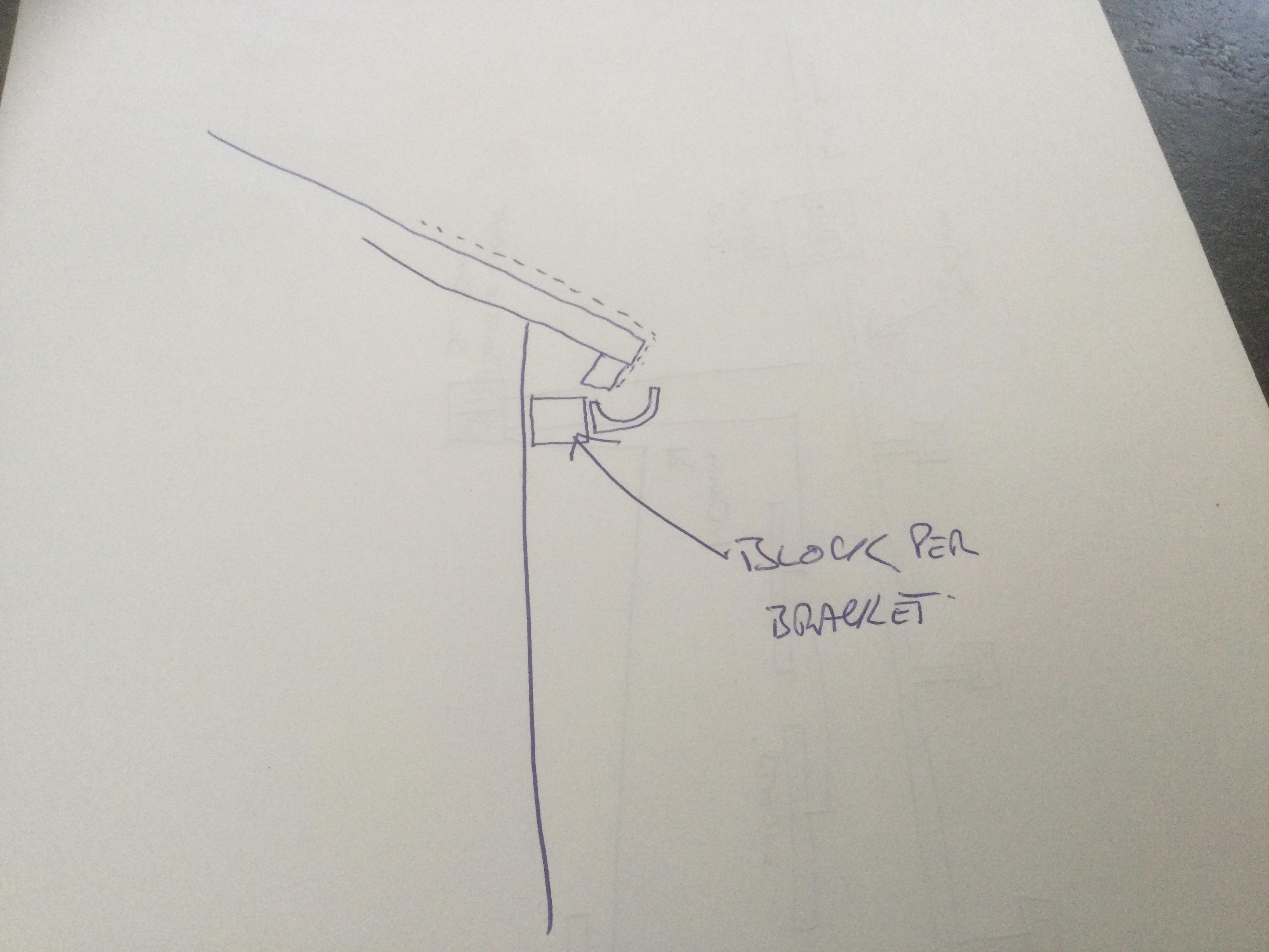

joe90 Posted May 18, 2021 Posted May 18, 2021 I think you will find the roof is so small most people don’t bother with guttering, I have none on my front porch. Probably best to just make blocks screwed to the side wall and the gutter fixed to those.

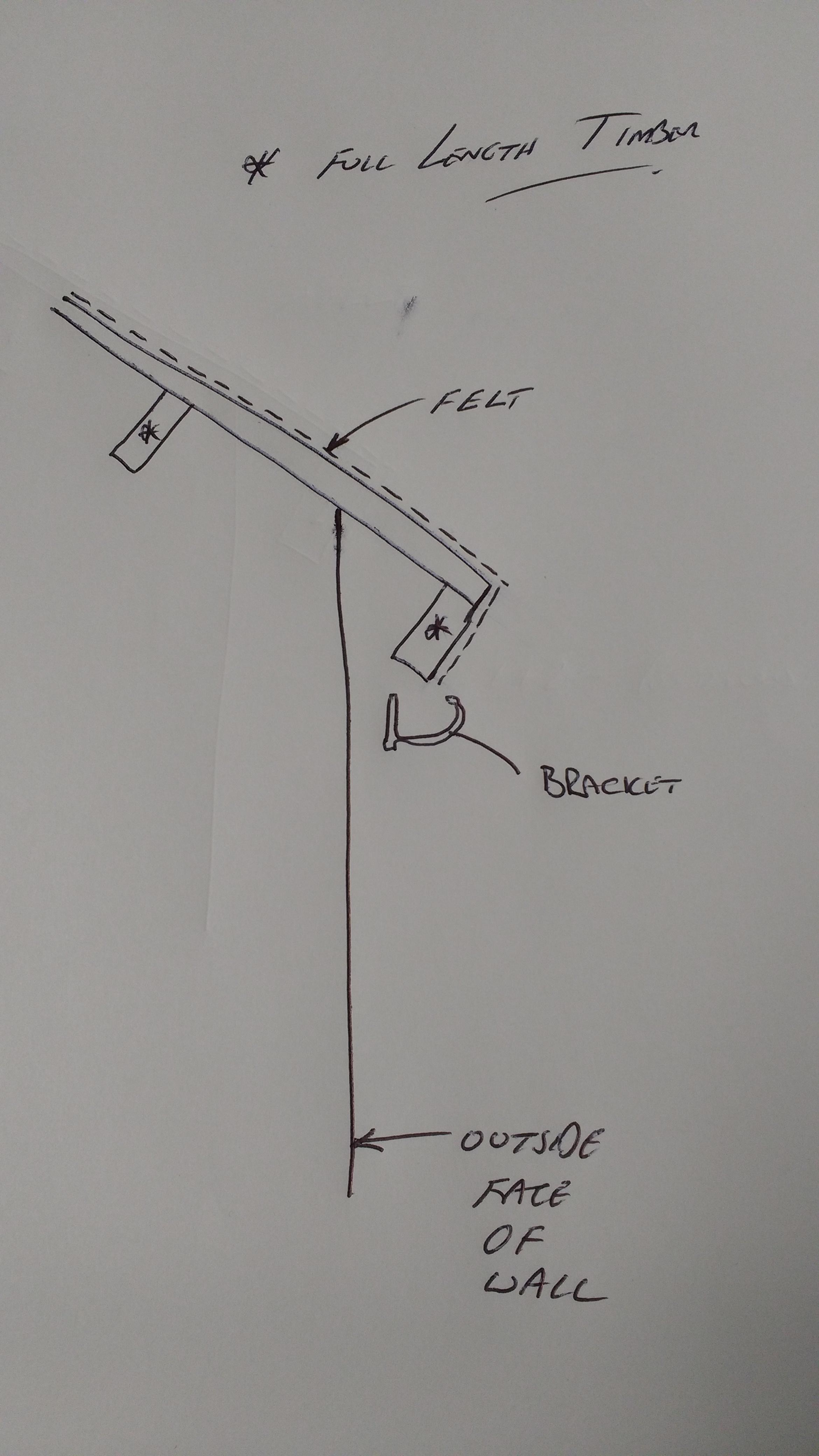

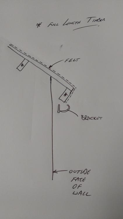

Onoff Posted May 18, 2021 Posted May 18, 2021 You have to be adaptable...and adapt what you have when you live in the cheap seats(like we do)! You could..... Run a continuous length of timber up underneath the roof overhang and affix your brackets to that. Something like: Just remember, you can do it, you're a winner!
joe90 Posted May 18, 2021 Posted May 18, 2021 6 minutes ago, Onoff said: You could... How do you get that screw in?, brackets in the way ?
Onoff Posted May 18, 2021 Posted May 18, 2021 1 hour ago, joe90 said: I think you will find the roof is so small most people don’t bother with guttering, I have none on my front porch. Probably best to just make blocks screwed to the side wall and the gutter fixed to those. At the front won't that block be fixing to thin air? 1 hour ago, joe90 said: How do you get that screw in?, brackets in the way ? Until he draws what he's got we won't know. Doable either at an angle or with a right angled drill attachment. Hold up Zoot I've an idea you might like, will sketch in a minute.
