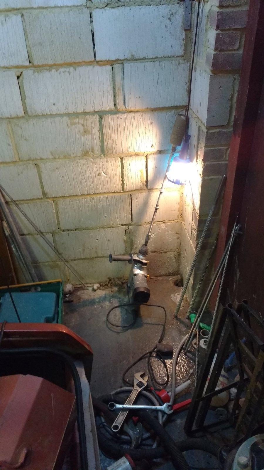

Onoff Posted August 14, 2023 Author Share Posted August 14, 2023 Gate related! Finally gotten around to running the gate wiring around the garage in some 50x50, galvanised, rat proof trunking. Even that's been a mission. Clearing stacked shelves to get access then the plugs wouldn't take in the lightweight blocks as so close to a joint. Resin anchors to the rescue! There's an SWA in there plus 2 20mm flexible conduits for comms, cameras etc to the gate. Got to shift a big, fully stacked shelf shortly to drill the floor slab again for a new incoming, underground supply. That and fit a new cu in there. 1 Link to comment Share on other sites More sharing options...

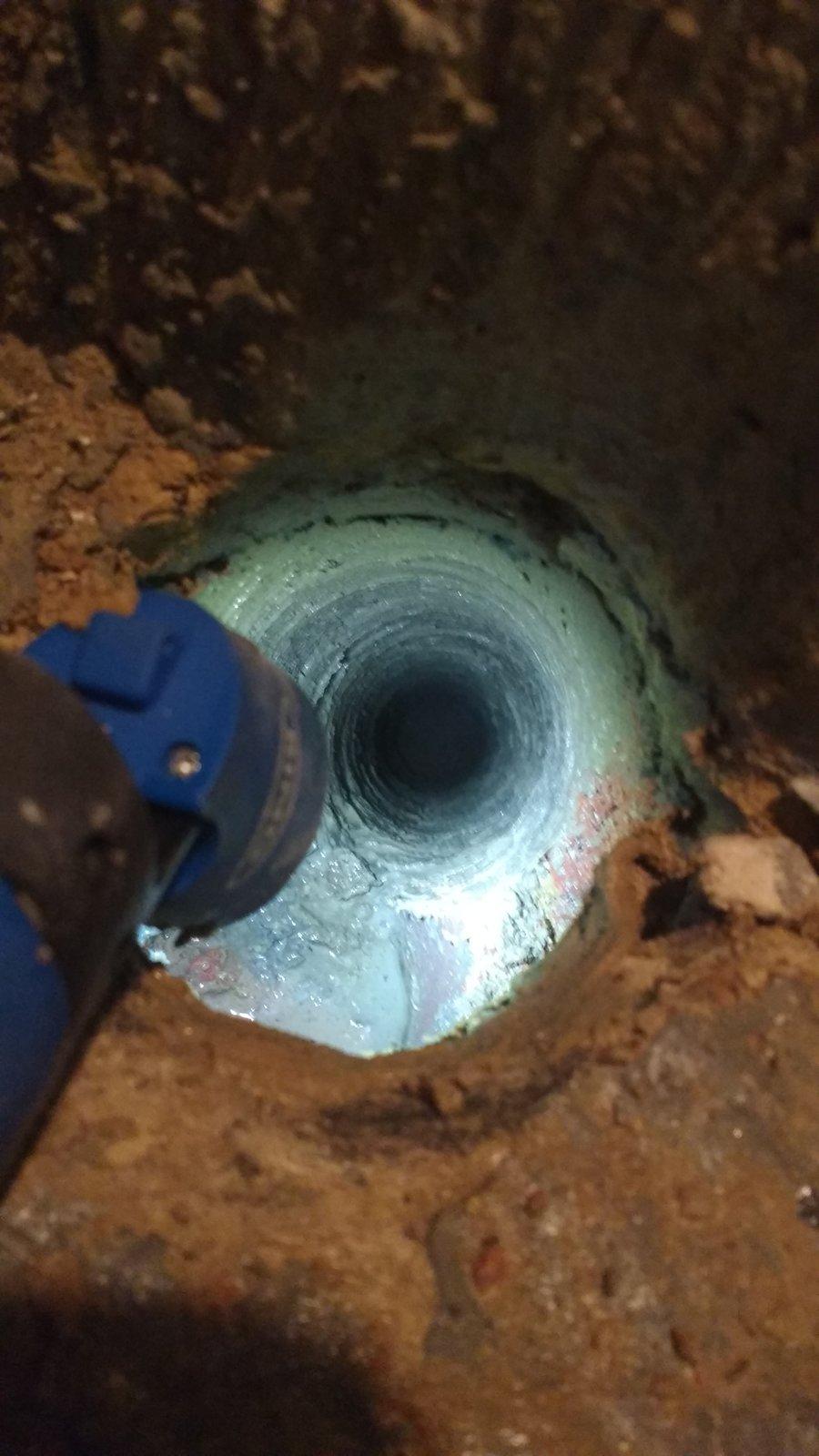

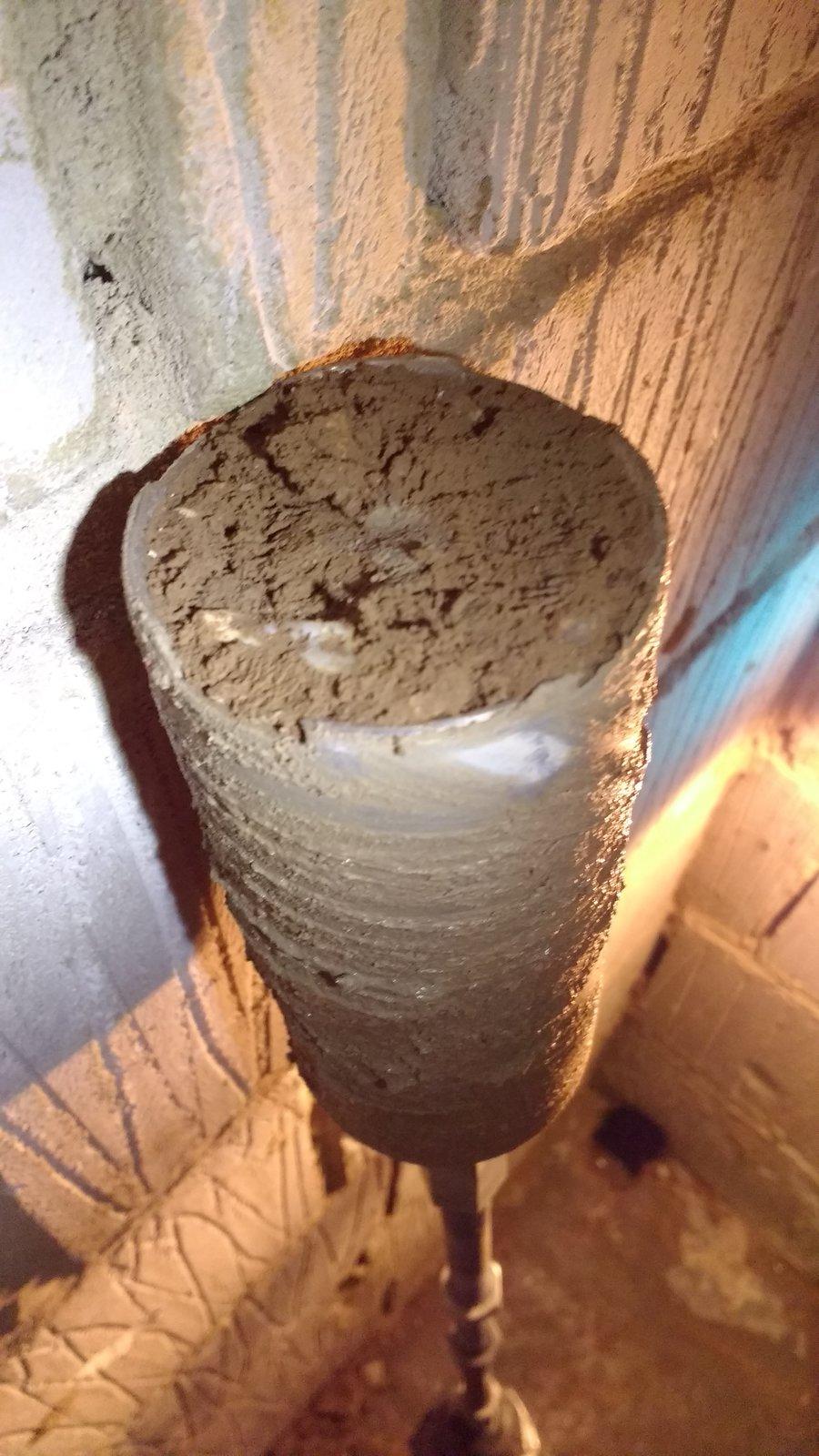

Onoff Posted August 15, 2023 Author Share Posted August 15, 2023 (edited) Got to repeat this the opposite of the garage now! That killed two SDS drills, a couple of 1m bits and nigh on me! Edited August 15, 2023 by Onoff 1 Link to comment Share on other sites More sharing options...
Big Jimbo Posted August 15, 2023 Share Posted August 15, 2023 Well done. That is a hell of a task. Link to comment Share on other sites More sharing options...
Onoff Posted August 15, 2023 Author Share Posted August 15, 2023 41 minutes ago, Big Jimbo said: Well done. That is a hell of a task. Did that one 3 years ago this month. Took me days! 1 Link to comment Share on other sites More sharing options...
