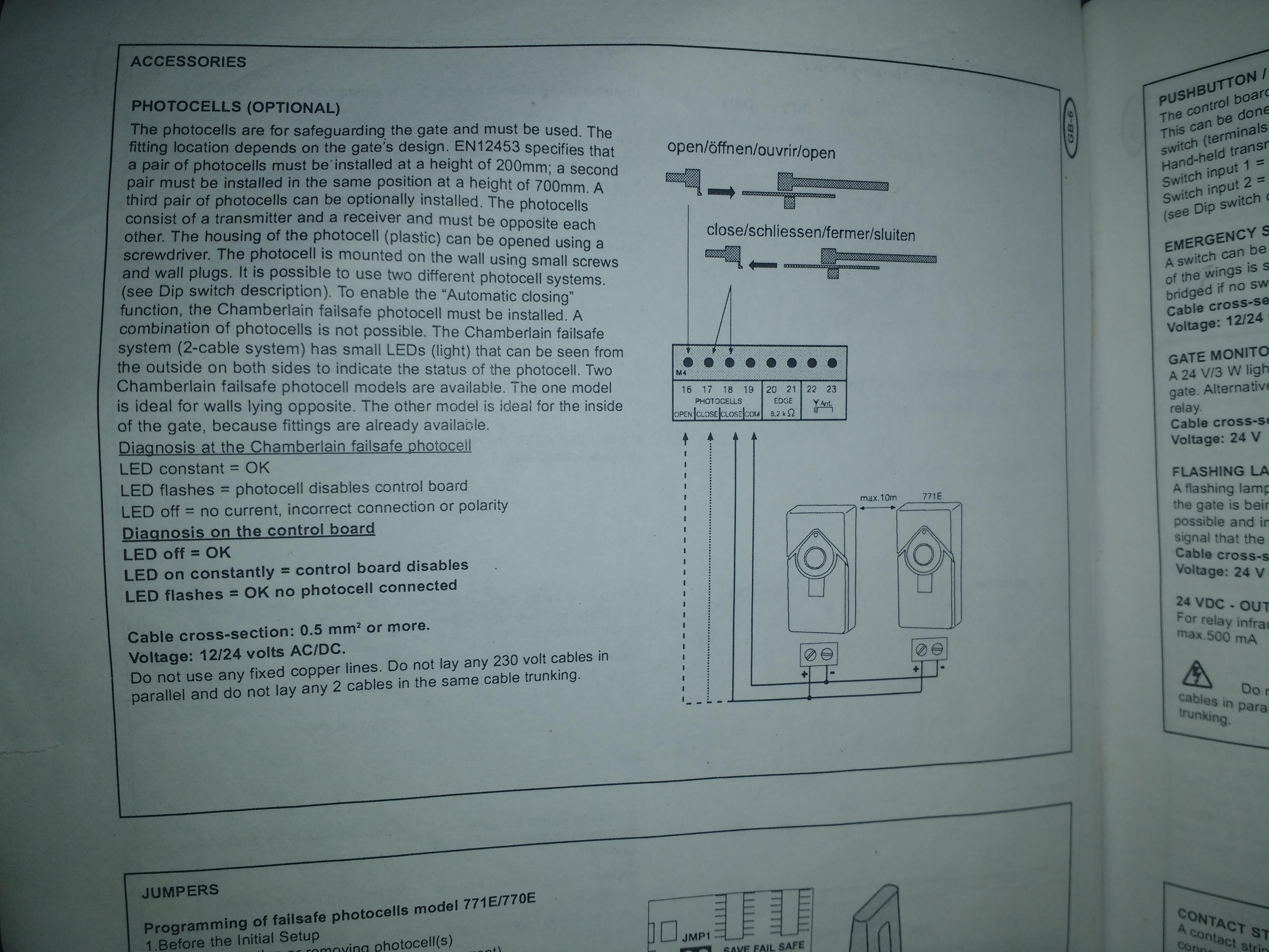

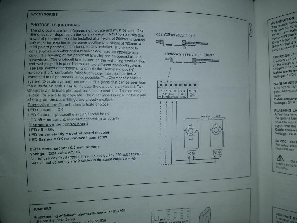

PeterW Posted August 14, 2022 Share Posted August 14, 2022 17 hours ago, Onoff said: The red & black is for a possible extra set of photocells. Usually the PIRs have a 4 or 5 core depending on how they’ve been wired - they need to switch something. Have you got a pair to check ..? Link to comment Share on other sites More sharing options...

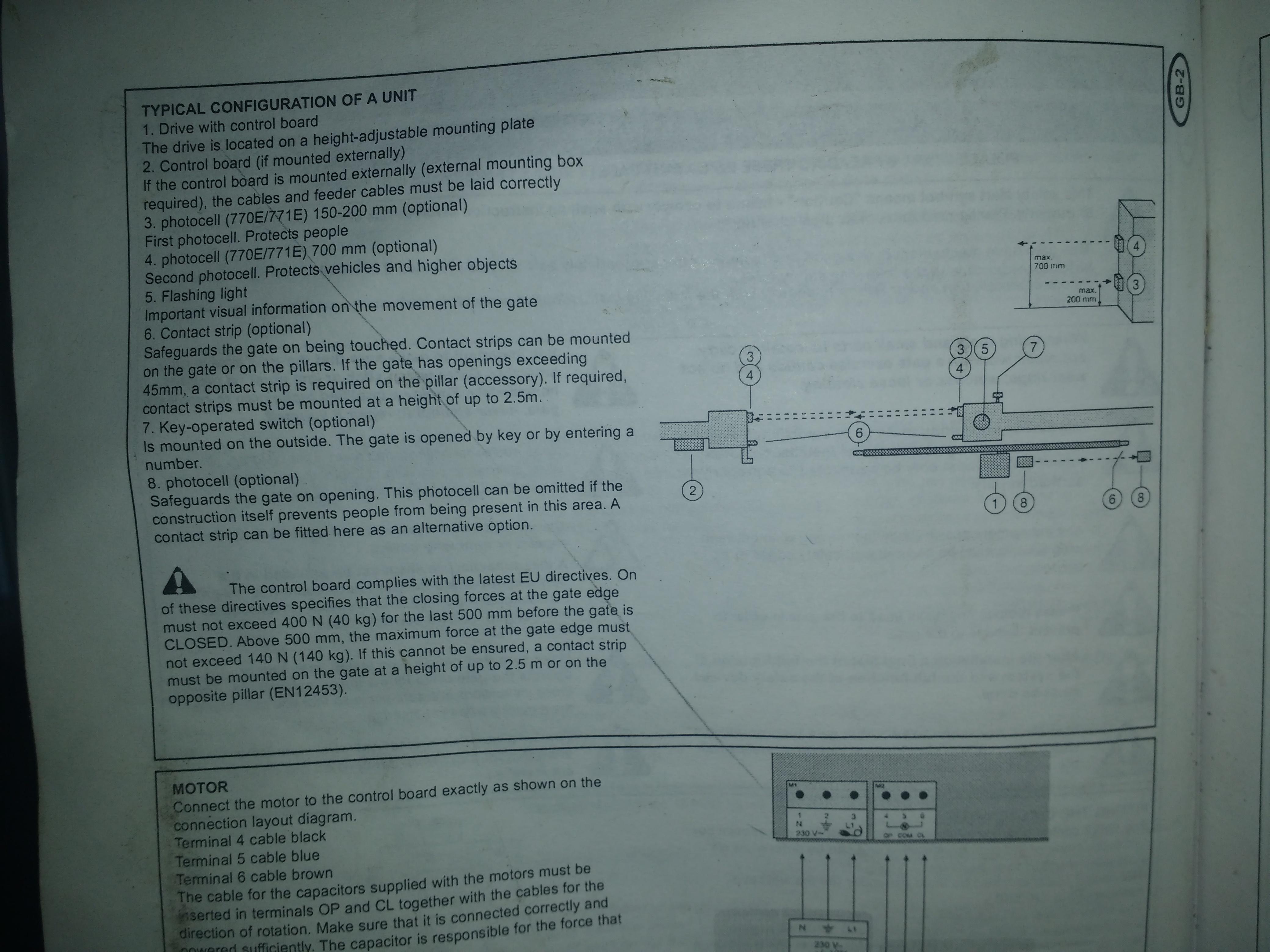

Onoff Posted August 14, 2022 Author Share Posted August 14, 2022 2 minutes ago, PeterW said: Usually the PIRs have a 4 or 5 core depending on how they’ve been wired - they need to switch something. Have you got a pair to check ..? Just two wires here to each photocell. I've had them connected to the board on the bench and checked their function: As it stands I've just got photocells 3 & 4 fitted. The aforementioned red/black is if I fit a pair of photocells as "8" on the diagram. I'll likely get some wireless contact strips instead: 1 Link to comment Share on other sites More sharing options...

Onoff Posted August 16, 2022 Author Share Posted August 16, 2022 Nearly done but for no white heatshrink! 😤 & redoing that 4,5,6 label... Link to comment Share on other sites More sharing options...
