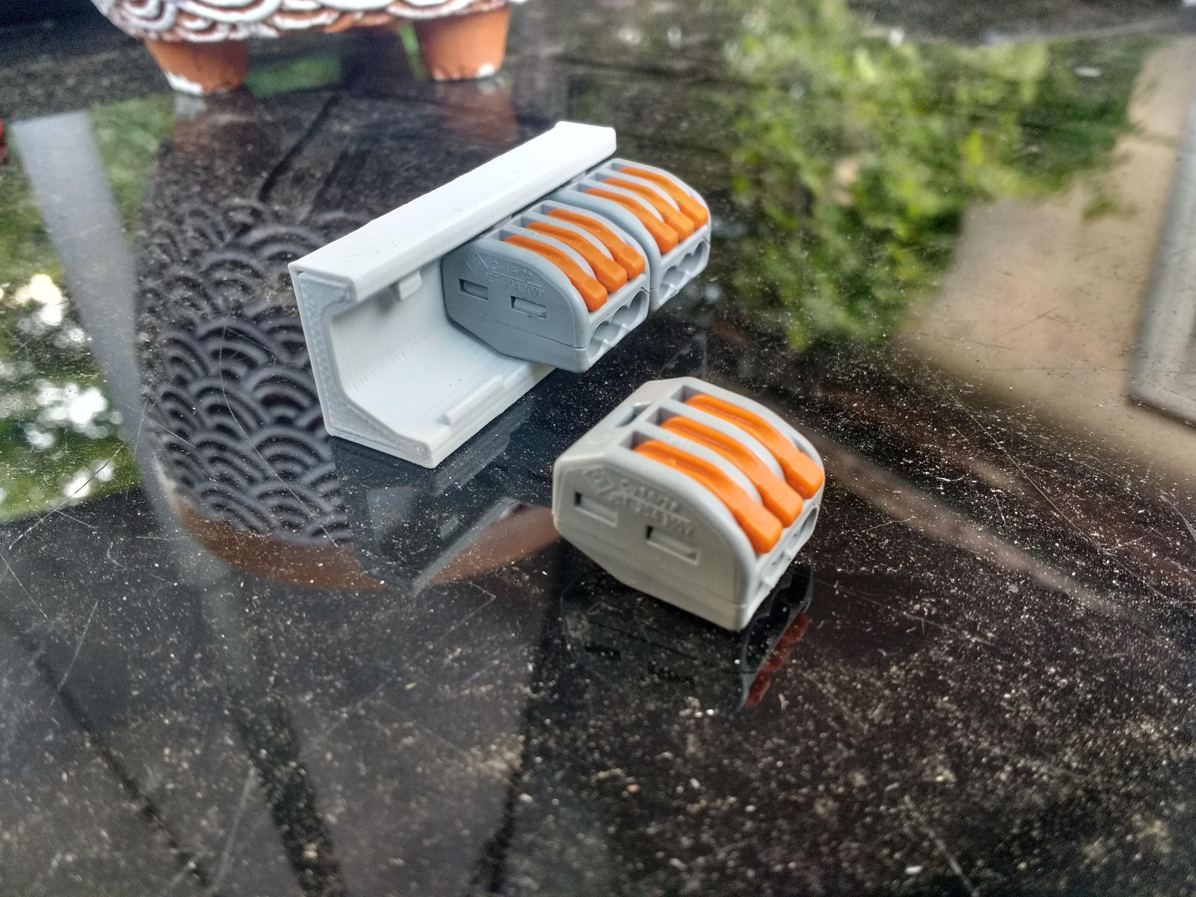

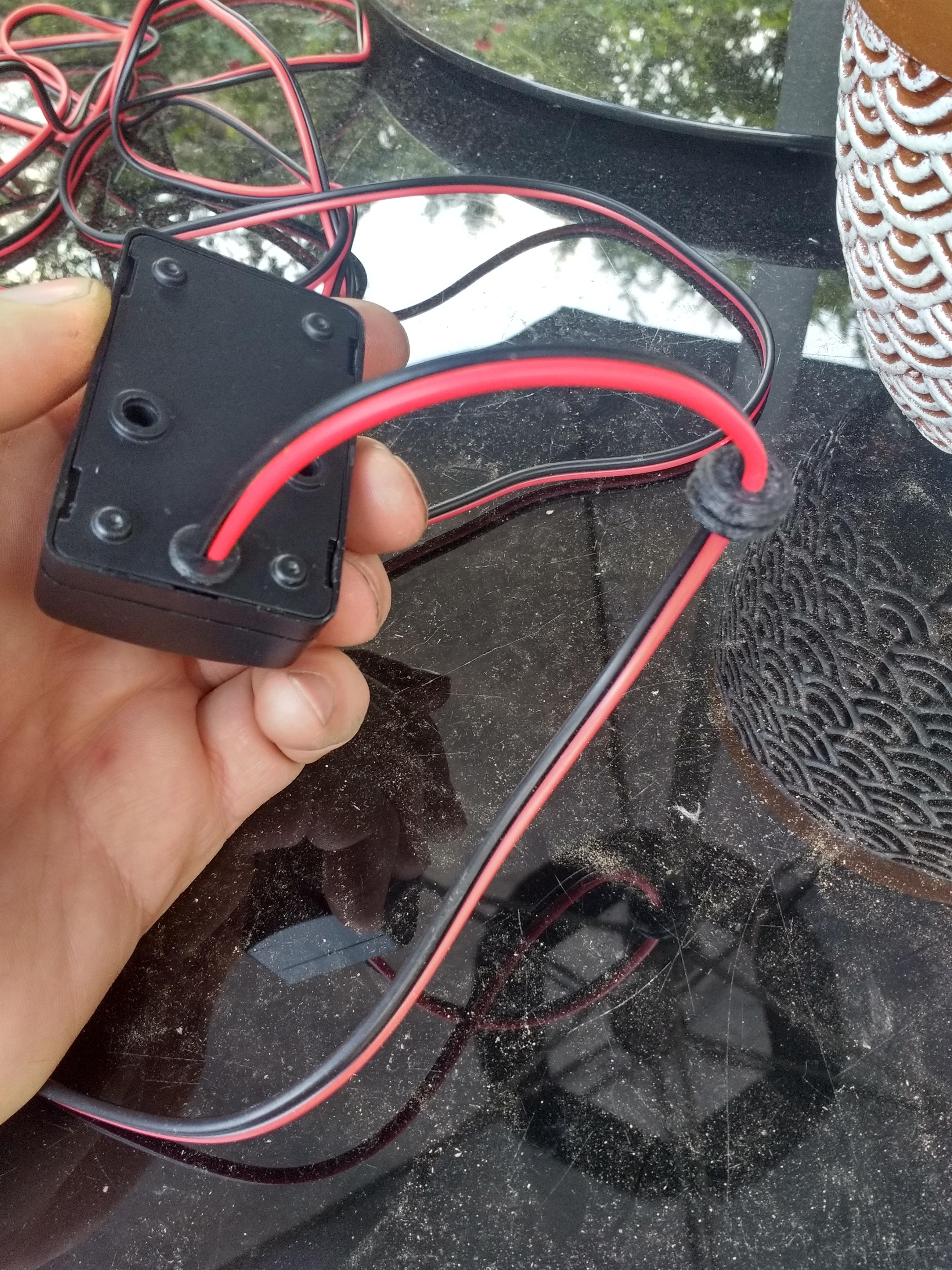

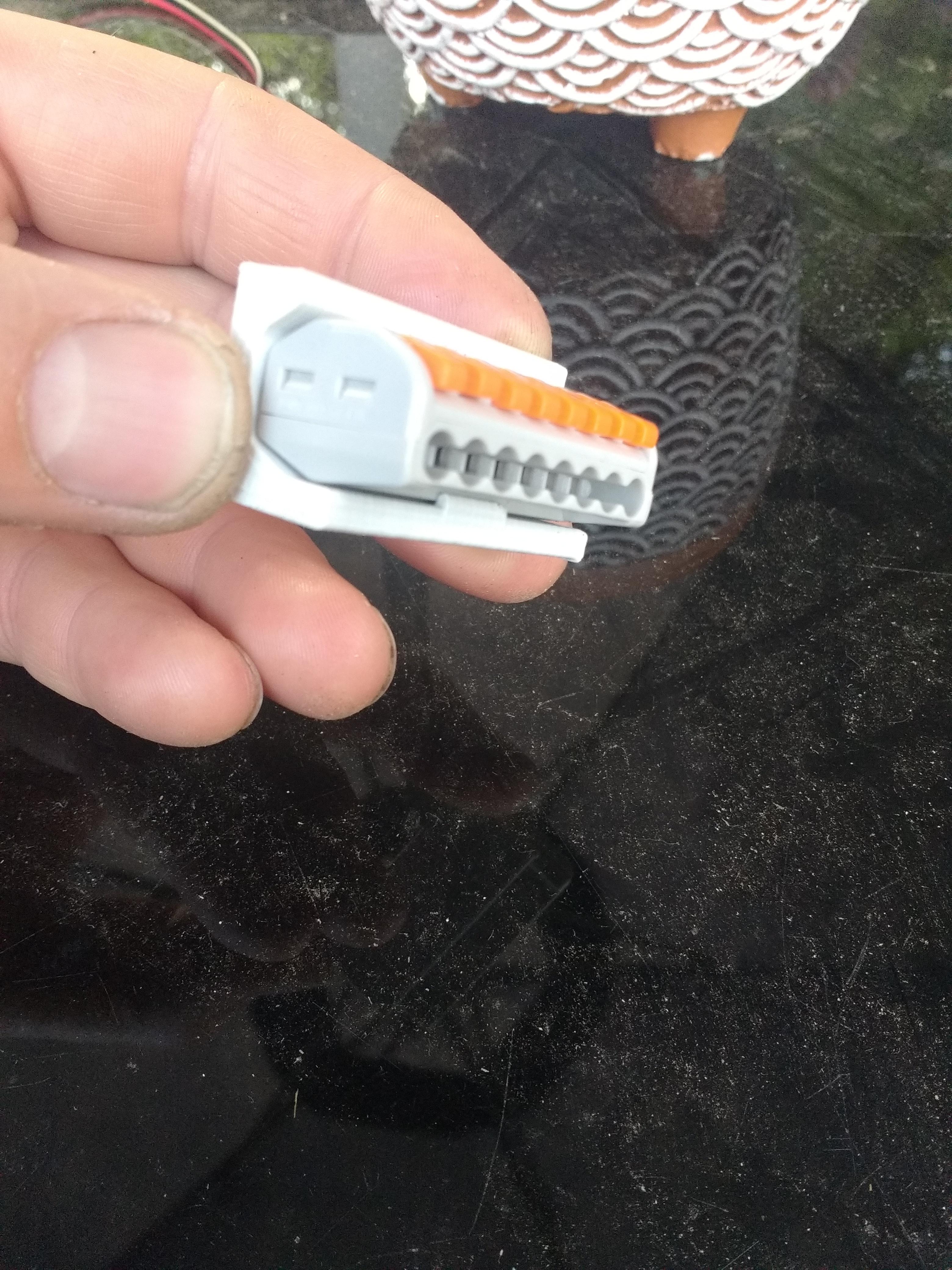

Onoff Posted August 3, 2022 Author Share Posted August 3, 2022 TPU grommets for my gate photocells, just to keep the creepy crawlies out. The one a couple of inches along was an oversize trial: Again for the photocell wiring, revisiting the WAGO holders in light grey PLA. A 3/3/3: For the 8-way FAKO though, the WAGO holder model needs tweaking. This one's a bit loose: Link to comment Share on other sites More sharing options...

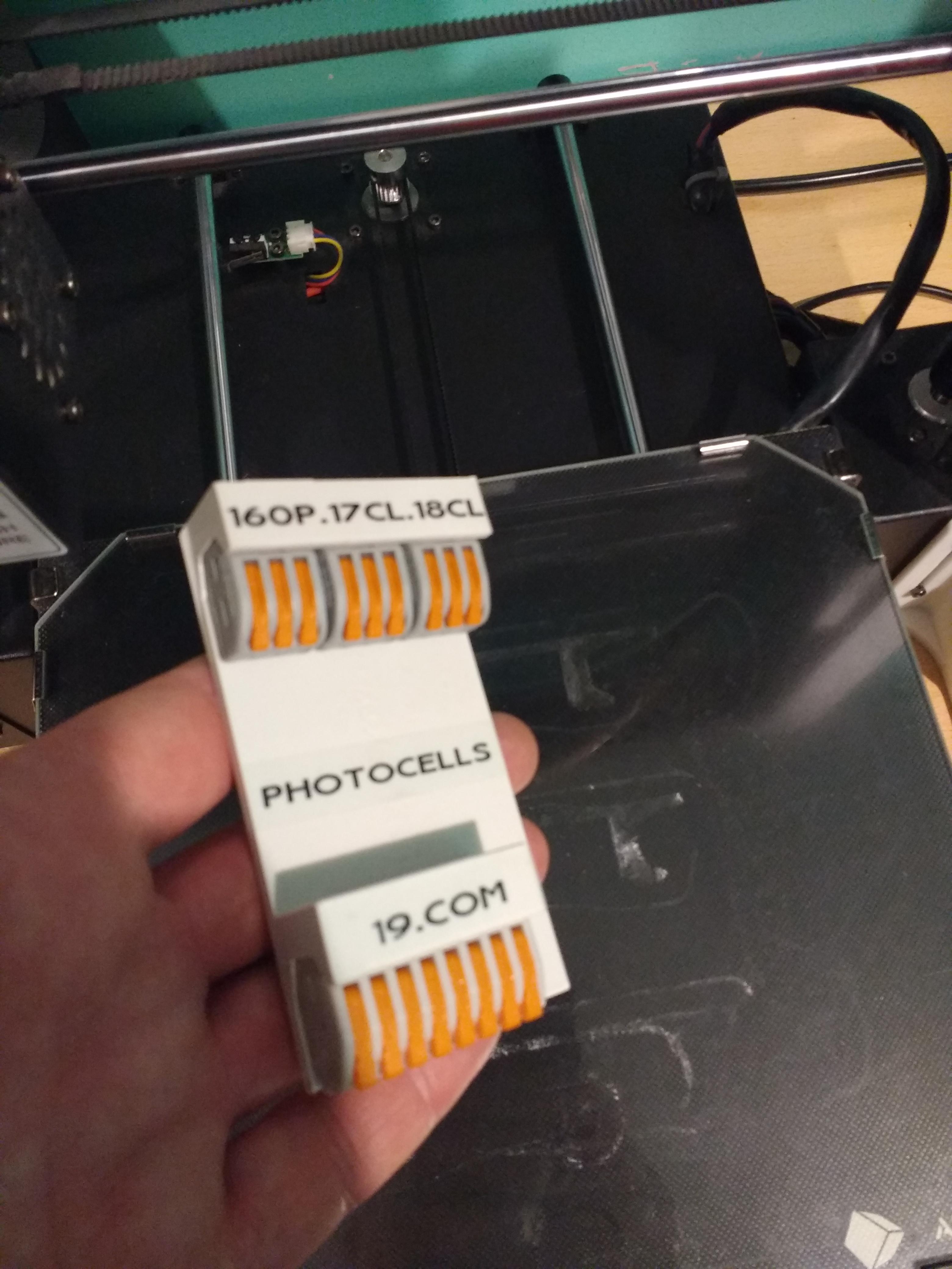

Onoff Posted August 4, 2022 Author Share Posted August 4, 2022 The 8-way FAKO is still a tad looser than I'd like it to be, but it'll do. Got a 12mm wide strip above, for a label: Link to comment Share on other sites More sharing options...
MikeSharp01 Posted August 4, 2022 Share Posted August 4, 2022 12 minutes ago, Onoff said: The 8-way FAKO is still a tad looser than I'd like it to be, but it'll do. Got a 12mm wide strip above, for a label: Love the clip, useful all over the place. Would a couple of counterbored holes in the top bar add the ability to screw the clips down when needed. Link to comment Share on other sites More sharing options...
Onoff Posted August 4, 2022 Author Share Posted August 4, 2022 1 hour ago, MikeSharp01 said: Love the clip, useful all over the place. Would a couple of counterbored holes in the top bar add the ability to screw the clips down when needed. Can do holes easily. The clip with the two on, in the last picture will just be 3M double sided taped or CT1'd to the RH side wall of the plastic enclosure. I like to keep all the penetrations in the bottom. Link to comment Share on other sites More sharing options...

MikeSharp01 Posted August 4, 2022 Share Posted August 4, 2022 2 hours ago, Onoff said: like to keep all the penetrations in the bottom. Great panel - then put some pilot holes in the bottom so they can be fixed down from underneath. Link to comment Share on other sites More sharing options...
Onoff Posted August 4, 2022 Author Share Posted August 4, 2022 (edited) 35 minutes ago, MikeSharp01 said: Great panel - then put some pilot holes in the bottom so they can be fixed down from underneath. No good, the "plate" with the two connectors on is going halfway up the enclosure side. All will be revealed soon...my soon! 😂 Edited August 4, 2022 by Onoff Link to comment Share on other sites More sharing options...

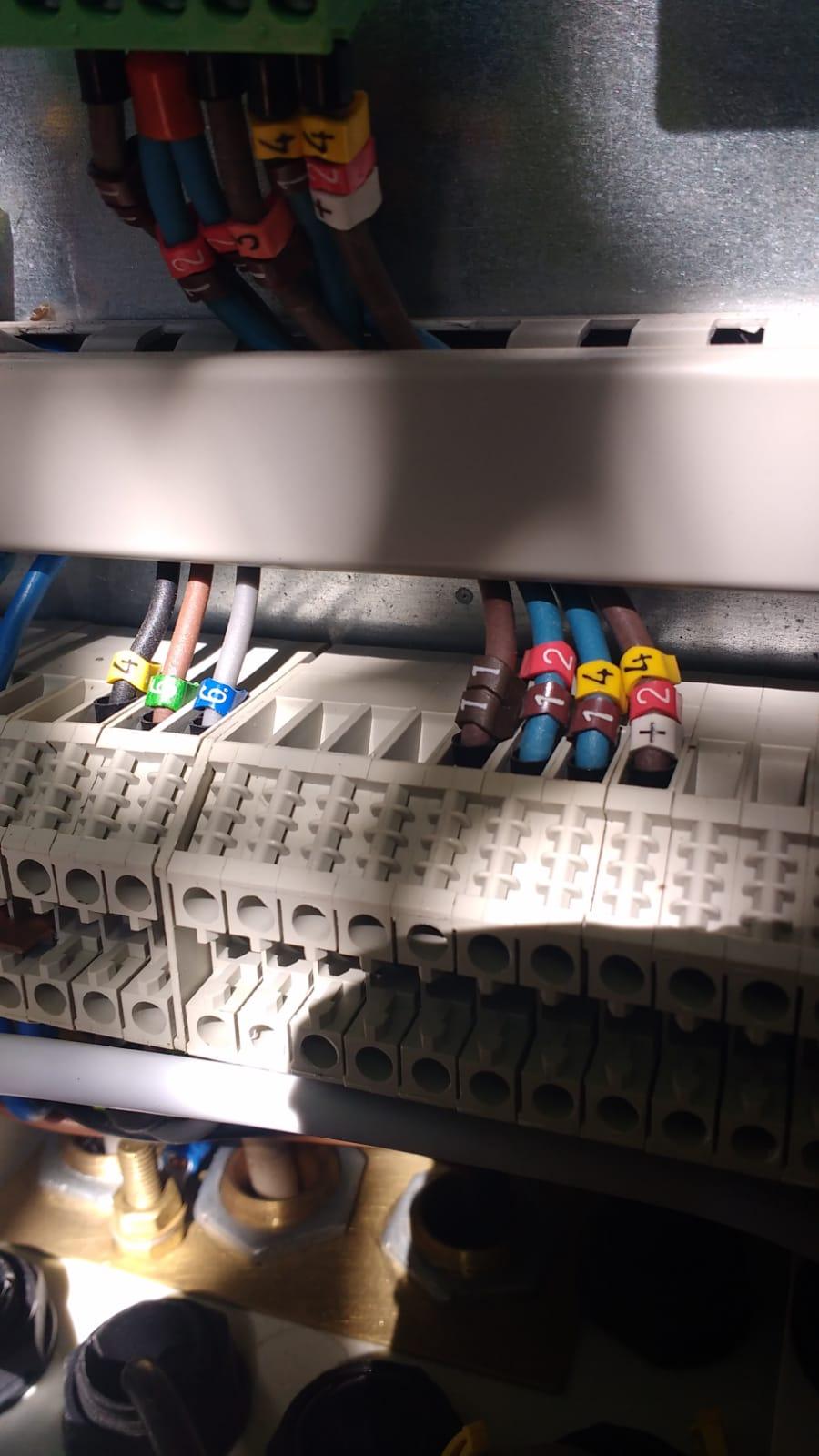

TonyT Posted August 4, 2022 Share Posted August 4, 2022 Like the ferrules in the panels- quality. Link to comment Share on other sites More sharing options...
MikeSharp01 Posted August 4, 2022 Share Posted August 4, 2022 41 minutes ago, TonyT said: Like the ferrules in the panels- quality. Proper bootlace ferrules and cable numbers - respect! Link to comment Share on other sites More sharing options...
Onoff Posted August 4, 2022 Author Share Posted August 4, 2022 3 hours ago, TonyT said: Like the ferrules in the panels- quality. One must maintain standards dear boy! 😂 My habit of stripping the wire, dipping in silicone grease and only then crimping the ferrule (or crimp) on, wins me no favours though. Link to comment Share on other sites More sharing options...
TonyT Posted August 4, 2022 Share Posted August 4, 2022 3 minutes ago, Onoff said: One must maintain standards dear boy! 😂 My habit of stripping the wire, dipping in silicone grease and only then crimping the ferrule (or crimp) on, wins me no favours though. Extra mark if the cable markers are not clip on! Link to comment Share on other sites More sharing options...
Onoff Posted August 4, 2022 Author Share Posted August 4, 2022 1 hour ago, TonyT said: Extra mark if the cable markers are not clip on! Link to comment Share on other sites More sharing options...

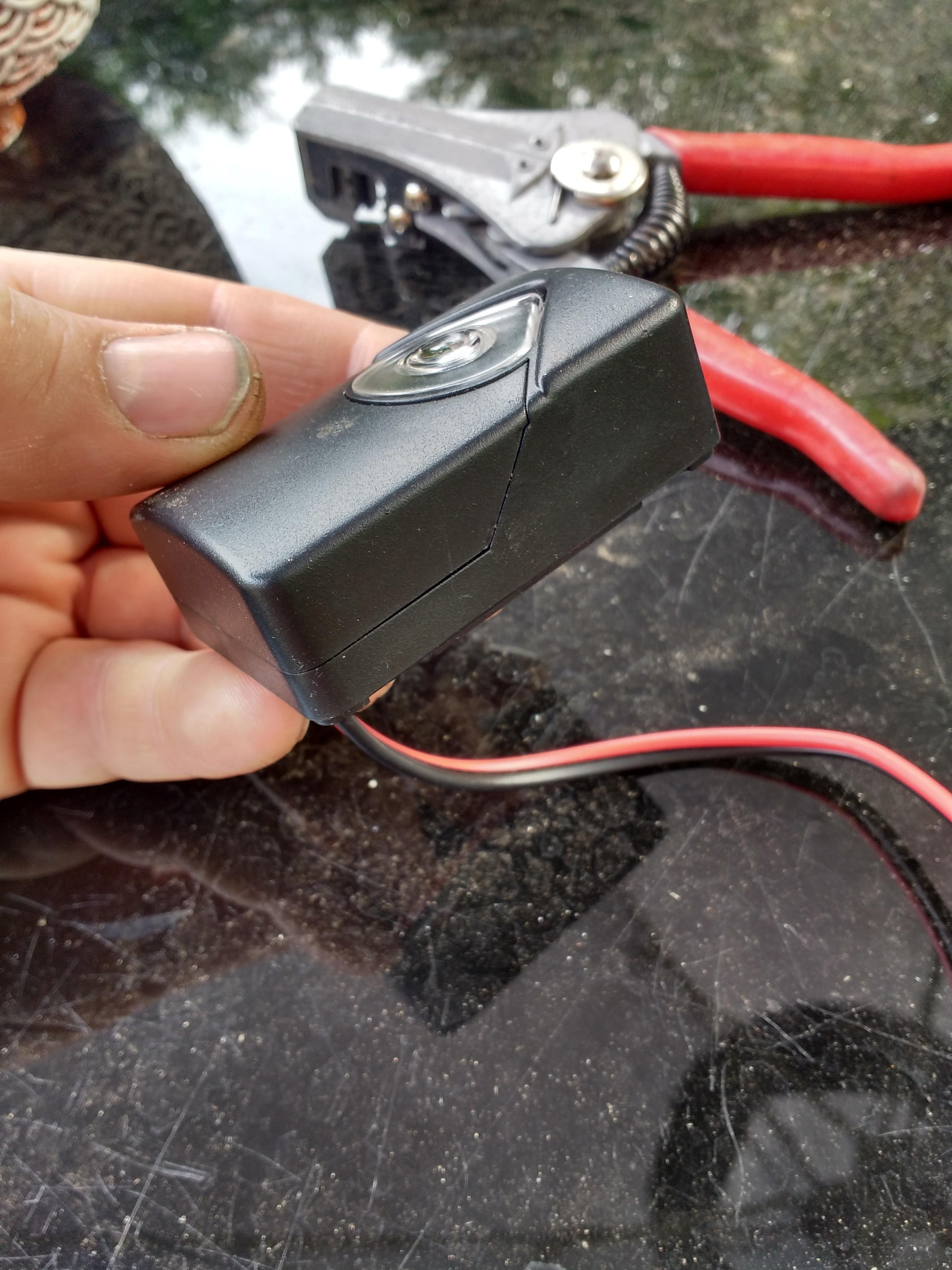

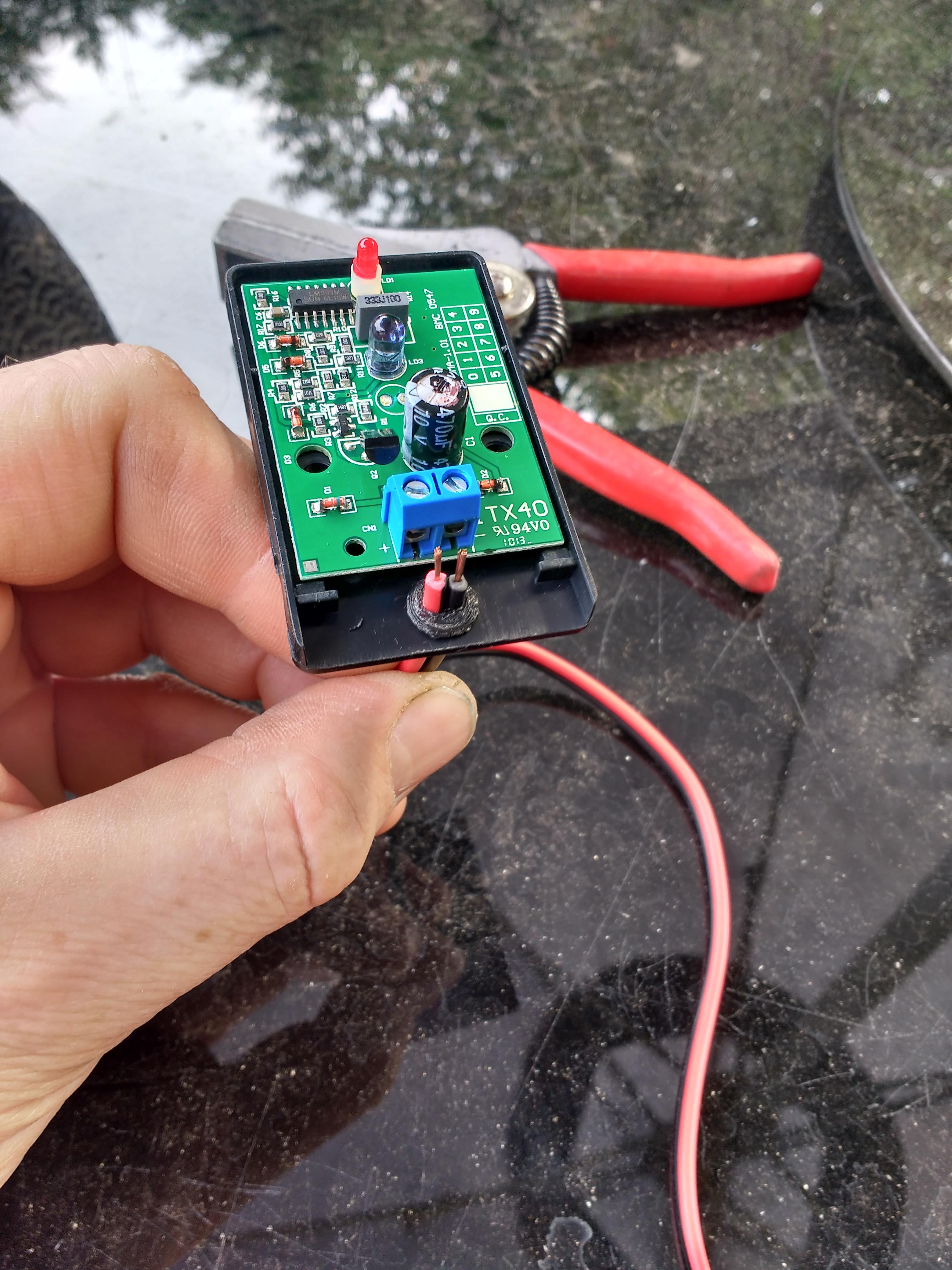

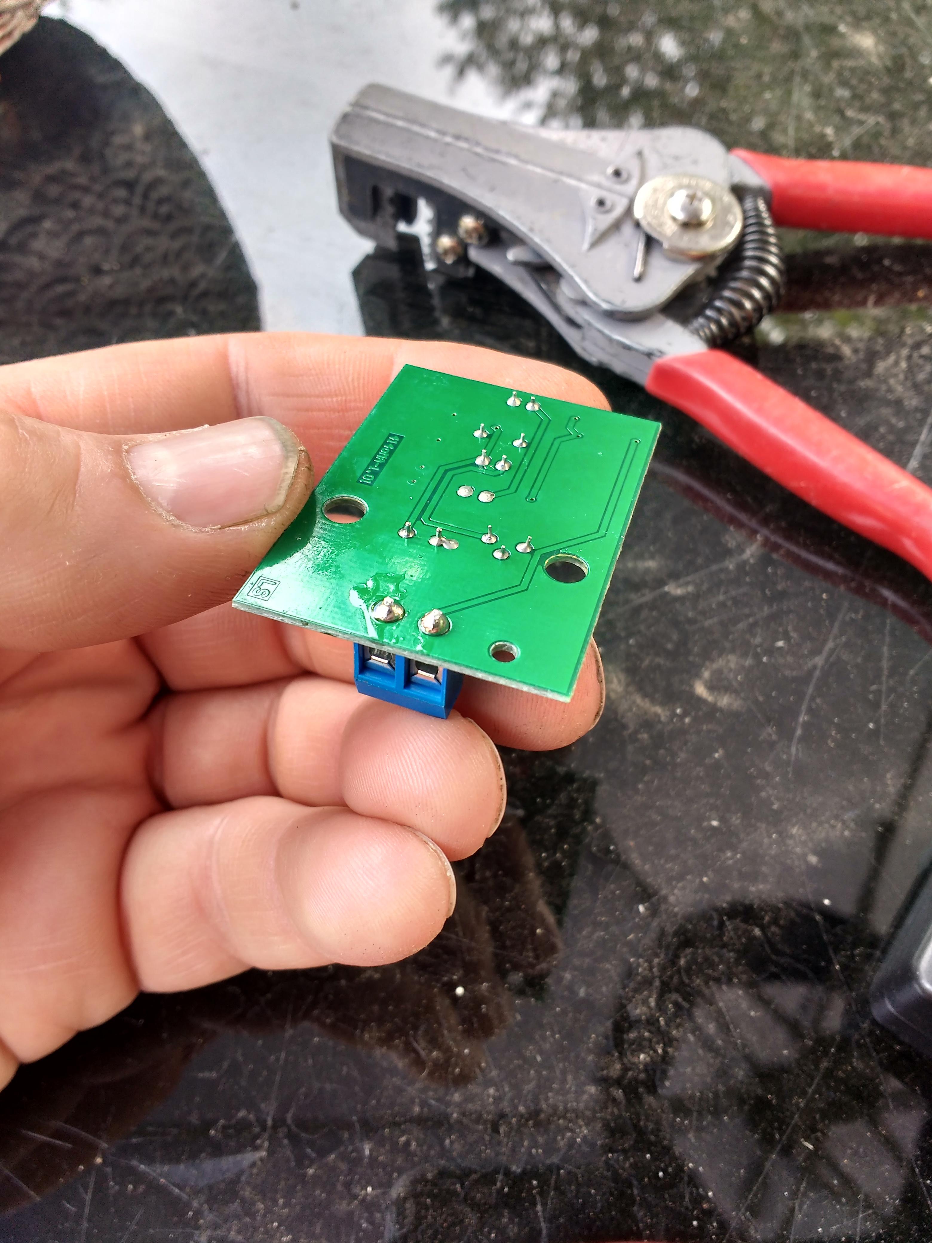

Onoff Posted August 4, 2022 Author Share Posted August 4, 2022 Not the most weather proof of things, these photocells. I'm wondering if giving both sides of the PCB a spray with some conformal coating / laquer will help prolong their life? 1 Link to comment Share on other sites More sharing options...

TonyT Posted August 4, 2022 Share Posted August 4, 2022 3 hours ago, Onoff said: Minus point for the terminals not having corresponding numbers as the conductors.😀 1 Link to comment Share on other sites More sharing options...
Onoff Posted August 4, 2022 Author Share Posted August 4, 2022 10 minutes ago, TonyT said: Minus point for the terminals not having corresponding numbers as the conductors.😀 When I find them I'll put them on! 😂 There's no "13" either...can't remember why...must consult the book of fag packet sketches... 1 Link to comment Share on other sites More sharing options...
