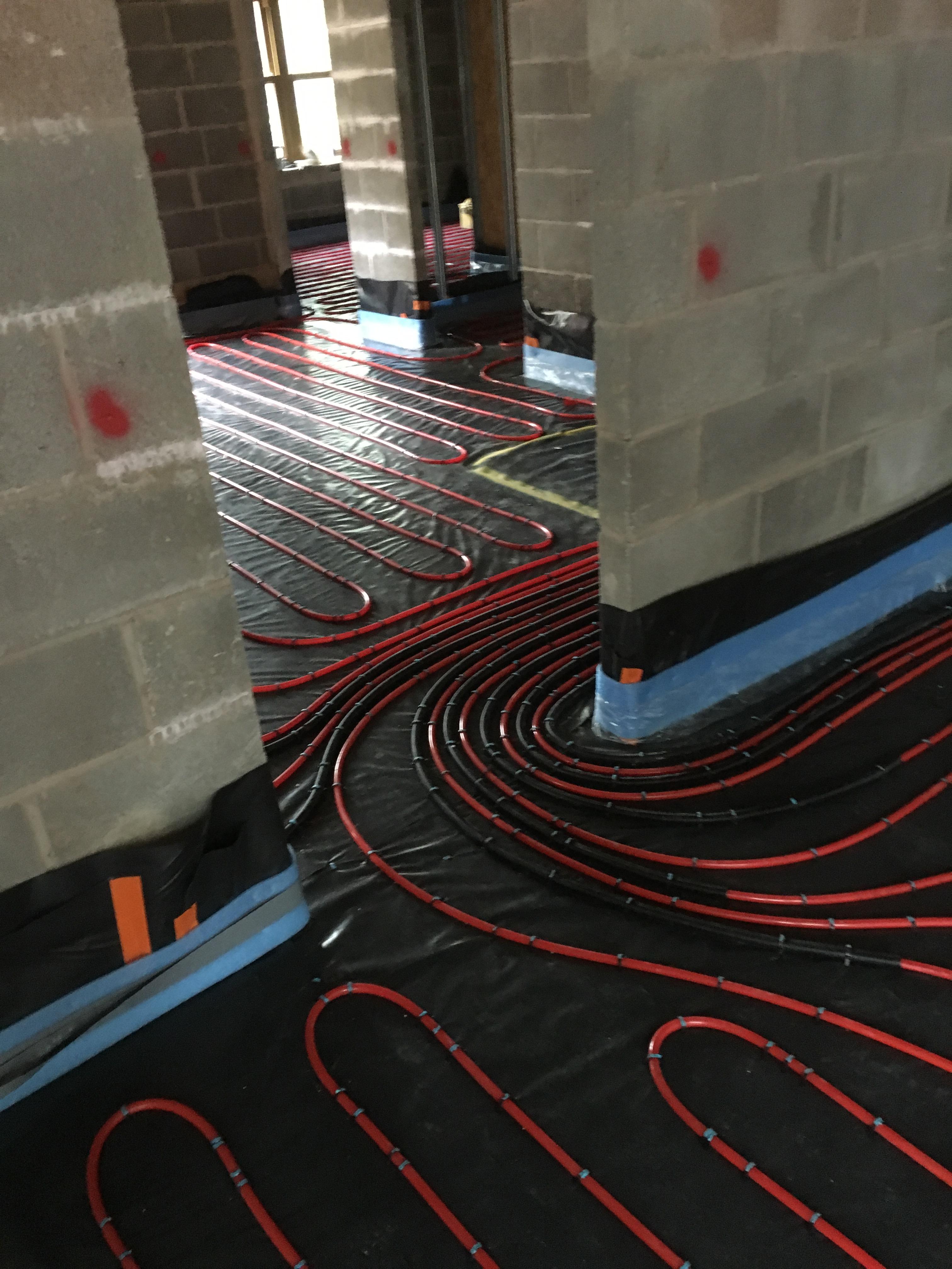

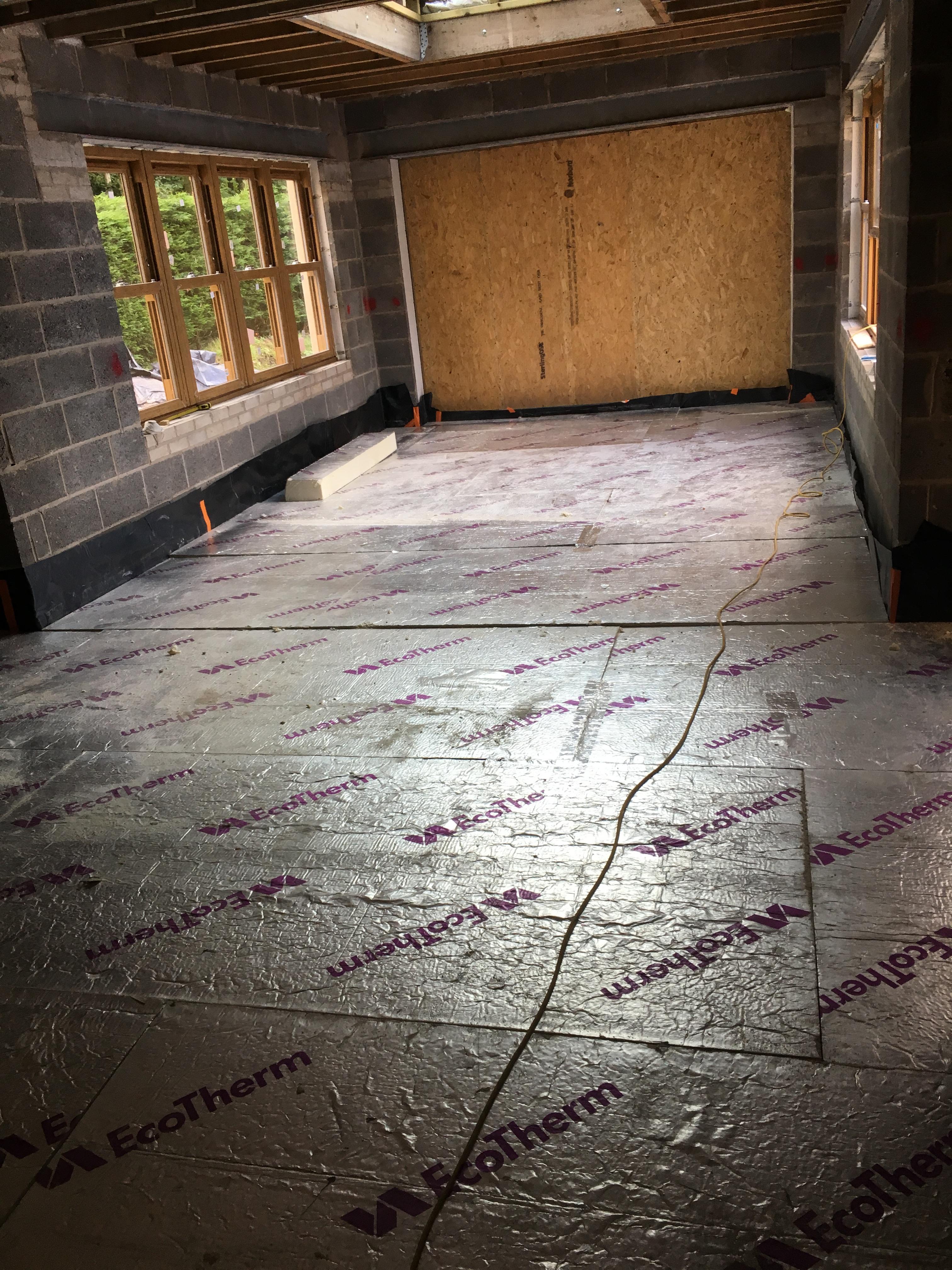

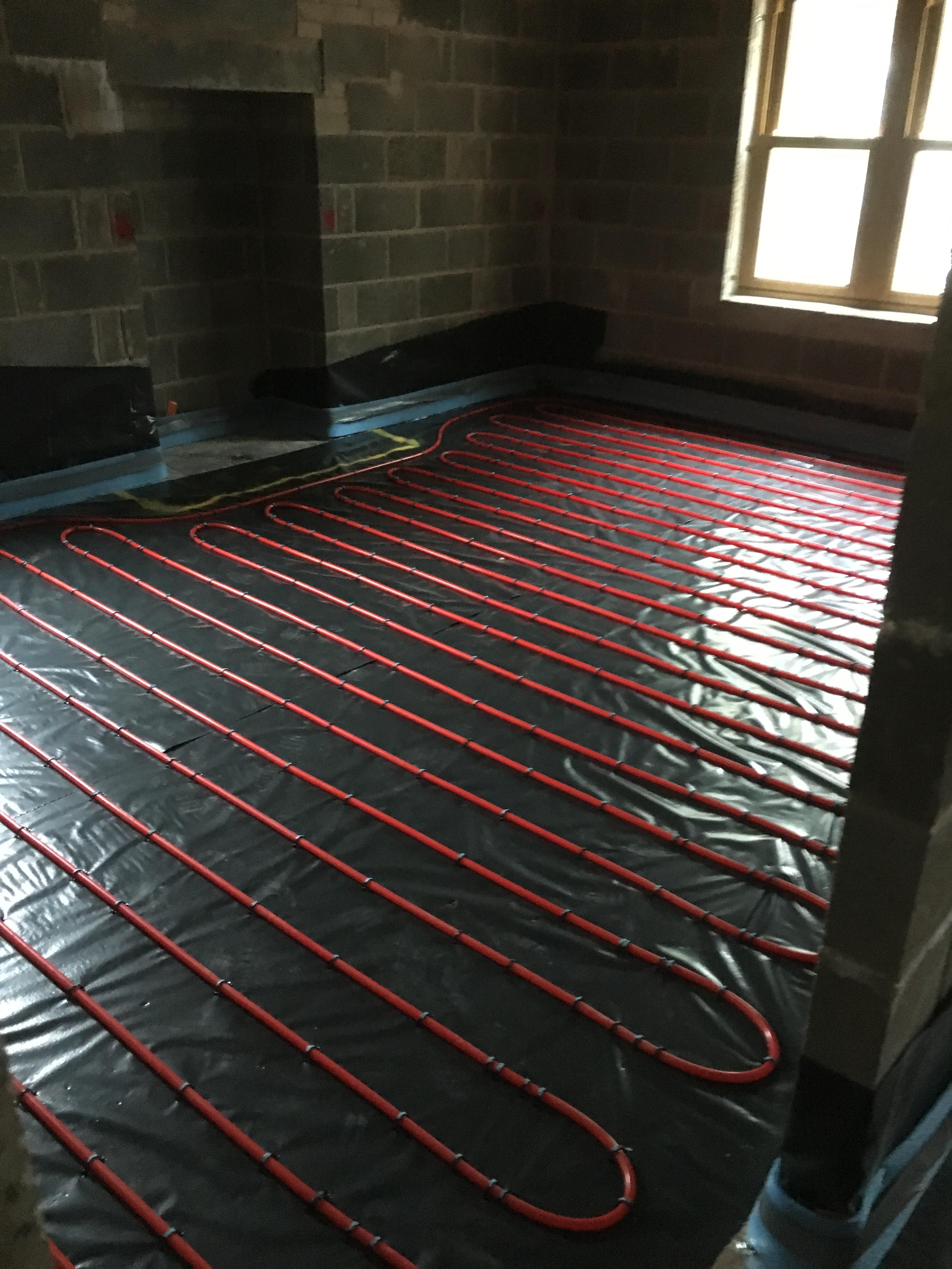

Ed_MK Posted June 5, 2018 Author Share Posted June 5, 2018 (edited) That looks a cracking job ! I must admit it does look a lot more solid with the block internal walls. Our timber came yesterday and its flying up ...as you can see from pics below these guys work like tornado's ...just a blur..makes me tired watching them LOL Going back to DPC ...In the last picture you can see the top of the trench block (with groundworkers DPC) and the other DPC that was laid under the frame....the "kicker bricks" the block laid directly under the frame was a CUT block and is about is around 150mm high I guess i am just nervous about how high I can actually sit gullys currently...and as these will be at exterior ground level i was trying to get my head around how high they could go and still remain 150mm below the RELEVANT dpc Edited June 5, 2018 by Ed_MK Link to comment Share on other sites More sharing options...

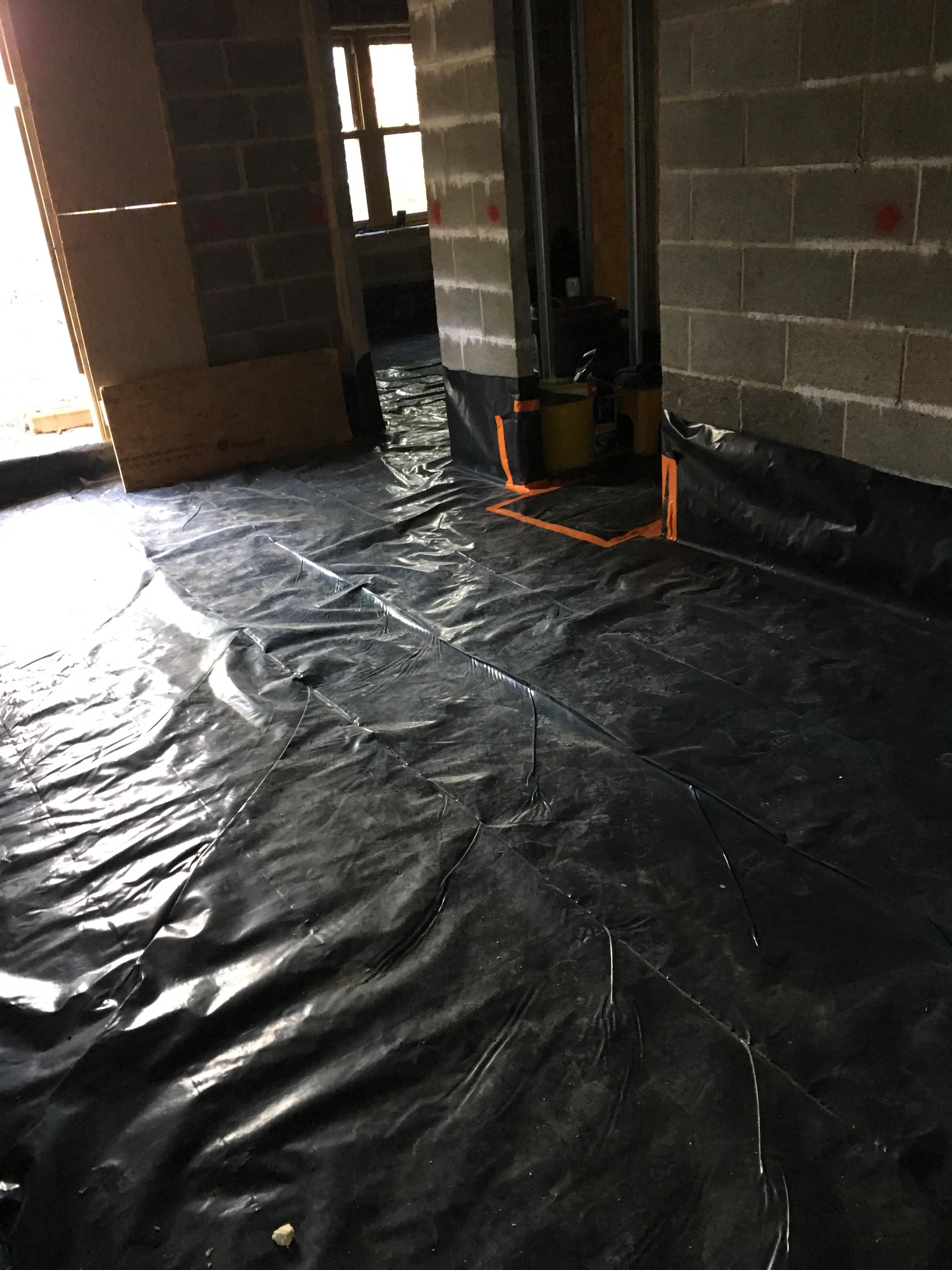

Onoff Posted June 11, 2018 Share Posted June 11, 2018 (edited) I feel your pain! My retrofit included digging down and building back up the bathroom floor. The original dpc, shown blue on the inner brick leaf was nom level with the original ffl and there were some damp issues. I put a dpm about a meter up the wall then came down under the 100mm PIR. The solid grey underneath is 25mm EPS and the dpm is sandwiched between that and the pir. The corners what with all the folding were a pig as I had to stagger it over footings I'd have loved to have had a blank canvas to design this out from the start! Your design above, are there cold bridging issues at the base? Edited June 11, 2018 by Onoff Link to comment Share on other sites More sharing options...

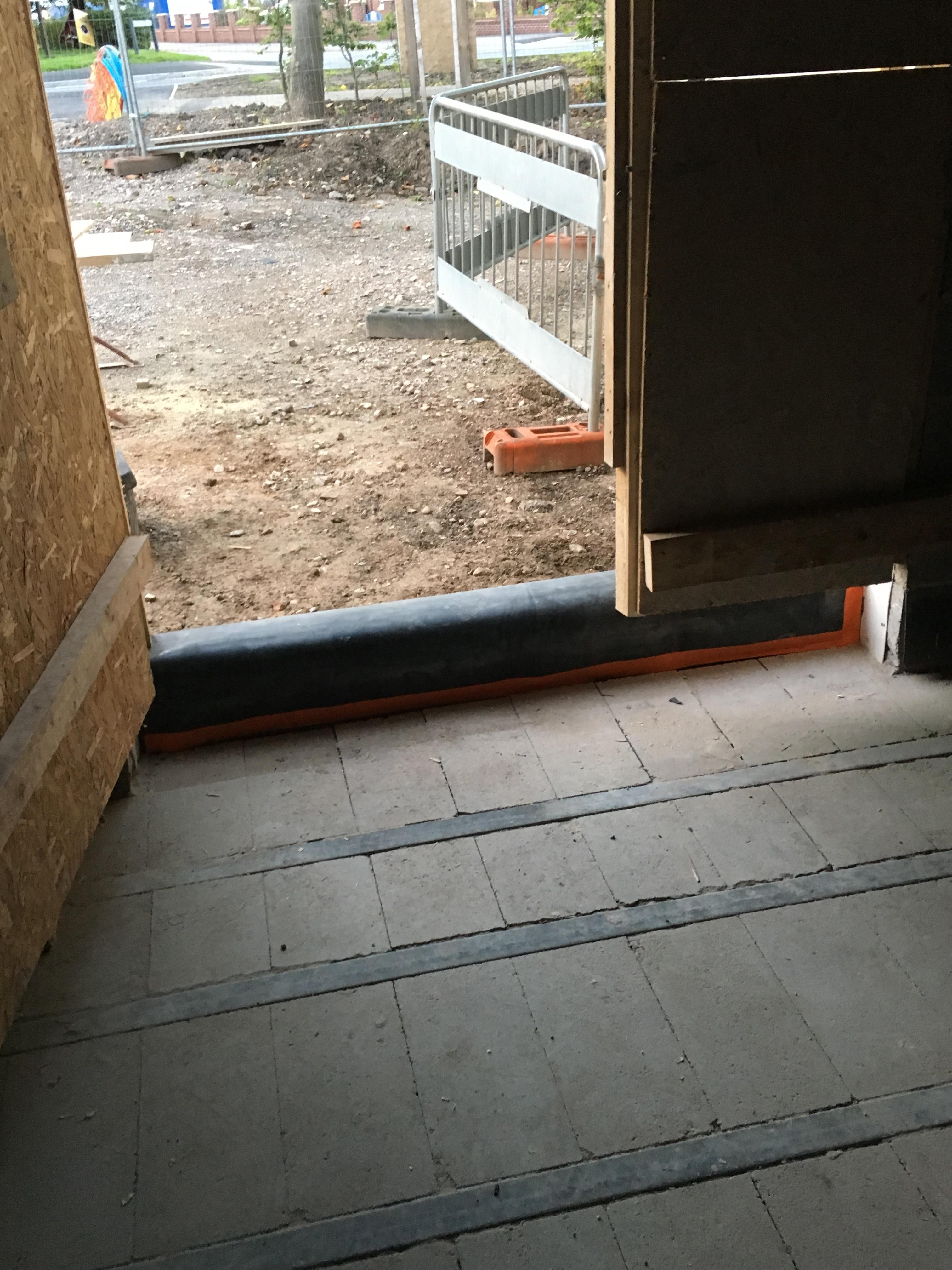

Ed_MK Posted June 16, 2018 Author Share Posted June 16, 2018 Well i have took some photos and measurements, what do you guys reckon 1. this is the view from INSIDE out through a doorway. the kicker bricks were all CUT with a saw, as i saw them doing it. they are about 160mm high ...including the bed now from the top of the B&B 2. This is the view from OUTSIDE at the same bit. The B&B must be about 160mm high too as the distance from the Trench block to the top of the kicker is around 320mm (note the waste pipe at the bottom) 3. I have LOADS of kicker bricks coming loose (see pic) and today and tomorrow I have been re-bedding them and pushing them back under the TF ...its like the mortar has turned to dust ...its sooooo flaky. I am no expert ...but i would say they have dried too fast ! but what can we do now (sigh) Link to comment Share on other sites More sharing options...
Brickie Posted June 18, 2018 Share Posted June 18, 2018 On 16/06/2018 at 19:47, Ed_MK said: a) does an all-round cavity tray effectively REPLACE the brick DPC ....or does this need to be there as well ? b) would it be a good idea to make sure all courses under the DPC/tray were engineering brick ? A/ it can do but it’s s bit fiddly to get it exactly bedded asyou would a 100mm strip of Dpc so for the sake of it I’d use 100mm too. We used to cut the membrane,slip the tray under & then staple the membrane back. PLEASE get some info from the TF company first before doing any of this though. B/ possibly,depends on how tough/frost rated your facing brick above is though. I’d make the muck a bit stronger,or use Sulphate resistant up to dpc. With your kickers coming loose,try dipping them in water before bedding them. This should kill the suction & stop them drying out too quick. Link to comment Share on other sites More sharing options...
