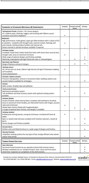

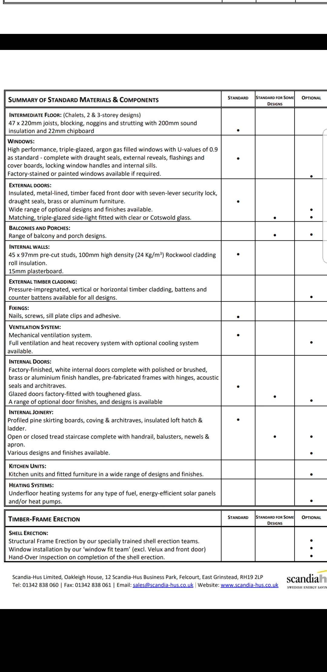

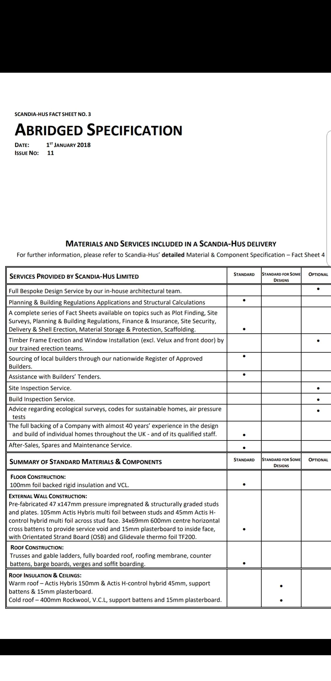

Jdyer Posted May 24, 2018 Author Posted May 24, 2018 7 hours ago, ultramods said: @Jdyerif it's a standard design that the company offers can you share the plans and cost? That would help us let you know if it's good value for money or not. Including spec (what's included and levels of insulation) The kit we found is from Scandia Hus - the Malthouse Barn https://www.scandia-hus.co.uk/designs/malthouse-barn/ They charge nearly 200k for the kit and erection with window installation. They estimate it would cost around 350k for the finished house. "The building set includes the timber frame with a fully boarded roof, insulation, 15mm plasterboard, plasterboard screws, Swedish triple glazed windows and external doors. Also included are Swedish internal doors, skirting boards, coving, architrave, insulated loft hatch and ladder, open or closed treat staircase and mechanical ventilation system. The estimate assumes standard foundation requirements and a good, above average specification of finishing materials. It does not include any external works, connecting to utilities or associated professional fees."
dpmiller Posted May 24, 2018 Posted May 24, 2018 I'm looking at that spec and thinking it's about 50k too dear?
PeterW Posted May 24, 2018 Posted May 24, 2018 @dpmiller that is the ScandiaHus premium ... There are kits that are not as good but the quality is there on these but you do pay a premium. Their estimate is probably on the high side too - last time I saw one of these it was something mad like £45k for kitchen and £30k for bathrooms in the end finished price.
ultramods Posted May 24, 2018 Posted May 24, 2018 Seams like an expensive way to save on architect fees. Have you gone to any other timber frame companies and said that you like that design and can they do one similar? My Architect (technologist) was £3300 for planning application drawings, detailed building warrant drawings and obtaining the planning and building warrants. SE was £1500.
NSS Posted May 24, 2018 Posted May 24, 2018 3 hours ago, Jdyer said: The kit we found is from Scandia Hus - the Malthouse Barn https://www.scandia-hus.co.uk/designs/malthouse-barn/ They charge nearly 200k for the kit and erection with window installation. They estimate it would cost around 350k for the finished house. "The building set includes the timber frame with a fully boarded roof, insulation, 15mm plasterboard, plasterboard screws, Swedish triple glazed windows and external doors. Also included are Swedish internal doors, skirting boards, coving, architrave, insulated loft hatch and ladder, open or closed treat staircase and mechanical ventilation system. The estimate assumes standard foundation requirements and a good, above average specification of finishing materials. It does not include any external works, connecting to utilities or associated professional fees." We used Scandia Hus, but deleted many of the items you mention (stairs, windows/doors, MVHR, internal doors, skirtings etc) not only to save money but to improve choice. Could we have got a cheaper TF kit? Almost certainly. If I was ever to do another self-build would I invite Scandia-Hus to tender again? Absolutely. As @PeterWsuggests, quality comes at a premium.
