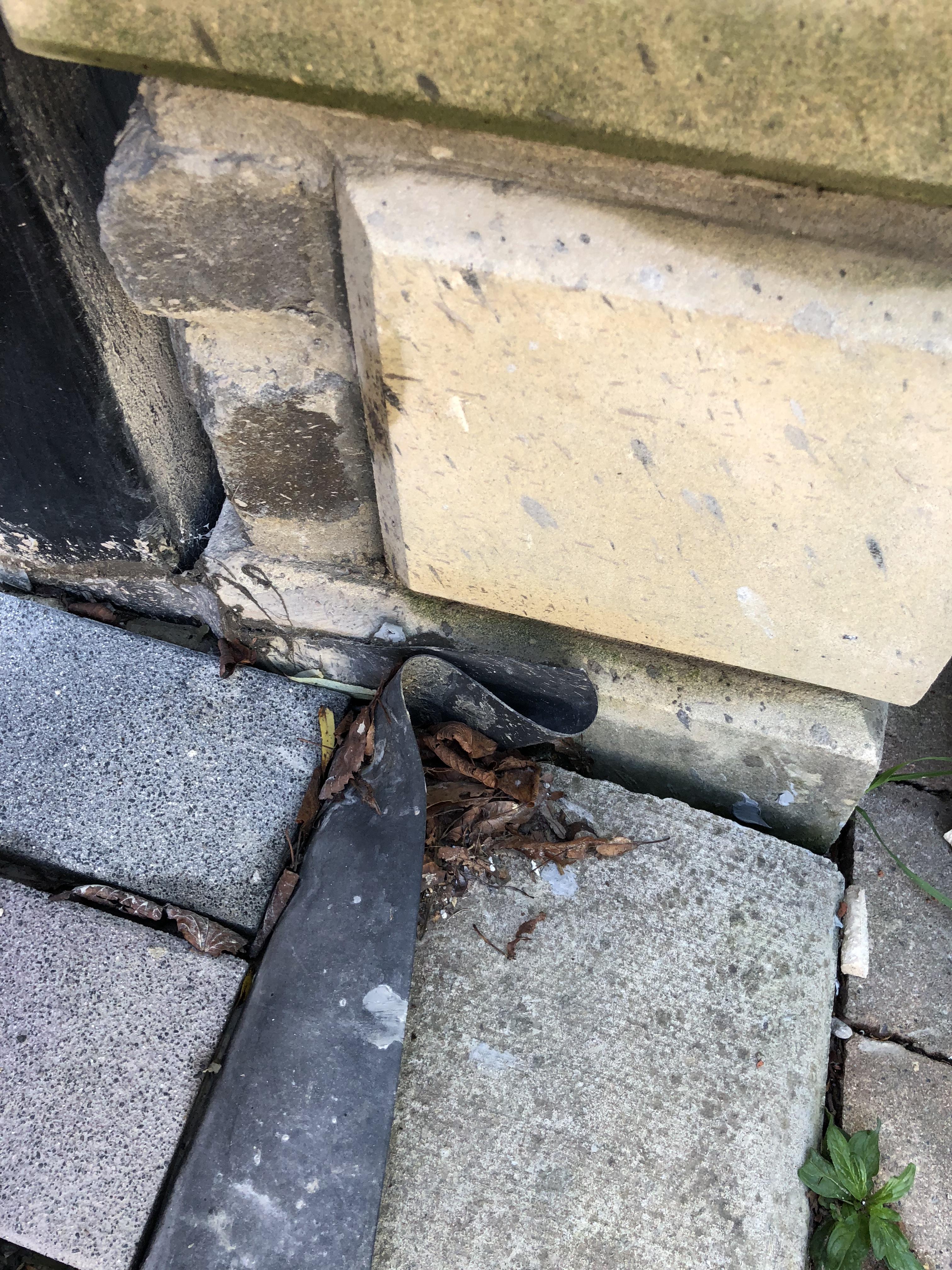

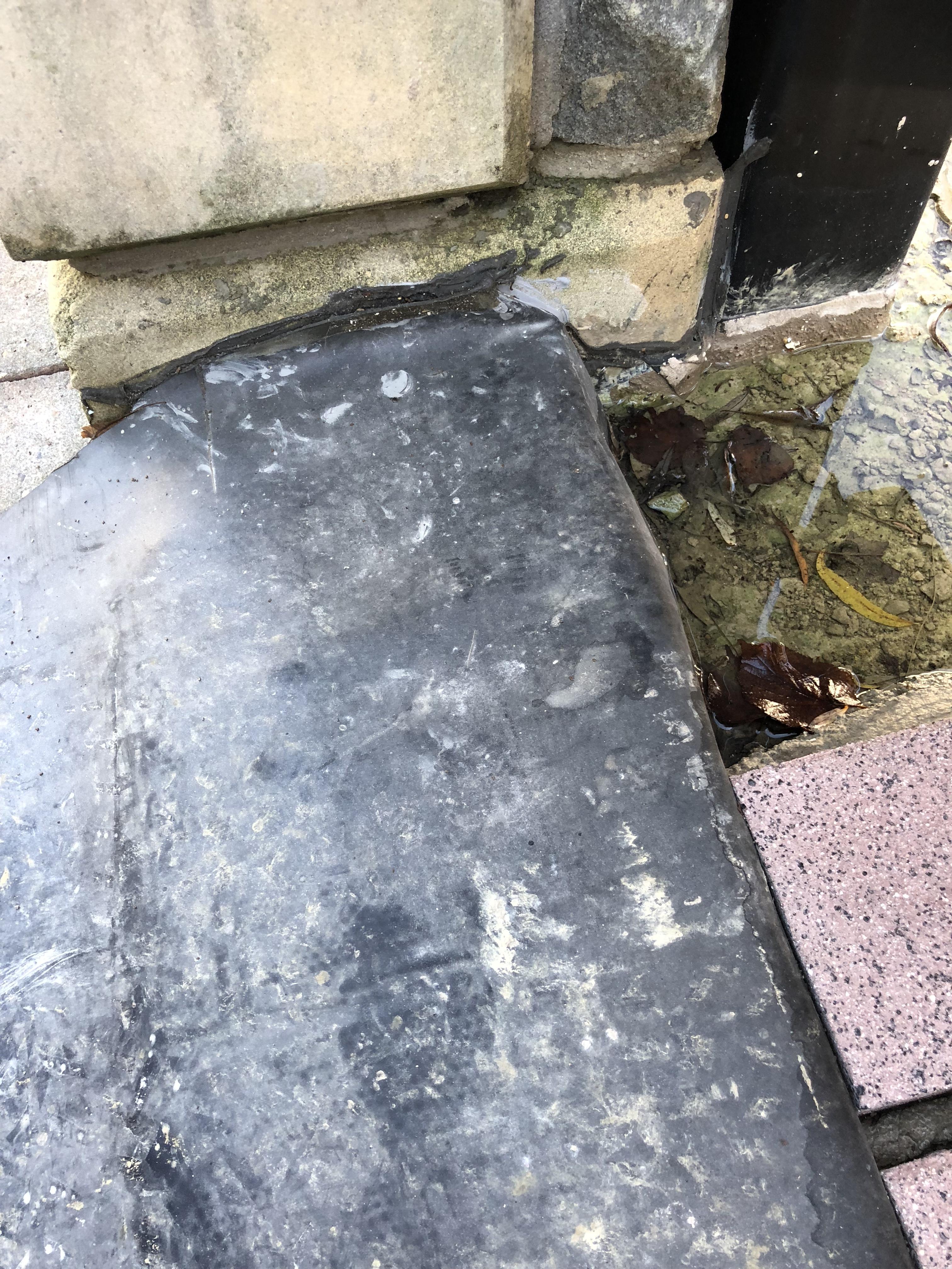

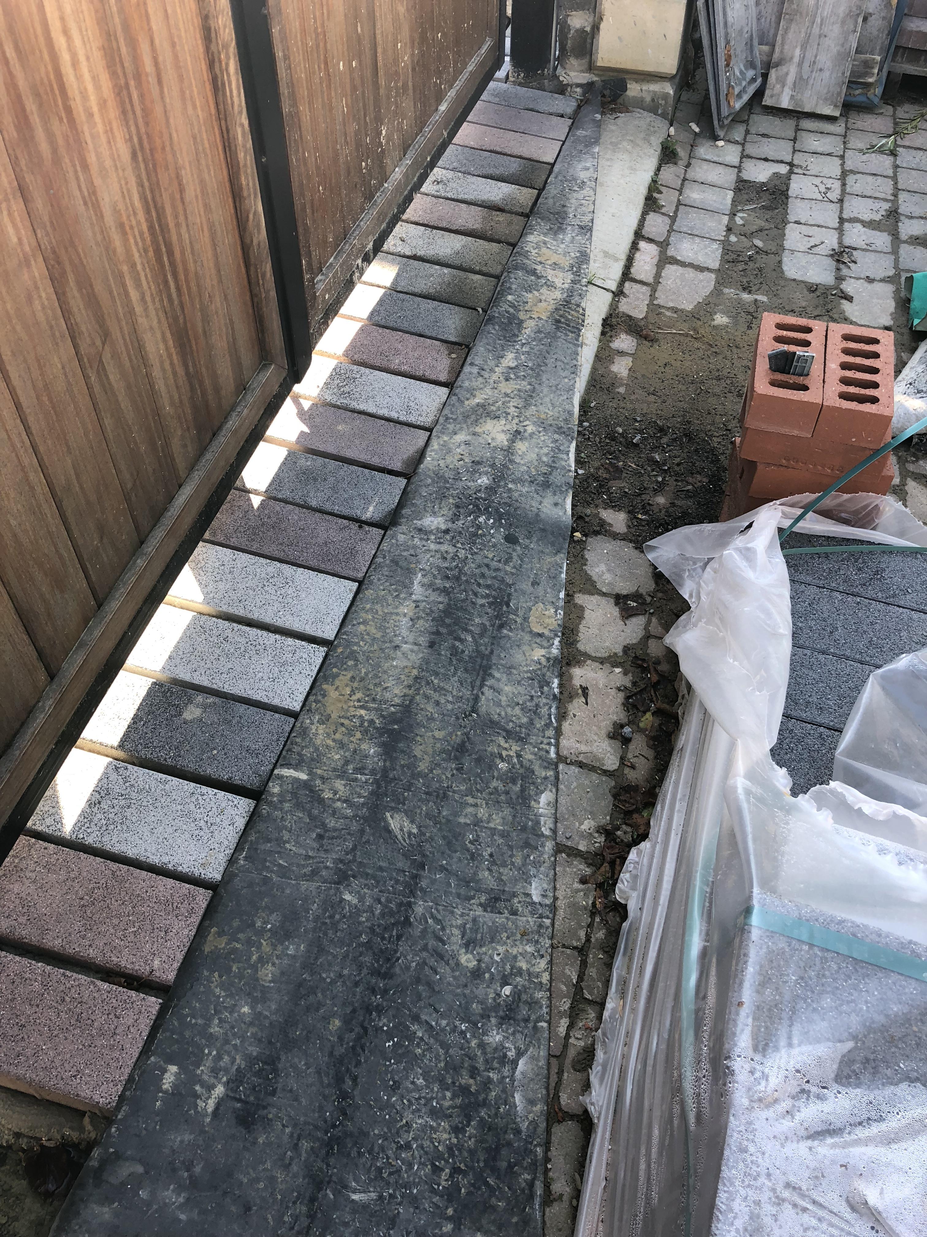

Pocster Posted October 19, 2018 Author Posted October 19, 2018 Just for completeness. Here’s the front effort they left me - i’ve Not touch this . When I flooded the site no water went over these bits as it’s fair too say they’ll leak . Enjoy quality !!
