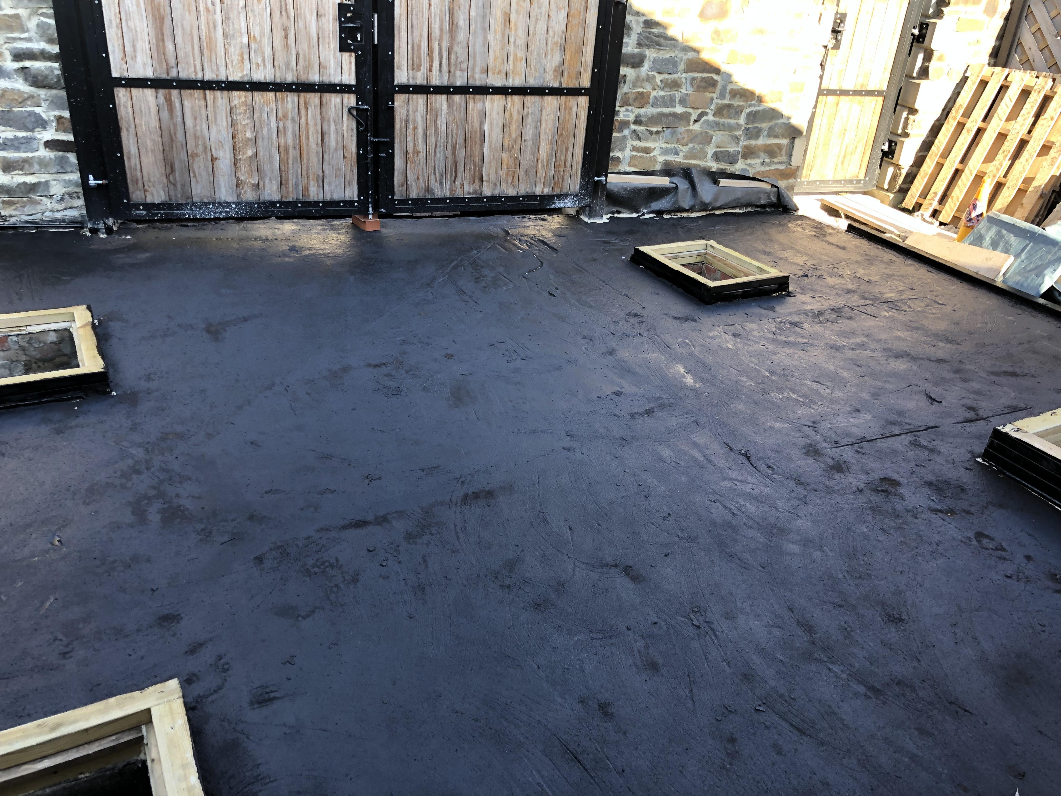

Pocster Posted February 21, 2019 Author Posted February 21, 2019 Roofer wants to prime surface tomorrow- YES ! ????

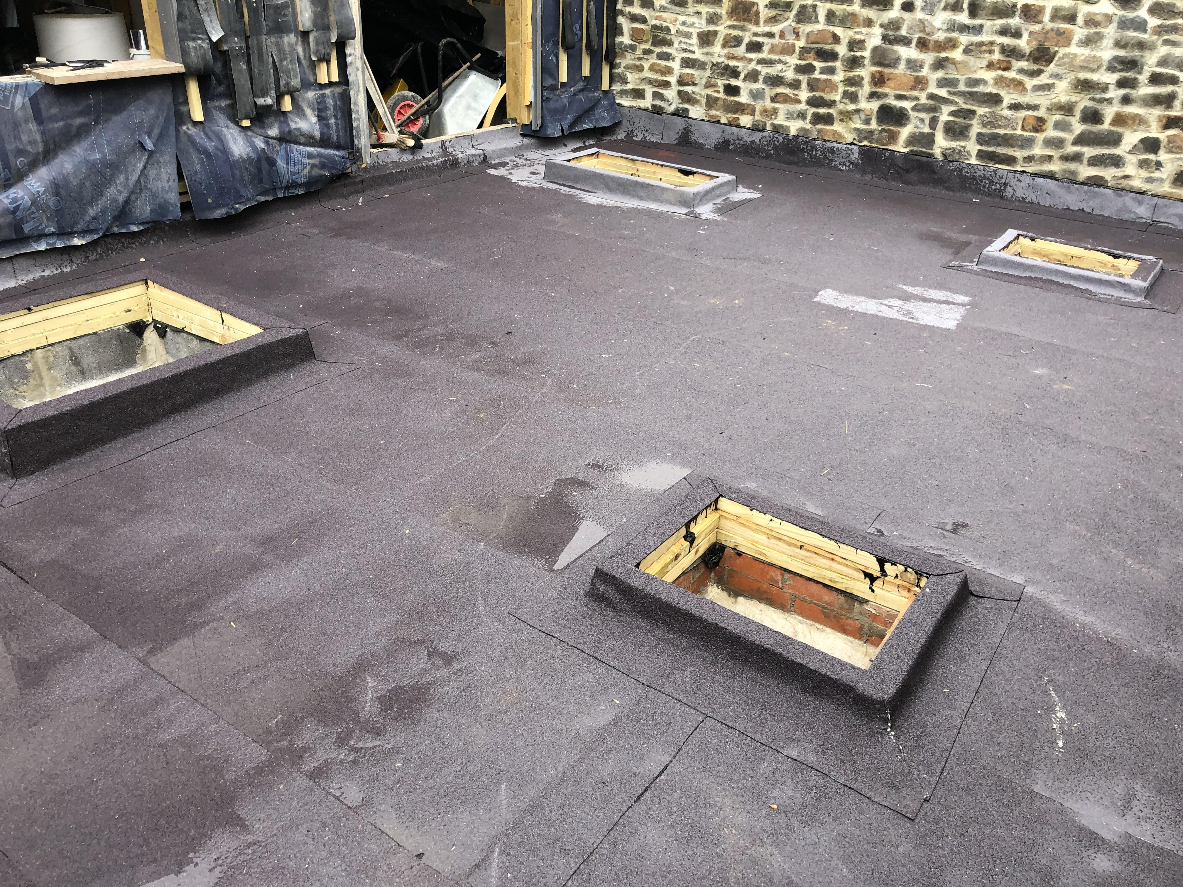

Pocster Posted February 28, 2019 Author Posted February 28, 2019 Went to the site today ; no workmen - it is raining . Been feeding them everyday with coffee , sausage rolls and doughnuts. *Assume* they just need to the flashing ...
Onoff Posted February 28, 2019 Posted February 28, 2019 I thought this was going to be a seamless hot asphalt type thing this time around?
Pocster Posted February 28, 2019 Author Posted February 28, 2019 On 28/02/2019 at 10:28, Onoff said: I thought this was going to be a seamless hot asphalt type thing this time around? Expand I don’t know . The guys told me the hot bitumen is the waterproof layer . The asphalt is purely for protection. I did think it was going to be seamless . Still if it doesn’t leak and I get my 25 yr warranty - then it’s good .
Onoff Posted February 28, 2019 Posted February 28, 2019 On 28/02/2019 at 10:41, pocster said: I don’t know . The guys told me the hot bitumen is the waterproof layer . The asphalt is purely for protection. I did think it was going to be seamless . Still if it doesn’t leak and I get my 25 yr warranty - then it’s good . Expand Erm...that looks like felt not asphalt. Asphalt is boiled up in a bfo pot and trowelled on to form a seamless continuous layer. What did the spec say?
Pocster Posted February 28, 2019 Author Posted February 28, 2019 On 28/02/2019 at 10:45, Onoff said: Erm...that looks like felt not asphalt. Asphalt is boiled up in a bfo pot and trowelled on to form a seamless continuous layer. What did the spec say? Expand I’ll check the spec Before this felt ( only seen it today and no one there now ) . They were boiling up ‘stuff’ and blow torching it on . Is asphalt jet black ?
Pocster Posted February 28, 2019 Author Posted February 28, 2019 On 28/02/2019 at 10:54, pocster said: I’ll check the spec Before this felt ( only seen it today and no one there now ) . They were boiling up ‘stuff’ and blow torching it on . Is asphalt jet black ? Expand Spec states " Provide and lay IKO permatec holt melt membrane to primed screed by others Finish with anti rot mineral finish"
Pocster Posted February 28, 2019 Author Posted February 28, 2019 On 28/02/2019 at 11:32, pocster said: Spec states " Provide and lay IKO permatec holt melt membrane to primed screed by others Finish with anti rot mineral finish" Expand I'm 99% sure that's what has been done. @Onoff stop making me worry! ?

Pocster Posted February 28, 2019 Author Posted February 28, 2019 Hmmmmmm Well roofer has confirmed that the IKO layer beneath the felt is indeed seamless and is the waterproof layer. He's now saying that flashing ( presumably lead ) wasn't included in the price. We did discuss flashing on-site - so I assumed was and more importantly was required. This IKO seamless stuff - even up uneven stone work requires no flashing????? Meeting on-site tomorrow to do the 'test' for the warranty.
