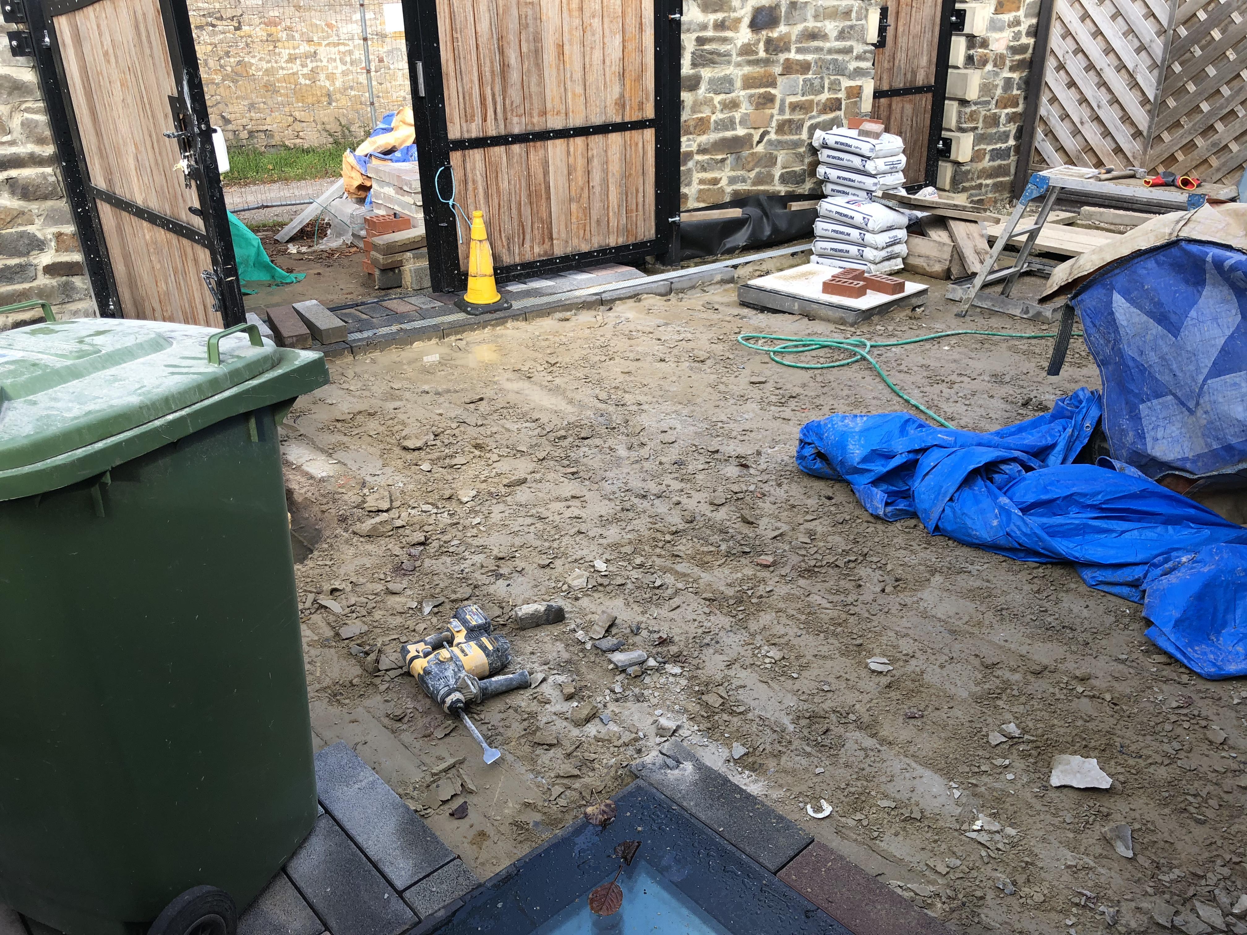

Pocster Posted October 24, 2018 Author Posted October 24, 2018 Architect gone very quiet as I take my pavers up......

Pocster Posted October 25, 2018 Author Posted October 25, 2018 Roofer just looked and suggested ashfelt......
Onoff Posted October 25, 2018 Posted October 25, 2018 3 minutes ago, pocster said: Roofer just looked and suggested ashfelt...... Wot I said wasn't it? 1
Pocster Posted October 25, 2018 Author Posted October 25, 2018 Just now, Onoff said: Wot I said wasn't it? Did you ? But parking on it ??? Block pavers on it ??? You a roofer @Onoff ; you might aswell be ????
PeterW Posted October 25, 2018 Posted October 25, 2018 6 minutes ago, pocster said: Roofer just looked and suggested ashfelt...... Not a hope. You will end up with issues and asphalt has joins in that have to be perfect. Go with either replacement EDPM or GRP.
Pocster Posted October 25, 2018 Author Posted October 25, 2018 2 minutes ago, PeterW said: Not a hope. You will end up with issues and asphalt has joins in that have to be perfect. Go with either replacement EDPM or GRP. He said grp would potentially crack . Edpm I think has been ruled out because the detailing round the gates / entrance etc can’t be done . GRP makes this bit easier though .
Onoff Posted October 25, 2018 Posted October 25, 2018 5 minutes ago, pocster said: Did you ? But parking on it ??? Block pavers on it ??? You a roofer @Onoff ; you might aswell be ???? Asphalt to "park" on is a harder beast quite different from roofing asphalt. Look up Polymer/Permapark, Maybe these people: PERMANITE LIMITED Cawdor Quarry Matlock Derbyshire DE4 2JH Tel No.: 01629 580 363 Fax No: 01629 760 993
Pocster Posted October 25, 2018 Author Posted October 25, 2018 Another roofer said only system to use for this job is hot melt bitumen ( not to call it ashfelt ) . He was honest and said their systems EPDM and a liquid pvc were no good . Said he’d send me the details of the firm . GRP he confirmed would crack .
Pocster Posted October 25, 2018 Author Posted October 25, 2018 (edited) Going round in circles here ! I was thinking the gates at the front etc are the detail issue with EDPM. The gates are past the under ground dwelling I.e beyond the exterior wall . I could therefore put blockwork back from that for the edpm ; so it’s just a simple edge . Edited October 25, 2018 by pocster
Mr Punter Posted October 25, 2018 Posted October 25, 2018 4 minutes ago, pocster said: Going round in circles here ! I was thinking the gates at the front etc are the detail issue with EDPM. The gates are past the under ground dwelling I.e beyond the exterior wall . I could therefore put blockwork back from that for the edpm ; so it’s just a simple edge . I think you need a proper drawing of this detail. TBH you need a proper professional design and spec for the whole roof. Don't try and design it yourself. 1
Pocster Posted October 25, 2018 Author Posted October 25, 2018 1 minute ago, Mr Punter said: I think you need a proper drawing of this detail. TBH you need a proper professional design and spec for the whole roof. Don't try and design it yourself. Oh I’m not ! Problem is Architect is very quiet . One roofer said the problem was the architect just states EDPM- but of course doesn’t understand the detail .....
