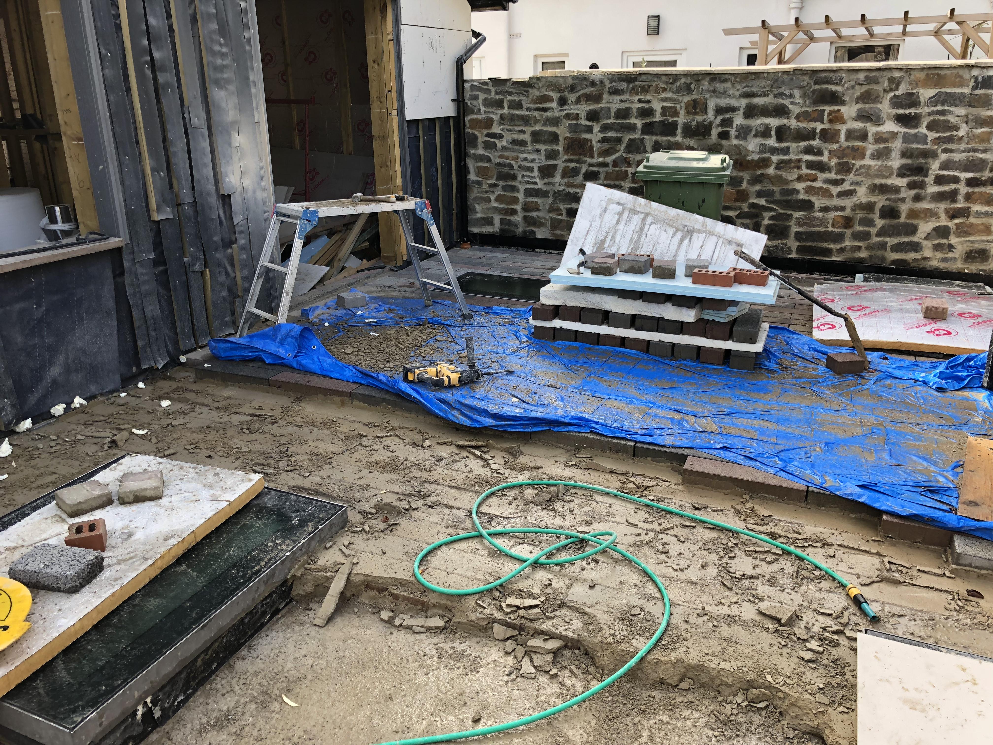

Pocster Posted October 23, 2018 Author Posted October 23, 2018 (edited) 2 minutes ago, JSHarris said: I thought the EPDM was over cement board and then the concrete was over the top of that? Anyway, GRP can be laid over concrete, just needs the concrete to be primed with G4 first. Yes ; layers are correct So I’m stripping this back to the 30mm concrete ( defective EPDM is below that ) Why oh why did he ignore grp so dismissively..... Edited October 23, 2018 by pocster
Pocster Posted October 23, 2018 Author Posted October 23, 2018 Went back to this thread Sigh!; still none the wiser. The guy that visited said he had no real idea how to 'finish' the edpm at the edges - but with grp it could be done. ( once he recovered from his obvious shock) If I'm 'floating' the tiles on pedestals ; why can't I float the parking area also?? on a special purpose construction??? This then solves the issue of car/concrete on grp (or edpm) Ignoring 'depth' issues - what would theoretically be wrong with say a steel structure to support the driveway?
Jeremy Harris Posted October 23, 2018 Posted October 23, 2018 24 minutes ago, pocster said: Went back to this thread Sigh!; still none the wiser. The guy that visited said he had no real idea how to 'finish' the edpm at the edges - but with grp it could be done. ( once he recovered from his obvious shock) If I'm 'floating' the tiles on pedestals ; why can't I float the parking area also?? on a special purpose construction??? This then solves the issue of car/concrete on grp (or edpm) Ignoring 'depth' issues - what would theoretically be wrong with say a steel structure to support the driveway? I agree with him, GRP would make the detailing around the awkward areas at the edges and upstands a lot simpler to implement, and likely be significantly more reliable in the long term. I also think that the idea of a galvanised steel subframe, that's free draining and which supports the pavers is a good one. You can then just ensure that the GRP "bathtub" underneath is properly drained, so water runs off easily, so reducing the risk of any water getting close to the junction of the roof lights and the top of their upstands. At a guess, standard walk way galvanised grating, like this, may well do the job, fitted to stand off legs with load spreading plates underneath them: https://www.themetalstore.co.uk/products/galvanised-steel-walkway You could opt to just leave the grating exposed, even, or go for a GRP grating like this stuff: http://www.duracomposites.com/industrial/fibreglass-grp-grating/ 1
Pocster Posted October 23, 2018 Author Posted October 23, 2018 8 minutes ago, JSHarris said: I agree with him, GRP would make the detailing around the awkward areas at the edges and upstands a lot simpler to implement, and likely be significantly more reliable in the long term. I also think that the idea of a galvanised steel subframe, that's free draining and which supports the pavers is a good one. You can then just ensure that the GRP "bathtub" underneath is properly drained, so water runs off easily, so reducing the risk of any water getting close to the junction of the roof lights and the top of their upstands. At a guess, standard walk way galvanised grating, like this, may well do the job, fitted to stand off legs with load spreading plates underneath them: https://www.themetalstore.co.uk/products/galvanised-steel-walkway You could opt to just leave the grating exposed, even, or go for a GRP grating like this stuff: http://www.duracomposites.com/industrial/fibreglass-grp-grating/ Wish you were my architect @JSHarris

Pocster Posted October 23, 2018 Author Posted October 23, 2018 (edited) Hang on ! Am I being thick !! What’s wrong with making a concrete parking slab and then simply grp up the sides of that direct to the floor . No need to grp under it ! Though grp would go over the parking area - that might be an issue ... ?!?!? ? Edited October 23, 2018 by pocster
Pocster Posted October 23, 2018 Author Posted October 23, 2018 Or perhaps just EPDM over the parking slab ( to keep architect happy ) . So EPDM overlaps grp on sides of parking slab . Sensible ? ??
Jeremy Harris Posted October 23, 2018 Posted October 23, 2018 You can't mix solutions, as that's a recipe for failure. If going for GRP, then create a single, integral, GRP "tub" over the entire roof area, including the edges and upstands, with no breaks or joins.
Pocster Posted October 23, 2018 Author Posted October 23, 2018 (edited) 4 minutes ago, JSHarris said: You can't mix solutions, as that's a recipe for failure. If going for GRP, then create a single, integral, GRP "tub" over the entire roof area, including the edges and upstands, with no breaks or joins. Exactly ! . But if *just* the top of the parking slab was EPDM it could overlap the grp . EPDM just to keep Architect happy - then driveway pavers ontop this so ‘tub’ ; sides ; upstands ; side of parking slab all grp - continuous . Edited October 23, 2018 by pocster

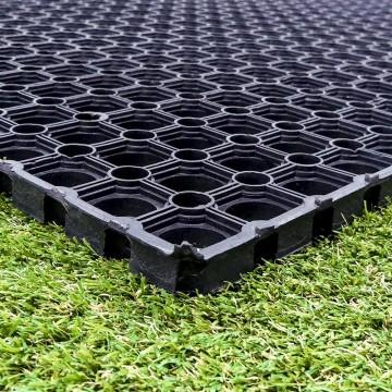

Onoff Posted October 23, 2018 Posted October 23, 2018 (edited) As we're "thinking out loud"... How about...EPDM then rubber mat: https://www.matsgrids.co.uk/rubber-grass-mats/65-16mm-rubber-grass-mats-150x100-5060423910770.html? Then blocks laid on sand / cement mix. I should point out I've just necked a large Cobra... Edited October 23, 2018 by Onoff 1 1

Jeremy Harris Posted October 23, 2018 Posted October 23, 2018 3 minutes ago, pocster said: Car parking area is essentially a giant upstand - but with edpm just on top .... I doubt you'd get a reliable joint, so would suggest you just GRP the whole area, to make one integral, watertight, composite roof with no joints. Joints are always going to be the Achilles heel of any waterproofing system, and the really big advantage of GRP is that there are no joints.
Onoff Posted October 23, 2018 Posted October 23, 2018 Just now, JSHarris said: I doubt you'd get a reliable joint, so would suggest you just GRP the whole area, to make one integral, watertight, composite roof with no joints. Joints are always going to be the Achilles heel of any waterproofing system, and the really big advantage of GRP is that there are no joints. I like the idea of grp. Easy to repair too! Maybe with something with "give" on top before the paving. See @Barney12's roof with integral, hidden gutter to see just how good it can look.
Pocster Posted October 23, 2018 Author Posted October 23, 2018 (edited) 7 minutes ago, JSHarris said: I doubt you'd get a reliable joint, so would suggest you just GRP the whole area, to make one integral, watertight, composite roof with no joints. Joints are always going to be the Achilles heel of any waterproofing system, and the really big advantage of GRP is that there are no joints. But that means driving over grp - my architect ‘s nightmare . Might be more acceptable because it’s not at floor level .... Could even grp over the slab and EPDM - everyone’s happy then !! Edited October 23, 2018 by pocster
