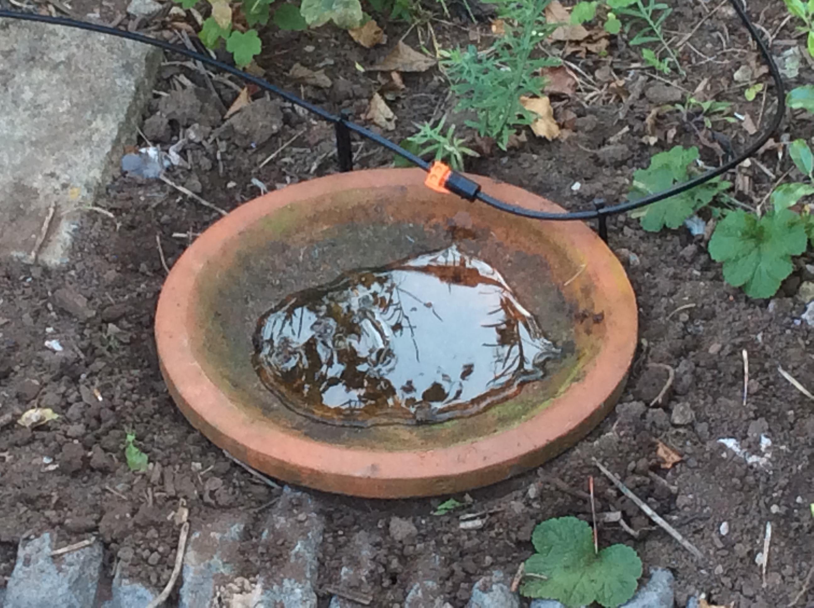

Ferdinand Posted July 6, 2019 Share Posted July 6, 2019 Hoicking this thread out of Hades, has anyone experience of setting up one of these systems to also refresh a ground level bird bath? The BB may be as simple as a trad dustbin lid or similar, with an entry ramp. Cheers. Ferdinand Link to comment Share on other sites More sharing options...
Jeremy Harris Posted July 6, 2019 Share Posted July 6, 2019 Should work OK, just a matter of adjusting the dripper feeding the bird bath to supply just enough water. Easy to do, but would need a bit of trial and error to get the setting right. Best run with a timer, so that the bird bath only fills at set times during the day, so the time periods would need some fiddling with too. Link to comment Share on other sites More sharing options...
Temp Posted July 6, 2019 Share Posted July 6, 2019 If you fill a wine bottle with water and turn it upside down with the neck under water in the bird bath the water doesn't run out of the bottle until the birds drink and the water and the level falls low enough to allow air into the bottle. Many variations on this theme are possible with larger bottles. 2 Link to comment Share on other sites More sharing options...
Ferdinand Posted July 6, 2019 Share Posted July 6, 2019 In the birdbath run, it would be about half a dozen outlets, and possibly running from a water butt - which would be turned on for half an hour or so each day when I come in in the car. I could set up a hose, but do not currently have one that side. At the back I may need a larger run, which would be from a tap. F Link to comment Share on other sites More sharing options...
Jeremy Harris Posted July 6, 2019 Share Posted July 6, 2019 1 minute ago, Ferdinand said: In the birdbath run, it would be about half a dozen outlets, and possibly running from a water butt - which would be turned on for half an hour or so each day when I come in in the car. I could set up a hose, but do not currently have one that side. At the back I may need a larger run, which would be from a tap. F The Claber system I installed last year came with a 20m length of small bore black pipe, and connects directly to an outside tap. Adding a longer length of pipe is easy, as the pipe they use seems to be pretty standard stuff that's available fairly cheaply on eBay: https://www.ebay.co.uk/itm/Micro-Feeding-Tube-Pipe-4mm-id-6mm-od-Hozelock-Claber-Compatible-Micro-Watering/281730798058?hash=item419876d1ea:m:mL7Hgmt3f-wJpH3DlusxZig Link to comment Share on other sites More sharing options...

Ferdinand Posted September 1, 2019 Share Posted September 1, 2019 On 19/05/2018 at 17:03, JSHarris said: cheap timer: https://www.ebay.co.uk/itm/Auto-Digital-LCD-Electronic-Water-Timer-Garden-Irrigation-Controller-Free-Post-A-/332160779280?_trksid=p2349526.m4383.l4275.c10 and have found it works very well indeed - surprisingly so for the price. I have set up the first part of my watering system. Easy to do and quite adjustable. Works fine from a water butt. I also have my lower tech device to warn me when it s probably time to have it on for a bit, before the soil dries out much. Link to comment Share on other sites More sharing options...
