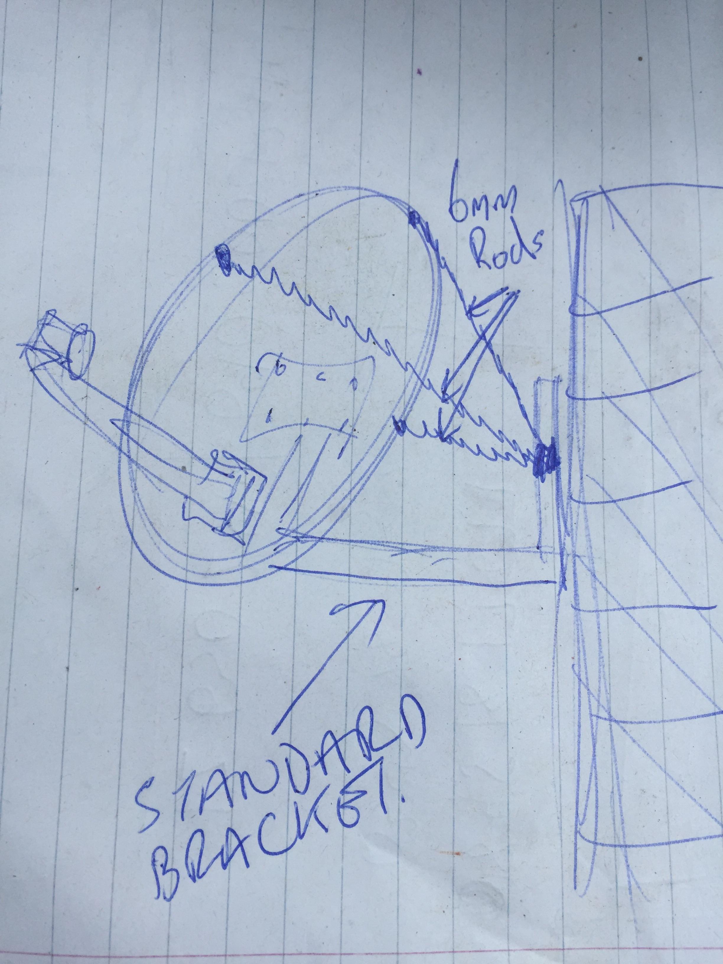

@Onoff any reason that threaded bar can't be used to stabilise the dish if it's that battered by wind ?
What, from the rim say back to the wall? Shouldn't cause a problem. The sat signal reflects off the parabola onto the lnb so keep that clear.
Some stainless steel wire might look a bit more attractive than studding.

Would have to be a dowel wouldn't it. Compression not tension. ?
You mean a strut I think? :)
I was envisioning one wire either side. Is the dish being blown against or just worried by the wind?

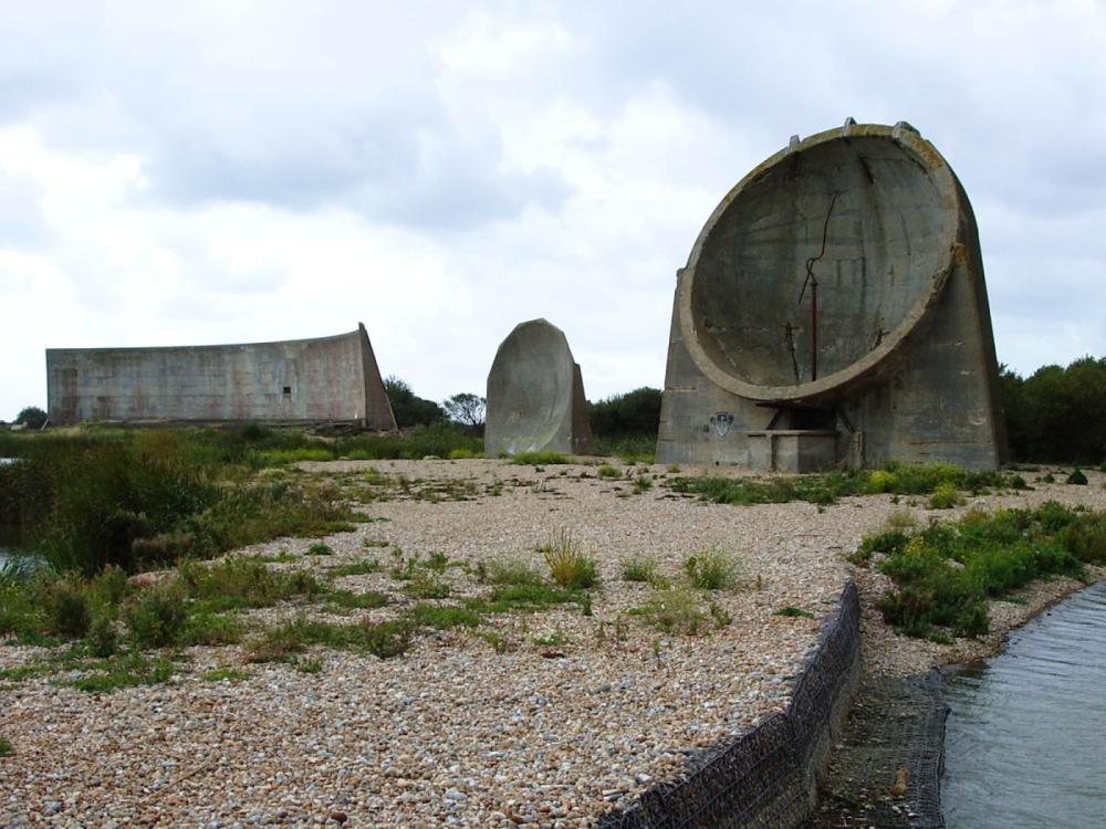

The (mad?) idea I had was to copy the wartime acoustic mirrors:
So you have a concrete block and the dish sits in that. It'd work a treat. In the case of the acoustic mirrors the parabola focused the incoming sound of enemy planes (pre radar) on a microphone. For satellite use you could glue on tin foil, takeaway containers or even metallic paint the concave face as long as the lnb was positioned right.

Summat like this. Just for additional stability. Either back to the OEM bracket or even back to the building structure.
No wind would shift it if I fitted it :D.
The usual weakness on many dishes is the LNB arm. Not helped by the design of some is a U shaped hollow tube specially designed to fill with water and rot from the inside.  I have 3 "guy wires" on mine,
