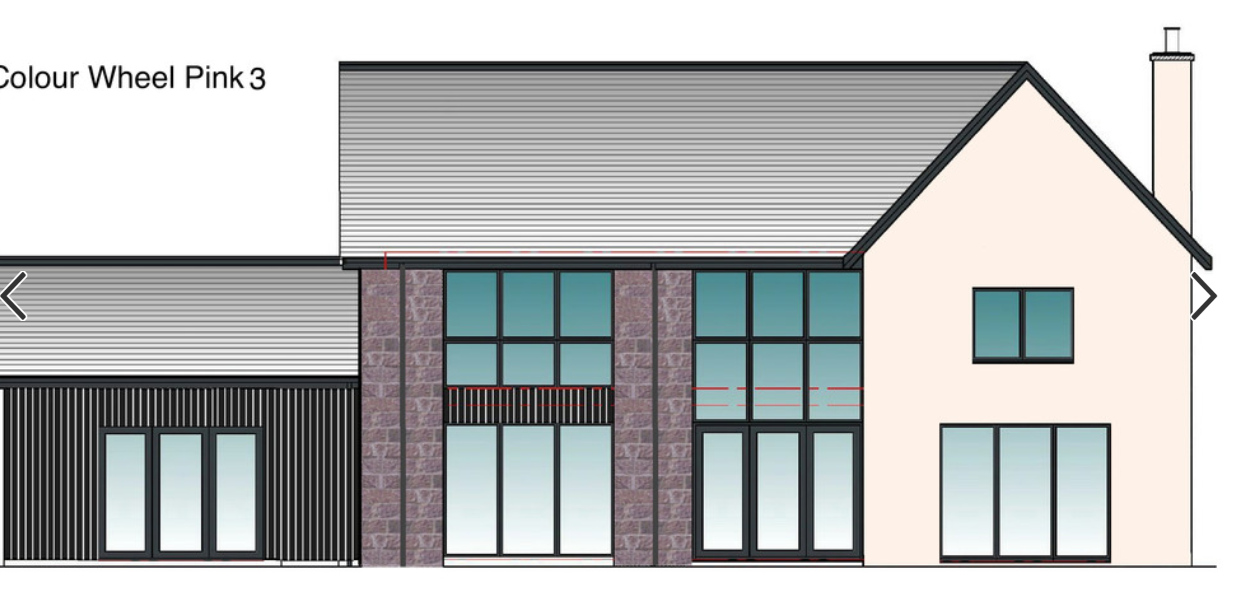

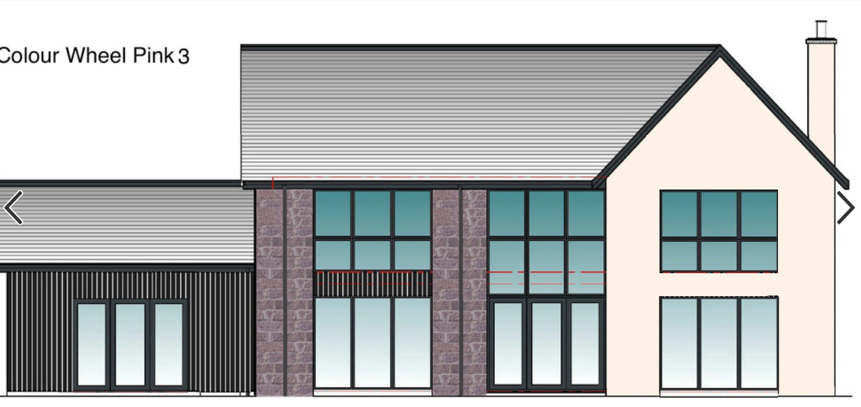

ultramods Posted May 9, 2018 Posted May 9, 2018 From an aesthetic/design perspective what do you think looks better, large or small window for the master bedroom (First floor, furthest right)?
PeterW Posted May 9, 2018 Posted May 9, 2018 Is that south facing ..? Looks better on the right but... middle panel needs to match the rest ..! 1

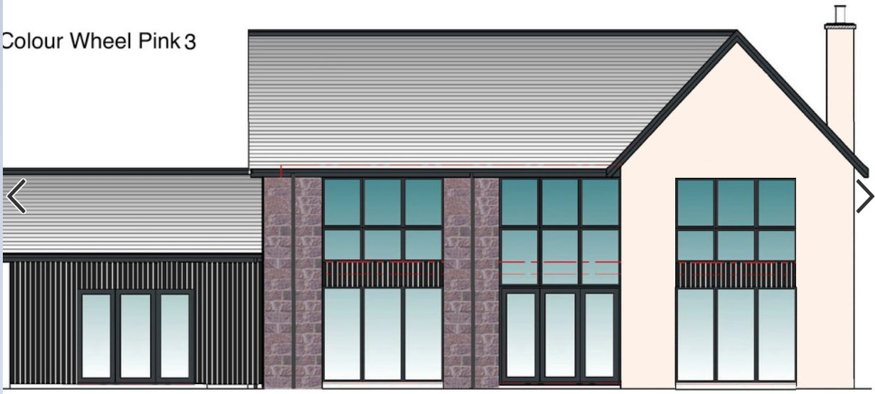

ultramods Posted May 9, 2018 Author Posted May 9, 2018 On 09/05/2018 at 09:32, PeterW said: Is that south facing ..? Looks better on the right but... middle panel needs to match the rest ..! Expand South west. Do you mean the middle panel to watch the render, like below?
newhome Posted May 9, 2018 Posted May 9, 2018 What separates the windows on the right horizontally and why isn’t that the same in the middle windows?
PeterW Posted May 9, 2018 Posted May 9, 2018 Middle panel seems to be all glass yet others have a timber (????) middle section in line with the floor ..?
ultramods Posted May 9, 2018 Author Posted May 9, 2018 @newhome The middle window is a double height space, so there is no first floor there 1
Crofter Posted May 9, 2018 Posted May 9, 2018 On 09/05/2018 at 09:37, ultramods said: South west. Do you mean the middle panel to watch the render, like below? Expand This version works for me. But I hope you're not going to be giving your neighbours too much of an eyefull! 1

epsilonGreedy Posted May 9, 2018 Posted May 9, 2018 Either works for me, the smaller window variant says trad design updated with a degree of modern large aperture glazing and is safer from a resale perspective. Although I am new to the selfbuild scene I already sense that self builders get carried away and incorporate an excess of glazed acreage in their designs. 1

newhome Posted May 9, 2018 Posted May 9, 2018 On 09/05/2018 at 09:58, epsilonGreedy said: Either works for me, the smaller window variant says trad design updated with a degree of modern large aperture glazing Expand +1 but if you go for the bigger windows separate with render to match that whole section as per pic 3. And wear boxers when standing to admire the view 1

Mr Punter Posted May 9, 2018 Posted May 9, 2018 Worth checking how high above floor level is the horizontal as you need to consider safety when opening / cleaning. I don't see that the windows either side of the double height need to match it, but they will probably look better matching each other. 1
