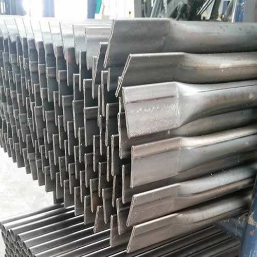

epsilonGreedy Posted April 23, 2018 Posted April 23, 2018 While nosying around my reference build site the other evening I noticed a few chipped brick faces where scaffold platform horizontal bars were located within brick courses. I guess the brickies did not leave a large gap enough for the flattened end of the scaffold bars. Would a cautious brickie add an offcut of such a scaffold bar end to his toolkit and use this as a template to ensure large enough gaps are left between bricks for scaffold lifts?

epsilonGreedy Posted April 23, 2018 Author Posted April 23, 2018 58 minutes ago, Russell griffiths said: Are they still using it where you are ? It looks like a proper job with a properly dated and ID'ed installation tag, it went up two months ago and has had a couple of lifts since then. The ties I am referring to are about 30mm wide with the pole dry inserted into the brick course by guess 50mm.
Russell griffiths Posted April 23, 2018 Posted April 23, 2018 I didn’t think they used it any more. How do you get a 30mm putlock in a 10 mm brick joint, unless it is not face work.
Construction Channel Posted April 23, 2018 Posted April 23, 2018 (edited) They've used these on a few of our builds recently, its still easy to chip the bricks taking them out but they are only 10mm thick....ish (i haven't actually measured one) http://www.scaffolding-direct.co.uk/scaffolding-fittings-pressed-spade-end-putlog-head-x-50-.aspx the other option is to use flattened tubes but I haven't seen those used in a while Edited April 23, 2018 by Construction Channel

Temp Posted April 25, 2018 Posted April 25, 2018 Just for info, Google found the following descriptions of scaffolding types: http://www.rowlandscaffold.co.uk/independent-access-scaffold/ Putlog Scaffold A putlog scaffold may also be called a bricklayer’s scaffold. As such, the scaffold consists only of a single row of standards with a single ledger. The putlogs, (transoms with one end flattened) are attached to the ledger at one end but integrated into the bricks at the other. Spacing is the same on a putlog scaffold as on a general purpose scaffold, and ties are still required. Birdcage Scaffold A Birdcage scaffold is an independent scaffold consisting of more than two rows of standards in both directions connected by ledgers and transoms. Scaffold Tower AKA a mobile tower or zip-up tower is a lightweight aluminium scaffold mounted on casters or wheels which provides a free standing ,and easily moveable, working platform. Truss-Out Scaffold A specially designed independent tied scaffold projecting from the face of the building or structure, and is entirely dependent upon the building for support. These scaffolds are generally used where it is impractical, or inadvisable, to build from ground level. Cantilever Scaffold A specially designed independent tied scaffold similar to a truss-out but erected on beams cantilevering out from a building. Drop Lift Scaffold A specially designed scaffold suspended at a fixed height, either below load bearing projecting brackets or beams or from the structural members of a roof or other overhead structure. Flying Shore Scaffold A specially designed temporary support scaffold fixed horizontally between two buildings This method of shoring does not touch the ground, but rather spans in mid-air the widths between the walls you are propping up. Raking Shore Scaffold A specially designed temporary support scaffold giving support to an unsafe wall by means of a series of rakers (sloping tube) between the face of the structure to be supported and the ground. Dead Shore Scaffold A specially designed temporary support scaffold giving support to the weight of the structure directly above and transferring the same to the ground on firm foundation below. Stair Access Scaffold A temporary scaffold which is much more robust and versatile than any of the push-fits on the market. 1
