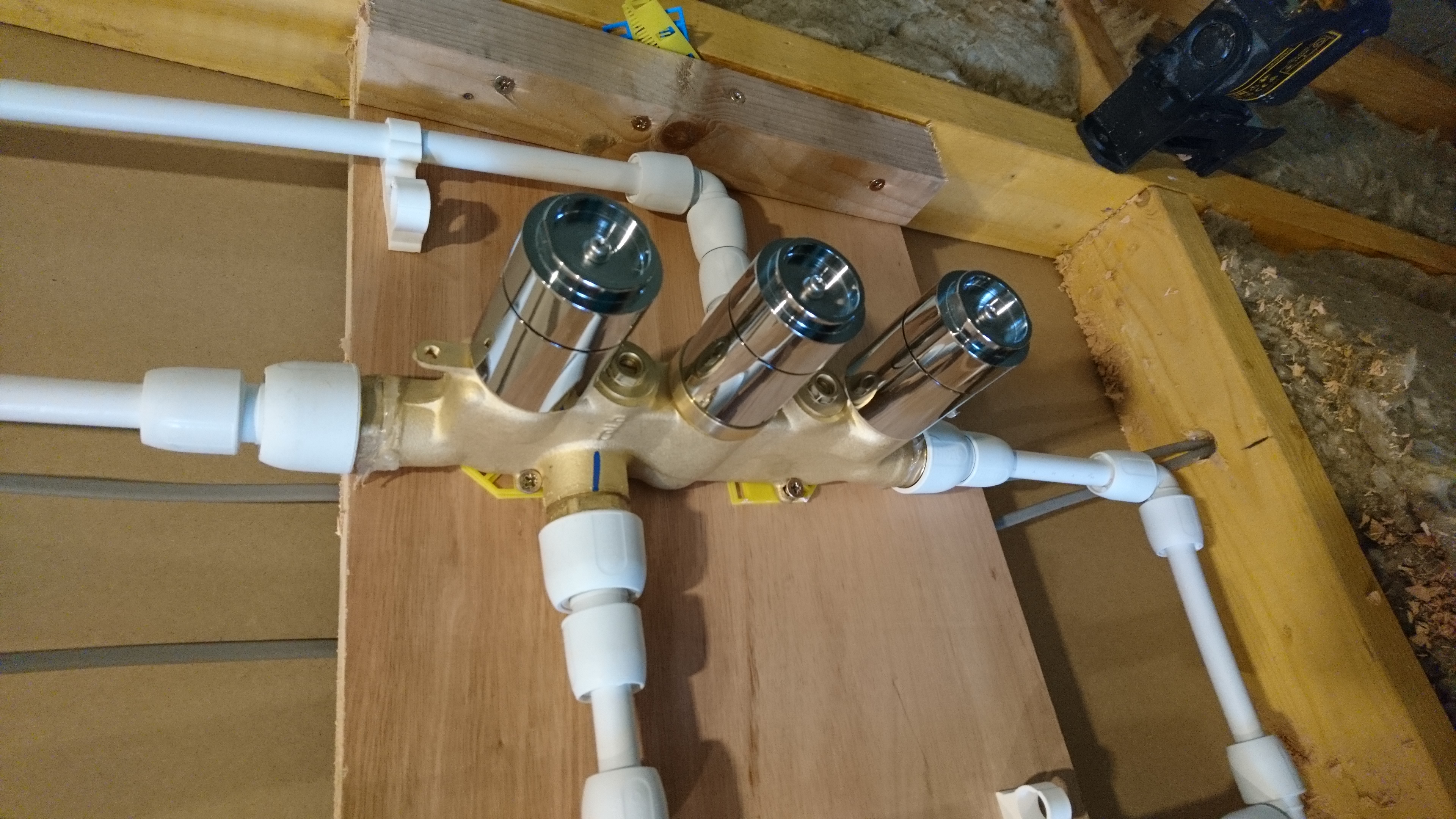

Onoff Posted April 23, 2018 Posted April 23, 2018 I've hived these Plumbing 101 questions off from my main thread as they might help others! So I'm taping these 1/2" BSP male fittings to go into my shower valve. The tape is wider than the male fitting is long. If I wind my 20 turns on it so as not to get any overhanging the end it encroaches on the hex bit that I need to get a spanner on to do it up: Then, what constitutes a "smear" of gloop? This much? On the tape? Doing it up and as it's so thick the flange doesn't sit down against the valve: The alternative being I guess to wind the tape on abutting the flange like this? But then it hangs over the end: Basic stuff I'm sure ( @Nickfromwales ) but which way is right, if any of them? Cheers

Nickfromwales Posted April 23, 2018 Posted April 23, 2018 They're all right, but the shot of the lesser goop is better, as it really just needs to be a smear. 10 minutes ago, Vijay said: 20 winds?? Hope there's a joke there, why so much??? Because with less you get a lot of leaks thats why Brass into brass is quite sloppy, so the fitting will simply displace what ever it doesn't want but will definitely have enough to pack the valleys fully. 1
Nickfromwales Posted April 23, 2018 Posted April 23, 2018 For the excess ptfe over the face of the thread, simply run it flat over an engineers file and clean off the waste bits. 2
CC45 Posted April 23, 2018 Posted April 23, 2018 The prob with those 90deg fittings is if they leak you cant give them a little tweak - its got to be a 360 turn. I put loads of ptfe - as @Nickfromwales says - fill those valleys. If I did it again i'd bend the pipe 90 / use 90deg joint and then go into the valve with a straight joint, you can then tighten it up a bit more if necessary. All looks good so far. Cant wait to see the tiling.... 2
Onoff Posted April 24, 2018 Author Posted April 24, 2018 7 hours ago, Vijay said: 20 winds?? Hope there's a joke there, why so much??? I thought it was taking the p too to start off with. I learnt the merit of it when doing my outside tap. My fear was it cracking the fitting but not a problem. @Nickfromwales said to wind on some weird number of turns, 23 to 29 rings a bell. It's then just right, enough that you can wind it in and you'll just know when it feels right and is dead level. Worked a treat, no leaks and has remained vertical. The key is I think not to be tempted to turn it back. For these shower valve fittings I'm figuring it's more crucial because of possible damage to finishes and contaminating the valve with excess tape.
Onoff Posted April 24, 2018 Author Posted April 24, 2018 6 hours ago, CC45 said: The prob with those 90deg fittings is if they leak you cant give them a little tweak - its got to be a 360 turn. I put loads of ptfe - as @Nickfromwales says - fill those valleys. If I did it again i'd bend the pipe 90 / use 90deg joint and then go into the valve with a straight joint, you can then tighten it up a bit more if necessary. All looks good so far. Cant wait to see the tiling.... You've got me worried now ref those 90s! Means re bending that convoluted bit and moving the hole up into the loft for the cold in. I was even thinking to use one of the liquid PTFEs. I'll think / drink on it!

Onoff Posted April 24, 2018 Author Posted April 24, 2018 9 hours ago, Nickfromwales said: They're all right, but the shot of the lesser goop is better, as it really just needs to be a smear. Both shots the same fitting, just turned around!

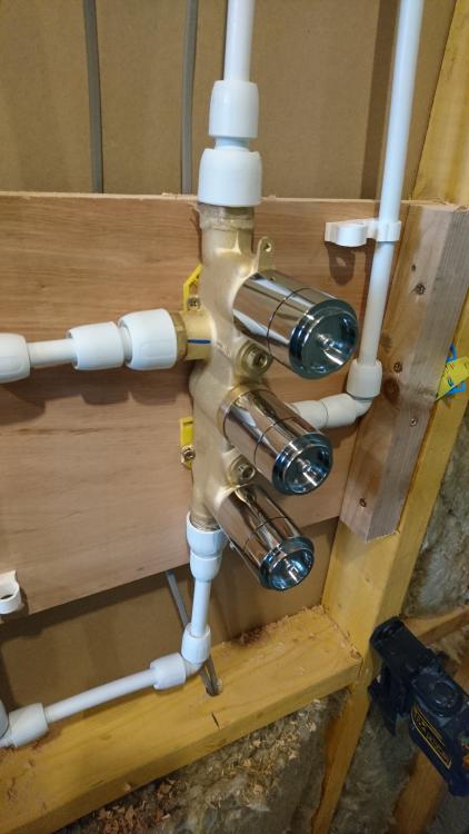

Onoff Posted April 24, 2018 Author Posted April 24, 2018 Well fingers crossed! Chamfered the timber to give better spanner access to the hot in: 25 turns and a smear of Jet Blue Plus. I tried a file to get rid of the PTFE on the end of the fitting but didn't get on with it: Found a new Stanley blade the answer: 2

Onoff Posted April 24, 2018 Author Posted April 24, 2018 Three out of the 4 nutted up on the compression fittings! The 4th, convoluted one off the bottom elbow to the handset is a bit of a problem. I'll put that in the bathroom thread!
