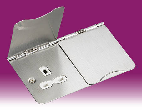

8ball Posted April 6, 2018 Author Posted April 6, 2018 1 minute ago, richi said: Looking at this again, there's this thing called a QuickCharge Aware cable in the newer versions of the standard. Looks like a revolting hack to me. I guess that's what this is. Bloody standards people. USB-C was supposed to make everything simple again, but here we are with another camel. Sometimes I have argued till I,m blue in the face about some standard or another then a smart *** gets his tablet out and puts me to shame I think what I'm better off doing is to have a hidden 13amp power socket recessed into the window board then I'm covered for all future changes and standards, not as low profile as a USB port but def future proof. Hmm wondering if a plug socket on a window board is regs approved?
richi Posted April 6, 2018 Posted April 6, 2018 How about one of those floor sockets with a sprung, hinged flap?

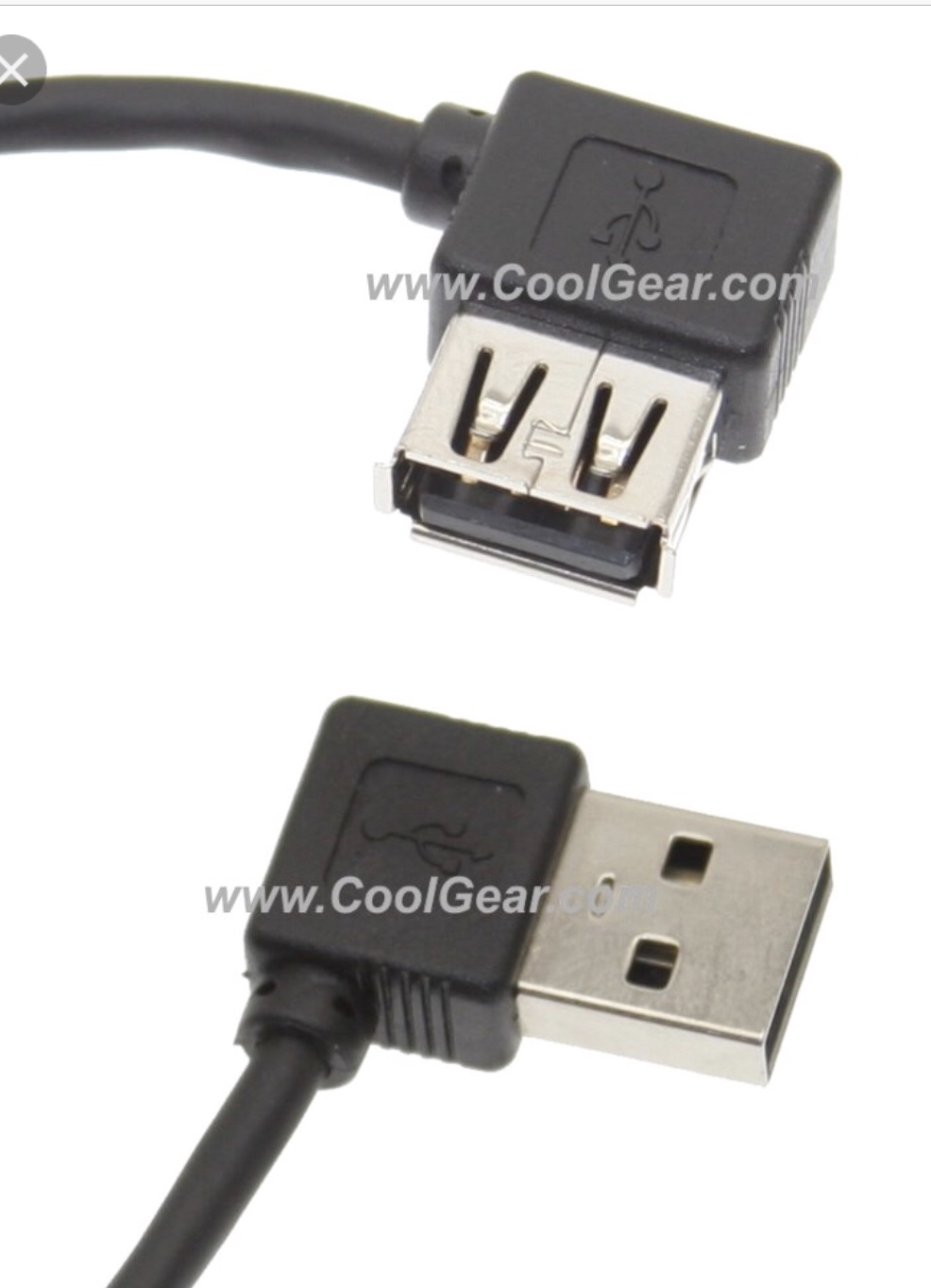

daiking Posted April 6, 2018 Posted April 6, 2018 (edited) Could get a fairly low profile solution with an USB extension lead. Plug the male end into a usb supply Edited April 6, 2018 by daiking
