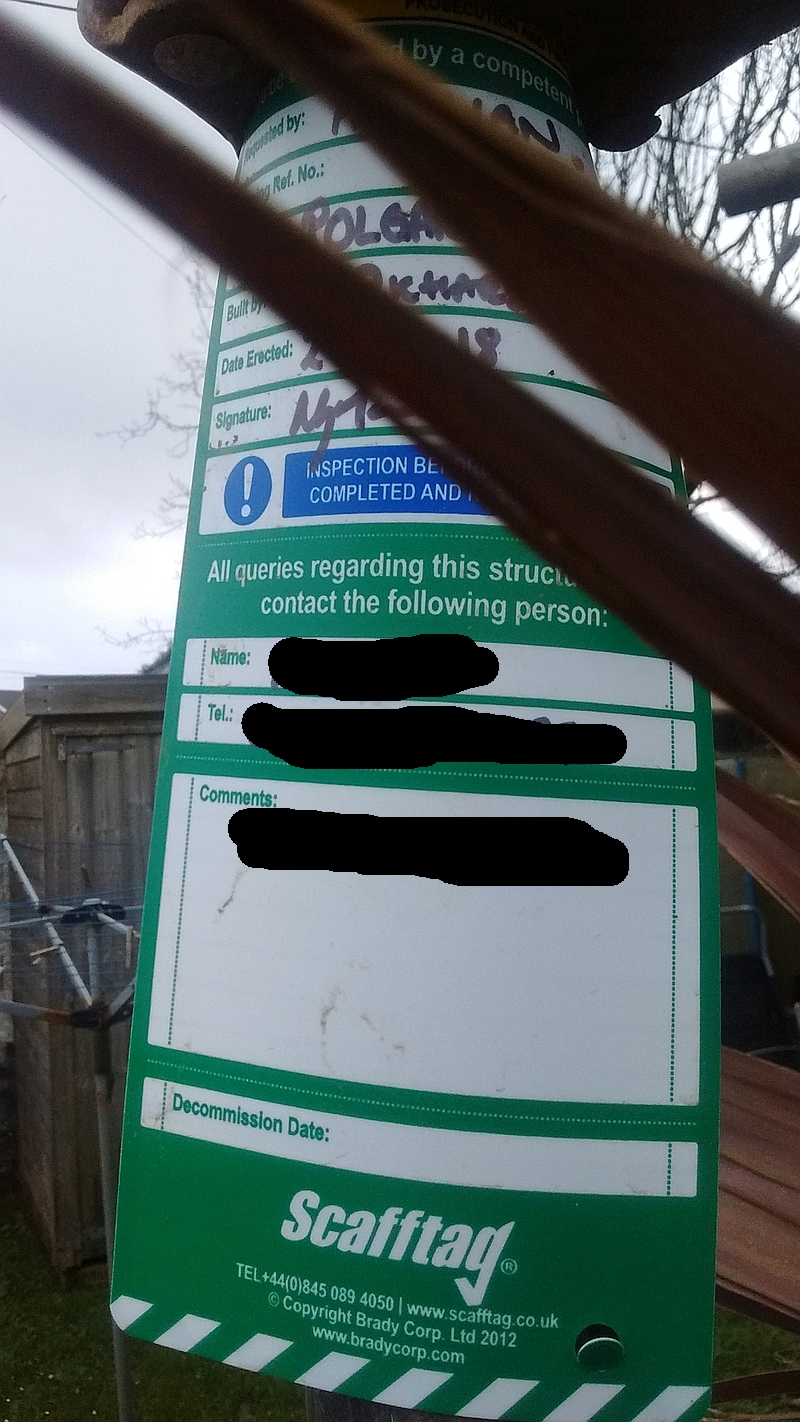

Jeremy Harris Posted March 31, 2018 Share Posted March 31, 2018 1 minute ago, SteamyTea said: Seems my neighbour's scaffolding has a tag, can't say I have ever noticed one before. Ours had one too, but it doesn't stop every trade on site just deciding to alter the scaff willy nilly. I had to keep calling the scaff company out to rectify unauthorised alterations made by others, and just accepted the £50 or so charge I got each time. It didn't matter how many times I told people not to touch the scaff, they still did. I even threatened one company (the fencing company) with action to recover the cost of getting the scaff reassembled properly, as I had motion camera images of them unbolting stuff and moving boards, but they were such a PITA about it that I just chose not to continue with trying to recover such a relatively small amount, but told them they would never get any more work from us and I'd tell everyone who asked not to deal with them. Link to comment Share on other sites More sharing options...
newhome Posted March 31, 2018 Author Share Posted March 31, 2018 6 minutes ago, SteamyTea said: Seems my neighbour's scaffolding has a tag, can't say I have ever noticed one before. Yep, that's what ours was missing!! Link to comment Share on other sites More sharing options...
Jeremy Harris Posted March 31, 2018 Share Posted March 31, 2018 5 minutes ago, newhome said: In my case the claim was that the scaffolding was defective and he was instructed to use it by my husband thus rendering him liable for the accident. The scaffolding of course was on hire from elsewhere so one might assume that the liability would pass onto the scaffolding company but in this case it did not and they came after us. Not much use now, but I included a clause saying that although we had provided scaffolding, it was erected and certified by MJ Scaffolding and all liability for them using it rested with that company. If they spotted an unsafe or changed part of the scaffolding then they should stop working on it and inform me, so that I could call the scaff company out. Only one company bothered to do this, and then only after a near-miss accident, and that was the solar panel installers. Everyone else who used the scaffolding just unbolted and moved bits, untied ladders and moved them, shifted boards around, you name it, and it was up to me to walk around each day to see what had been buggered up and then call the scaff company back. 1 Link to comment Share on other sites More sharing options...
newhome Posted March 31, 2018 Author Share Posted March 31, 2018 Just now, JSHarris said: Not much use now, but I included a clause saying that although we had provided scaffolding, it was erected and certified by MJ Scaffolding and all liability for them using it rested with that company. If they spotted an unsafe or changed part of the scaffolding then they should stop working on it and inform me, so that I could call the scaff company out. Only one companny bothered to do this, and then only after a near-miss accident, and that was the solar panel installers. Everyone else who used the scaffolding just unbolted and moved bits, untied ladders and moved them, shifted boards around, you name it, and it was up to me to walk around each day to see what had been buggered up and then call the scaff company back. This is very much of use now, not to me but for the countless self builders who will read your post and make your advice their modus operandi. This was entirely the point of this thread - to act as a warning and for others to provide ideas as to best practice to hopefully mitigate against issues encountered. Knowledge is power (and good for arse covering too). Re the unbolting, it could easily have been the employees of the contractor who did fiddle around with the clips as up to that point they were the only folk who had used it. I just read my husband's statement to the solicitor after the incident and he states that originally the contractor told my husband that the insurance claim was going to be against the scaffolding company. I don't know what led to that not being the case but the next thing we knew the claim was served on us, even though the H&S report noted that the scaffolding had missing clips and the H&S officer demanded a site meeting with the scaffolder and ripped into him about the missing clips. The insurance company had the H&S report too but chose to admit liability in the end rather than try to flip the claim to a third party. I have a feeling that they wanted to avoid any court action and had already determined that they would not need to pay out very much money so decided to cut their losses. Link to comment Share on other sites More sharing options...
