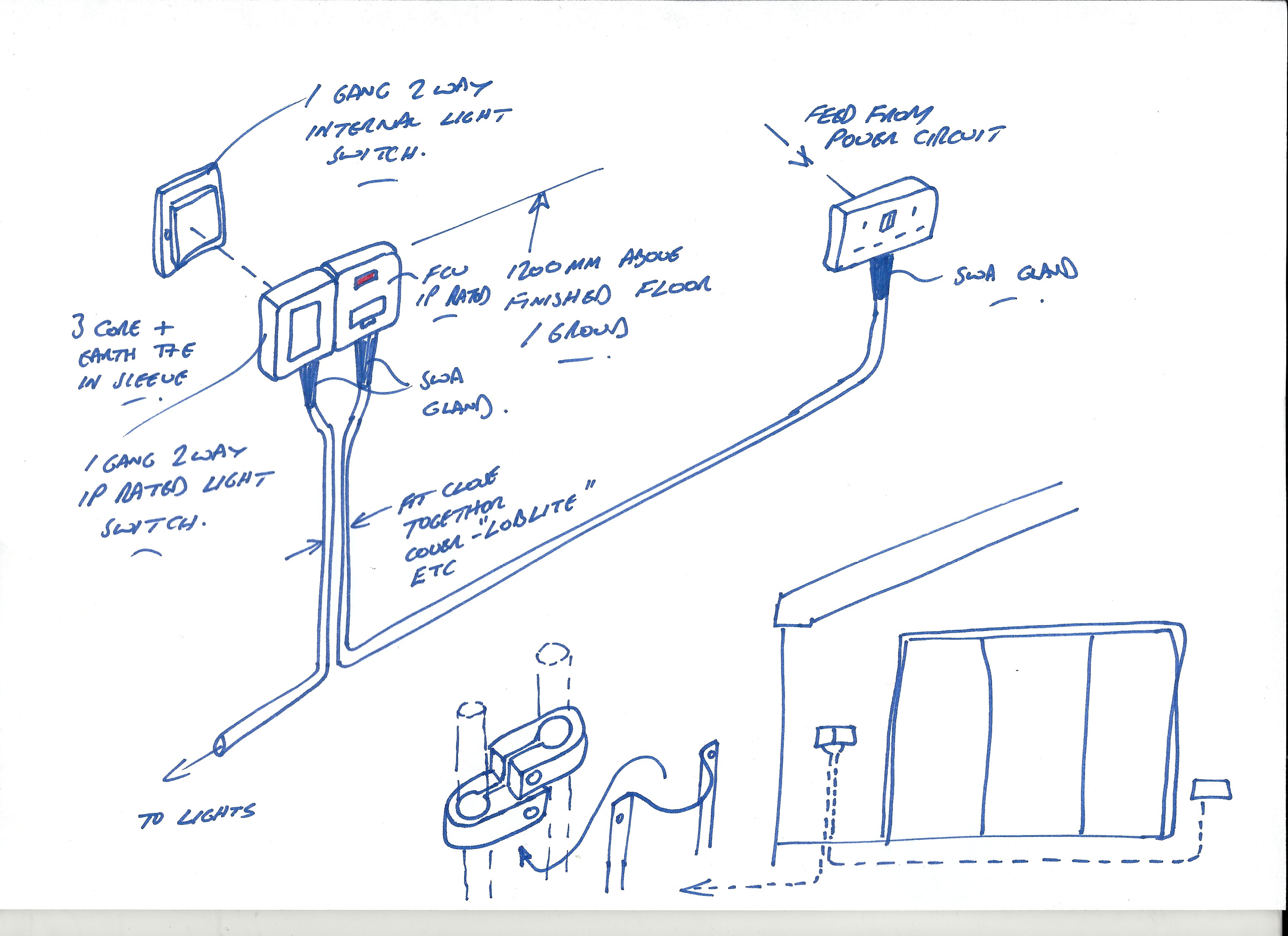

Nickfromwales Posted March 26, 2018 Share Posted March 26, 2018 1 hour ago, daiking said: So that would also need to be wired to an ugly outdoor switch? https://www.screwfix.com/p/bg-1g-2-way-sp-ip66-20a-switch/54649 but 4core would mean I could also have a switch inside? Yes, and kinda. Youll need one cable that powers the lights, live neutral and earth. From any junction you then create your switching circuit. Live to the 2-way switch Common terminal and L1 ofcthe switch goes to the lights as the "switched live" feed. From that switch you then need a 3-core and earth as a 'strapper' between that switch and the second switch. I'll add the configuration later but that's what you need to know for cables . Link to comment Share on other sites More sharing options...
Onoff Posted March 26, 2018 Share Posted March 26, 2018 That plastic "outdoor box" - is it two double sockets in there or just a terminal box ready for "something? Link to comment Share on other sites More sharing options...
daiking Posted March 26, 2018 Author Share Posted March 26, 2018 4 hours ago, Nickfromwales said: Yes, and kinda. Youll need one cable that powers the lights, live neutral and earth. From any junction you then create your switching circuit. Live to the 2-way switch Common terminal and L1 ofcthe switch goes to the lights as the "switched live" feed. From that switch you then need a 3-core and earth as a 'strapper' between that switch and the second switch. I'll add the configuration later but that's what you need to know for cables . Im not intending to DIY, . Just want to know where to take things to. To be honest I’d prefer the switch on the left (blue box) as that is the opening side of the bifolds and the green outline is where the outside lights are switched internally. So cable from sockets to blue box (switch) then cable to wherever I decide that I want lights. If I wanted an internal switch as well, would it need another cable from the blue box to the switch? (Hoping the mark up is visible) 3 hours ago, Onoff said: That plastic "outdoor box" - is it two double sockets in there or just a terminal box ready for "something? IP66 double socket. Now I’ve looked at it, it has many knockout ports. Link to comment Share on other sites More sharing options...
Onoff Posted March 26, 2018 Share Posted March 26, 2018 Like this? Link to comment Share on other sites More sharing options...
Nickfromwales Posted March 26, 2018 Share Posted March 26, 2018 Damn he's good lol. The only thing I'd add is that there may be a conflict of supplies in the internal switch if that's got the existing lighting feed in it, and then you take the outside live into it too. @Onoff / @ProDave, any issue with the two feeds sharing the same switch plate ? If not, then if the existing internal switch is a single or double, it can be bumped up to a double or triple ( 2 gang or 3 gang ) rather than make a new cut out for an additional switch to add the extra gang. Getting from the blue square to the green square can be done by fishing the cable down the cavity. Push some slack back on the cable, into the cavity, to get a drip loop. Link to comment Share on other sites More sharing options...
