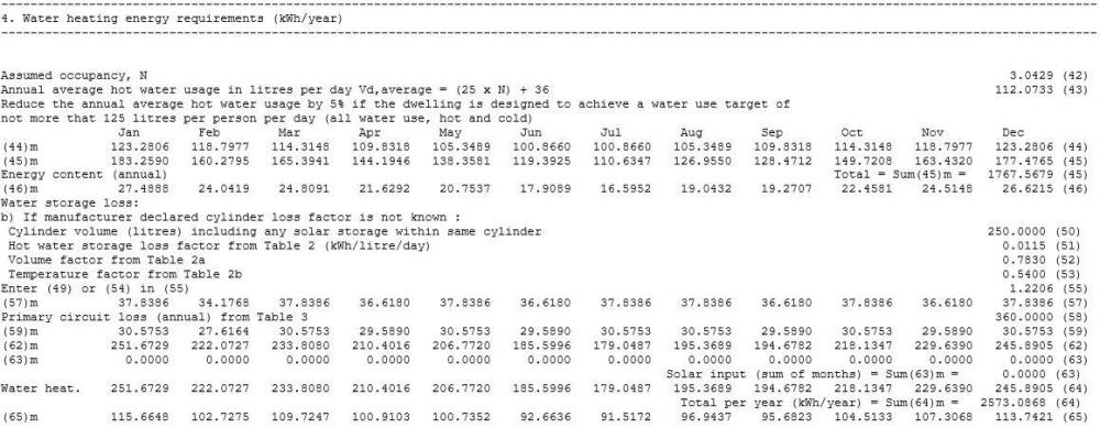

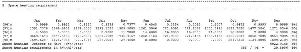

JohnW Posted March 11, 2018 Author Share Posted March 11, 2018 55 minutes ago, JohnW said: According to the as-designed SAP report... (which uses 0.15 U-value for external walls, which will actually be closer to 0.19 now we've changed the spec) DHW - 2500 kWh/year Space Heating - 5200 kWh/year Sorry @dpmiller I'm not sure if I have supplied the correct figures, here. Which section of the SAP 2009 report should I take them from? Link to comment Share on other sites More sharing options...

JohnW Posted March 12, 2018 Author Share Posted March 12, 2018 54 minutes ago, SteamyTea said: All a bit tricky, but 4 things to know first. The energy demand of your house The energy split e.g DHW and Space heating The instillation costs Thanks @SteamyTea, I have the as-designed SAP report but I'm not entirely sure which figures to lift as our energy demand, maybe you could tell me which ones from this selected extract; Section Water heating (kWh/year) Space heating (kWh/year) Calculation of Energy Ratings 2573.0868 5214.5496 Calculation of dwelling emissions for regulations compliance 2573.0868 6375.9114 Calculation of target emissions 2901.8514 18840.2881 Calculation of energy ratings for improved dwelling 1573.4793 5219.229 1 hour ago, SteamyTea said: Energy pricing for NI is here: Thanks for this info - it's very helpful. Thanks also for explaining the differences based on ASHP & gas/oil boiler. Link to comment Share on other sites More sharing options...
JohnW Posted March 12, 2018 Author Share Posted March 12, 2018 27 minutes ago, dpmiller said: Not convinced the average plumber is any use for anything other than oil/gascombi/ rads. Finding one as good as @Nickfromwales truly is a needle in a haystack. I tend to agree...on both counts. Link to comment Share on other sites More sharing options...
SteamyTea Posted March 12, 2018 Share Posted March 12, 2018 1 minute ago, JohnW said: Calculation of dwelling emissions for regulations compliance 2573.0868 6375.9114 That one I think. Link to comment Share on other sites More sharing options...
