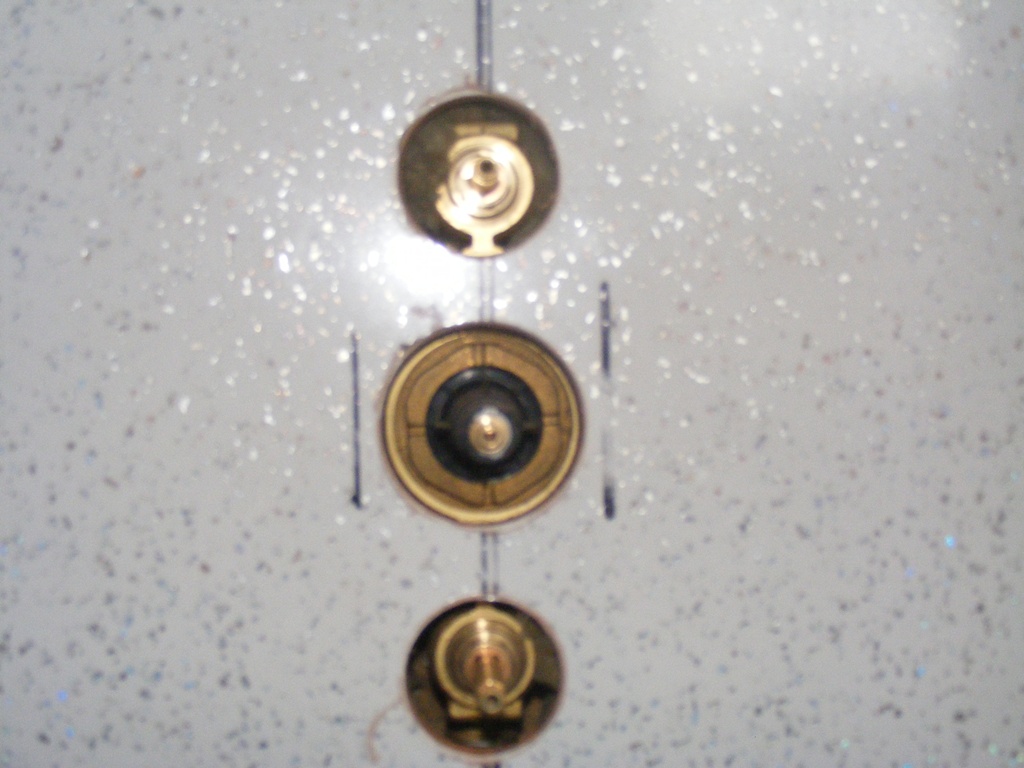

ProDave Posted March 22, 2018 Author Share Posted March 22, 2018 Here is something I suspect a lot of people overlook. The thermal mixer cartridge is quite big. To stand a chance of being able to change it in the future, you need quite a big hole. I drilled one 65mm diameter that is just about big enough. It's quite tight. Only about 6mm either side for the cover plate to cover, you need to be quite accurate with your drilling. The two black pen marks show where the cover plate covers to. I wonder how many people just drill a smaller hole like I have done for the top and bottom valves. That would be plenty to fit the cover tubes, but would be impossible to ever remove the thermal mixer cartridge and be "challenging" to later enlarge the hole. Link to comment Share on other sites More sharing options...
Onoff Posted March 22, 2018 Share Posted March 22, 2018 2 hours ago, ProDave said: Here is something I suspect a lot of people overlook. The thermal mixer cartridge is quite big. To stand a chance of being able to change it in the future, you need quite a big hole. I drilled one 65mm diameter that is just about big enough. It's quite tight. Only about 6mm either side for the cover plate to cover, you need to be quite accurate with your drilling. The two black pen marks show where the cover plate covers to. I wonder how many people just drill a smaller hole like I have done for the top and bottom valves. That would be plenty to fit the cover tubes, but would be impossible to ever remove the thermal mixer cartridge and be "challenging" to later enlarge the hole. Doesn't @Nickfromwales advocate deeming that tile sacrificial as and when? Link to comment Share on other sites More sharing options...
ProDave Posted March 22, 2018 Author Share Posted March 22, 2018 5 minutes ago, Onoff said: Doesn't @Nickfromwales advocate deeming that tile sacrificial as and when? Possible if it was a tile. This is a 2400 by 1200 sheet of "wet wall" and the way it joins in the corners into extruded profiles, you would sequentially have to remove 2 other panels first. Hence it has to be servicable from the front. 1 Link to comment Share on other sites More sharing options...
CC45 Posted March 22, 2018 Share Posted March 22, 2018 @ProDave - what about access to the filters? We've got the same shower - I've allowed for access to the filters - it from the front. Another 2 holes needed if you want that option. Link to comment Share on other sites More sharing options...
ProDave Posted March 22, 2018 Author Share Posted March 22, 2018 4 minutes ago, CC45 said: @ProDave - what about access to the filters? We've got the same shower - I've allowed for access to the filters - it from the front. Another 2 holes needed if you want that option. Where are the filters? There are none on the input or output ports and no mention in the instructions. There are two "unexplained" screws on the front labelled H and L are these what you talk about? I assumed there were high pressure / low pressure adjustment but have not touched them because again no mention of them in the instructions. I can drill further holes as long as they will be covered by the front plate. Link to comment Share on other sites More sharing options...
Onoff Posted March 22, 2018 Share Posted March 22, 2018 The filters appear to be the strainers, part number(s) 6 on the diagram: REI3417.pdf Link to comment Share on other sites More sharing options...
CC45 Posted March 22, 2018 Share Posted March 22, 2018 Those two screws sit on a hexagonal 'nut', undo it and you will find some plastic bits - filters in there. You can actually see the filters if you look in the hot and cold supply. Link to comment Share on other sites More sharing options...
ProDave Posted March 23, 2018 Author Share Posted March 23, 2018 8 hours ago, CC45 said: Those two screws sit on a hexagonal 'nut', undo it and you will find some plastic bits - filters in there. You can actually see the filters if you look in the hot and cold supply. Ah I see now. To get to those I can simply cut with the multi tool to join the 3 holes I have drilled into one big opening, so easy to do in situ. Shame there was no mention of them in the instructions. Link to comment Share on other sites More sharing options...
Nickfromwales Posted March 23, 2018 Share Posted March 23, 2018 9 minutes ago, ProDave said: Ah I see now. To get to those I can simply cut with the multi tool to join the 3 holes I have drilled into one big opening, so easy to do in situ. Shame there was no mention of them in the instructions. They're not just filters. They also look to be the NRVs too. . Link to comment Share on other sites More sharing options...
CC45 Posted March 23, 2018 Share Posted March 23, 2018 They are nrv as well - noticed that while pressure testing them. The plate supplied does need to be slightly wider. Link to comment Share on other sites More sharing options...
