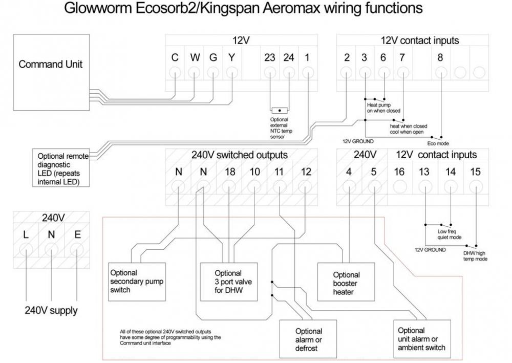

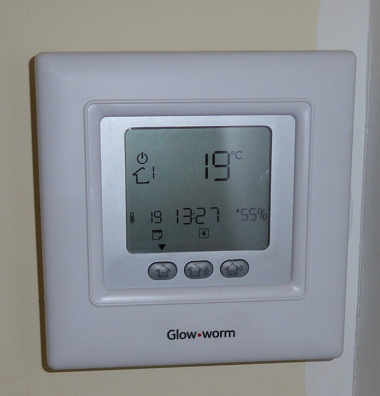

Jeremy Harris Posted July 2, 2016 Share Posted July 2, 2016 The Command Unit is definitely useful, as apart from allowing all the myriad of settings to be programmed to the unit (flow temperatures for heating and cooling, weather compensation curves, cut off limits etc) and acting as a combined thermostat and timer/programmer (if you are OK using its internal temperature sensor) it also has a display that tells you pretty much exactly what the ASHP is doing, so shows the flow temp, whether it's heating or cooling (or defrosting) and gives a one-button way of putting the unit into "holiday mode". You can use the Command Unit as the primary thermostat and programmer, if you wish, although I'd be the first to say that it isn't a particularly intuitive thing to use in this way. Had I realised that the Command Unit was as versatile as it is, then I would have run the cable for it to the hall, so I could have used it as the main thermostat and programmer. It has the ability to programme spare relays in the ASHP and they could be used to operate valves, an UFH pump etc, I think. Link to comment Share on other sites More sharing options...
Guest Alphonsox Posted July 2, 2016 Share Posted July 2, 2016 11 minutes ago, JSHarris said: Had I realised that the Command Unit was as versatile as it is, then I would have run the cable for it to the hall, so I could have used it as the main thermostat and programmer. I think this would only work if a buffer tank isn't being used. I can't see a way to let the buffer tank thermostat tell the controller it wants heat. Link to comment Share on other sites More sharing options...
Jeremy Harris Posted July 2, 2016 Share Posted July 2, 2016 If the buffer tank thermostat separately controlled the isolation valve and the no-volt contacts on the ASHP, then perhaps it would over-ride the Command Unit? I'm not sure, TBH, as I concentrated on trying to decode and reverse-engineer things from the Glowworm manual, before you found the Carrier information, but it seems possible. All the buffer tank control has to do is over-ride the heating/cooling selection, set the ASHP to heating mode, open the isolating valve to allow the buffer to take the heat pump flow and, perhaps, close the UFH isolating valve to prevent heating the floor if the ASHP was in cooling mode. A simple thermostat and a relay would do this OK, or a thermostat and an isolating valve with a dry contact switch in it to select the ASHP mode.. Link to comment Share on other sites More sharing options...

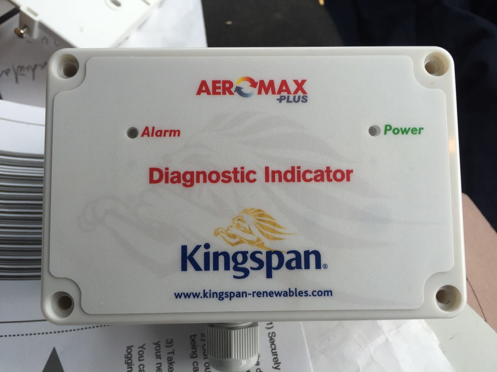

Inchbyinch Posted July 2, 2016 Share Posted July 2, 2016 Is the command controller The same as the diagnostic box? Link to comment Share on other sites More sharing options...
Guest Alphonsox Posted July 2, 2016 Share Posted July 2, 2016 No its not - As far as I can tell the diagnostic box is a bit of Kingspan tat only containing a couple of LEDs. I have added details on the controller to the thread above (Carrier 33aw-cs1) Link to comment Share on other sites More sharing options...
Jeremy Harris Posted July 2, 2016 Share Posted July 2, 2016 That's right. There is an alarm LED outputs on the wiring panel and that, together with the 12V power, just feed the LEDs in this otherwise empty box. If you wanted the same diagnostics, then two 10p LEDs connected to the connector strip would do the same job.................. The alarm LED may also be duplicated on the circuit board in the unit - it is in mine - so you can read out the code by just taking the cover off. 1 Link to comment Share on other sites More sharing options...
Inchbyinch Posted July 2, 2016 Share Posted July 2, 2016 I think I might have found one on an Italian site, look like the one? cheers for all the help on these, it's a mine field but very easy to navigate if you follow some good foot steps!! https://www.climamarket.it/vendita/termostato-programmabile-per-pompe-di-calore-carrier Link to comment Share on other sites More sharing options...

Jeremy Harris Posted July 2, 2016 Share Posted July 2, 2016 3 hours ago, Inchbyinch said: I think I might have found one on an Italian site, look like the one? cheers for all the help on these, it's a mine field but very easy to navigate if you follow some good foot steps!! https://www.climamarket.it/vendita/termostato-programmabile-per-pompe-di-calore-carrier That's the same as the Command Unit I have, just with the Carrier logo rather than the Glowworm logo that's on mine: 1 Link to comment Share on other sites More sharing options...
