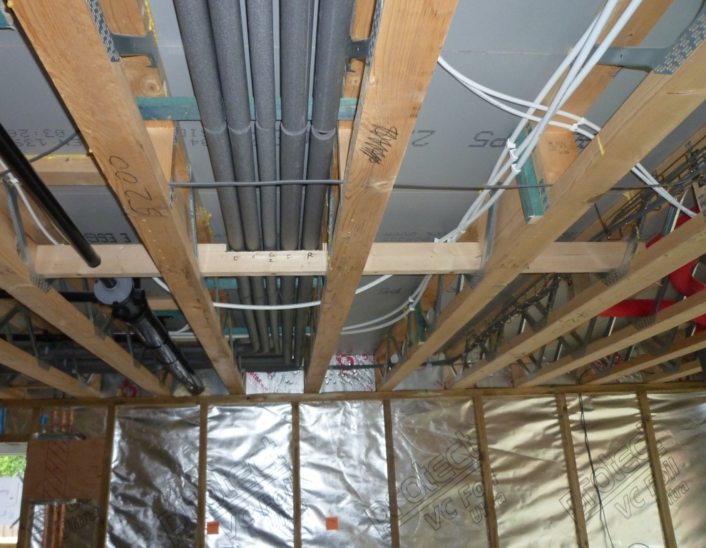

RandAbuild Posted February 28, 2018 Posted February 28, 2018 Here's a pic of some of our service runs in pozijoists. The main cable routes were contained in baskets secured along the length of the joist - very neat solution 1

epsilonGreedy Posted March 1, 2018 Author Posted March 1, 2018 @RandAbuild - your photo is very helpful particularly the basket idea for cradling the electric cables. Did you find you needed to think ahead and load up the joist void with extra timber to be used later for service supports? I note the larger diameter black pipe running through the wood support, was that wooden support too large to thread into place after the joists were fixed in position?

PeterW Posted March 1, 2018 Posted March 1, 2018 11 minutes ago, epsilonGreedy said: @RandAbuild - your photo is very helpful particularly the basket idea for cradling the electric cables. Did you find you needed to think ahead and load up the joist void with extra timber to be used later for service supports? I note the larger diameter black pipe running through the wood support, was that wooden support too large to thread into place after the joists were fixed in position? Soil pipes need to run parallel to any joist unless you add it when building the floor otherwise you have to leave the end off the building....

PeterW Posted March 1, 2018 Posted March 1, 2018 1 minute ago, epsilonGreedy said: Ok but I am not sure why this thread keeps veering towards trade standards. When running your mains cabling through the posi joist void did you implement a metal tray support plinth as described by @jsharris or did you invent a cradle system as shown in the first photo in this thread? None of the above...! Sparks used either cable clips on the sides of the posijoists, or where a bundle of cable was created then there is a standard plastic coated strap used to keep them tidy - all standard detail as per the site guide which is the requirement of the Wiring Regulations. That is what you have to follow - not a joist manufacturers installation guide as they are not the expert in this case 1
