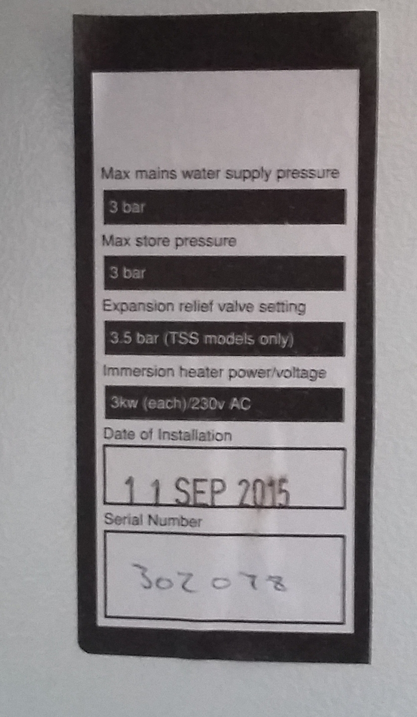

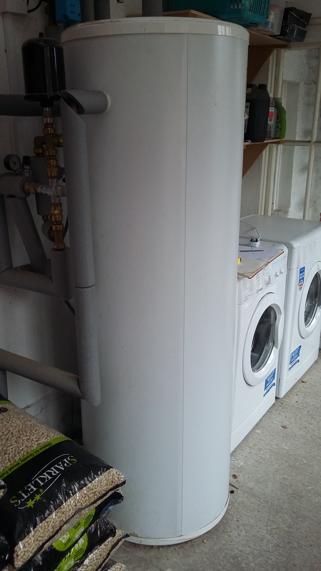

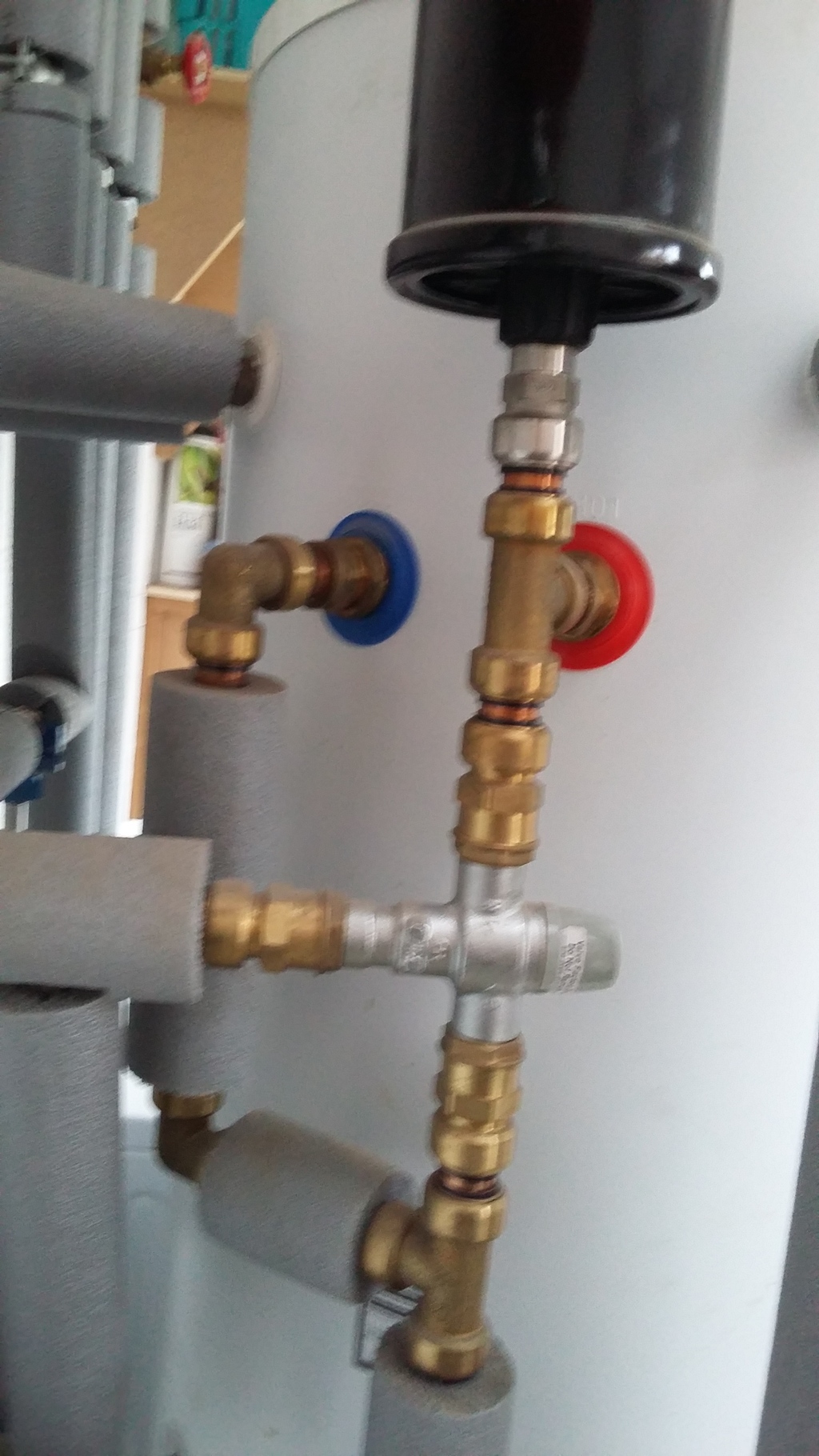

ProDave Posted February 26, 2018 Posted February 26, 2018 On a job I am working on. This is the hot water tank used on conjunction with a wood pellet stove. The whole system is about to be ripped out and this tank may be going begging. I am trying to work out exactly what it is, and can I do anything useful with it. First off, I cannot find a manufacturers name anywhere on it. It measures 22" diameter and 65" tall It is clearly unvented. Almost all of the ports are not labelled. To the left connects the wood pellet Boiler. Just 2 pipes one top and one bottom go to the boiler and nowhere else. At the back a top and bottom port connect to what I believe is the flow and return to the radiators (via a pump) An additional top port connects to a 50L expansion vessel, an over pressure relief valve and a fill loop. The only 2 ports that are labelled are "hot" and "cold" that appear to be fed with mains cold water and output via a thermal mixing valve. I believe the black thing is a tiny expansion vessel? it has a Schroeder valve on the top. The ONLY label on the tank is this one so I don't even know it's capacity My thinking is it must be a thermal store (the hot / cold and blending valve looks like an output loop to me) or some kind of tank within a tank arrangement? The thing that puzzles me is if it is a thermal store, then it's the first unvented thermal store I have ever seen.
PeterW Posted February 26, 2018 Posted February 26, 2018 Looks like a McDonald Engineering TS. Black thing is an expansion to allow the coil water to expand.
ProDave Posted February 26, 2018 Author Posted February 26, 2018 So all the various top and bottom ports just connect to the store volume as simple as that? There is also one immersion heater, and 2 thermostat pockets one near the bottom, one half way up. Any idea from the size what volume it might be?

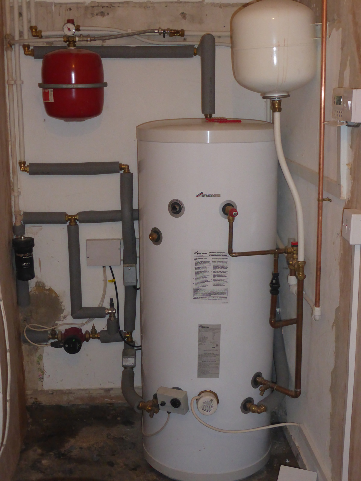

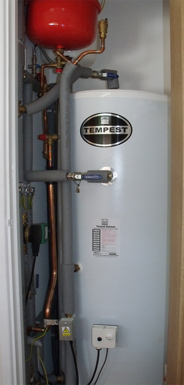

Onoff Posted February 26, 2018 Posted February 26, 2018 Looking at the lip on the plastic top then Tempest (or maybeWorcester)?
Nickfromwales Posted February 26, 2018 Posted February 26, 2018 Deffo a TS. Id say 300l at a guess, possibly 350l.
Declan52 Posted February 26, 2018 Posted February 26, 2018 I have a 350l and that looks slightly smaller. Mine is 22 inches X 72 inches. 1
ProDave Posted February 26, 2018 Author Posted February 26, 2018 If it were a (Telford) Tempest the ports would be labelled and I am sure they would have their name on it I can't see it is any use to me as a hot water tank as I really want an UVC not a thermal store (thermal store needs a hotter temperature to get a decent amount of hot water capacity so not really suitable) I am wondering if it has a future as a heating buffer tank. I had been planning an indirect tank for the heating buffer so I only have a small circuit filled with antifreeze circulating water from the heat pump to the cylinder(s) Any thoughts on using this as a heating buffer and using a plate heat exchanger between the small heat pump circuit and the larger thermal store volume? I guess that would need a circulating pump on the thermal store side of the PHE?
