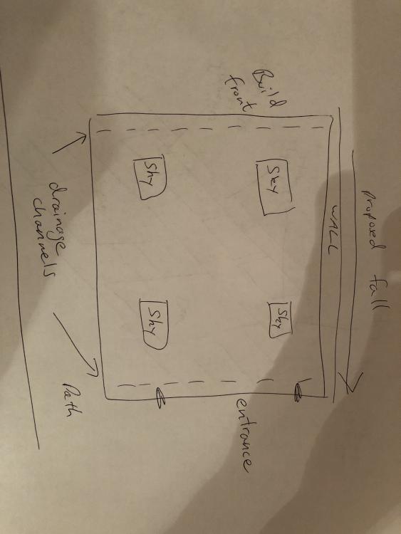

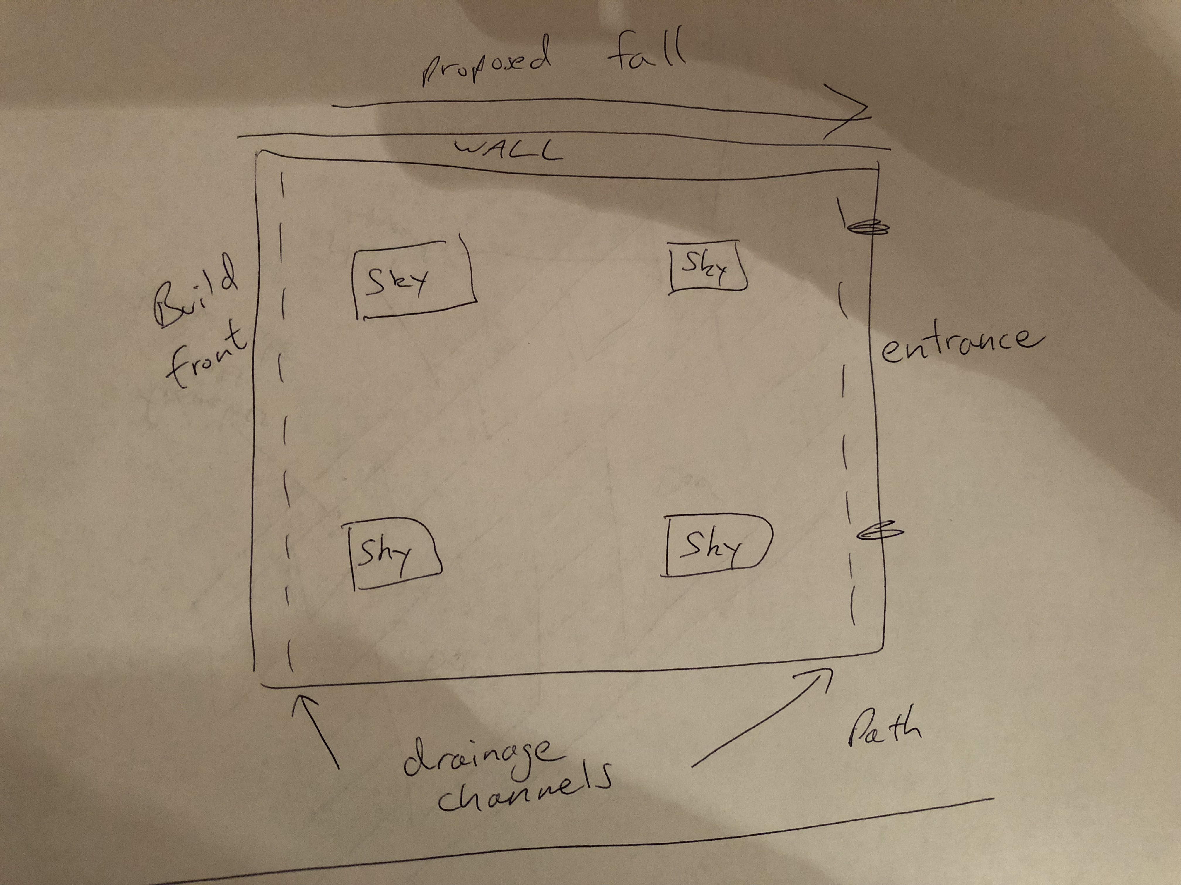

Pocster Posted February 18, 2018 Author Share Posted February 18, 2018 (edited) 54 minutes ago, SteamyTea said: @pocsterI am a bit tied up at the moment, but shall come back and give my thoughts on how to do your layup. Any chance that you can post a picture or sketch up of the two run off areas and any these up stands. It may help clarify what you are trying to do. Basically GRP is easy to put into a corner/edge, harder to put over a corner/edge. Bondage on a Sunday ? Here's a *rough* site plan. The drainage channel's will be added after i.e sit on top the EDPM/GRP. 'Path" and the wall are 'outside' the below ground construction. Another issue (there are so many!) is I really need to gain height!. At the house from current slab to build is 38cm, at the front (entrance via gate) is 18cm. If OSB is required whether GRP or EDPM that looses another 18mm!!. Tempted (without telling architect!) to put zero insulation in (to save height). Would insulate underneath i.e. in ceiling with celotex or if ceiling height becomes an issue aerogel (ignoring the £££££). I *assume* that altering that insulation layer wouldn't be an issue (MHVR so presumably no condensation issues). Saves me 50mm 'moving it'...... Any views on that appreciated also. Strangely enough companies that only sell GRP recommend that; companies that only sell EDPM recommend that - how strange! Edited February 18, 2018 by pocster Link to comment Share on other sites More sharing options...

SteamyTea Posted February 18, 2018 Share Posted February 18, 2018 On 2/17/2018 at 18:31, pocster said: reinforced concrete high compressive insulation osb ? If using edpm or just grp reinforced poured concrete chippings sand driveway blocks Just had a look at your build up, any change of putting some measurements onto it. I am envisaging a platform to park cars on. The platform is built over something. Is that right? As the GRP is only for waterproofing, it could go onto thinner board, possibly 3mm ply. It is really only to make the lay up easy and stable. I don't think it is there to add anything structural. I can see where the wall is and the drain challenges. It would be usual to have the drainage built into the platform. Is there walls either side of them and that is why are two of them. A 3D sketch may be more useful as I am struggling to understand it. How high up do the skylights stand. As long as there is 100 mm, then bonding to that should not be a problem. Does depend on the radii at the corners. There are ways around that though. Link to comment Share on other sites More sharing options...
Pocster Posted February 18, 2018 Author Share Posted February 18, 2018 2 minutes ago, SteamyTea said: Just had a look at your build up, any change of putting some measurements onto it. I am envisaging a platform to park cars on. The platform is built over something. Is that right? As the GRP is only for waterproofing, it could go onto thinner board, possibly 3mm ply. It is really only to make the lay up easy and stable. I don't think it is there to add anything structural. I can see where the wall is and the drain challenges. It would be usual to have the drainage built into the platform. Is there walls either side of them and that is why are two of them. A 3D sketch may be more useful as I am struggling to understand it. How high up do the skylights stand. As long as there is 100 mm, then bonding to that should not be a problem. Does depend on the radii at the corners. There are ways around that though. ? I’ll attempt ! reinforced concrete : this is done high compressive insulation : only 50mm ( meant to be 120mm ) causes me issues anyway osb ? If using edpm or just grp : this will add 20mm reinforced poured concrete : SE wants 75mm chippings : whatever :-) sand :-) whatever driveway blocks : 50mm as you can see 180mm at the front is an issue . upstands ; well glass is 64mm ; so 100mm for up stands min . grp or edpm not structural . nothing either side of drainage channels . One near the house to ‘protect’ it ; other to deal with run off from sloped finish . cheers Link to comment Share on other sites More sharing options...
SteamyTea Posted February 18, 2018 Share Posted February 18, 2018 The way I see it then is that the GRP is just waterproofing. So can be put directly onto the insulation. If that insulation is glass tissue covered. 3 layers of 450 gm.m2 matt with a flow coat will do that as the strength is in the reinforced concrete pour above it. There will need to be some detailing for the drainage channels, but that would need some more information as to what you want it to look like. With the final reinforced slab being 75mm thick, bolting the balustrade to it may be a problem. Is it possible to have some plates with threaded studs fitted into the correct place (I was a toolmaker, not a builder so working to 1000th of an inch is normal to me). Or you could have plates fitted and then drill and tap after (probably safer). That would need a structural engineers input. At the interface of the drainage channels and the reinforced concrete below it I would fit a pre moulded section. Probably make the interface and the 'gutter' as one, then lay some GRP over it. I am not sure how they would detail with with a rubber sheet, sorry EDPM, but suspect that they would do something similar. What are the overall dimensions? Some consideration may be needed for thermal expansion. Link to comment Share on other sites More sharing options...
Pocster Posted February 18, 2018 Author Share Posted February 18, 2018 7 minutes ago, SteamyTea said: The way I see it then is that the GRP is just waterproofing. So can be put directly onto the insulation. If that insulation is glass tissue covered. 3 layers of 450 gm.m2 matt with a flow coat will do that as the strength is in the reinforced concrete pour above it. There will need to be some detailing for the drainage channels, but that would need some more information as to what you want it to look like. With the final reinforced slab being 75mm thick, bolting the balustrade to it may be a problem. Is it possible to have some plates with threaded studs fitted into the correct place (I was a toolmaker, not a builder so working to 1000th of an inch is normal to me). Or you could have plates fitted and then drill and tap after (probably safer). That would need a structural engineers input. At the interface of the drainage channels and the reinforced concrete below it I would fit a pre moulded section. Probably make the interface and the 'gutter' as one, then lay some GRP over it. I am not sure how they would detail with with a rubber sheet, sorry EDPM, but suspect that they would do something similar. What are the overall dimensions? Some consideration may be needed for thermal expansion. Thanks balustrade??? Lol there isn’t any ? I did suggest to the Architect to cast the drainage channel in situ ; but he wasn’t happy and wanted standard anco type product .haunched ontop the grp and obviously flush with finished level . total area is question is approx 6m x 6m cheers Link to comment Share on other sites More sharing options...
SteamyTea Posted February 18, 2018 Share Posted February 18, 2018 Is it something like this? Link to comment Share on other sites More sharing options...
SteamyTea Posted February 18, 2018 Share Posted February 18, 2018 Link to comment Share on other sites More sharing options...
