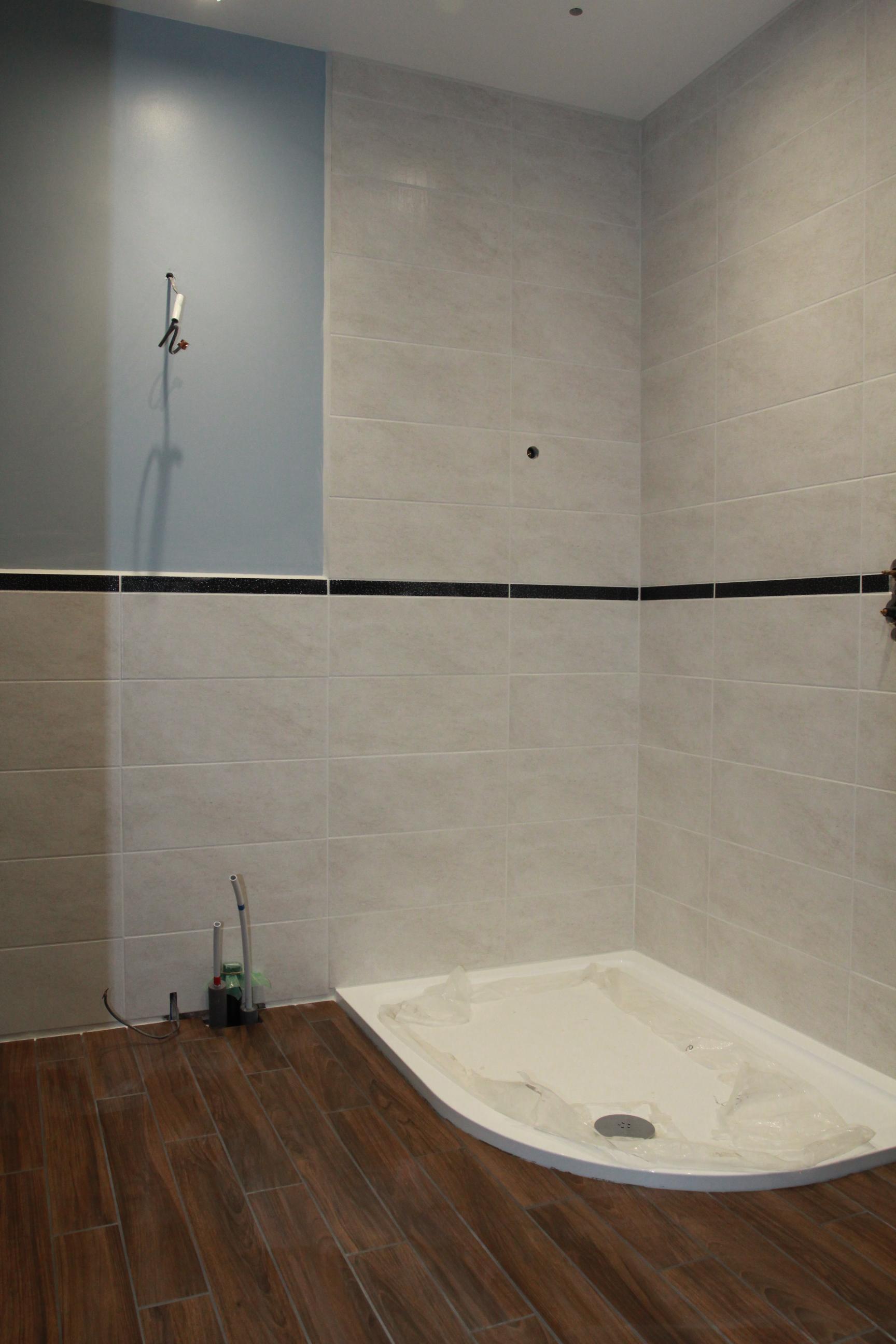

newhome Posted December 2, 2018 Posted December 2, 2018 Yeah it looks good.Gap looked wider than a single mosaic in the previous photo, but fine if there are no awkward half bits

CC45 Posted December 2, 2018 Posted December 2, 2018 3 hours ago, Onoff said: Where d'you mean, the window reveal? no, the long length above the toilet & bath. There might be a gap that doesn't show on the pic.
Onoff Posted December 2, 2018 Author Posted December 2, 2018 2 minutes ago, CC45 said: no, the long length above the toilet & bath. There might be a gap that doesn't show on the pic. You've lost me...bath and wc are on opposite walls...
Onoff Posted December 2, 2018 Author Posted December 2, 2018 7 minutes ago, CC45 said: sink and bath. nice kebab? Sorry still not getting what you mean. Humous was the best bit followed by the cajik.
CC45 Posted December 2, 2018 Posted December 2, 2018 Where youve stuck that strip of tiles vertically above the shelf above where the sink is going. A pic showed you marking out for the trip before you stuck it down ready for tiling.
Onoff Posted December 2, 2018 Author Posted December 2, 2018 14 minutes ago, CC45 said: Where youve stuck that strip of tiles vertically above the shelf above where the sink is going. A pic showed you marking out for the trip before you stuck it down ready for tiling. Erm...the grey wall tiles come up where the sink is going and you hit the white trim where the narrow full width shelf is that spans across the sink and bath. To the rear of this shelf is the "3 high" mosaic upstand. There is deliberately no horizontal grout line where the mosaics come down onto the shelf. If that's what you mean?
Onoff Posted December 2, 2018 Author Posted December 2, 2018 1 minute ago, CC45 said: Yep. All by design so thats chipper. HWMBO from Swansea said to do it like this albeit with Sika EBT or CT1 rather than the mixture of the two Evo Stick products I've used.
