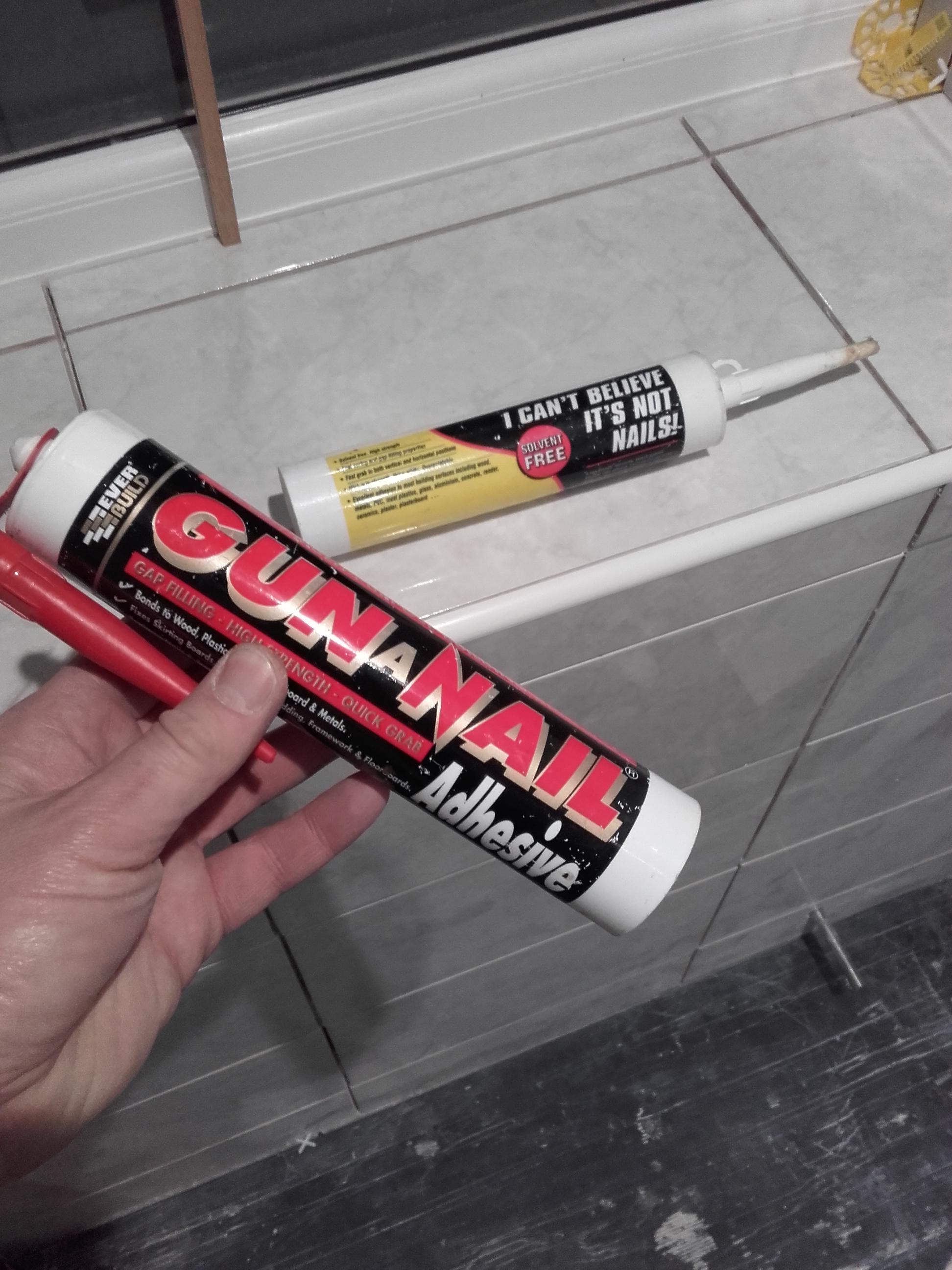

Onoff Posted December 2, 2018 Author Posted December 2, 2018 In the absence of anywhere open to get CT1 today I thought I'd give this a try: Going to use it to stick some tile trim on where I would have used clear CT1. Maybe also the mosaic strip across the long shelf above the bath. Tbh it's nearly a tenner a tube. I can get CT1 at the local BM for just under £8. Be interesting to see if baby wipes take it off.
Onoff Posted December 2, 2018 Author Posted December 2, 2018 (edited) That's the reveal done then. Loving this Sticks Like Sh!t! Edited December 2, 2018 by Onoff 1

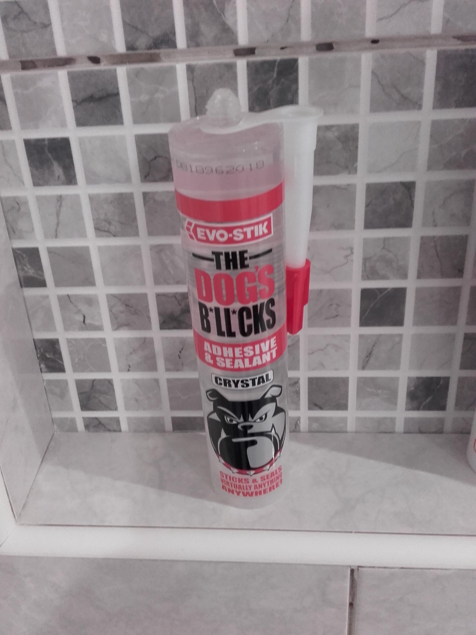

Onoff Posted December 2, 2018 Author Posted December 2, 2018 5 minutes ago, newhome said: You're smashing it today! Go plain because having half squares of mosaics will show imperfections more and I doubt you'll get an even 2 squares in that strip. Tiling in a tube helps! Giving me the confidence to "silicon" them to the ply bath surround as I said but still mulling which product. It is just so damn easy compared to mixing up adhesive. I used the crystal clear Evo Stick The Dogs B*ll*cks to stick this trim up. Seems to behave like CT1 and comes off with baby wipes much the same.
