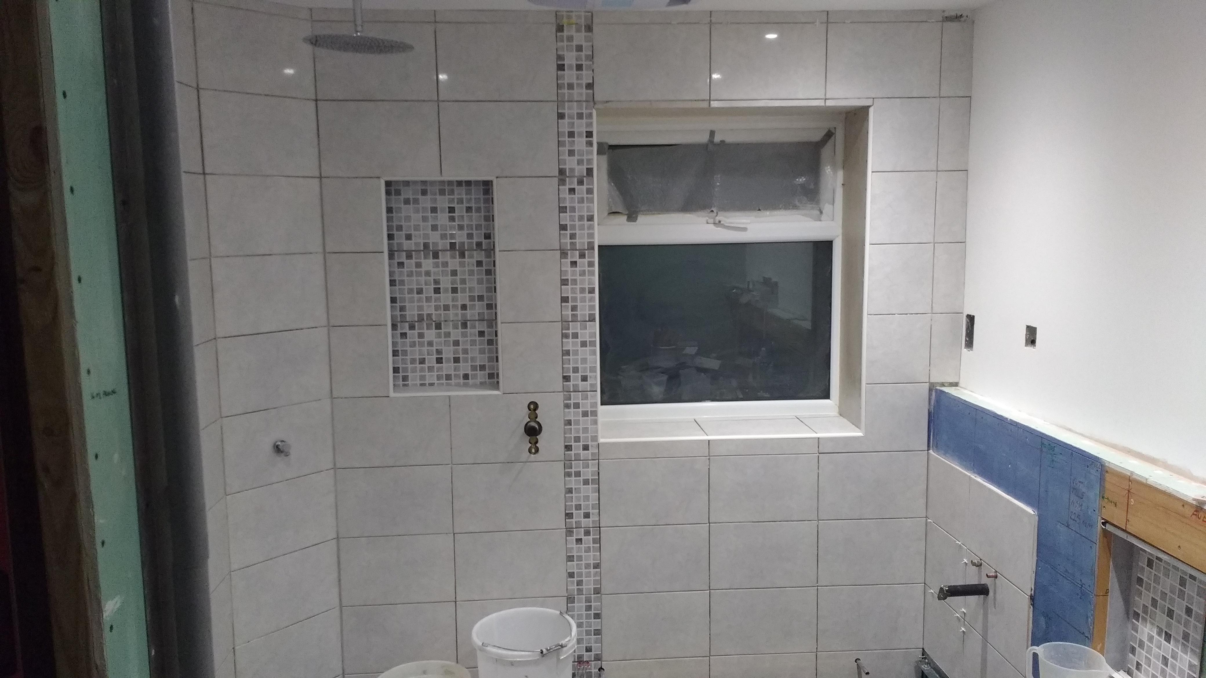

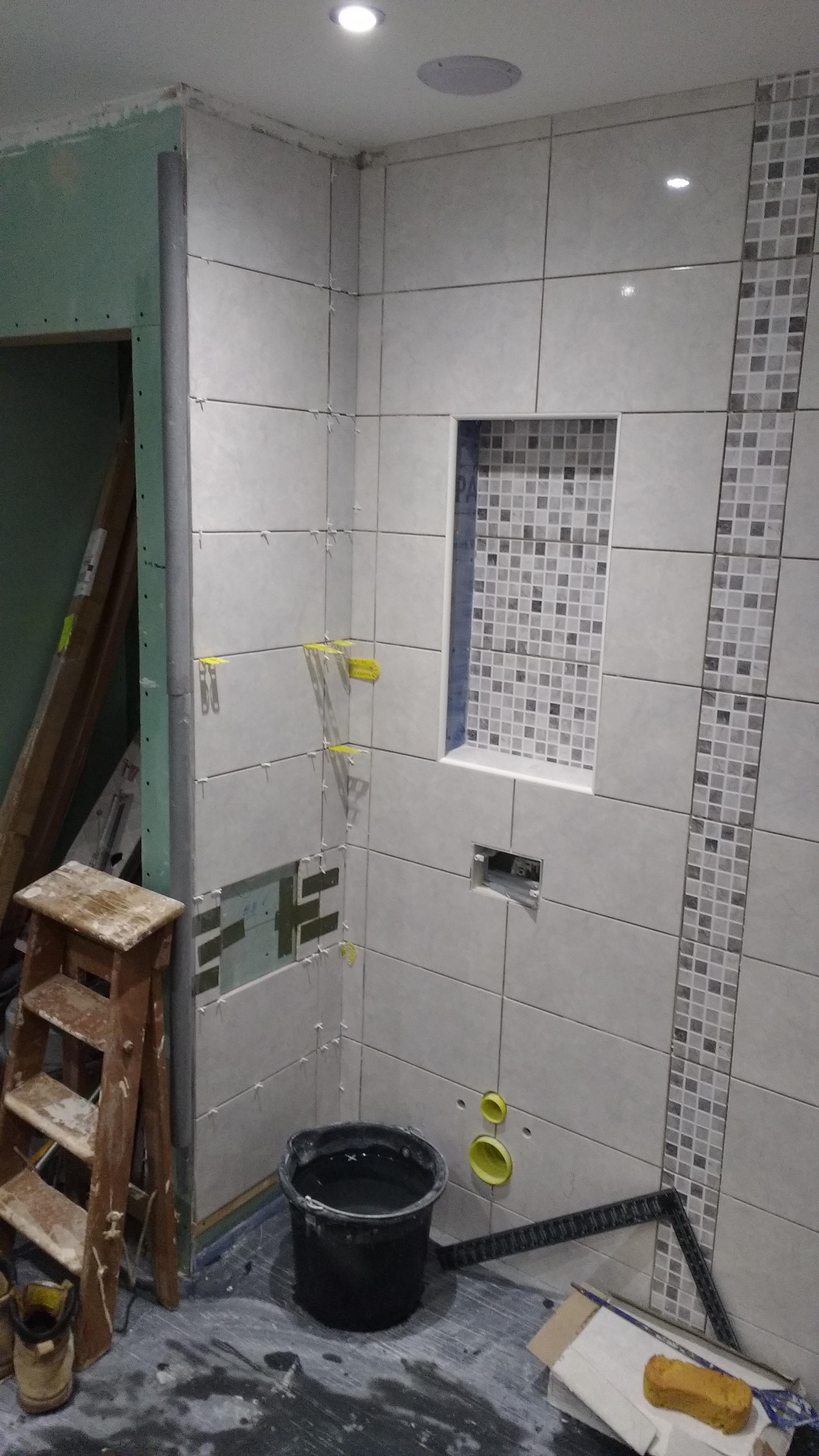

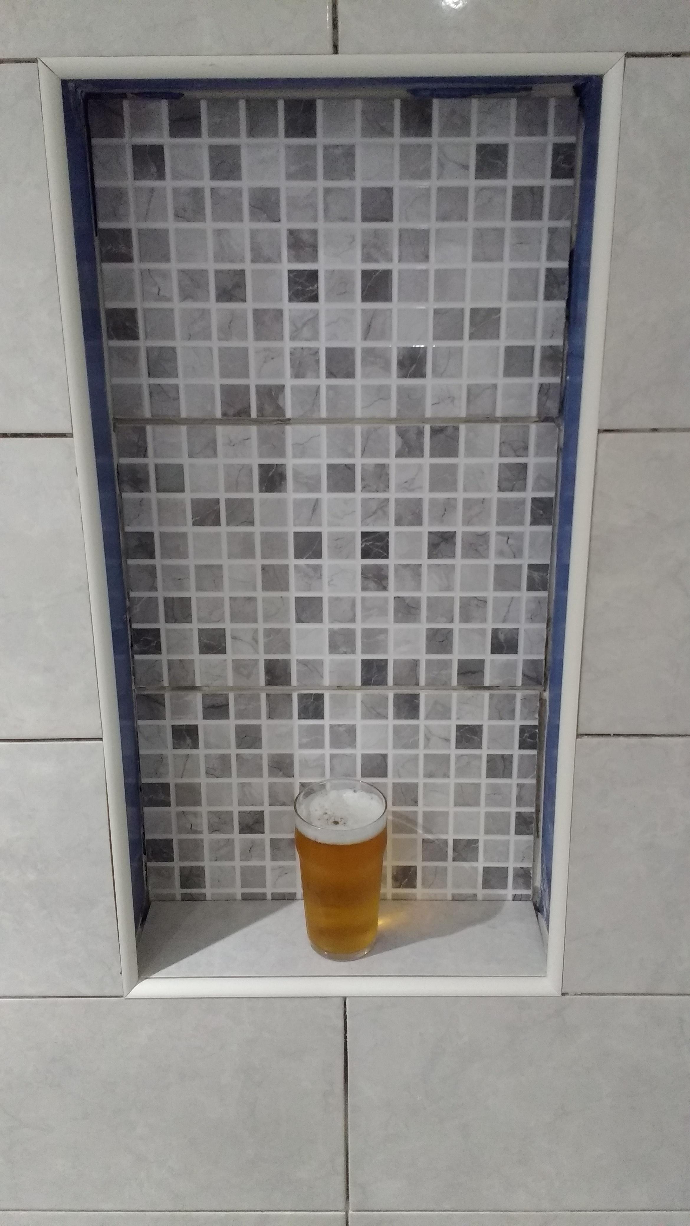

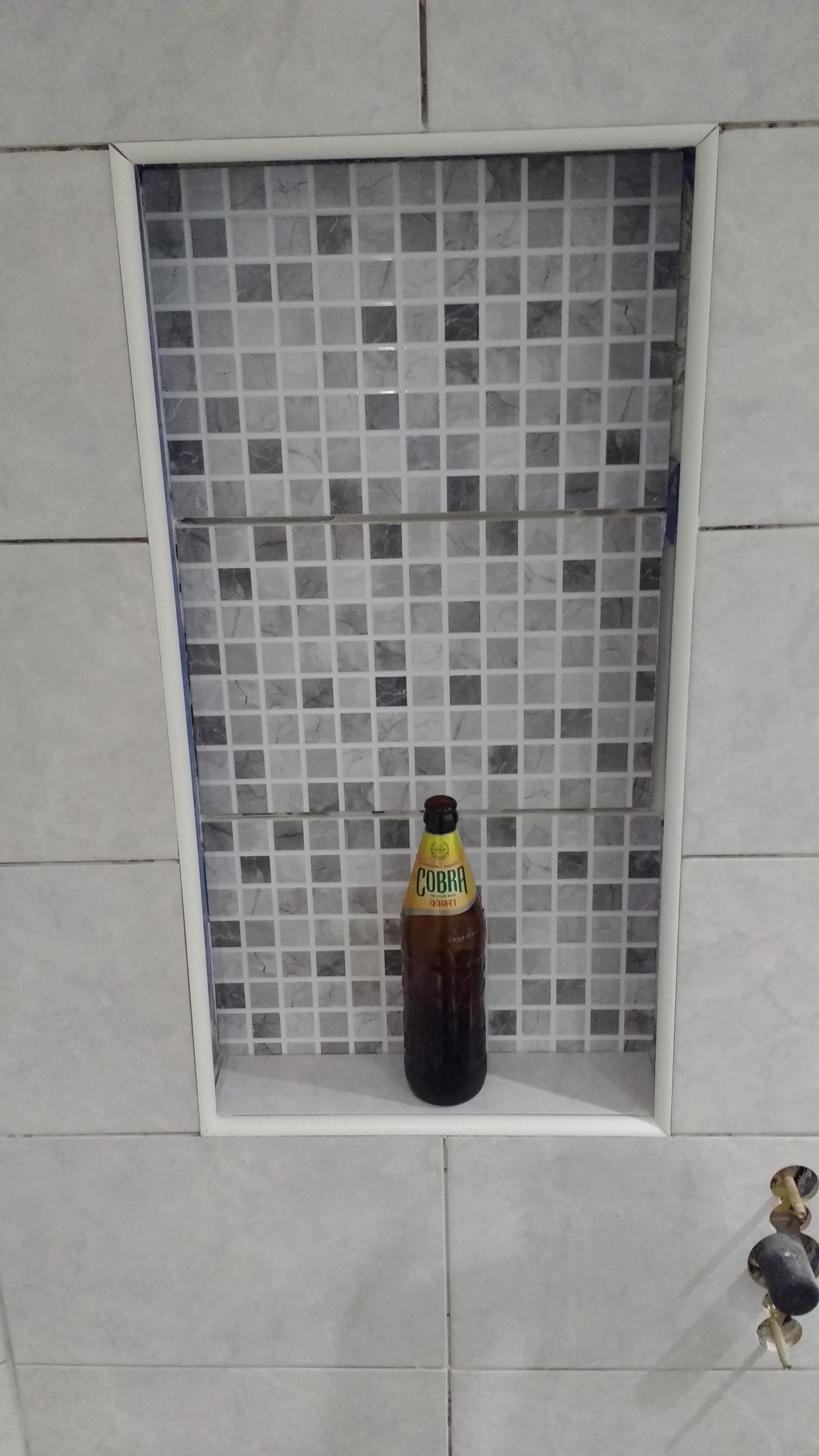

Onoff Posted November 10, 2018 Author Share Posted November 10, 2018 A few more fiddly bits. The 3 pocket "sills", quite pleased although all at v.slightly different angles as different depths. Tried to align with the mosaics: The window sill, it's "alright". Had to have the back of one joint at about 4mm rather than 3. And a few tiles on the return by the wc. One tile left out for the loo roll holder. SWMBO, amazingly, is quite taken with my idea for a stacking, inset loo roll holder / dispenser. She did however say to finish the rest first! 3 Link to comment Share on other sites More sharing options...
Onoff Posted November 10, 2018 Author Share Posted November 10, 2018 That's enough for today: Beer o'clock! 2 Link to comment Share on other sites More sharing options...

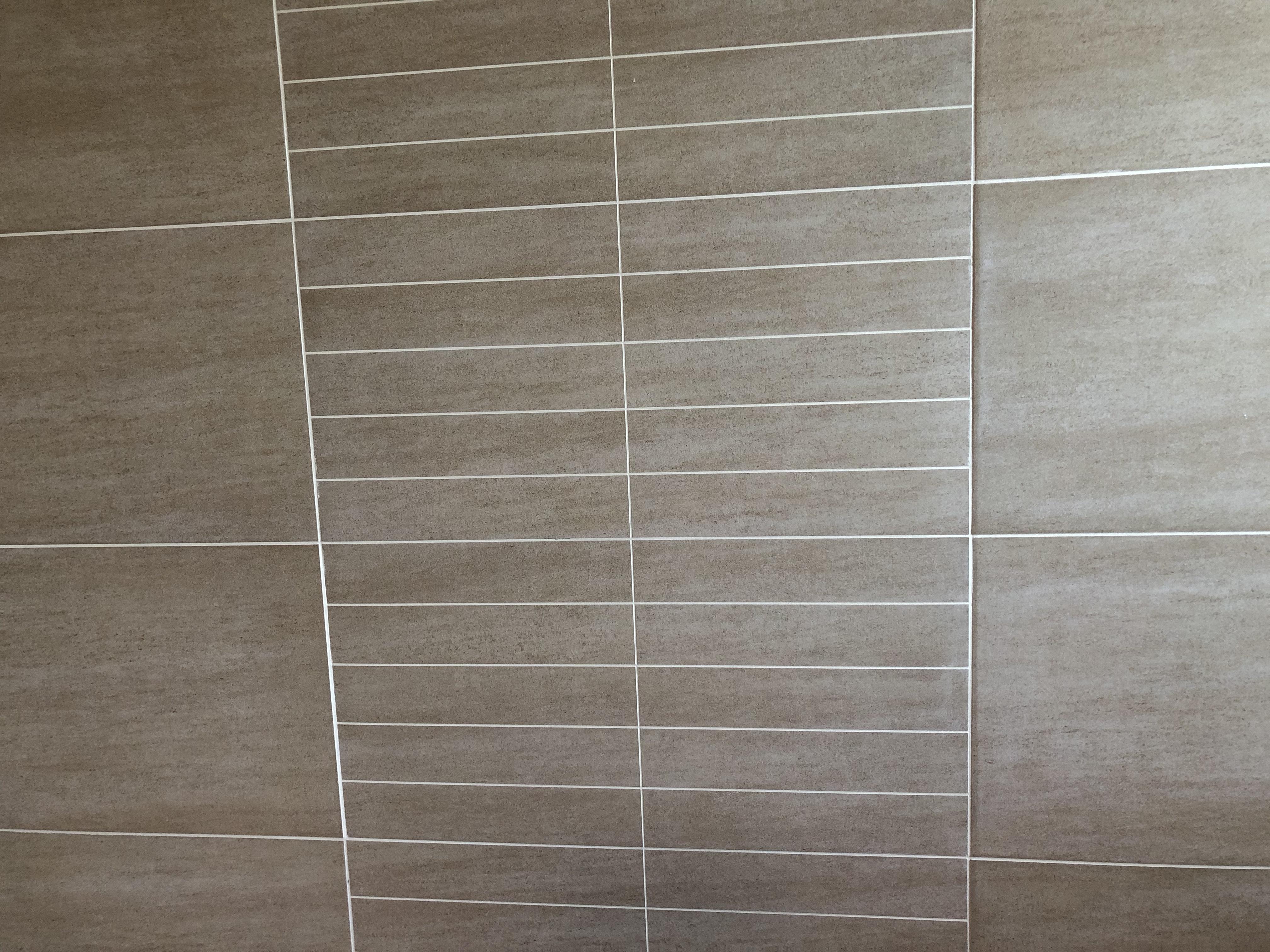

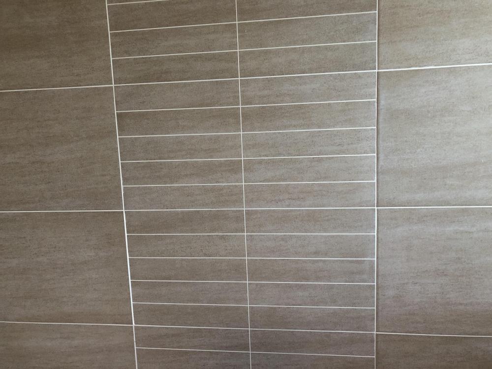

newhome Posted November 11, 2018 Share Posted November 11, 2018 1 hour ago, Onoff said: I'm unsure tbh how real grout lines will look against the faux ones. Not mosaics but faux and real grout lines 1 1 Link to comment Share on other sites More sharing options...

newhome Posted November 11, 2018 Share Posted November 11, 2018 Where's the bath?! Or is that from way back? It looks like your faux grout may be shiny rather than matt? That may be harder to blend in unless you pick a grout that has a shine to it if such a thing exists Link to comment Share on other sites More sharing options...

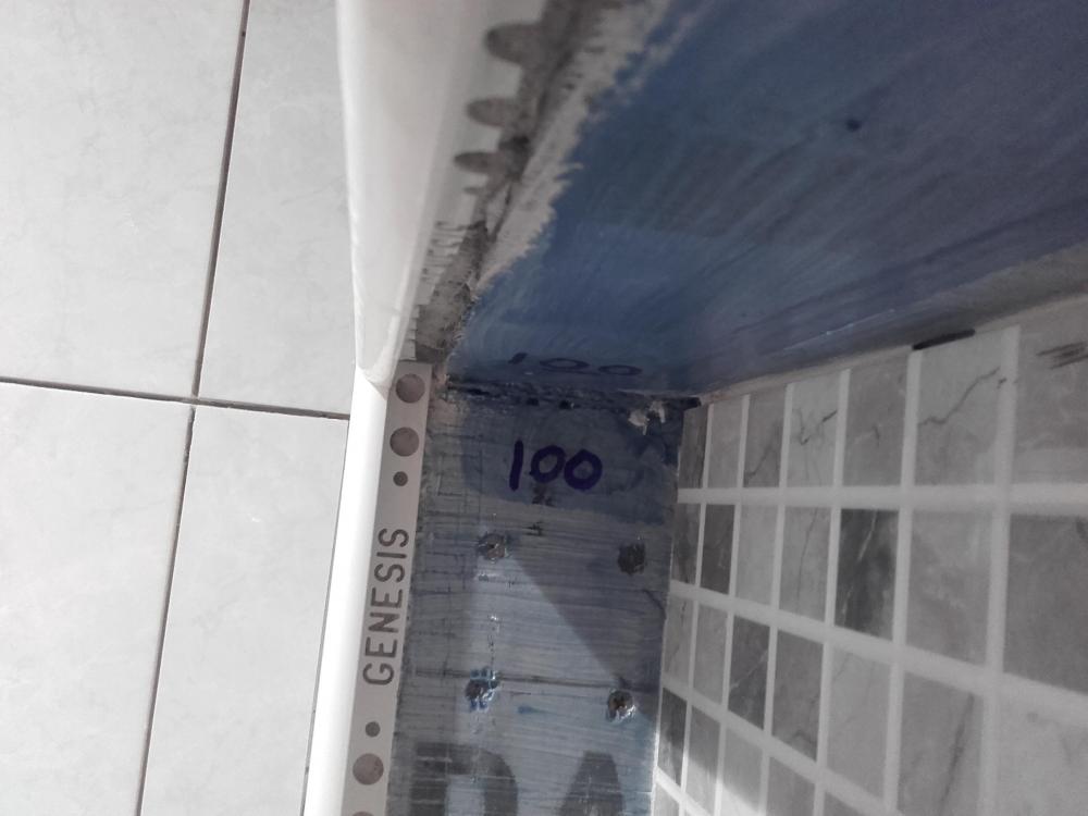

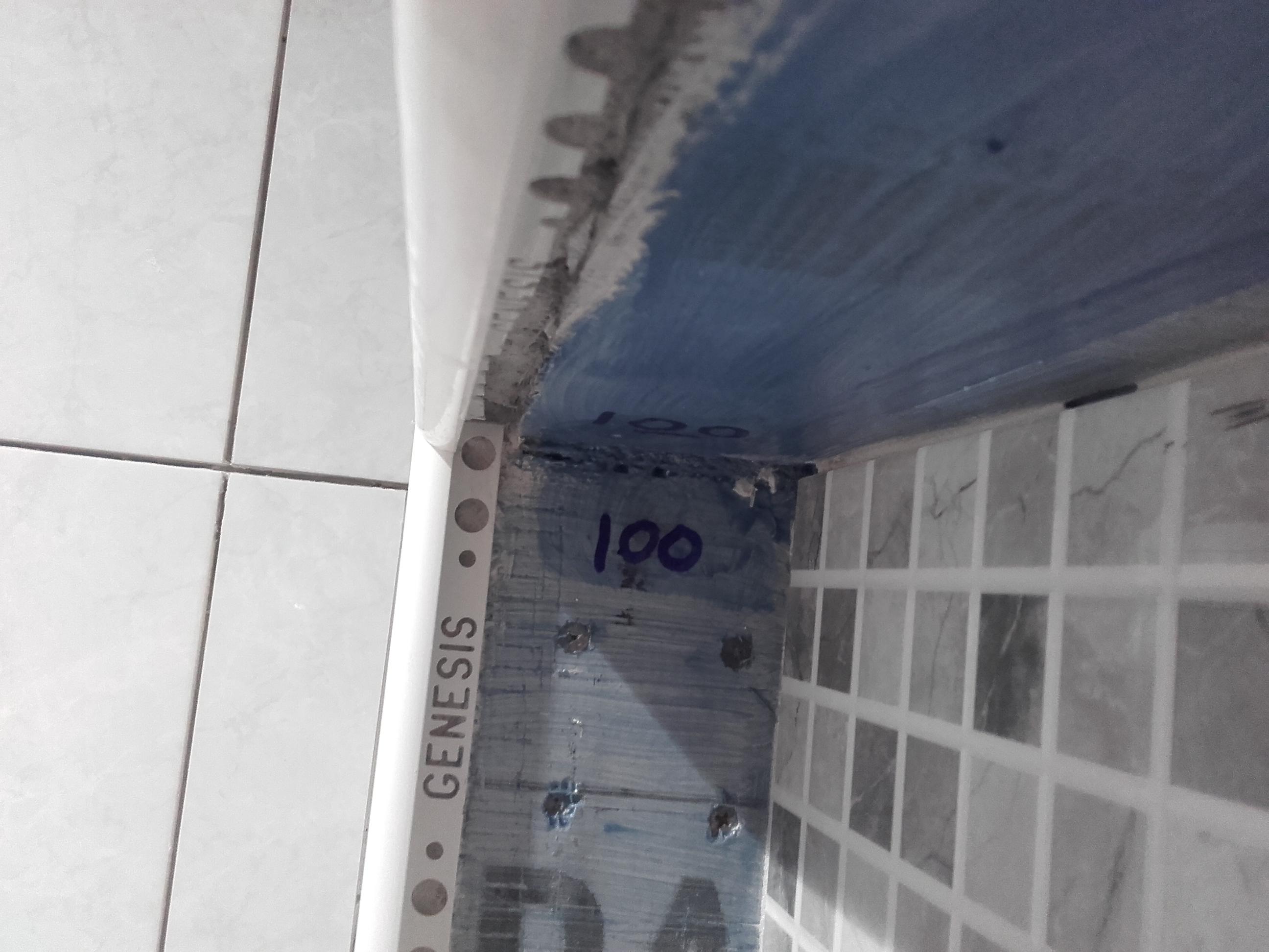

Onoff Posted November 11, 2018 Author Share Posted November 11, 2018 (edited) Just fiddling today! Thought I'd play with the tiles that line the pockets: Onto then these pocket lights using the cheapo LAPP deck lights (stainless steel, £4.99 /10). I need to drill a 22mm hole in the soffit tile (then up thru the Aqua Panel and timber beneath). No problems there. Considering the spread of light within the pocket as I have two different pocket depths, 78 & 100mm. I reckon the centre of the light fitting should be a constant from the mosaics, so 78/2 = 39mm. It'll therefore be central on the 78mm pocket but offset, 39/61 on the two deeper pockets. The arc from the lamps should appear equal on all three: Here's them in loose a while back pre mosaics etc. Interesting that within the fitting are 3 LEDs arranged 120o apart so they all have to be aligned the same way! Edited November 11, 2018 by Onoff 1 Link to comment Share on other sites More sharing options...
