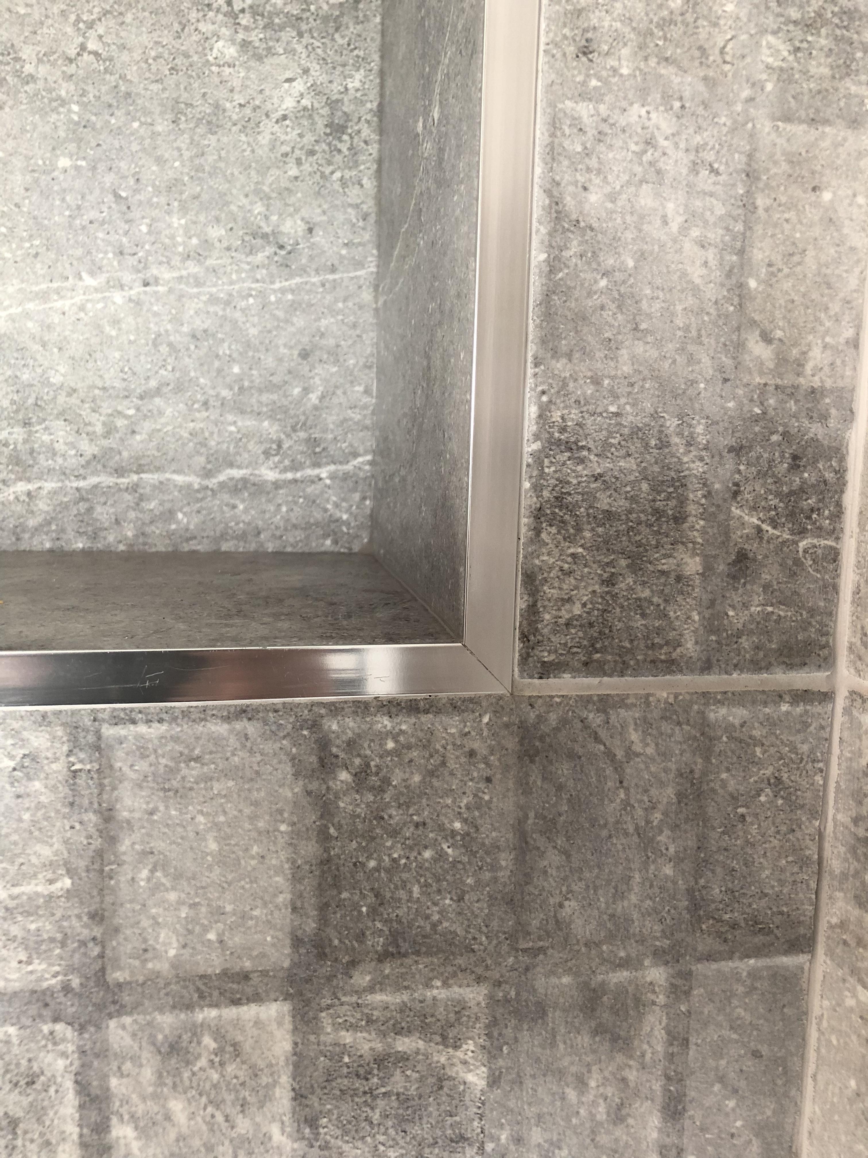

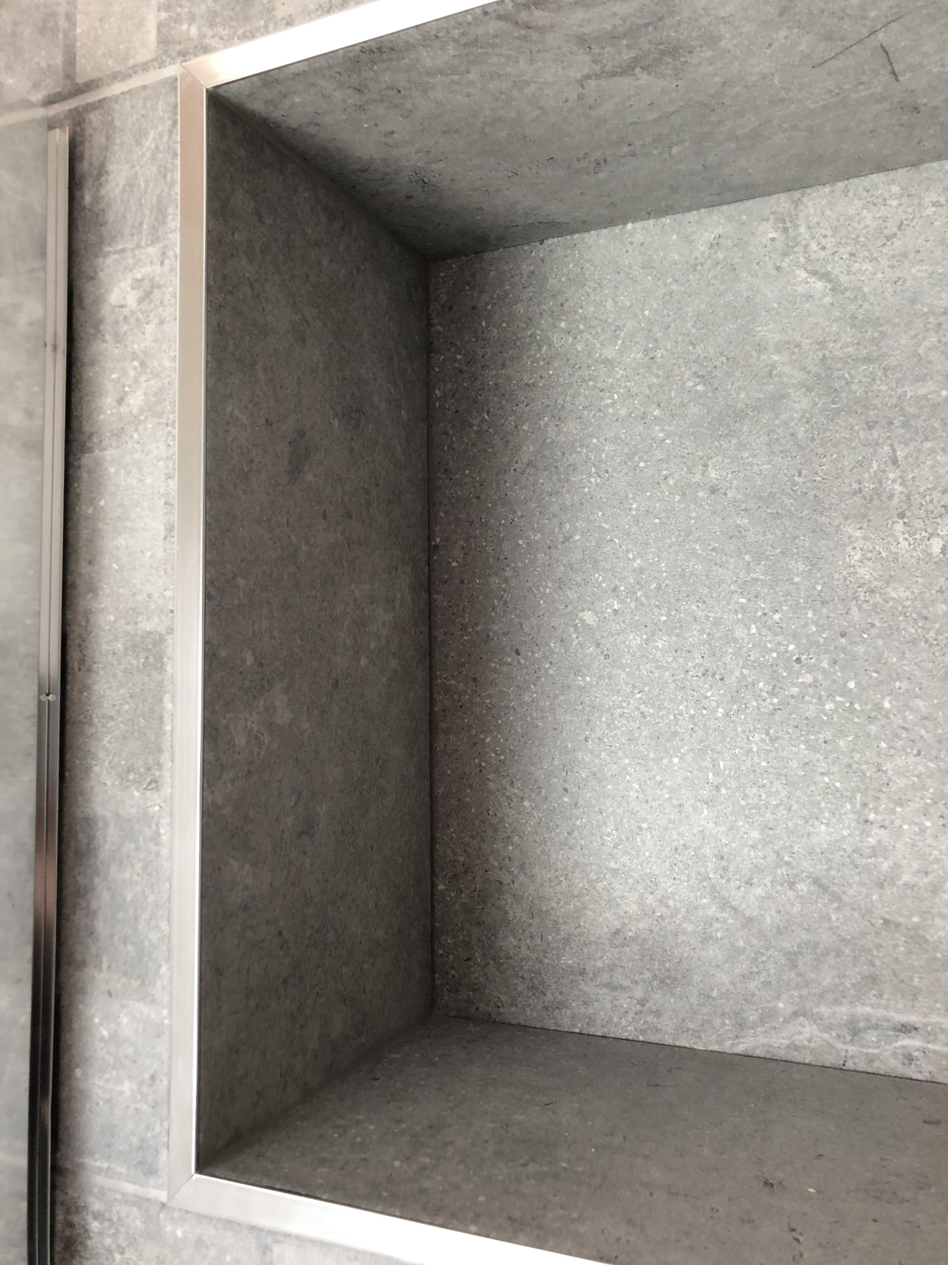

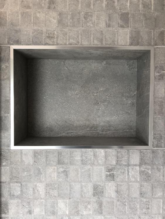

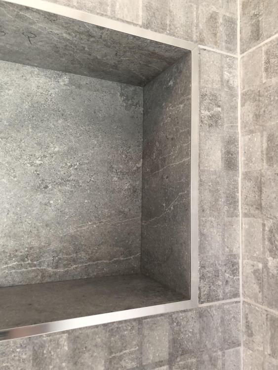

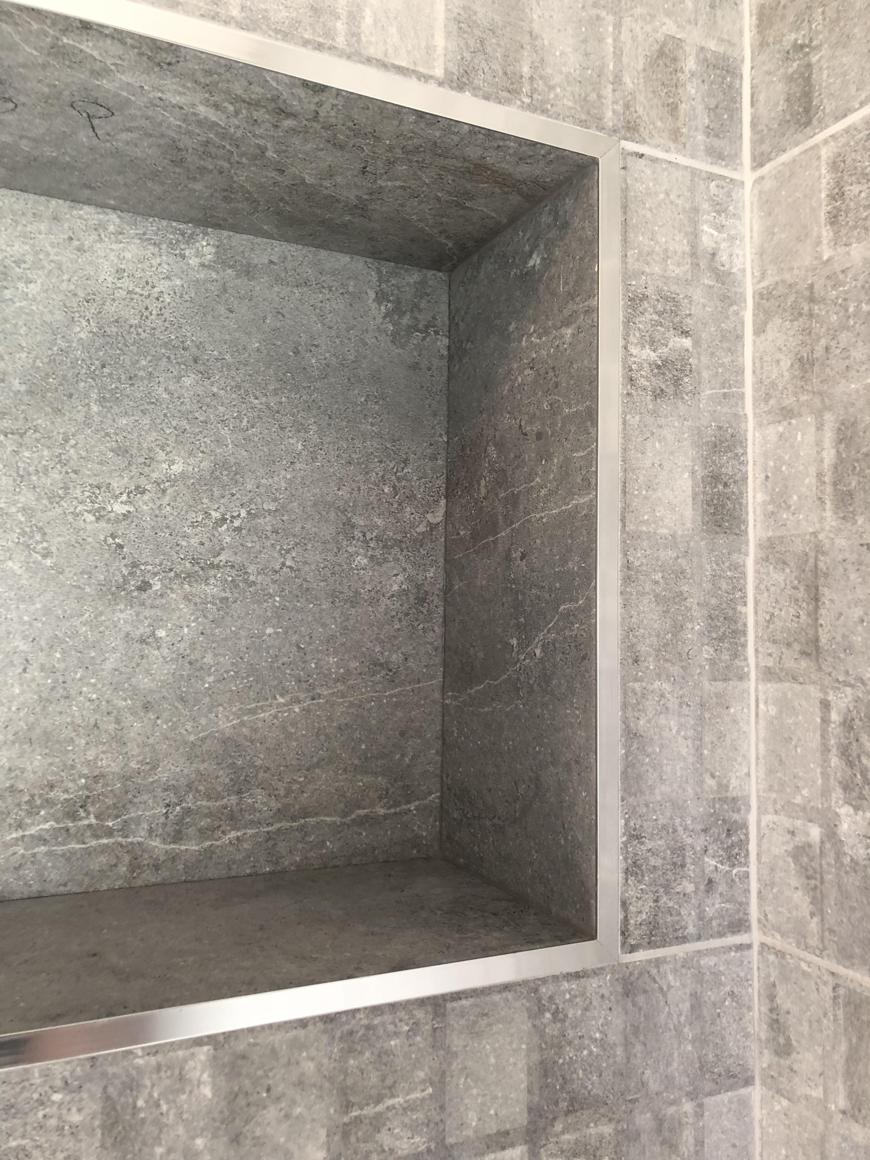

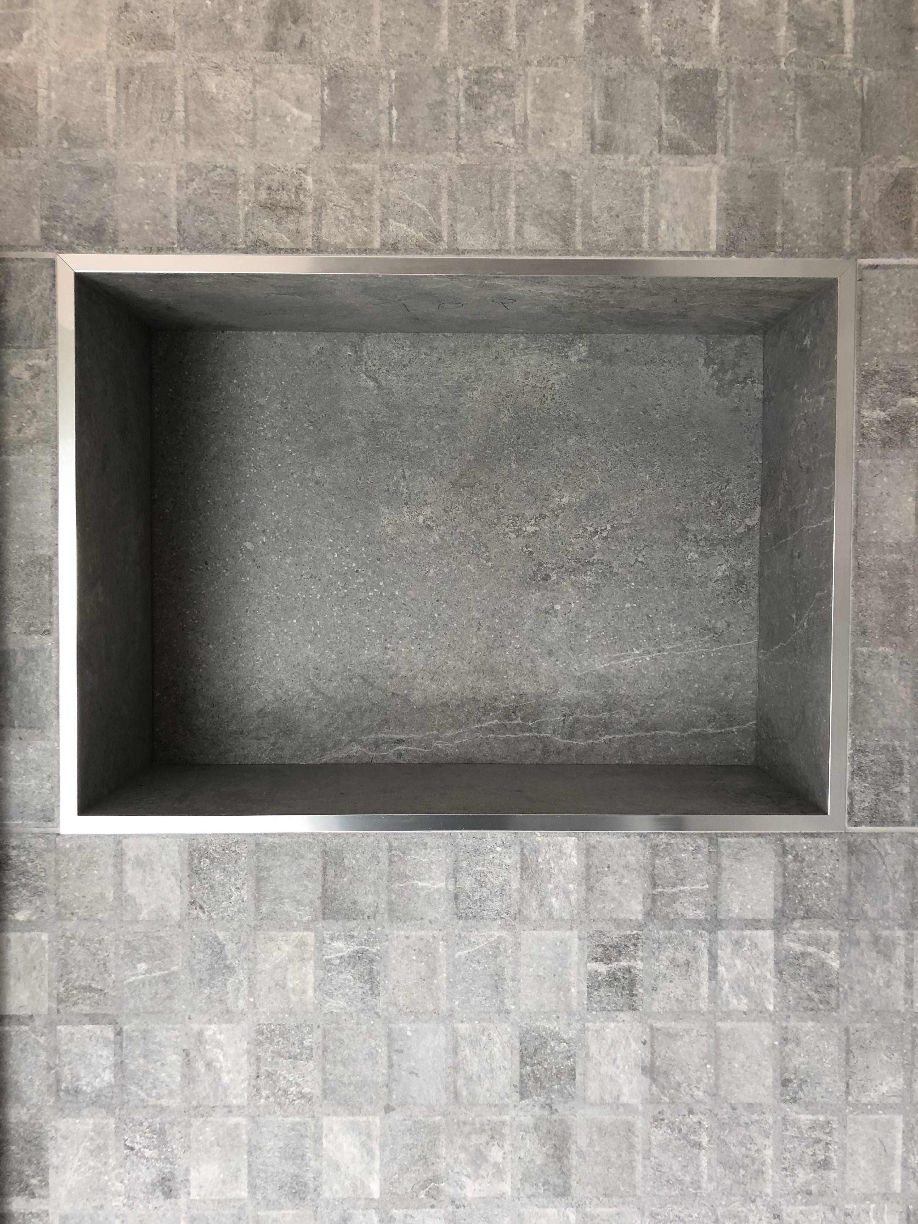

Nickfromwales Posted September 21, 2018 Share Posted September 21, 2018 Rear tile went on first. Then chrome trims ( cut slowly in the chopsaw between two pieces of sacrificial PAR timber to minimise F.O.D. ). Then the left and right tiles. Leave to set. Then the base tile. Leave to set. Then the head. All tiles colour matched siliconed into place so when I pushed them home the excess silicone squeezed out of the trims / mitres / and gaps between tiles and trims. It gets everywhere but the baby wipes clean up in minutes. 1 4 Link to comment Share on other sites More sharing options...

Pete Posted September 21, 2018 Share Posted September 21, 2018 (edited) 14 hours ago, Nickfromwales said: Yup. Tile the vertical wall all the way up first and then mitre bond the trims on so you can set the mitres perfectly. Then do the two side tiles, then the base tile, leave to set and do the top with stilts to hold it up off the base tile. Hi Nick. Do you mean mitre bond the corners of the tile trim to get them set perfectly and then use adhesive to hold them in place behind the tile? Edit. Should have read to the end of the thread first. It looks like you basically do away with the grout lines around the tile trims? Edited September 21, 2018 by Pete 1 Link to comment Share on other sites More sharing options...
Pete Posted September 21, 2018 Share Posted September 21, 2018 14 hours ago, Onoff said: Ta...don't you though do the base tile first so the side ones sit on it and the grout line isn't so prominent? I was going to do in this order: Base Rear tiles Top tile Sides ??? And how do you cut the trim, small mitre block and what saw? Chippy mate lent me this, reckons it's great for plastic trim but I can't get on with it. I think you need a bigger tool mate!! Link to comment Share on other sites More sharing options...

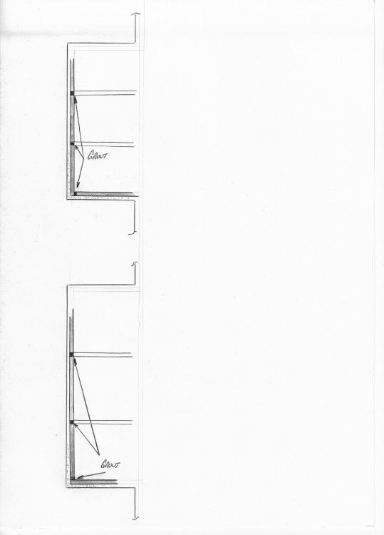

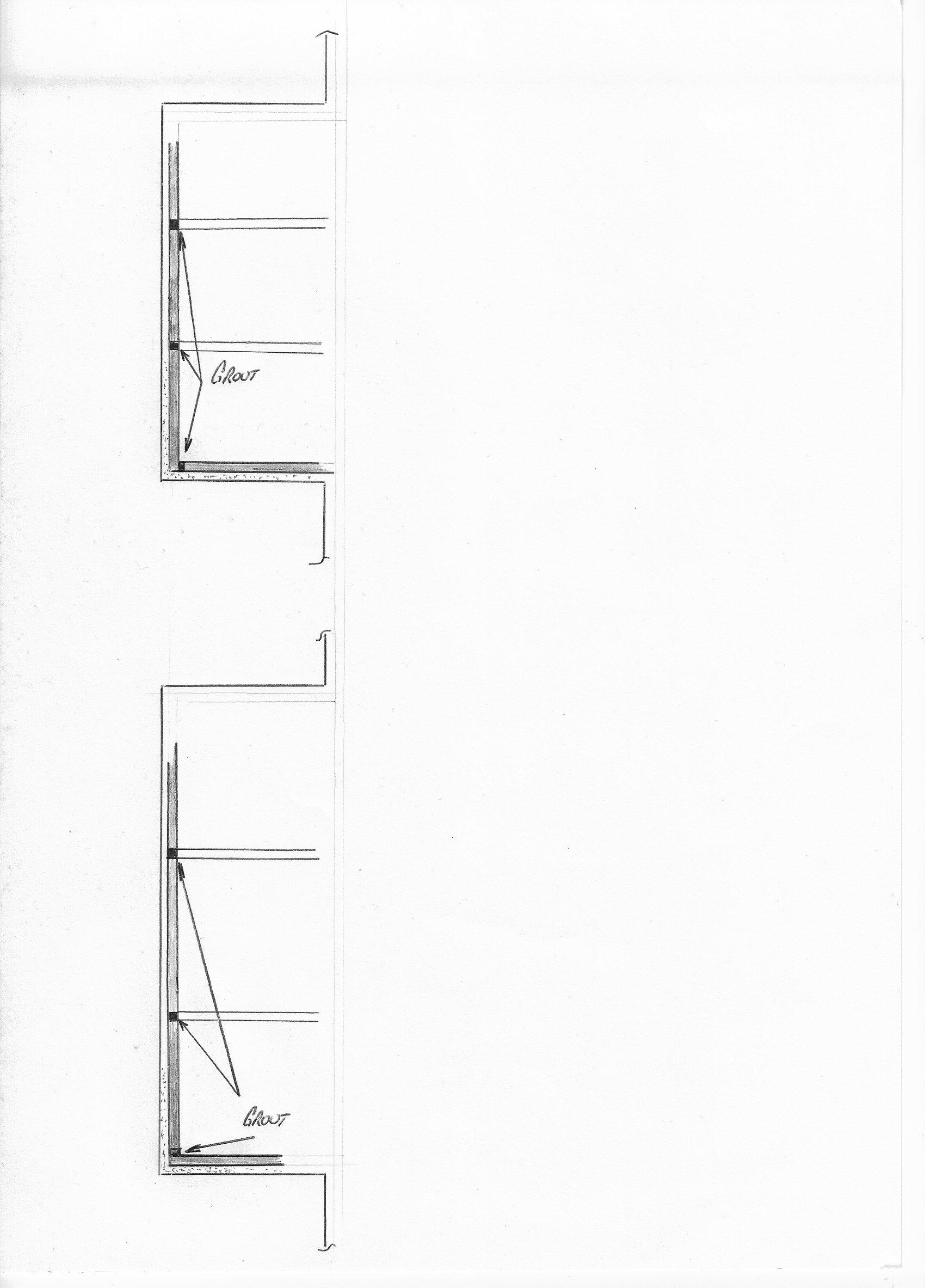

Onoff Posted September 21, 2018 Author Share Posted September 21, 2018 (edited) @Nickfromwales I'm 3 tiles high in these pockets. The mosaics at the back then the plain grey, top, bottom & sides. Means I'll have 3mm grout lines which your pockets don't have. I'd envisaged doing it as per the second sketch (water ingress less likely horizontally than if sitting atop the grout line) When you said the rears go on first I thought maybe like the first sketch. Now I'm guessing to do away with that grout line altogether and use CT1? I'll need to be sticking my tiles in with tile adhesive. That's going to squidge out. Trying to figure how to do the CT1 joint without that and the tile adhesive "meeting". Edited September 21, 2018 by Onoff Link to comment Share on other sites More sharing options...
