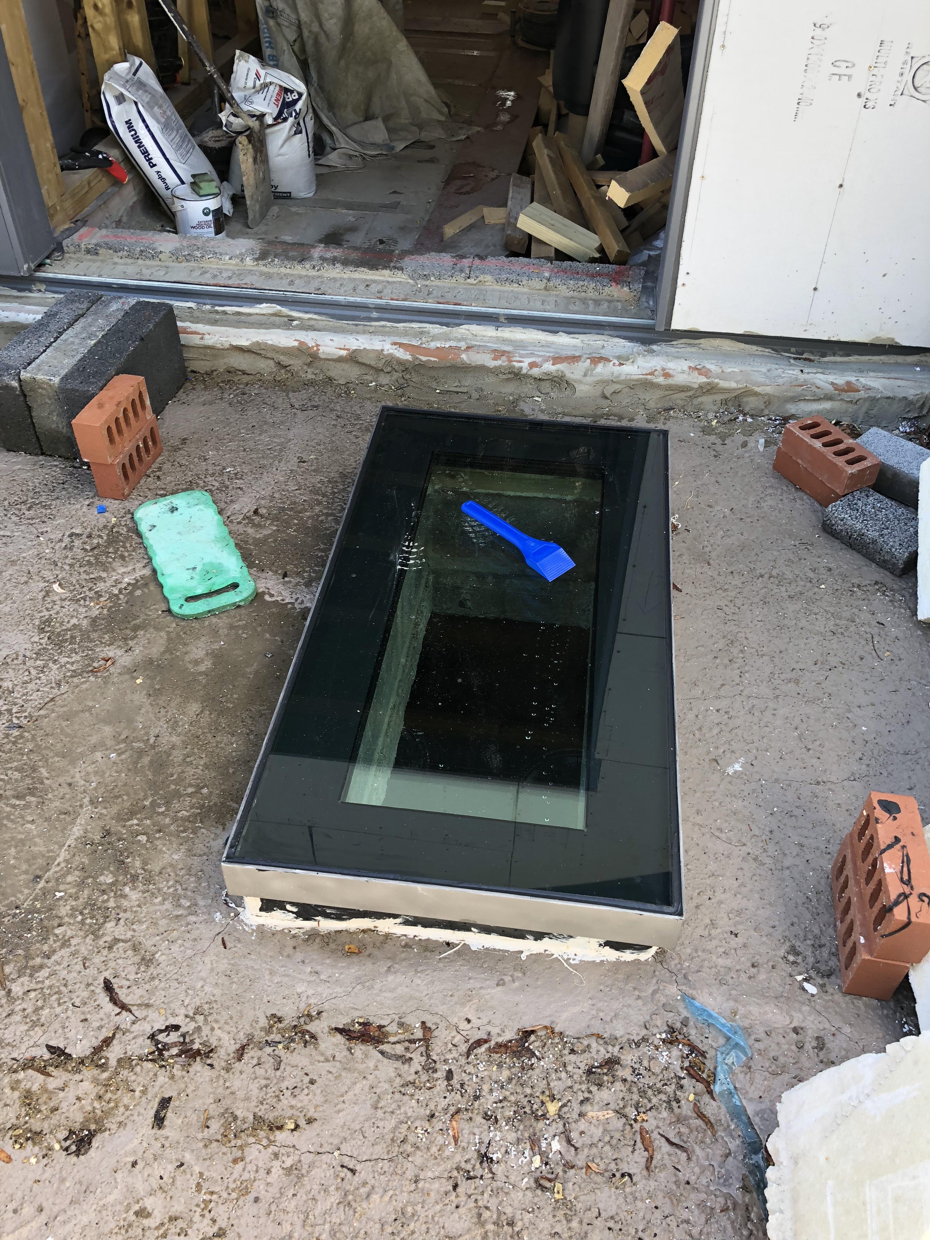

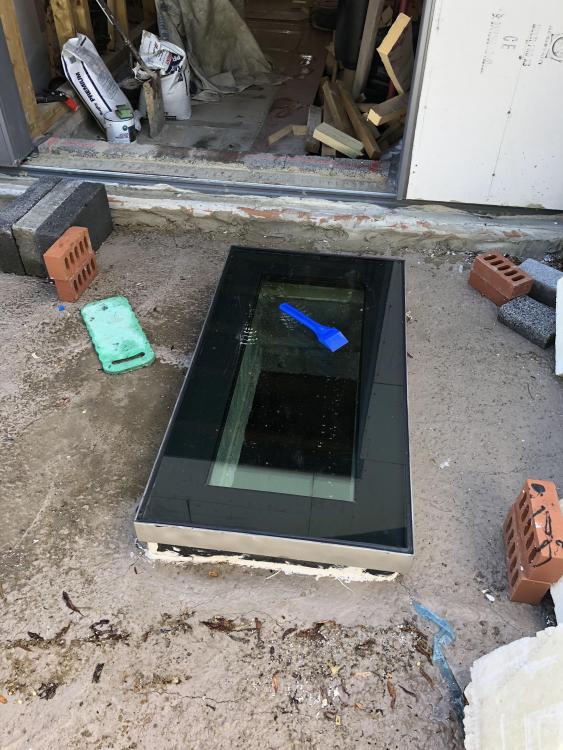

Pocster Posted August 16, 2018 Share Posted August 16, 2018 (edited) On 16/08/2018 at 08:46, newhome said: And do you have (roof)light yet? ? Expand Do actually ! All 4 are in ; 3 have been mastik’d This ‘special ‘ Mastik is a dog - cures in 10 mins . So mastik less than perfect . But this is external walk on - so can be forgiven like your floor grouting ??? Edited August 16, 2018 by pocster 1 Link to comment Share on other sites More sharing options...
Onoff Posted August 16, 2018 Author Share Posted August 16, 2018 On 16/08/2018 at 11:51, pocster said: Do actually ! All 4 are in ; 3 have been mastik’d This ‘special ‘ Mastik is a dog - cures in 10 mins . So mastik less than perfect . But this is external walk on - so can be forgiven like your floor grouting ??? Expand Is it 2-pack? I've see some structural silicon used at work. Gun runs off a compressor! Link to comment Share on other sites More sharing options...
Pocster Posted August 16, 2018 Share Posted August 16, 2018 On 16/08/2018 at 16:26, Onoff said: Is it 2-pack? I've see some structural silicon used at work. Gun runs off a compressor! Expand No its ssg4000e ( sounds good doesn’t it ) Link to comment Share on other sites More sharing options...

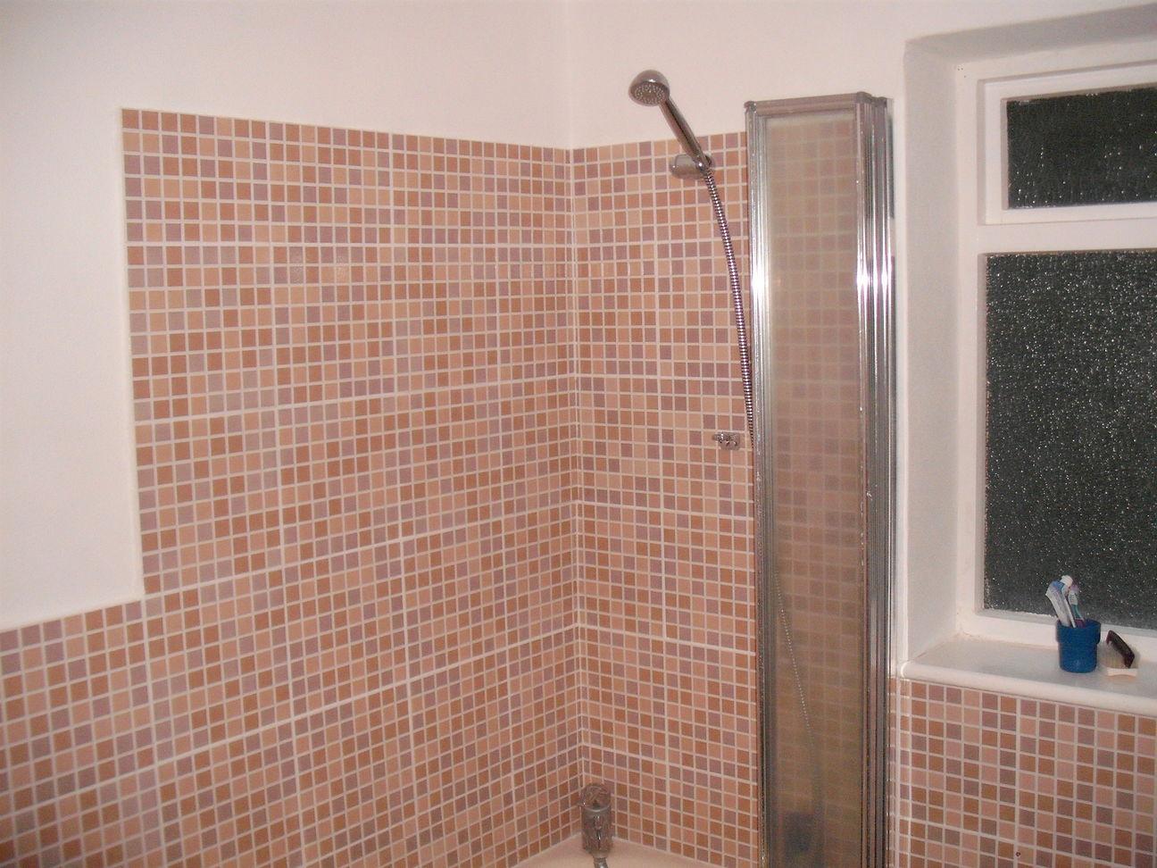

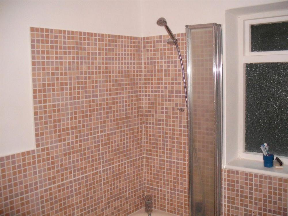

Ed Davies Posted August 17, 2018 Share Posted August 17, 2018 On 17/08/2018 at 12:53, Onoff said: Like this. A bit misleading as there'll not be rips in the photo up the lhs mosaic. The mosaics will start after two tiles from the mitre: Expand Good plan. Mosaic into a corner is hard. I was starting with not very flat walls so I'm not too displeased with my first attempt at tiling except at the corner: 1 Link to comment Share on other sites More sharing options...
