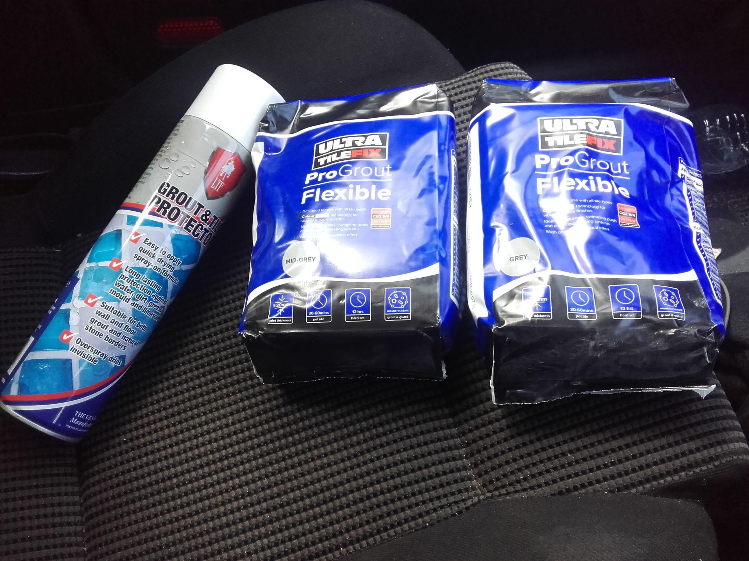

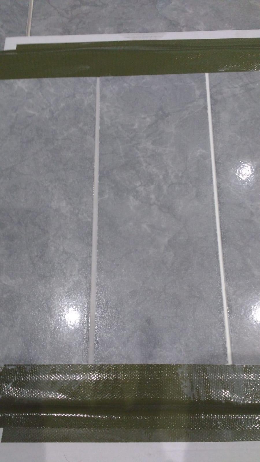

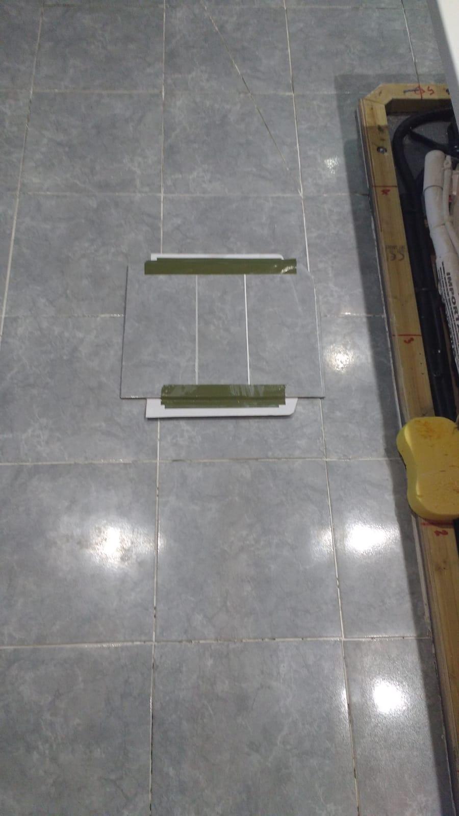

Onoff Posted August 11, 2018 Author Posted August 11, 2018 So after a half hour phone call & Whatsapp session she decides the Silver Grey has dried "too white". She loved it last night when it first went in. The difference I think is that it was wetter hence darker. This is it dry: And from a distance: So we've ditched Charcoal and I'm going to do some samples of Mid-Grey and the darker Grey which is one down from Charcoal. Just made my sample board up:

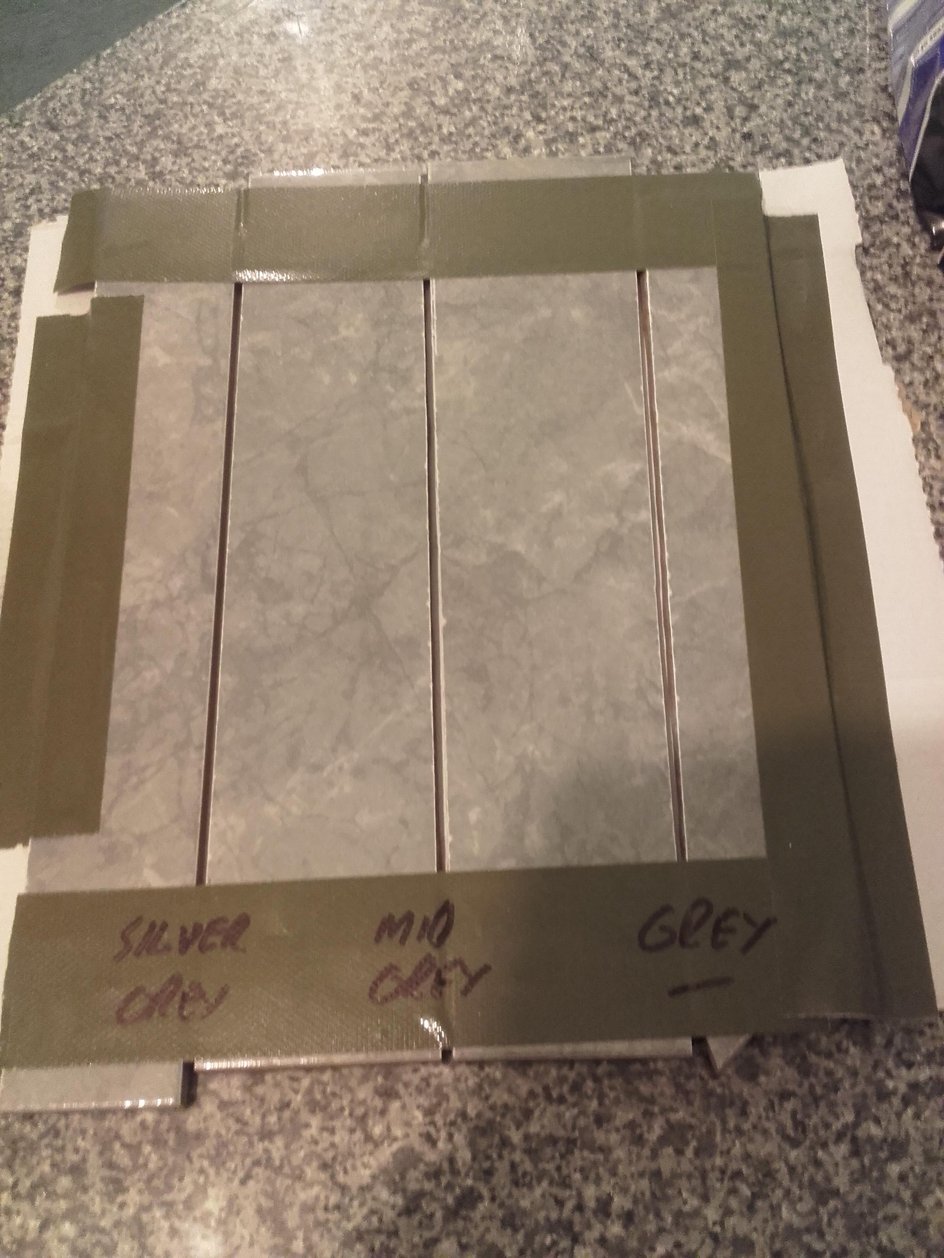

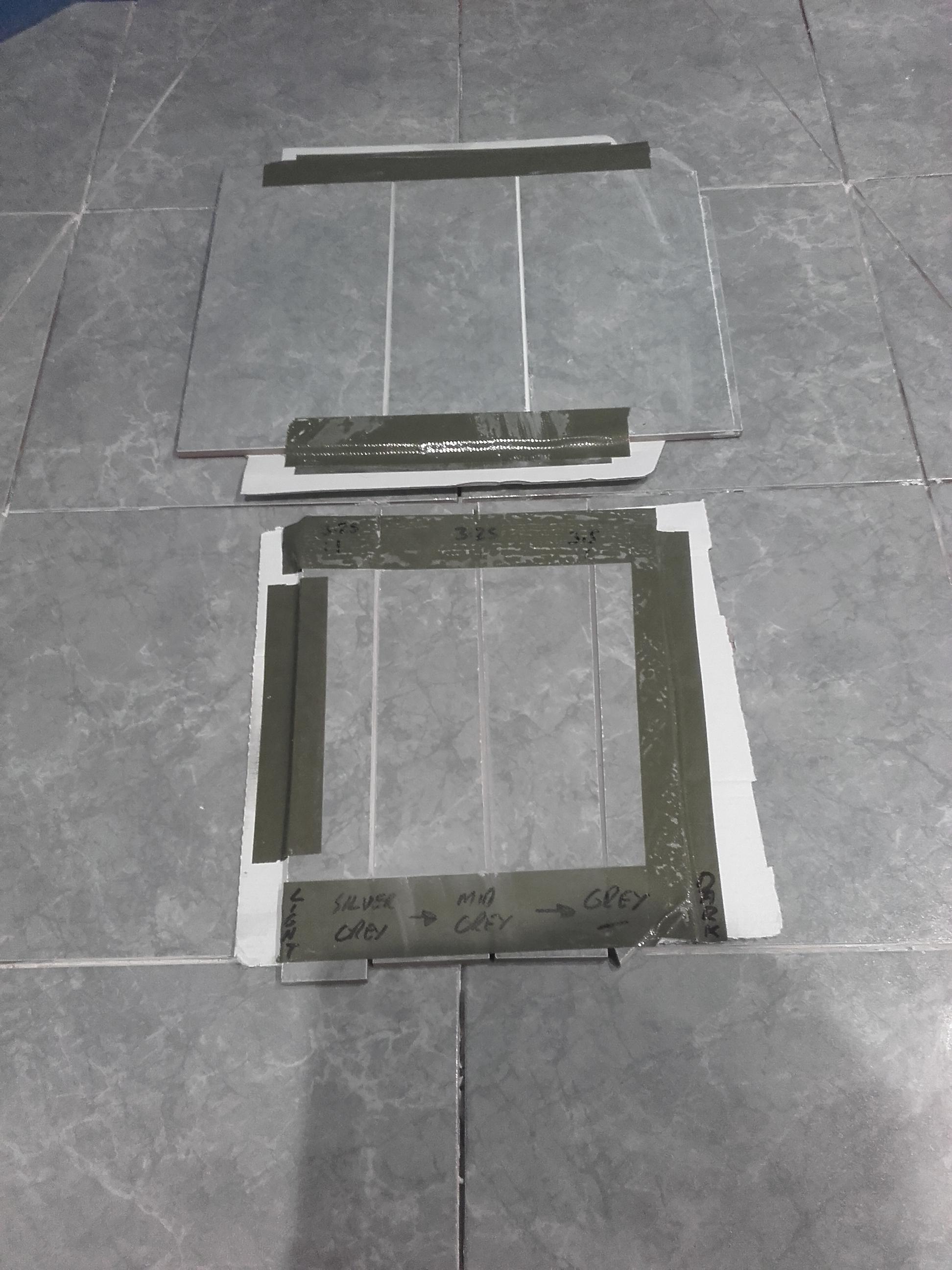

Onoff Posted August 11, 2018 Author Posted August 11, 2018 Meanwhile, back on thread: Top sample is Silver Grey then White. Done last night. Lower sample is Silver Grey, Mid Grey, Grey as written. Done earlier today. Mid Grey is looking favourite at the mo depending how it dries overnight. The sample grout was made up religiously following the powder/water mixing ratios. Used one of those 25/50ml Calpol spoons! Silver Grey = 3.25:1 or 300ml/1kg Mid Grey = 3.25:1 or 300ml/1kg Grey = 3.5:1 or 250ml/1kg What was odd was that SWMBO made up the Mid Grey twice following the above ratios and it was far too thick. Third time lucky she added a little more water to get the right consistency. So it was in fact <3.25:1. ??? All grout bags are in date as in Jun/Jul 18. Be interesting when we do the bulk mix.
newhome Posted August 11, 2018 Posted August 11, 2018 Mid grey looks the best at present as you say. Bit of a change from white ?

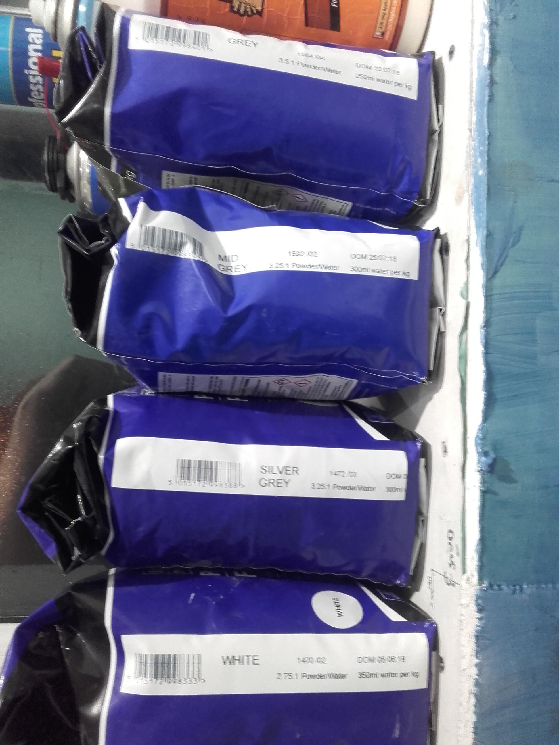

PeterW Posted August 11, 2018 Posted August 11, 2018 9 minutes ago, Onoff said: All grout bags are in date as in Jun/Jul 18. Thats out of date and 12 months old .... Sounds like the supplier is pushing the crap your way - ask for fresh bags as that will set very quickly and go lumpy especially when it’s got a porous adhesive to pull the moisture out of it. 1
ragg987 Posted August 11, 2018 Posted August 11, 2018 I prefer a small contrast between tile and grout. White jars, mid grey is trying to blend in but fails, grey seems more spectacular failure to blend, silver grey is"just right". IMO.
Onoff Posted August 11, 2018 Author Posted August 11, 2018 26 minutes ago, PeterW said: Thats out of date and 12 months old .... Sounds like the supplier is pushing the crap your way - ask for fresh bags as that will set very quickly and go lumpy especially when it’s got a porous adhesive to pull the moisture out of it. No, the supplier is spot on. All IN date. They're DOM dates, the white is Jun 18 & the rest later:
Onoff Posted August 11, 2018 Author Posted August 11, 2018 3 minutes ago, PeterW said: Ah ok - thought you meant use by date ..! No worries. Each of the sample lines took a similar time to set. Just odd about that mid grey. Tbh I wasn't at all scientific about mixing the two samples last night. The guy at the tile place reckons getting the ratio right is critical as it will affect the final colour. I never knew that!
