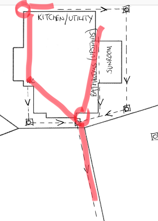

Ed_MK Posted February 12, 2018 Author Posted February 12, 2018 I think i MIGHT be over thinking this sewage diagram. Perhaps i am going loopy with inspection chambers I have been advised that its FINE to run waste UNDER the slab ...but I don't like the idea of it ... ..Do you know what I mean ? I like to be able to get at stuff without demolition ! Anyway ...I have been looking at where waste will be originating in this build 1. Downstairs there is a small WC and of course a fair bit of it coming from the greywaste in the kitchen along the wall 2. Upstairs its all located along the one wall ...basically above the sunroom, well not exactly ...but you know Now if these sites I am reading suggest that every time you make a substantial turn, you need an inspection cover ? Well as you can see below ..I will have FOUR ....is that normal ? Also as we are PICKING UP our parents waste (they are currently on a cesspit) its a fair run out to the road. When i manage to get the top off and check the invert level ..i hope i can get enough fall along this legnth , as I am guessing the more manholes ...the more STEPS DOWN i will be going ..and may well end up UNDER the Road Mains That will make me a gibbering wreck !?!?
PeterW Posted February 12, 2018 Posted February 12, 2018 Over thinking it... First IC at the back left, pick up the kitchen and use as rodding point. Run under slab to pick up SVP for downstairs WC Second SVP into rest bend to back of sunroom, all meeting in an IC at the front. Allows you to rod both branches and down the drive. Job done ...
Ed_MK Posted February 13, 2018 Author Posted February 13, 2018 thanks Peter ...I feel like I am back at school Work getting handed back with lots of RED on it ... remember the old "See Me" they used to put on it ? I wonder do they still do that LOL * I get the top bit ..that extended line is a" Rodding eye" right? * and then it runs the full length (about 15m) picking up the downstairs WC, and that "angle" is OK ? i suppose after all there is no other "chunky" waste going down there ...except the wifes leftover lentils ! *On the right hand side, I can see that it runs UNDER the property, would this also have a rodding eye at the top right, as i keep reading that it should be rodded "downstream" only ..would that be right? sorry for the questions PS. I suppose the optimal place for the "stench pipe" is just above he sunroom in the image (to the right of it as you look at it)? and am i right in thinking the downstairs WC does not NEED a stench pipe at all ?..to be honest i dont really understand their "mechanics"
