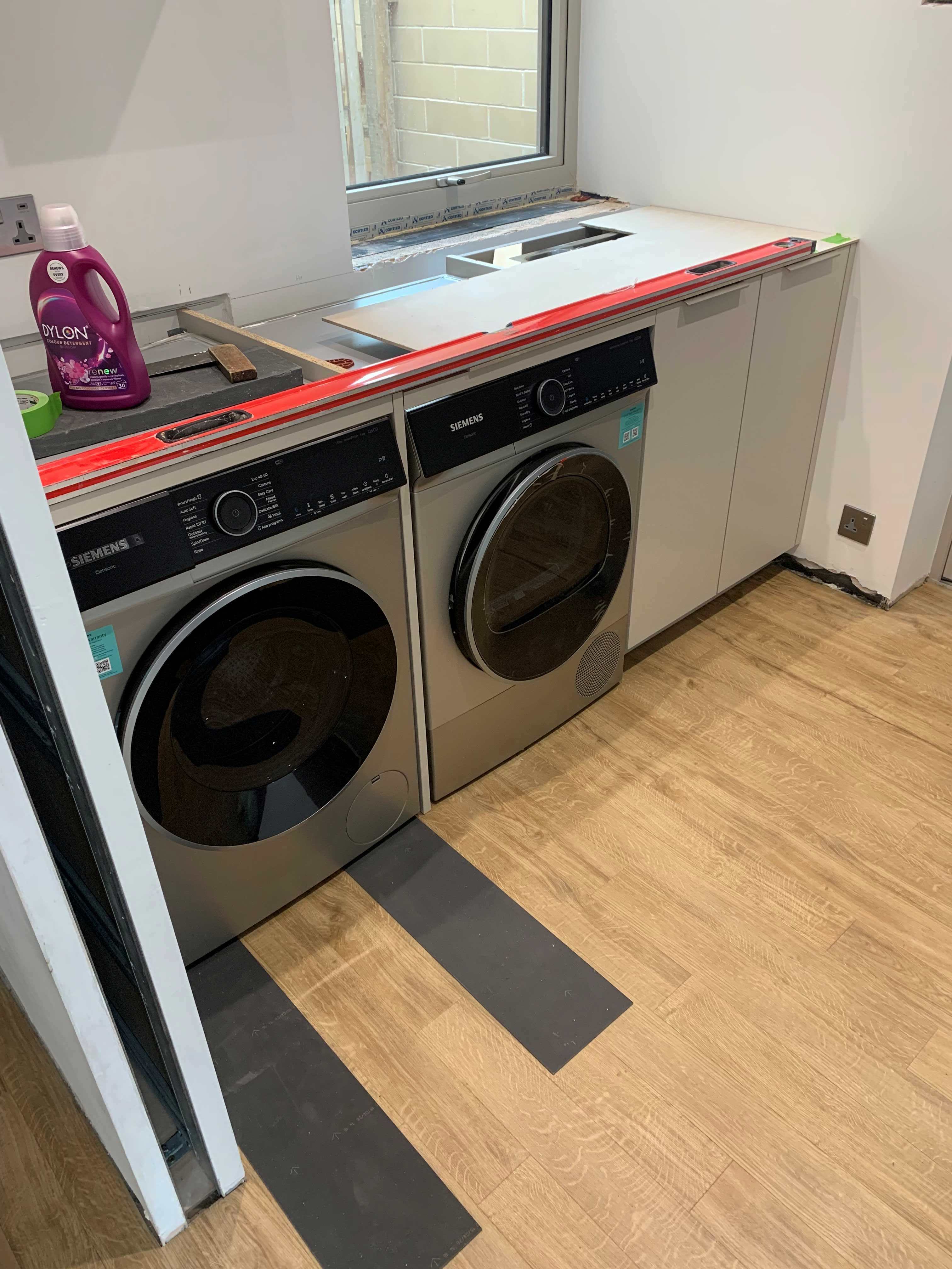

There is no upstand. There are 3 worktops:
1/ the hob run backs against the rear wall which will have a glass splashback templated and fitted after - the ends finish against tall cabinet panels and they said they would be polishing the cut ends to help the worktop slide in without damaging the cabinet panels if it is a tight fit.
2/ the island which is nice and square from the fitter and has the sink cut out (2 taps) and a waterfall end
3/ the utility which has a sink cut out (1 tap) and runs in against the window frame to seamlessly form the window cill. Although no upstand, we will be tiling the walls at one end, in the window reveal, and along the back wall.

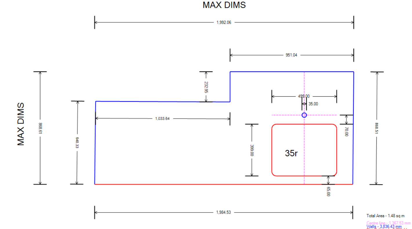

I have been sent the template drawings (created by a laser scanner device, not by any physical template being made) but trying to check them is tricky. I will post them so you can comment. My own measurements of the utility piece give me some concerns. It is basically L shaped to run into the window reveal with the long edge into the reveal marked as 868.51 mm. However the short edge is marked as 640.33mm and the other dog leg marked 232.95mm. Now that adds up to 873.28 which is almost 5mm longer than the other end. And if I measure the actual dog leg it is 227mm or almost 6mm less than they have. And my measurements show the worktop space will be 870mm from overhang into the window frame and exactly parallel to the window frame. So by logic that implies a potential 7.5mm gap at the back of the worktop away from the window. Yes I am going to tile it but doesn't seem a reason to leave the worktop 7.5mm short ?!? There is also no measurement given for the distance between the edge of the sink and the edge of the worktop.

I'd be nervous too, and measuring has  been my life.
The two decimal places is false and unnecessary precision.
7mm difference is perfectly normal.
But what if the shape isn't quite square?  Actually it can't be with that 7mm.
A proper template would tell if all the corners were 90 degrees.
OR they would show diagonal distances as checks
I think I'd be telling them it's their job to measure and get it right... which clearly they aren't comfortable with. ... which puts their measuring skill in doubt.
And point out the missing dimension.

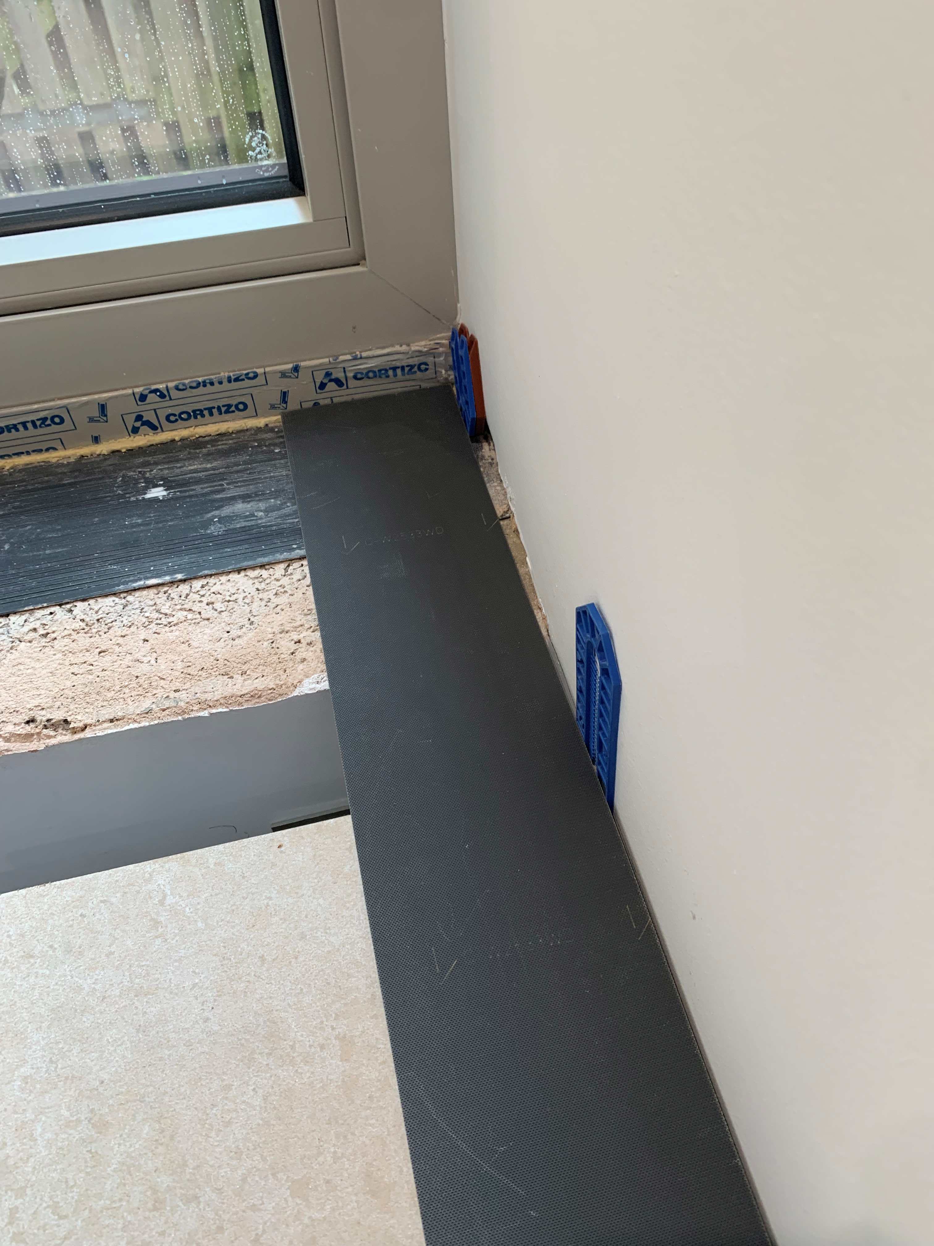

When they were here they commented that there would be a 10mm gap at the sides of the window frame so it was just as well we were tiling the sides. That is why I have focussed on checking the utility piece in particular. I have used a machine cut piece of board and the edge of a spirit level to to form the planned position of the straight front edge of the worktop. This shows me (using spacers to measure) that the 5mm overhang will be 5mm at one end increasing to 7mm and then falling again to 4.5mm at the far end because there is a small misalignment - but visually unnoticeable - of the front face of cupboards/appliance bays.
The right angle on the cut board, checked with a set square, shows me the long edge, if cut to 90deg will taper somewhat away from the wall and I will end up with an 8mm gap on that side near the window where the reveal isn't straight. Tiles will just about cover.
By the way the sink corners have radii of curvature given by the manufacturer which I looked up when they came to template. For the utility it is 35mm radius, and for the kitchen 25mm radius. For the bowl width and length they have gone with 1mm less than the manufacturers specified dimensions - so in theory should be 0.5mm beyond the edge of the bowl all around.
They did tell me the cutting would be done on a CNC machine, so should be a very close reproduction of the dimensions fed into the machine.
My measurements...
So now can see there is a 'cut back' on the wall section, so the 227 reveal has to be added to 643 = 870.
But at the left hand wall the worktop has to be 648.5 or 5.5mm deeper to reach the wall.
Seems odd.
The wall section thay have as about 1.5mm less than the actual of 870mm - a reasonable allowance perhaps of 1.5mm short of the window frame ?
But the wall section on the far left they have a worktop depth of 640.3 but the actual is 648.5 - an unreasonable gap of 8mm between back edge and the wall. No reason for this unless they can only cut right angle corners - which surely cannot be true as some people would have angled worktops by design.

Just to be clear here, are you trying to order the worktop from the stone supplier with just a drawing of it and not a full size physical template cut by them on site from plywood?  If so that sounds most unusual and very risky.
One observation from your photo that you have noticed is your right hand wall is not at 90 degrees and you have some run out.  That is going to make sliding the complete top into place hard.  Assuming the run out continues forward beyond the front of the worktop, it will have to be even shorter to get it to slide in.
A physical full size plywood template on site will resolve this and they will be certain if the template slides in, then the worktop will.
