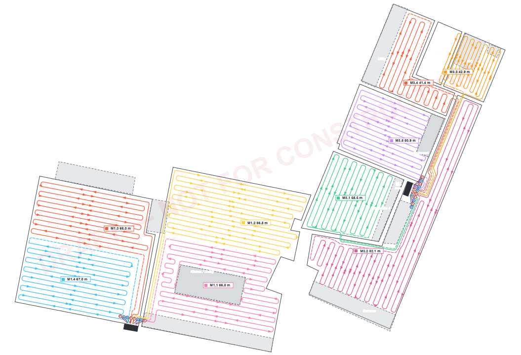

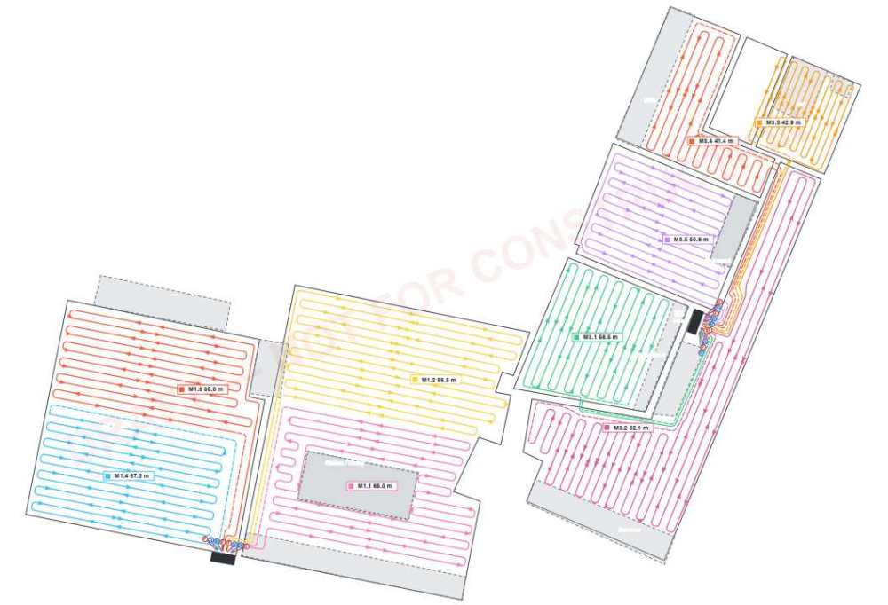

5 hours ago, Mulberry View said:
The designer has gone for 300mm pipe centres
FWIW, French regulations specify a maximum of 250mm between pipes - more here:
Edited by Mike
300mm pipe spacing does seem big, on tile flooring you'll notice the heat spacing unless you have really thick screed.
Id opt for smaller and dial back the temp.
So, back to the original point, Supply and Return pipes to/from the manifolds. What type of pipe is best to use here? I'm installing 25mm (26mm?) that will be within the PIR, with 150mm PIR under it. There is about 30m of linear length to reach both manifolds, so I'll need 60m of pipe in total, which I understand needs to be insulated despite it being installed into PIR? Is it just 25mm Pre-insulated MLCP?
As for the design, the designer was certain that 300mm spacing would meet the heating requirements, but I've had him do 200m spacing to be on the safe side (150mm in the Bathroom). I don't really ever want to do this again and certainly don't want to have to use plug-in heaters if it gets chilly!
There are 2 manifolds as this simplified the routing. The M3 manifold is at the lowest ground floor level, the M1 manifold is 1m higher in terms of ground floor FFL. The bundle of pipes running along the hallway to the WC and Utility will be in conduit as they are just transit pipes and the heat they emit is not required before the rooms.
This design saves 400m of pipe compared to the earlier designs. The ASHP will be against the wall in the top-right of this drawing, so the manifold connections are the hardest part here really.

Where are your flow and return pipes running to and from - do you have a route planned?
This is them sketched by me on an earlier layout plan. Ignore the pipe layout and manifold positions on that plan, this was an overlay to show my proposed position of the M1 manifold and the omission of the M2 manifold in the middle, along with routing of the supply/returns.
Where the omitted manifold is shown there, the supply/returns need to turn up out of the lower floor, ascend by 600mm then turn back into the Kitchen floor. The 600mm vertical section will need to be contained in a battened out wall.
Edited by Mulberry View
Added the attachment. Duh.
So question, instead of through the house, why not around the house, buried in trench then though wall to manifold.  Would certainly do the manifold in room M1.2 in 28mm.
Are you intending to run as a single or 2 zone system?

How would running these pipes around the house benefit? I can't see how it would shorten or simplify the routes unless I've missed something obvious?
I thought you had elevation changes to contend within the house, thought it maybe easier routing overall outside Or just route them beside the UFH pipes, why bother insulating at all inside the heated environment, any heat loss is going into the house.  In cooling mode atmospheric air is excluded, so no condensation to make either. Assume your hot water cylinder is in room M3.4? If so why are you bothering with an UFH loop in that room? It's always going to be warm, ours sits in an unheated loft space room is 6m x 4m it's always the warmest place in the house.
You didn't read what I wrote alongside that pic! LOL.
Regarding the internal level changes, they are also outside, we have a tricky plot and an even trickier shaped building. They need to be inside really.
