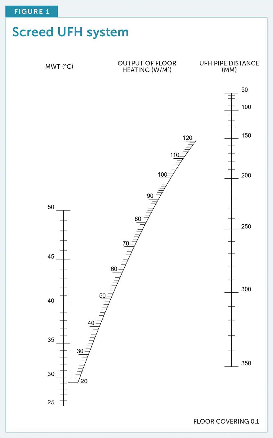

This chart and room by room heat loss calculation is about all you need. You then vary spacing to suit your needs.  Start in living room with say 200mm to 300mm spacing and then move the spacings around to W/m2 based on heat loss and target room temperature. Your flow temp max shouldn't be above 30 degs.
Key to this knowing room heat loss. @SimonD has a tool in boffins corner I think.
As @Nickfromwales says loops don't need to be by room. One of mine partly heats hall, bathroom and kitchen.

You are really running your UFH like a radiator system, it's your system your choice, but keep an eye on floor surface temperature. Actual flow temp doesn't mean much, floor surface temp does.
