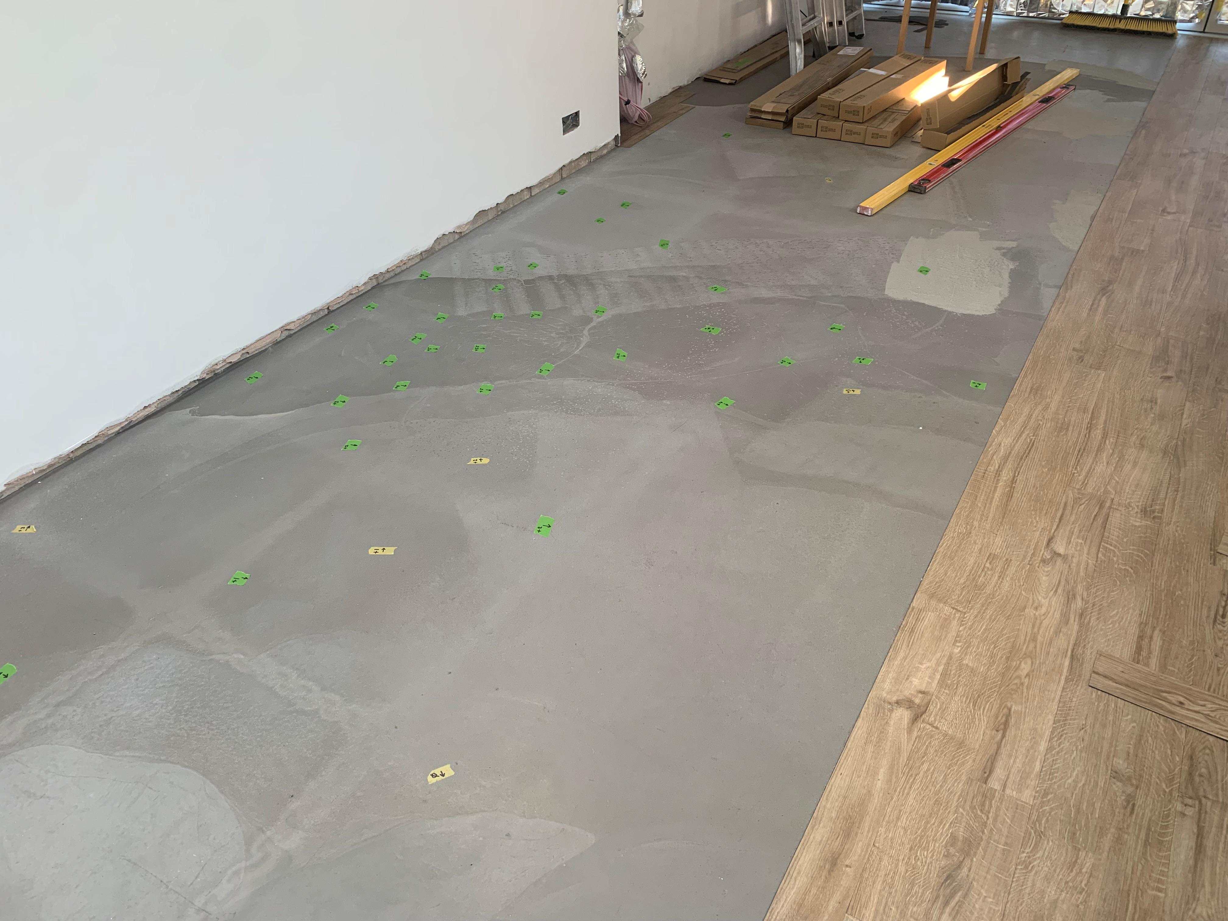

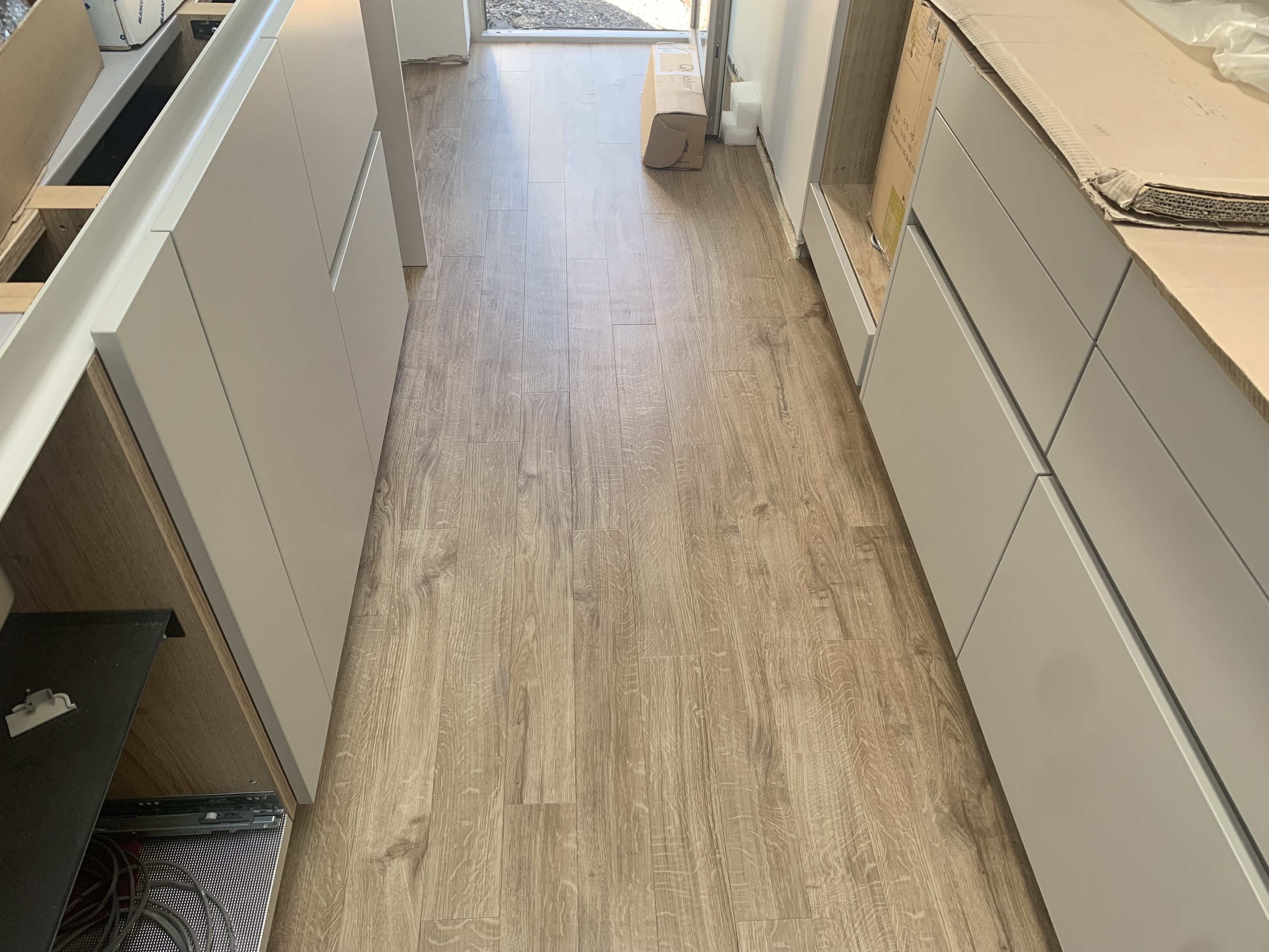

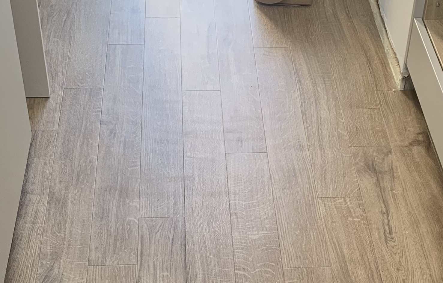

So I have most of my LVT down now only another 15 sqm to do.
However as I feared there is another undulation/raised area within the floor leveller applied on the remaining floor area. The bulk of the floor area is between 0mm and +3mm of target. However there is a ridge/raised area where part of the floor rises to +5mm or +5.5mm and then back down again. Rising from say an acceptable +2-3mm to the peak of +5.5mm and back down to +2mm again over about a 1.4m distance. 500mm rising from +2mm to +5mm, then flatish for 400mm, thenback down to +2mm over 500mm. You can rock a spirit level on the ridge and measure up to a 3-5mm gap under the end of a 1.8m spirit level.
There was 1 other smaller area on the floor now laid that had a 'hill' and I asked for it to be reduced as thet said it could be sanded down. However the sanding/grinding process did leave some fine ridges in the floor surface - basically like marks from a sanding/grinding disc. And now the LVT has been layed over that area, these marking suprisingly show through. When viewed into the light at the right angle you can see the markings in the LVT itself, which seems to have conformed itself to any lack of total smoothness in the floor surface.
So should I not have my other 'hill' sanded down, as 'messing with it' may reduce the hill/ridge, but end up with the floor perhaps looking worse because the working marks will show through in the LVT surface ? Should I live with a lack of levelness in a decently smooth surface - or risk having a flatter but unsmooth surface by having the flooring contractor work on it ?
See photos...
The hill is where the darker pour area is on the floor - now with levels marked on tape by me.
The closer photo of the other LVT laid floor area shows how you can see small arcs in the LVT in glancing light from the open door way. This is where the other high spot was sanded/ground down.

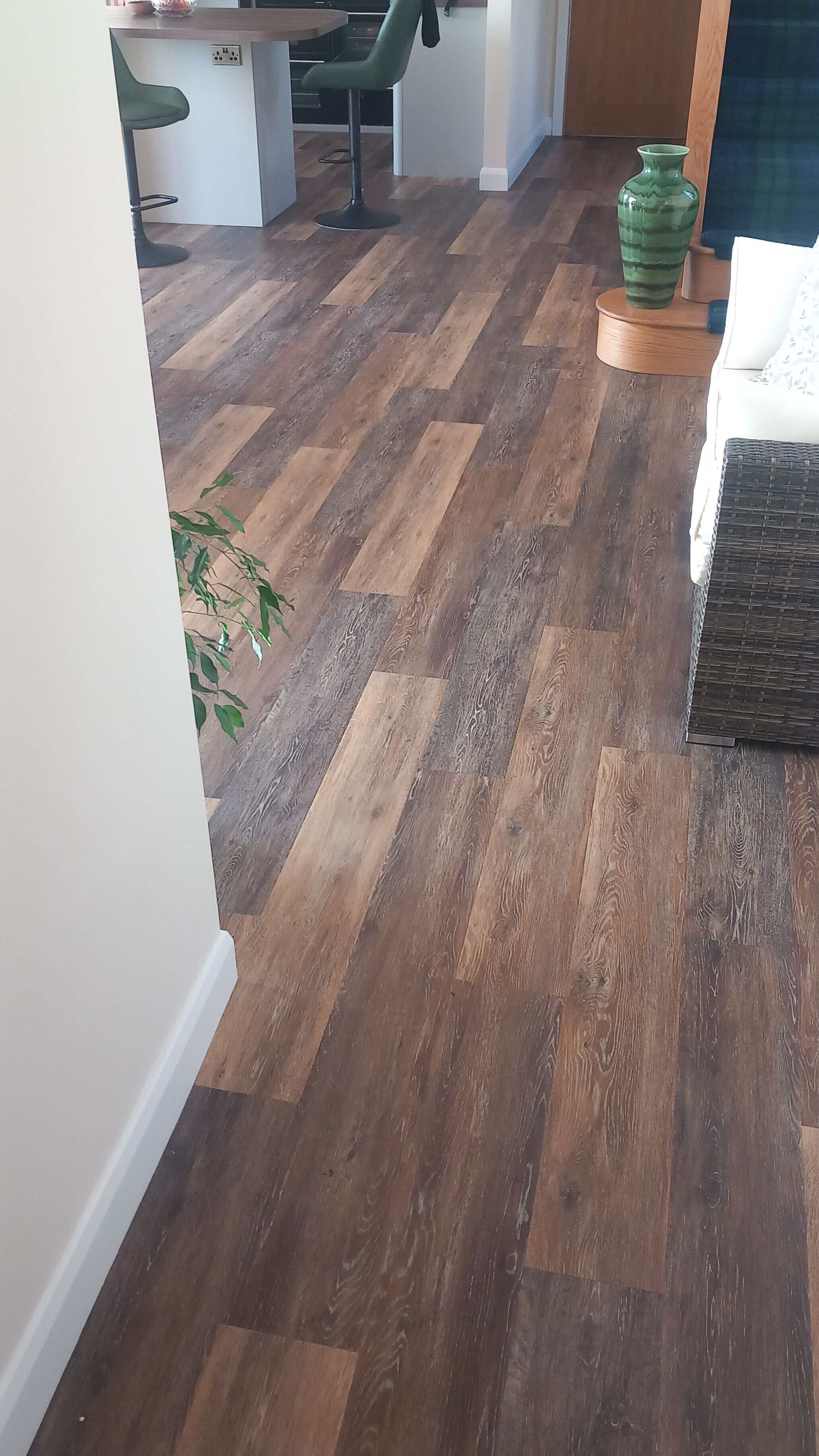

another wee picture before they started laying the lvt -- they did it with skirting all fitted
 a picture i took today -nearly 2 years after being done
Looks excellent.
Did you put a spirit level across it checking it yourself ? How flat do you reckon it is ?

8 hours ago, Spinny said:
Looks excellent.
flat as a pancake-- no swirl marks no dips
they just did it the right way  and used a proper floor grinder  and over that length any undulations would show
 i did ask about non glued  at the beginning and even wood flooring and they said with all the heat coming through the big windows  would move  and warp and fade over time due to the size   8m wide and 15m long

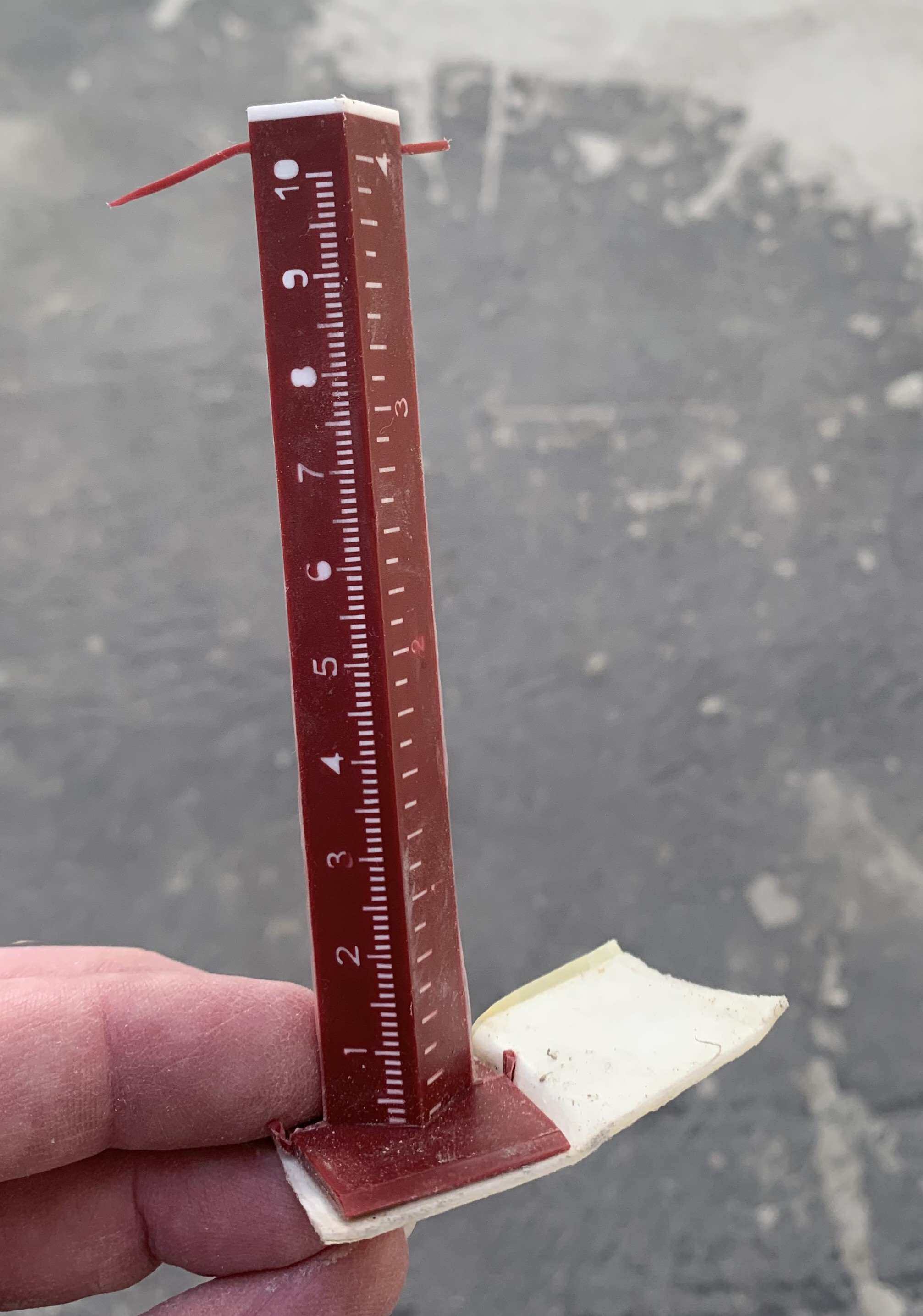

The flooring guy that did my levelling used small self adhesive sticks (see photo). Snapped them off to height and then stuck them onto the concrete surface, they then stayed there embedded in the levelling compound aftwerwards. These were his levelling guide. However...
When setting out he used a spirit level and seemed happy as long as the bubble was 'somewhere between the lines' rather than dead centre. He didn't actually put that many level indicators in - may be one every 1.5-2m (I had to explicitly ask him to put one next to my floor length window). Using a level end over end across 8m is not that accurate tbh.
I had taken quite some time using my water level to put reference marks around the room at skirting board level - but there was no interest in these and they were ignored.
The pour was done straight from a mixing tub without a tipping frame or spout. The mixes were made up by the junior outside. They only had 2 mixing tubs. So it was gradually work across the floor pouring one while the other was mixed. The actual level was generally a little below the marker sticks (obviously if the pour went higher they disappeared and became useless as guides).
For some reason the levelling compound dried to somewhat different tone/darkness on some pours - makes me wonder how consistent the water mix was. Though the second layer used a different compound with the liquid mix supplied with it - no water to add.
