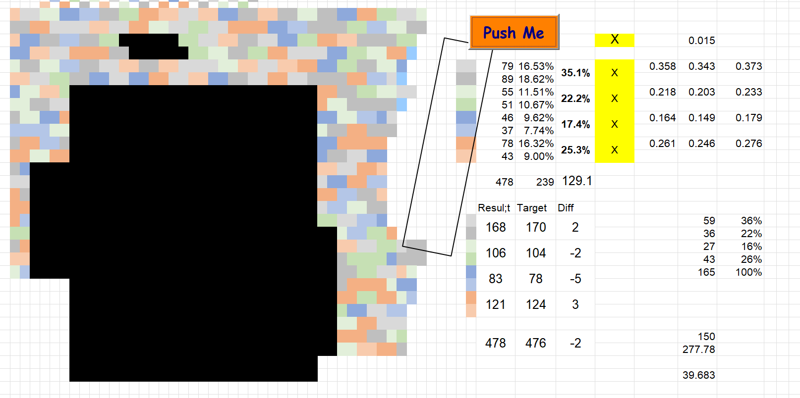

I built a randomiser spreadsheet using the RAND function to cycle through weighted combinations until I found one I liked for a mosiac tiling project.
The way you do this is use numerical values for each cell and then ascribe a different conditional format to colour each cell. Every time you calculate you get a different pattern. I just cycled through until I got a weighting that closely matched the number of tiles I had. After each run they were all random, but some just looked "wrong" so I just ran it again until I had one I liked
I resurrected it for my porcelain tiles. I had only four different designs, thus eight different tiles if you include orientation. I then labelled each pile of tiles A-G and gave my tiler the pattern, then it's an instruction, not a guide
Regards
Tet

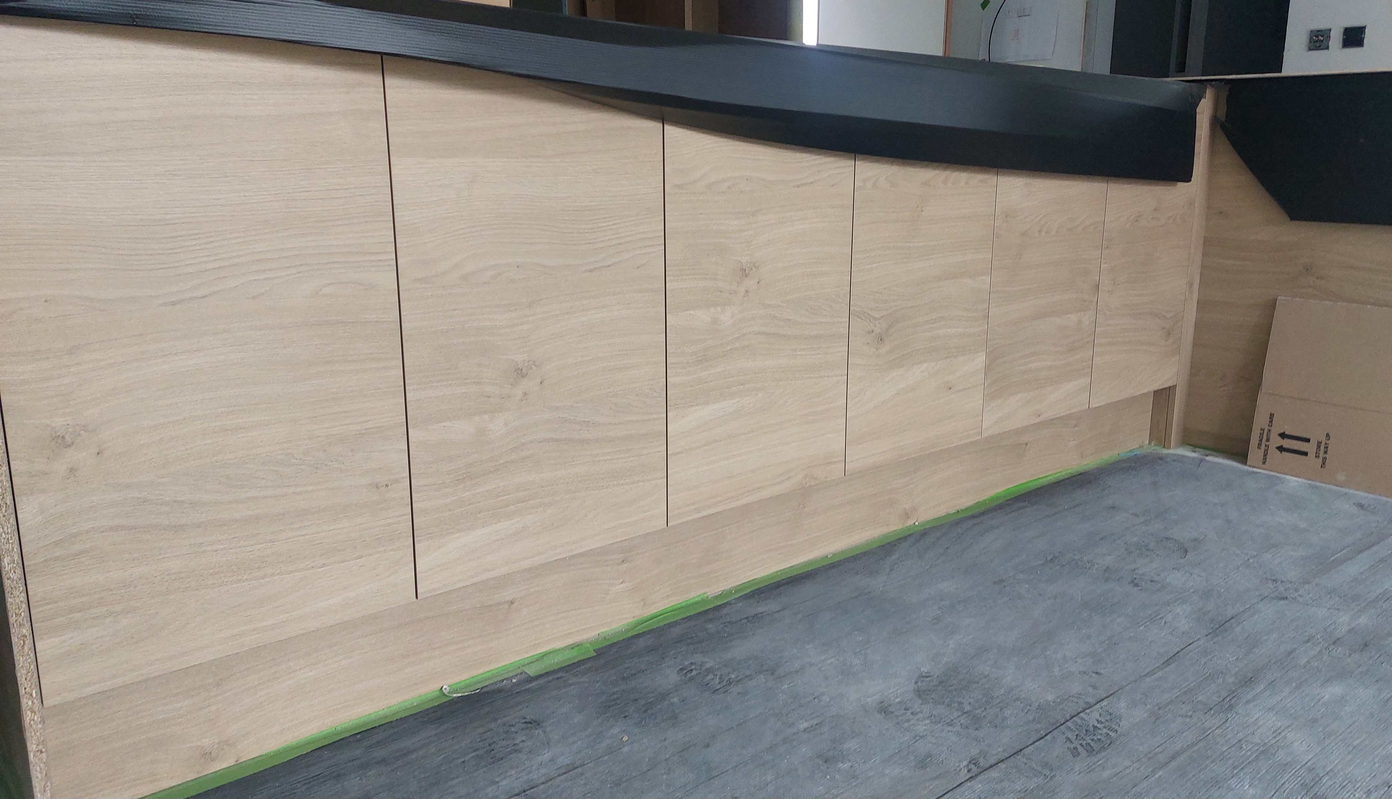

On 27/08/2026 at 21:10, Spinny said:
unique image area is only 1.2sqm.
Maybe this will ease your pain... a problem shared and all that.
Here is our new kitchen island showing the blank side.
You may notice the " feature " knot that repeats and repeats.... and there was no way round this other than rotation.
Again it shows that the manufacturer doesn't register this as an issue/ doesn't care.
To be fair I don't suppose many kitchens have so many in a row, and at least the pattern is staggered.
Would it sell more kitchens if they had several patterns and marketed this virtue? Probably not.
I have though noticed some tile manufacturers advertise that their wood effect has 22 or whatever, individual patterns.
There will be a table in front of this.

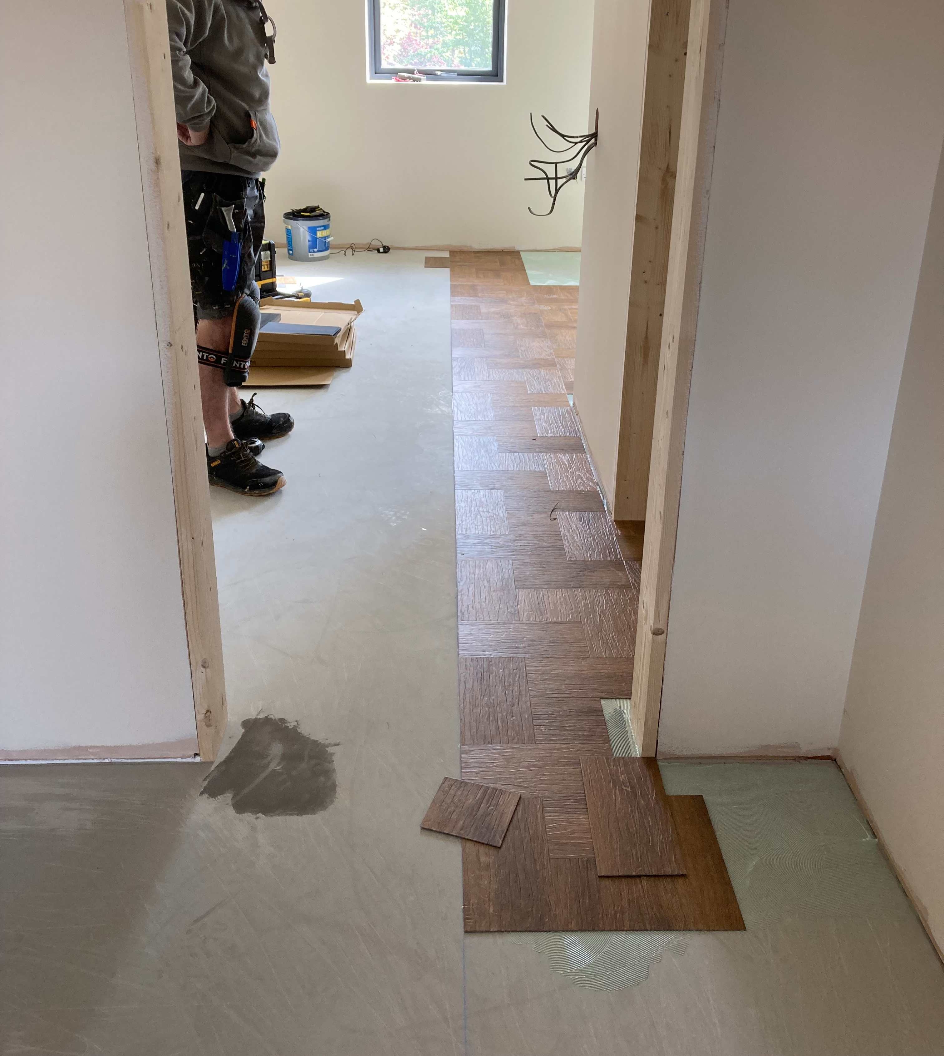

2 hours ago, Russell griffiths said:
a better finish is achievable
Excellent.
There are a couple of pairs of my Amtico planks that have grain line features that can be partially matched up if you lay them at the right offset on different rows. Sadly the fitters decision to change all my offsets has removed these.
At present the plan now is for me to label selected planks that he has laid. And to select replacement planks. He will then take up the labelled planks and replace them with my alternatives. It won't get back to my own careful arrangement, but will reduce the worst of the problem. Unfortunately this means deferring finishing off the floor as my kitchen fitter is back in on Wednesday.
I don't mind @Nickfromwales being so frank. I think doing his job you have to be able to be blunt sometimes - to some tradies, and perhaps sometimes beyond that. I do have to say having my sparky on the same day as the floor fitter was not by choice. The floor fitter gave me Thu/Fri as his only dates available before October for completing my job - so I had to take them. The sparky then told me the only dates he had were Thu/Fri. And with Kitchen fitter only being available this Wed before he goes on holiday for a fortnight next week, there was no alternative except yet more weeks of delay.
The fitter admitted he knew what my labelling meant and deliberately changed all the offsets anyway. I suspect as a youngster the older guy has drilled him intensly - YOU MUST DO IT THIS WAY - DO NOT DEVIATE etc As a youngster he is also very quiet and shy of speaking. I have spent 40 years surrounded by bright, communicative people - it is difficult to recognise just how closely some things need to be overlooked.
Interesting and helpful to see the variety of responses here on such detail and comforting to see I am not alone in seeking carefully detailed finishes, even if others are not so bothered.

Absolutely agree with this but....... having had solid wood floors before, in this house we wanted a 'maintenance free' finish for throughout upstairs that would last for the foreseeable and was suited to bathrooms as well.
We went with Amtico, but chose a small tile laying pattern, which helps solve some of the repeat pattern issues of a figured design on its own, and our fitter then dry laid large sections and moved and rotated tiles as necessary. Yes if you hunt hard you can find repeats.....it isn't wood...but it ticks our other needs.
Just for info. for those that follow, our fitters also laid 6mm flooring grade ply (over a very flat caber deck new build floor) and applied levelling compound before laying and required that the tiles were here in advance of laying to acclimatise......circa £100 m2 laid exc.
So the upshot, 'you pays your money and you takes your choice', but do your research!
