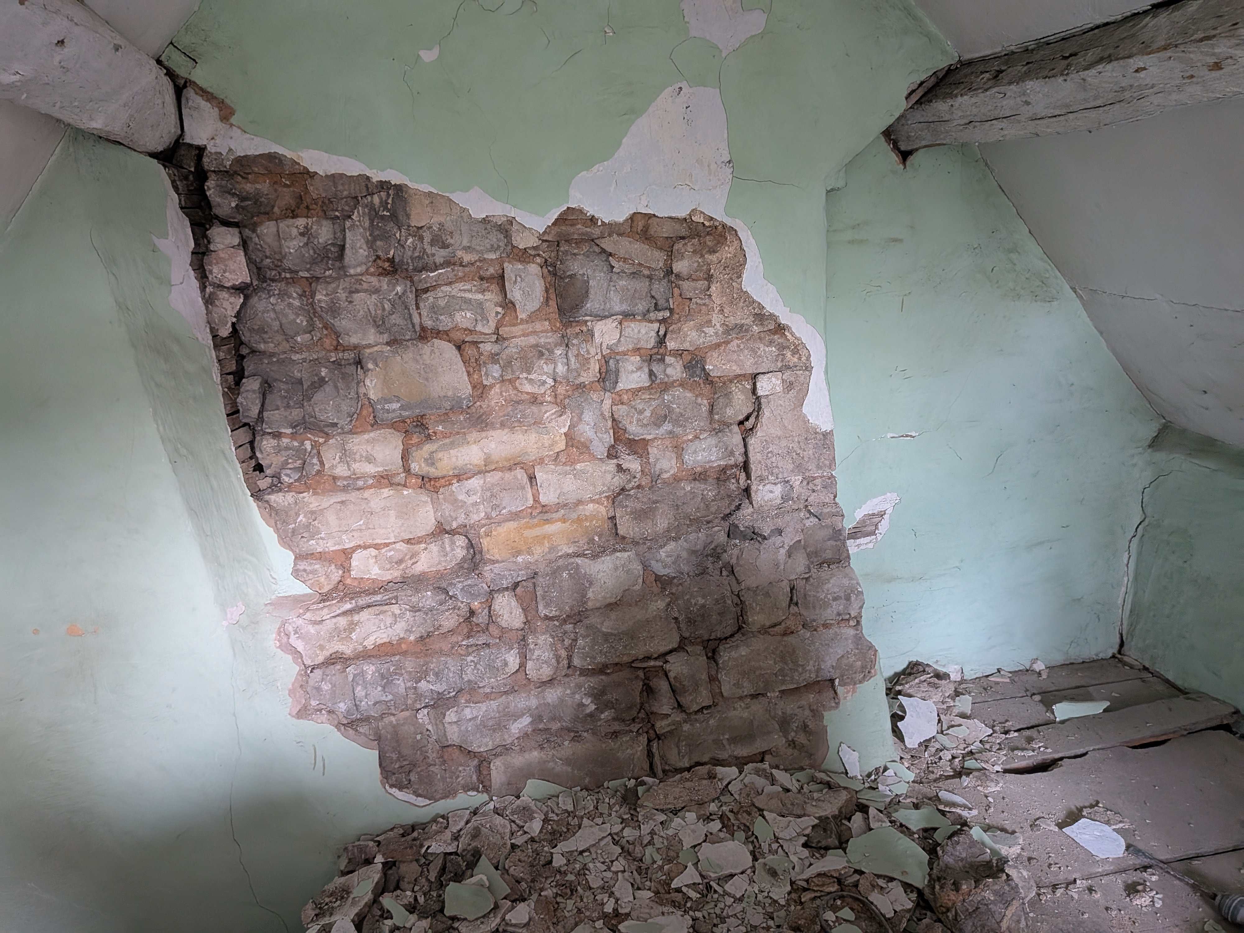

I believe it is dressed mudstone, and mortared. As for the quality of this [mmm], pic:PXL_20260717_162915950.RAW-01_MP.COVER.thumb.jpg.d70fc966587cbcca32084e5cda0ededa.jpg
That's the chimney breast in the loft room. The wall opposite is solid brick while the walls below that brick are also stone, with some small patches of brick repairs.

very interesting chimney . the rustic construction would be great to retain for interest but will need a lot of attention. Doable though.
are these stone flag floors? on second looks... perhaps old timber planks and some infill modern stuff?

@saveasteading looking at the "mortar" I don't know if using clay was a thing but that's what it looks like to me, or even mud. It's very soft and I can crumble it with my fingers.
