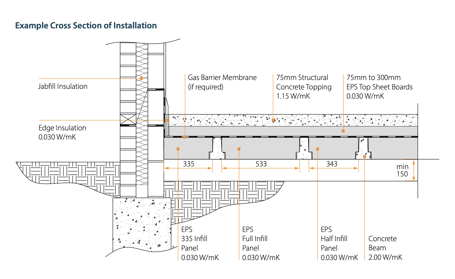

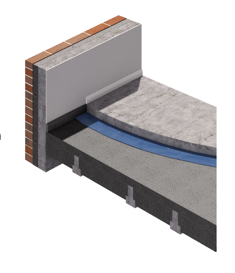

I've attached photos of the likely floor structure. It's like beam and block, but with EPS instead of blocks, and then structural concrete instead of screed 🤷‍♂️
Builder initially refused to confirm due to copyright / intellectual property nonsense. Then they mentioned the beam + EPS infill structure, 155mm x 120mm beams with a 75mm reinforced screed. I guess a structural engineer will need more details around beam spacing, orientation, etc - that so far they refused to produce. This is obviously not my area of expertise, but as an outsider I find it crazy that there's no legal framework to source those calculation from developer / building control (NHBC) but instead guess or do invasive surveys.

So it is suspended?  But you only say "likely"
Just an amateur suggestion, to determine if the beams are sagging, or it is the screed that was laid with a depression, drill and measure the screed thickness at the centre and the edges.
Likely?
You need to know.
There's lots of good info above as if this was prestressed planks rather than beam and block. B and B seems more likely and the prognosis is less bad.
They can span 5m so this sounds simply to be an incompetent slab laying, but could be something else.

The floor is definitely suspended, I see air bricks, seen similar properties build next door, and the builder confirmed beam + EPS infill. Likely is just the BEWI Thermal Flooring, there are other competing insulated beam infills solutions out there.
