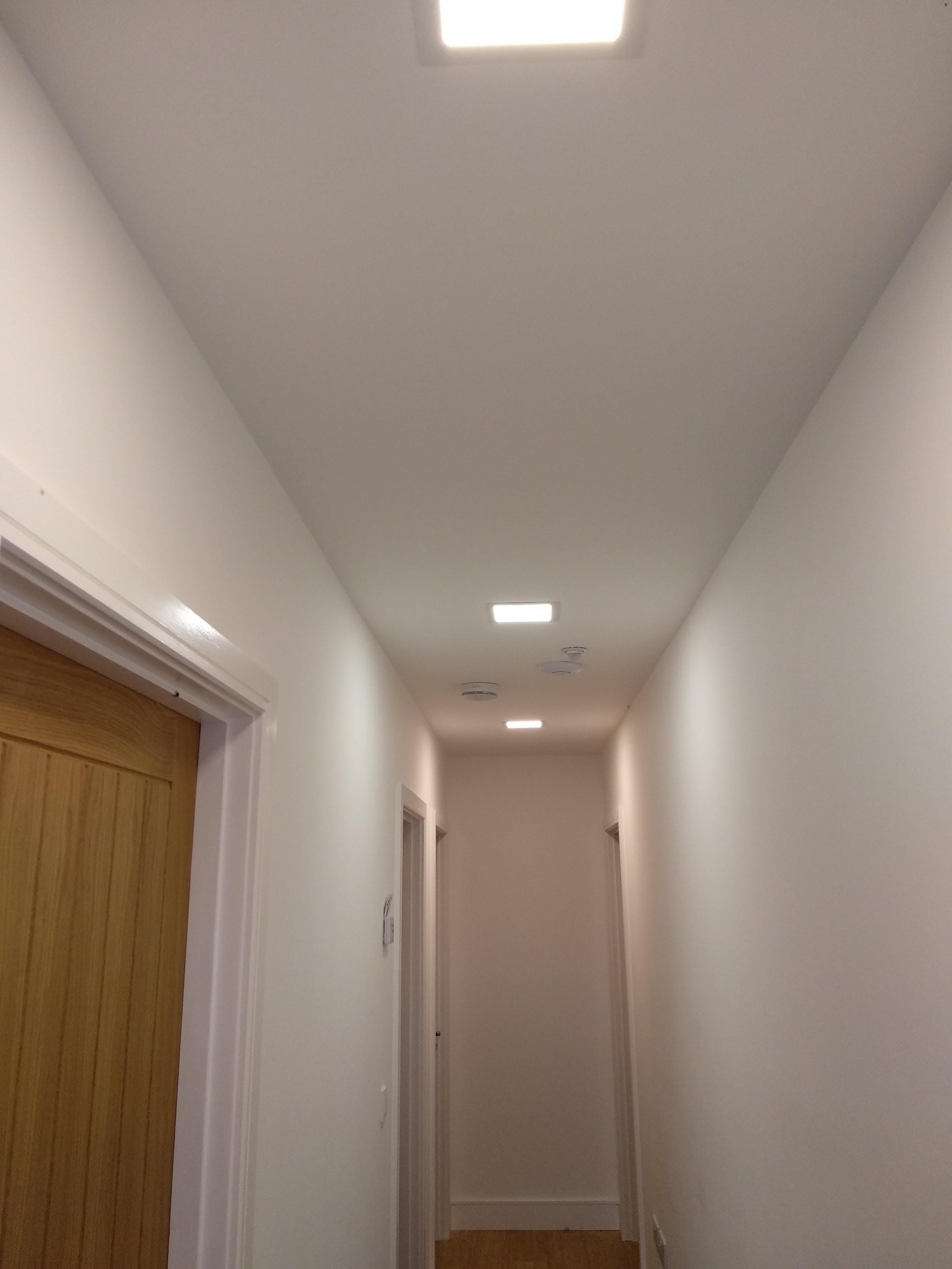

Fallingditch Posted February 3, 2018 Posted February 3, 2018 We built a three storey house - there's two staircases, three halls and a corridor on the intermediate first floor. We've fitted four presence detectors - one in each hall and one in the corridor. The two on the intermediate floor are wired together so if either detects presence, lights will come on. They are all driving LED panels inset into the ceiling. The attached picture shows the intermediate ceiling with LED panels, 1 x smoke alarm, 1 x WiFi access point and one of the presence detectors. We went for Steinel is d360 presence detectors. (I wanted to use a good quality make because I wanted to have confidence they could be adjusted for run on time, and background illumination detection). Think they were about £30 each - sourced from eBay over a period of weeks. They are also under master time switch control to force them off in the middle of the night (but that might be overkill). I am 100% happy with the way that they work - I would absolutely recommend such a setup.
