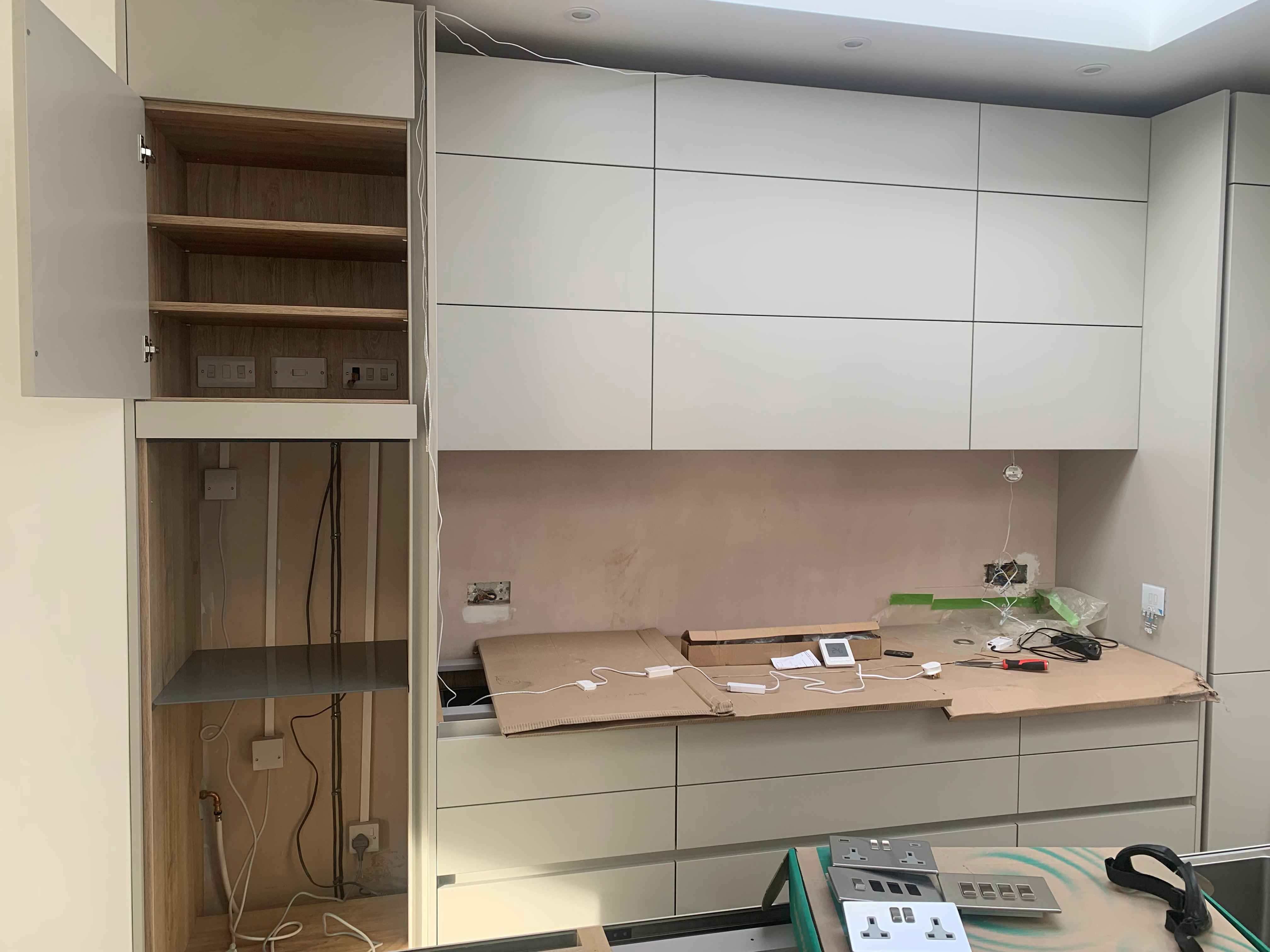

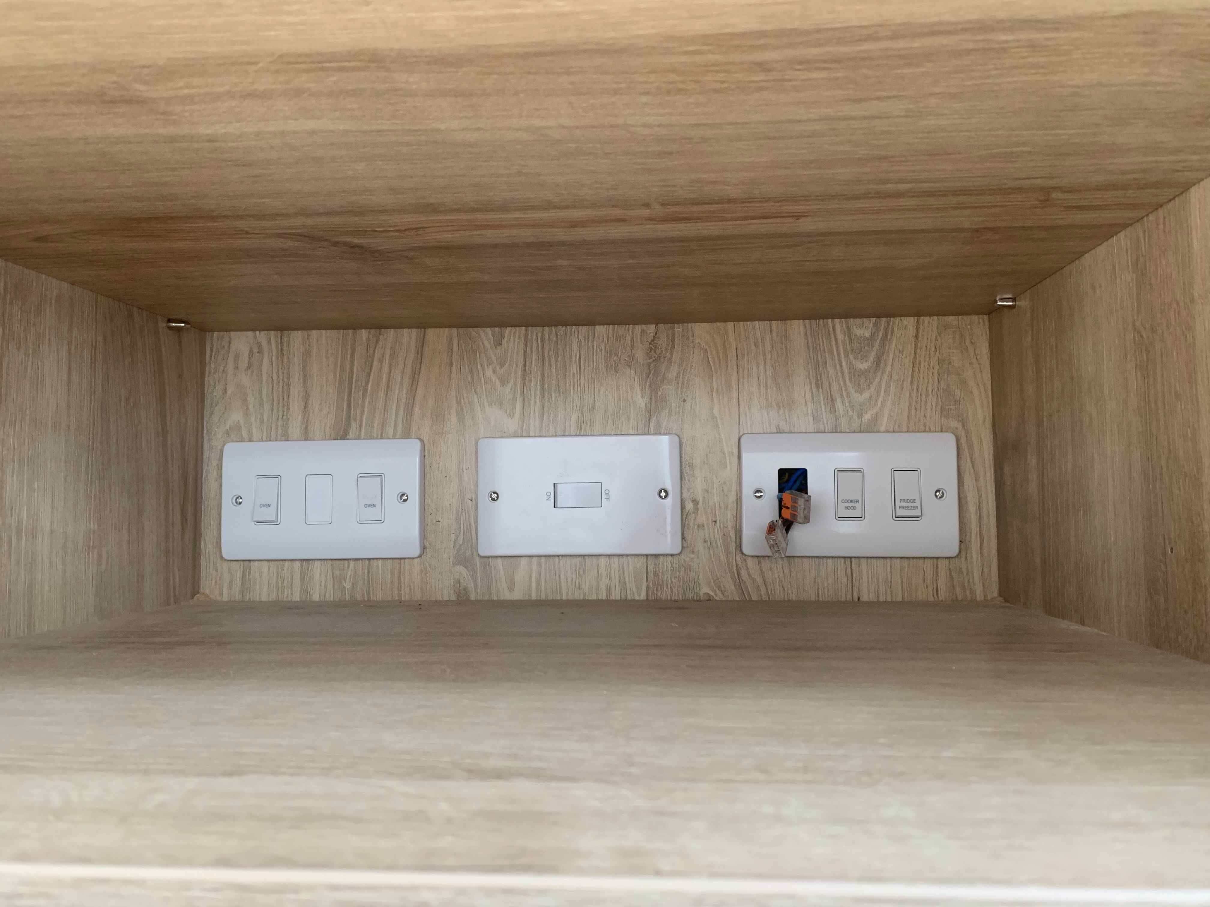

Here are a couple of pics showing where we got to with our sparky. Isolation switches in the back of a cupboard for everything on the hob run. (Our sink is going on the island, hob against the wall).
I guess your cable length issue is because you have no direct conduit/trunking between wall run and island. Fortunately we put some in under the floor and it has proven very useful.
We are going to put a 3 gang light switch on our island end panel for under wall cabinet wall lights, under worktop LED strip, and shelving LED strip - so cable run happily goes through the hob to island conduit. (As does a water pipe in a separate conduit)
(One day in the far off future I suppose kitchen companies might provide designed in electrical box locations, rather than vaguely saying 'one of these cupboards'.)
